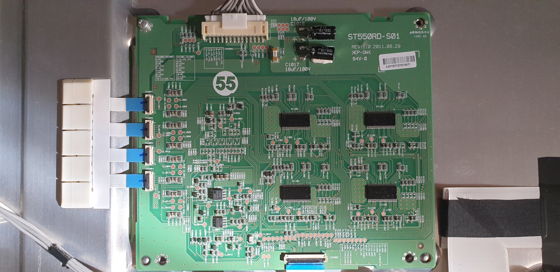

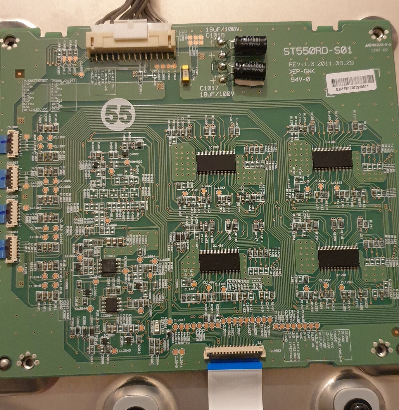

    I got a Sony 55HX850 with psu APS-326(ch) and Driver LED ST550RD-S01.
    I don't know what happenned before I get it.
    The TV is working great, except the led backlight that does'nt. Backlight nevers turn on, not even a little flash.
    The TV doesn't show red light errors at start The tv is working, I heard the sound of TV from antenna, menu etc... with the flash of my phone I can see the picture that seems fine (T-con OK ?).
    Fuses from Driver LED ST550RD-S01 seems fine (multimeter beeping : not broken, 0V), and caps of this card too.

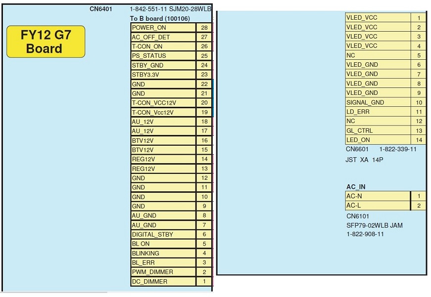

    Pins :
    If I disconnect the Driver LED cable (CN6601), nothing changes :
    CN6601 pins (tested on card and psu):
    TV ON :
    Pin 14 : 3.3v
    13 : 3.8v
    12 : 0.6v
    11 : 0.7v
    Others : 0v

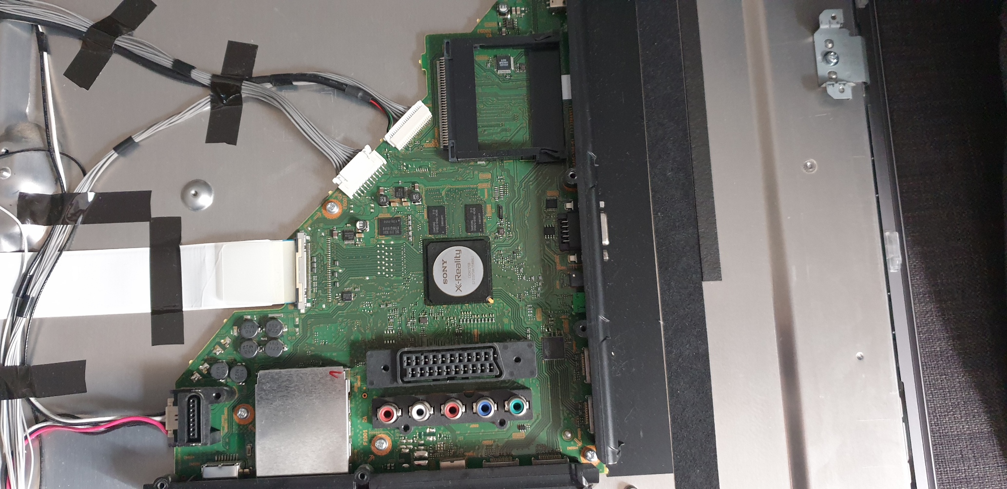

    If I disconnect CN6401 (to the motherboard), no backlight.
    If I disconnect any other cable, the error leds associated to what I disconnected appears.
    CN6401 (to motherboard) pins :
    TV ON : TV OFF :
    Pin Pin
    28 3.3v 28 3.3v
    27 3v 27 3v
    26 3.3v 26 0v
    23 3.3v 23 3.3v
    20 12.43v 20 0v
    19 12.43v 19 0v
    18 12.53v 18 12.54v
    17 12.53v 17 12.54v
    16 12.53v 16 12.54v
    15 12.53v 15 12.54v
    14 12.53v 14 12.54v
    13 12.53v 13 12.54v
    Others : 0v Others : 0v

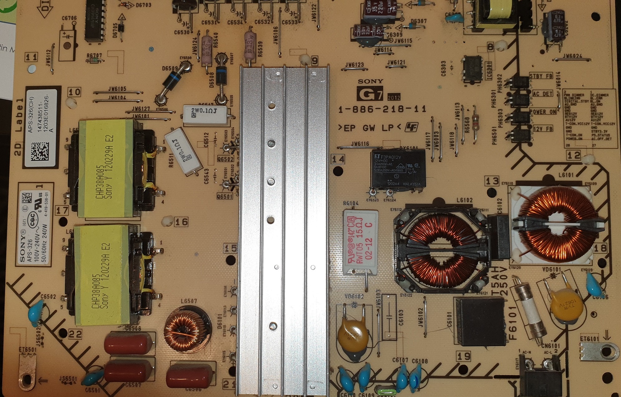

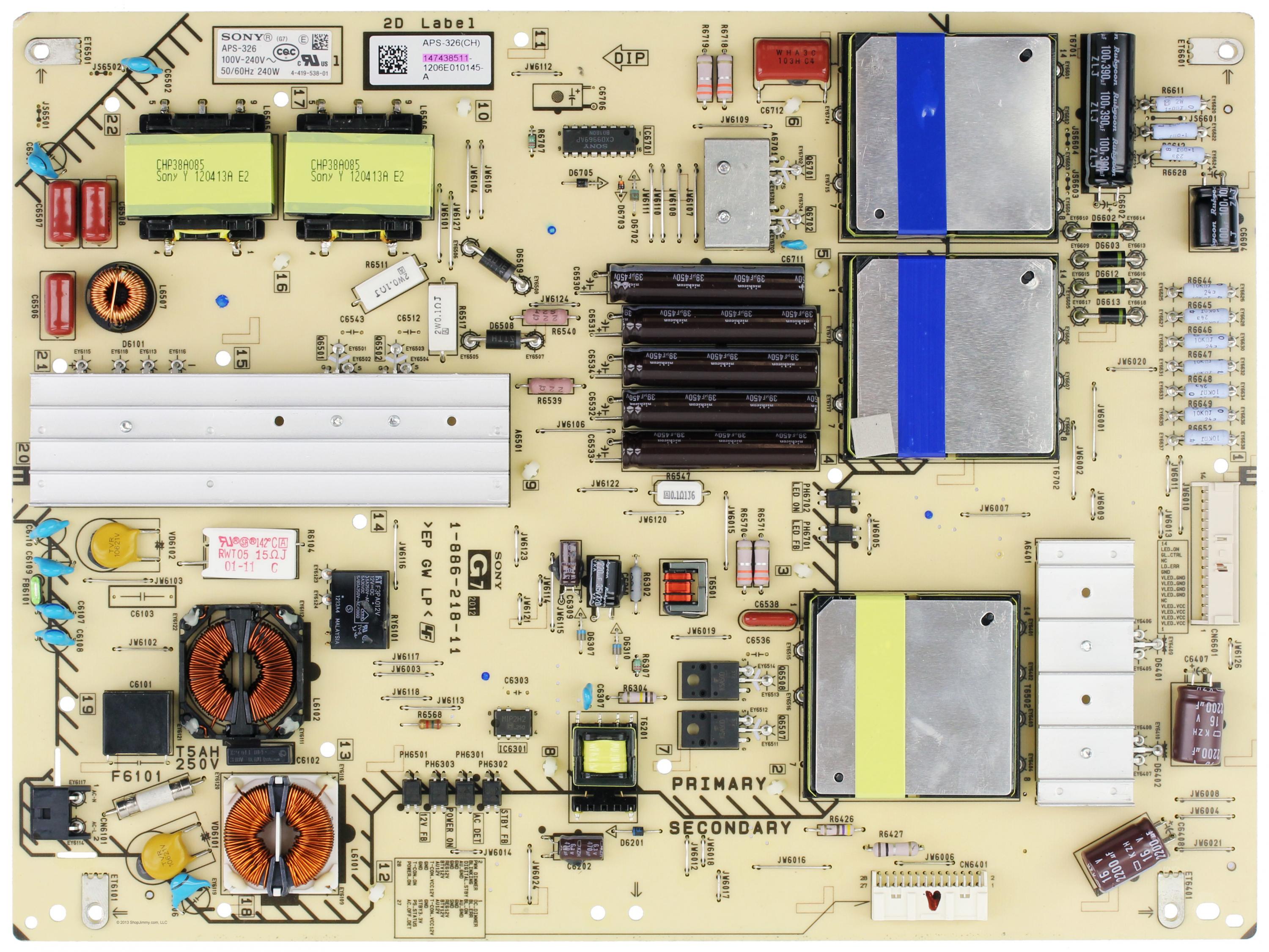

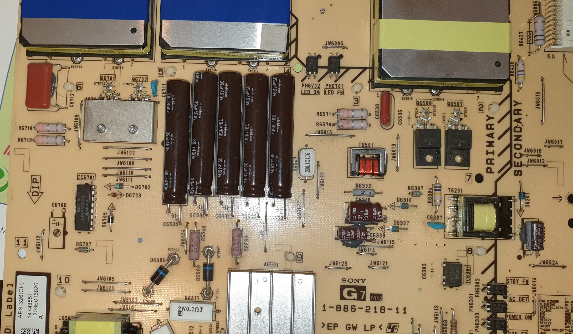

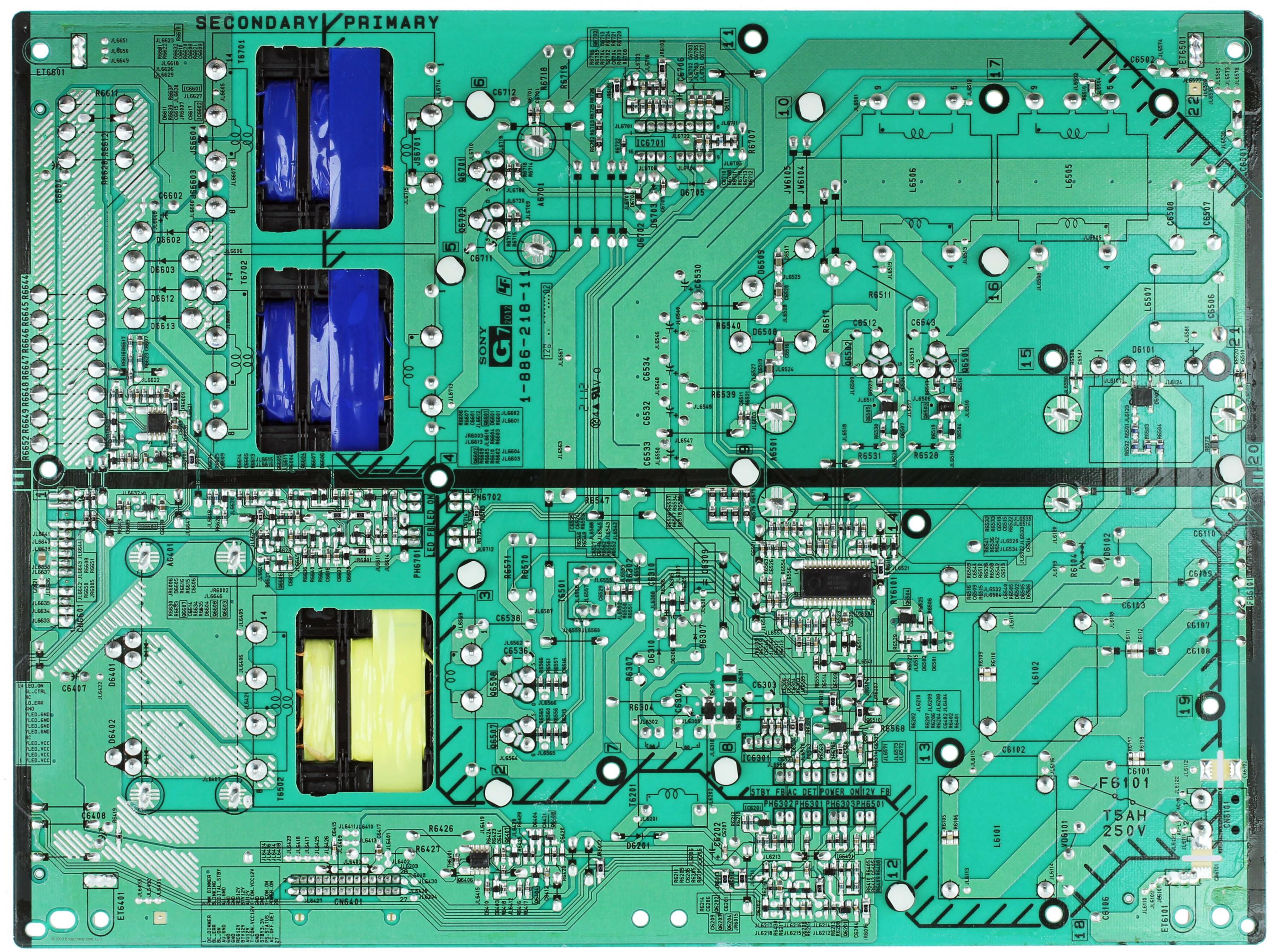

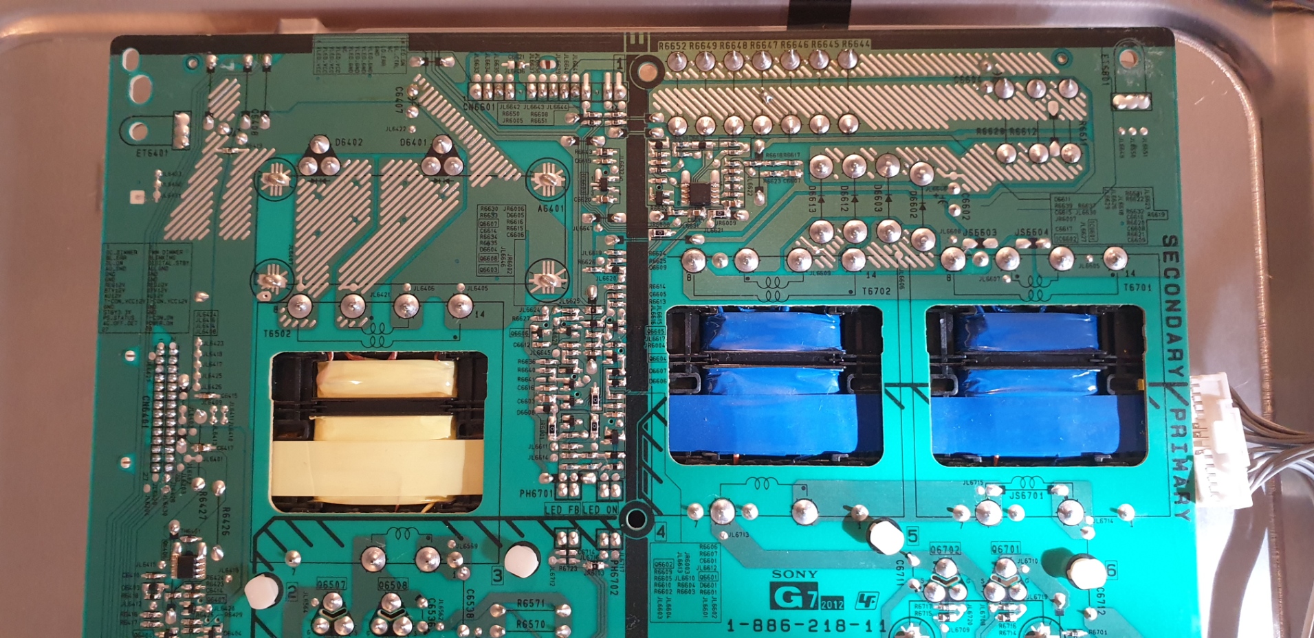

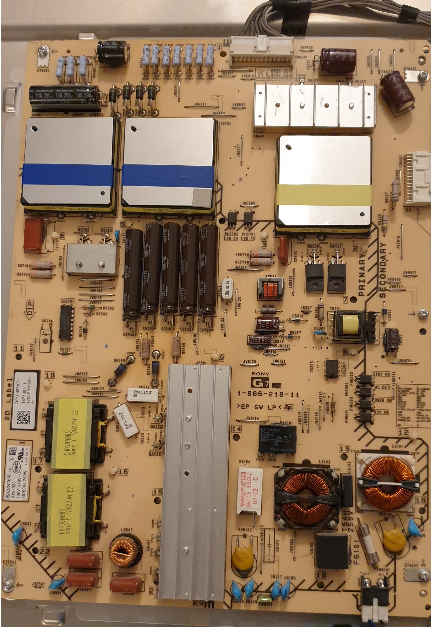

                              CN6601 per chart on your post #1 Pin 14 is the LED ON (BL-ON) and you do have 3.3V there on pin 14.
                              Since you do not have VLED_VCC for driving the LED driver board, the power supply feeding the VLED needs to be checked.
                              Check fusible resistor R6547.

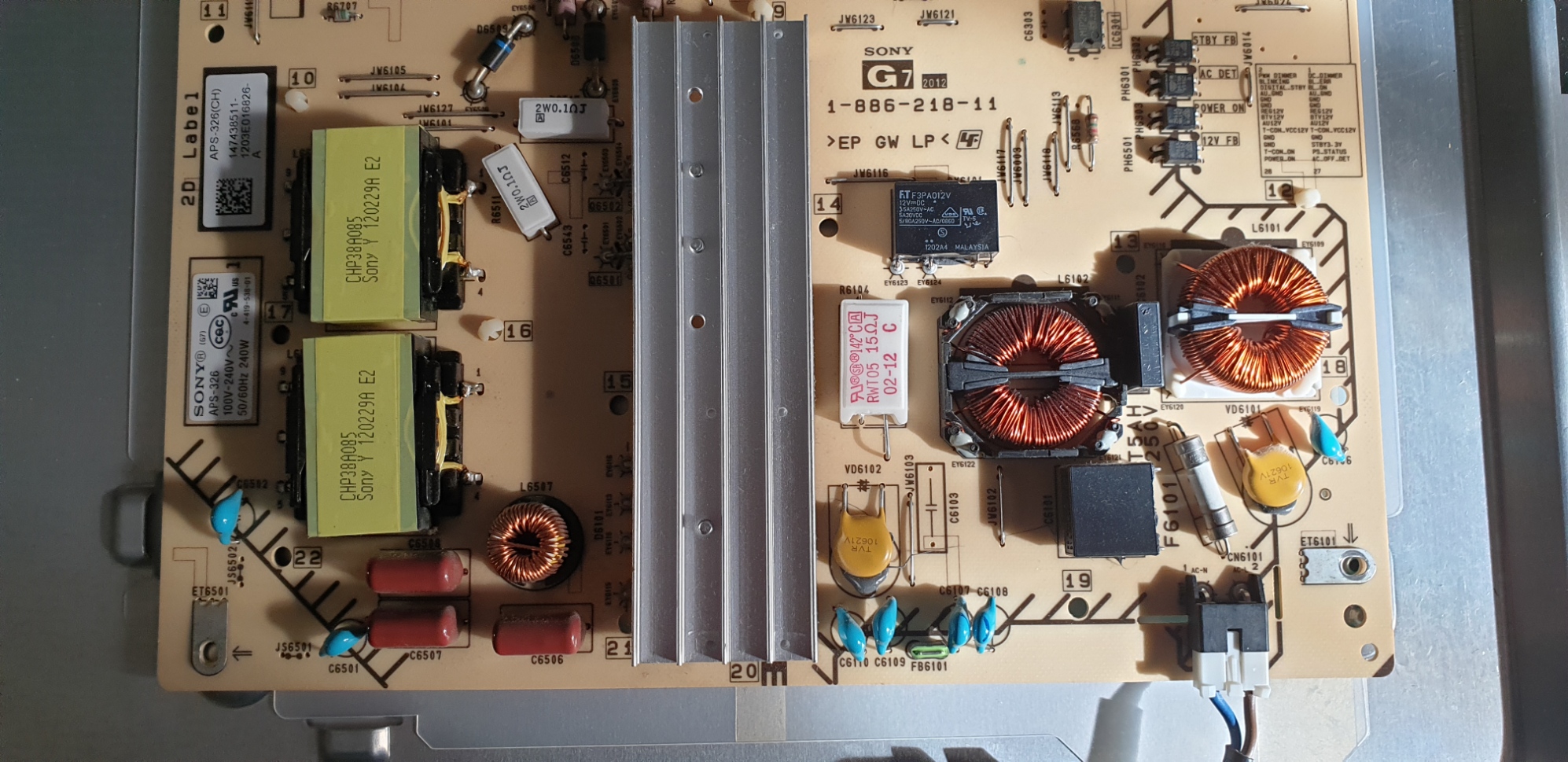

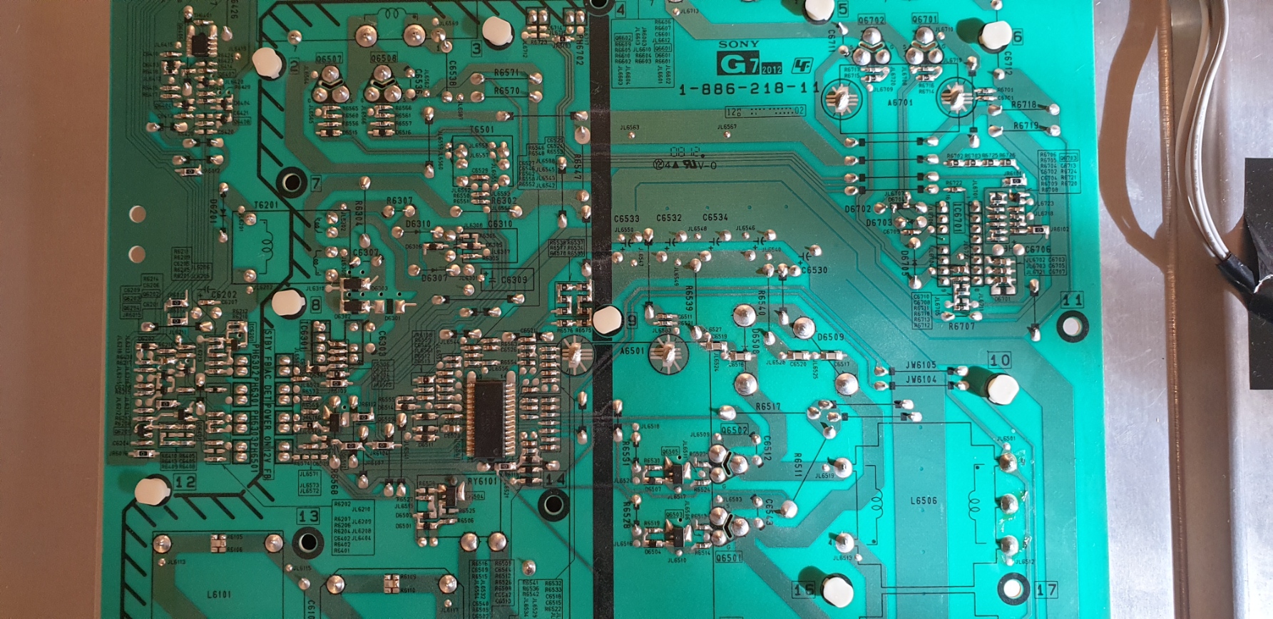

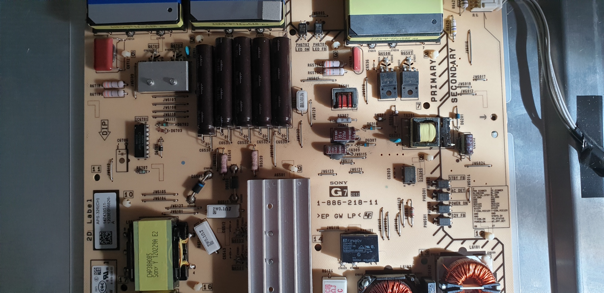

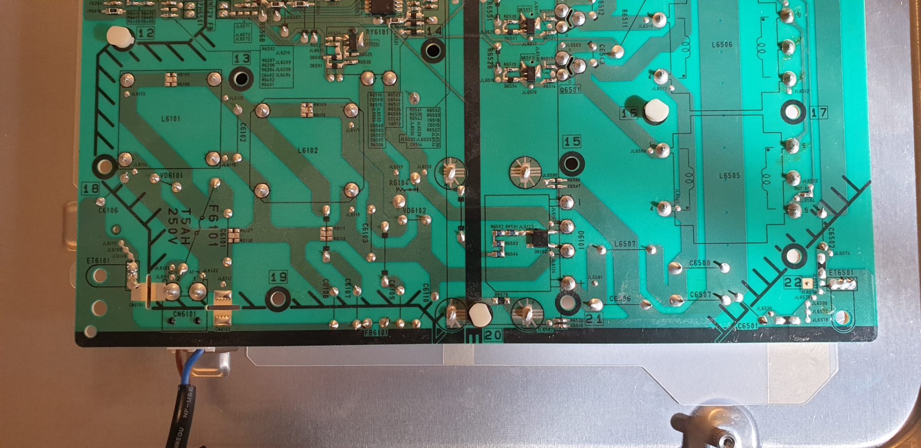

                              I also need good clear straight shots pictures of the whole top and bottom side of YOUR power supply board, and also the pictures of the whole backside of the TV showing how all the boards are connected together.
                              Please also upload the service manual since you already have it.
                              Pictures provided by shopjimmy.
                              APS-326(ch)_Sony 1-474-385-11 G7 PS

                                To be clear, when all cables are connected, BL_ON (CN6401 to main borad) is never 3.3v, even if LED_ON (CN 6601 to driver LED) is ~3.28v.
                                R6547 : Beeping with tester (continuity), 0.001v, 018.5 ohm in multimeter (18,5 ohm so ?), it's written 0.1 ohm on it, is it broken or my test is wrong ??
                                Service manual too big for attachment :

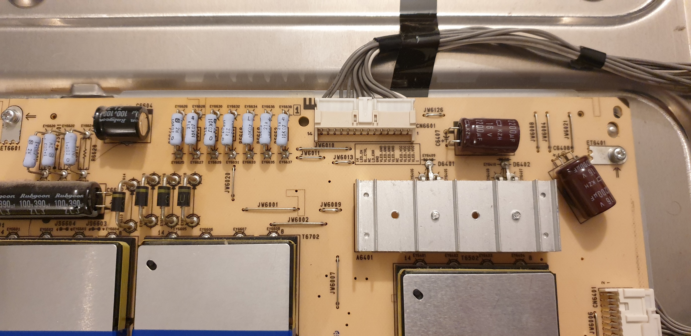

                                  check the Fuse on LED driver boards F2001. if its okay.. ready for risky job to take screen apart. search for other 2 hands help you with this risky job.
                                      F2001 : Continuity OK (beeping), 0.001v, 0 ohm
                                      Originally posted by budm
                                      1) Monitor that LED_ON pin of CN6601,it should change state between <1V and > 3V when you turn the TV on and off.
                                      2) Set meter to 200VDC scale, Keep black meter probe on chassis, red probe any one of the any one of the VLED_VCC pin of the CN6601 then turn on the TV while watching the meter to see if you see the Voltage jumps up at all.
                                      1) LED_ON is ~-0v in standby and 3.28v TV on
                                      2) VLED_VCC are 0v in standby, go up to 0.140v EACH 4 VLED_VCC for 2 secs and go down to 0V 3 sec later progessively.
                                      Thanks again !

                                        1) So BL_ON (LED_ON) control signal is fine.
                                        2) So the LED power supply does not even try to put out anything, I would look into that power supply section, since we do not have the schematic of the power supply, then it will have to be traced out, the SMPS IC for that section need to be checked to see if it is getting VCC to run or not, etc.
