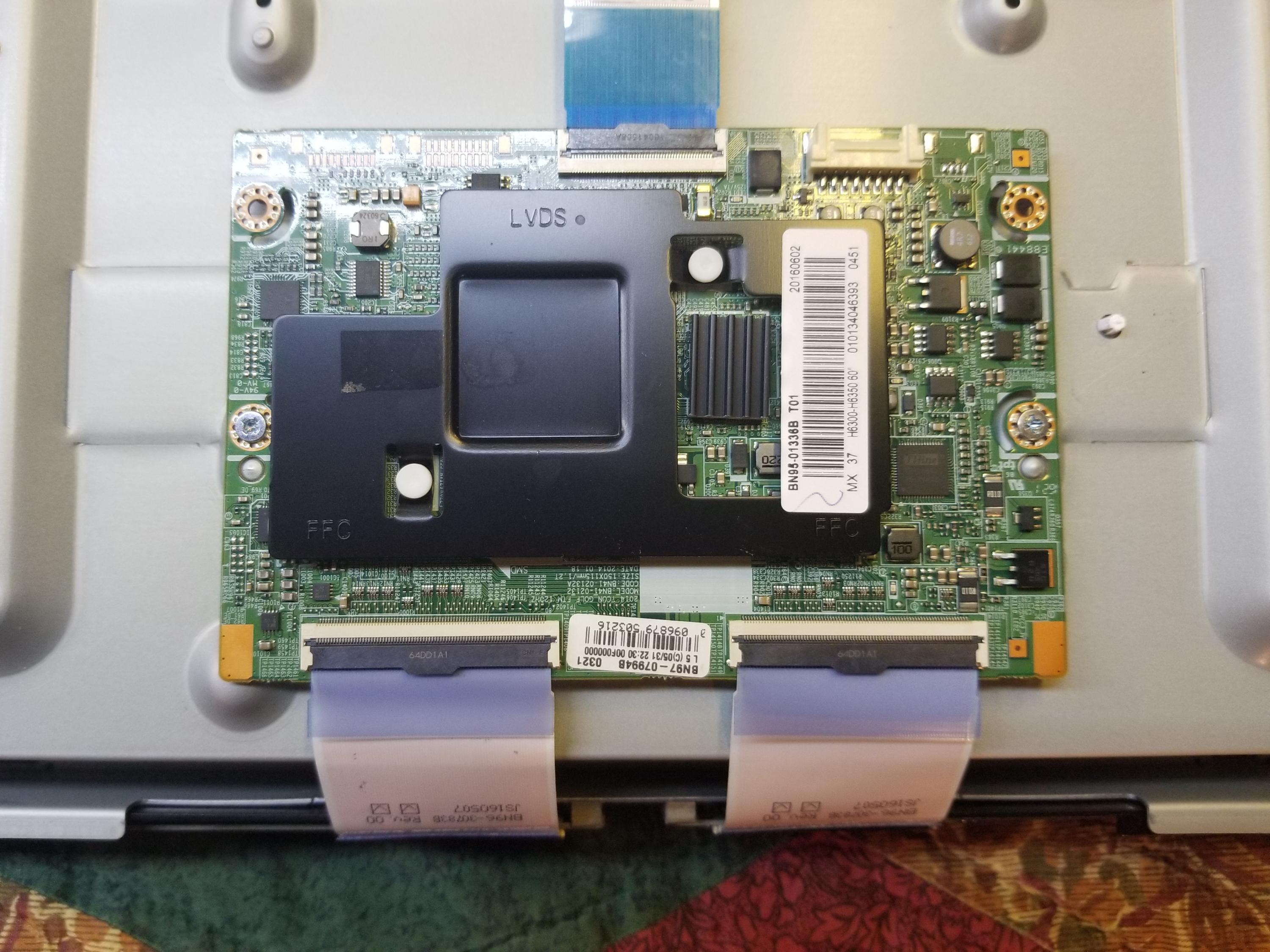

    Tried all I could: replaced the t-con board and mainboard. Swapped all cables. I see no defect on the panel cables either and touching them does not change the picture. I have no idea what to do next. Any help is greatly appreciated! Thanks!

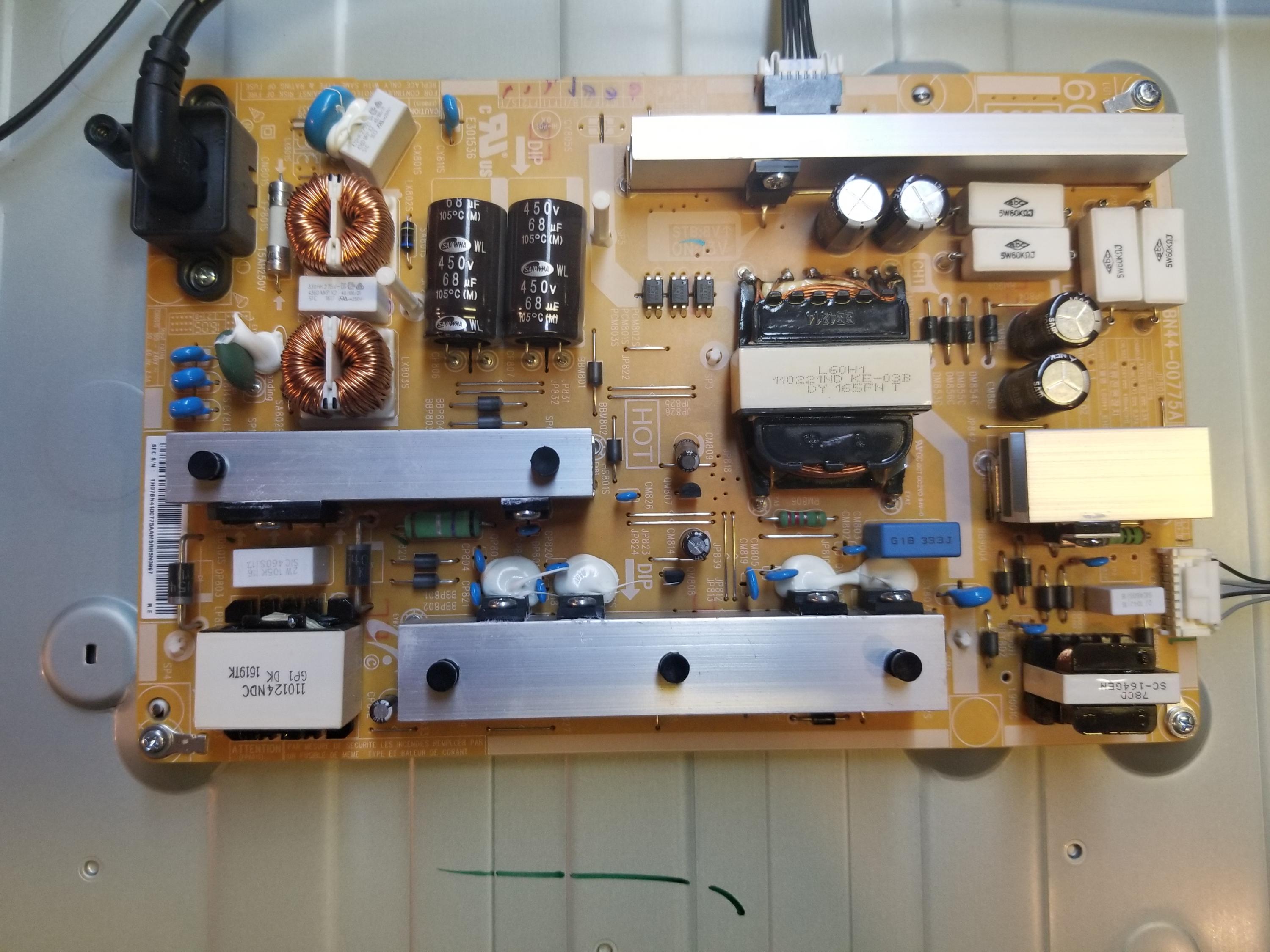

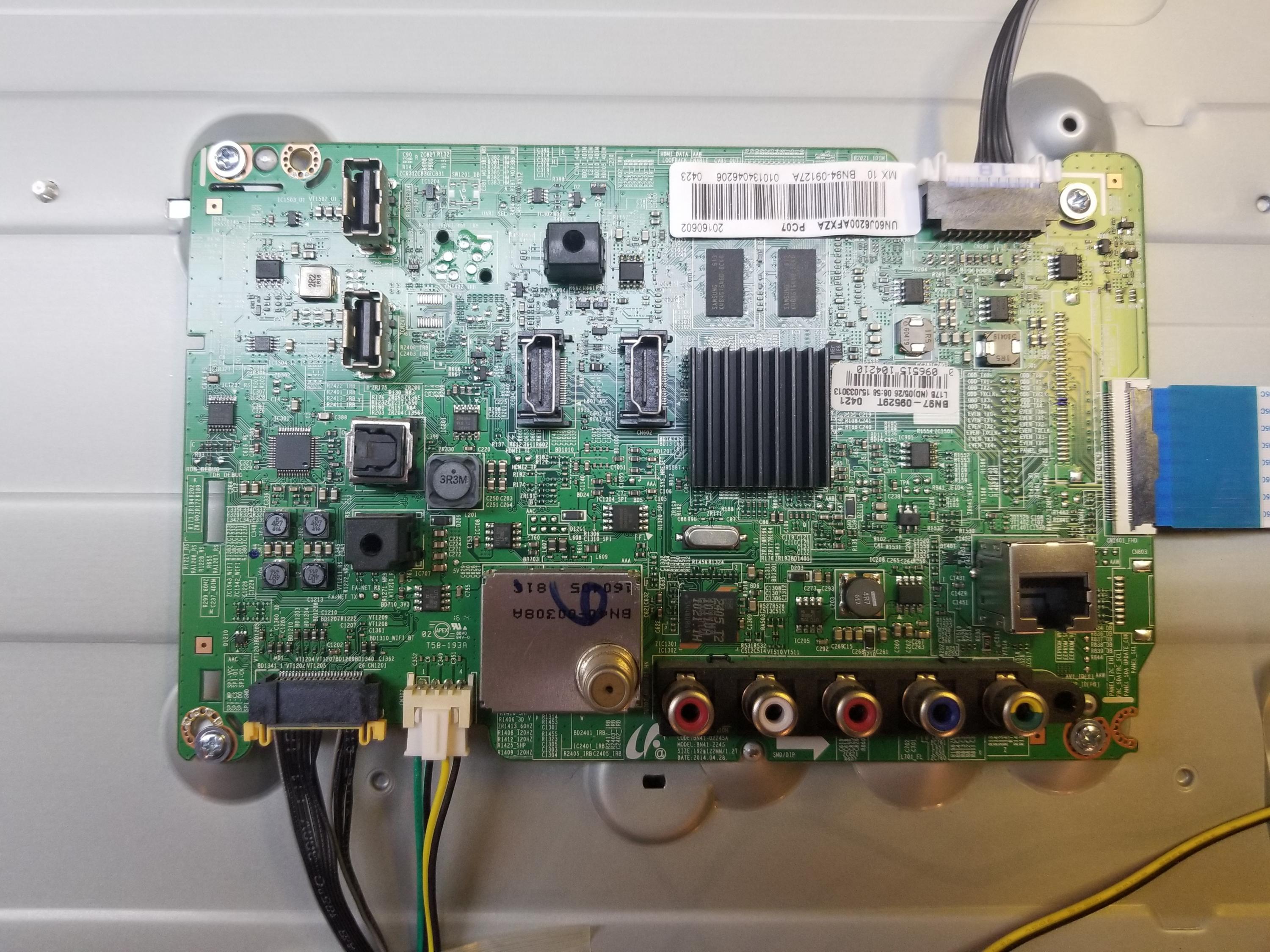

    Doesn't look like anyone wants to try on the sammys, I'll try to help you, do you have a multimeter for testing? Can you use the attachment to post some good clear str8 on pictures of each board and one of the whole back to see how they are arranged?

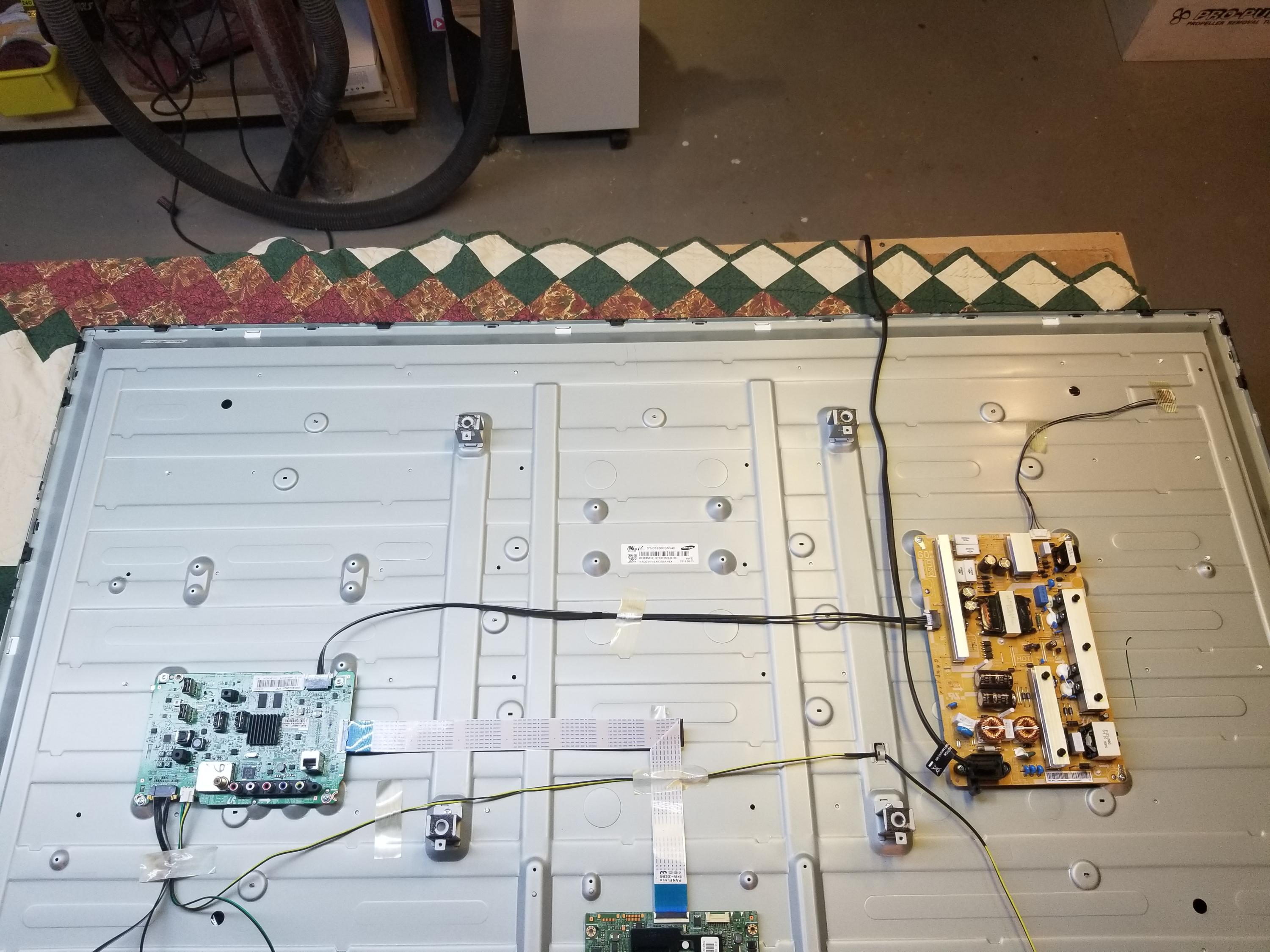

      Show us good clear pictures of the backside of the TV showing all the boards using GO ADVANCED to attach the pictures..
      What Voltage testing have you done so far?

        Thanks! I have scope and voltmetter (multimeter). I did not do any voltage testing yet. Here are the pictures:

          and one more

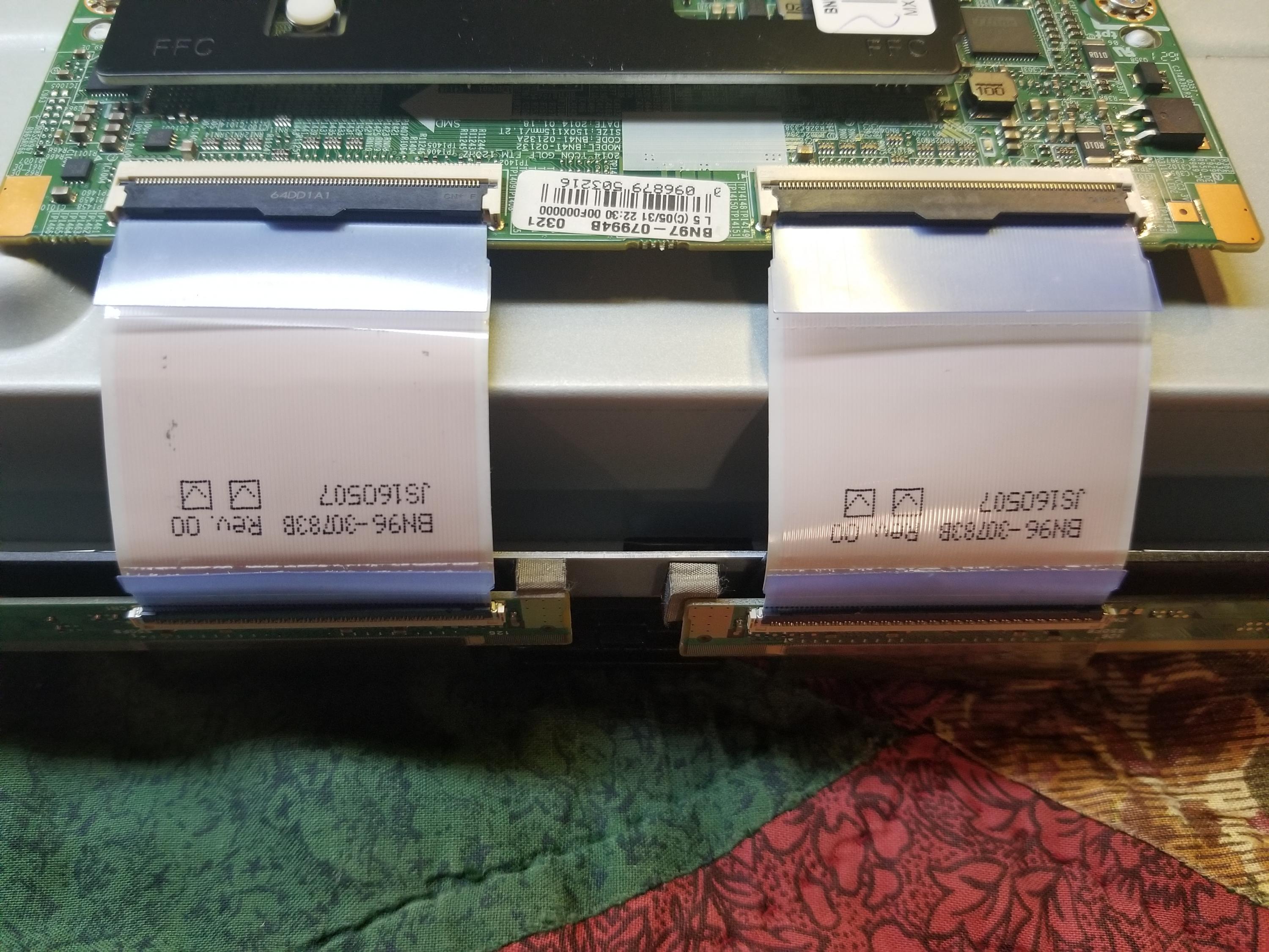

                          Did you disconnect the ribbon cables from tcon to panel strip at the panel strip end. They don't look like they are inserted correctly since you can see the contacts on the ribbons rising up at the left-hand side (in your photo) away from the connector. Post #4, last picture.
                          Could just be the photo.

                            looks like bad tab bonds to me.
