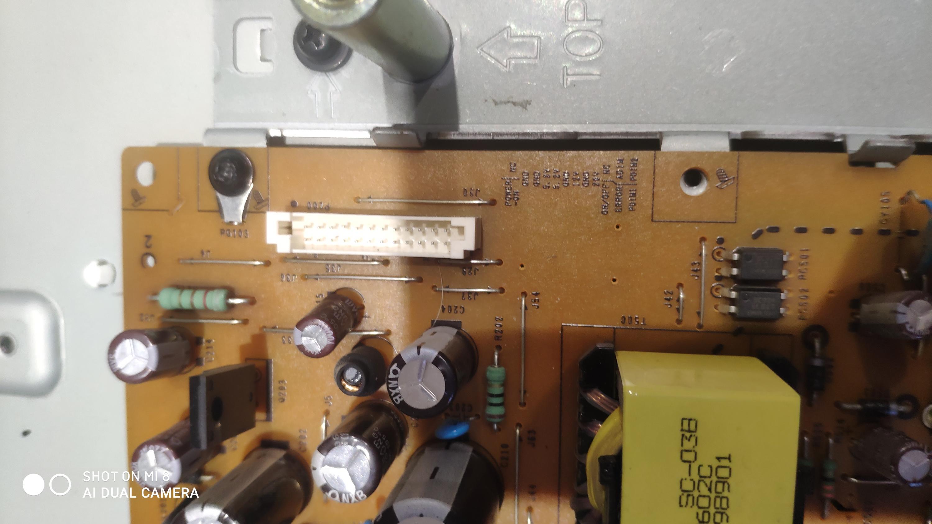

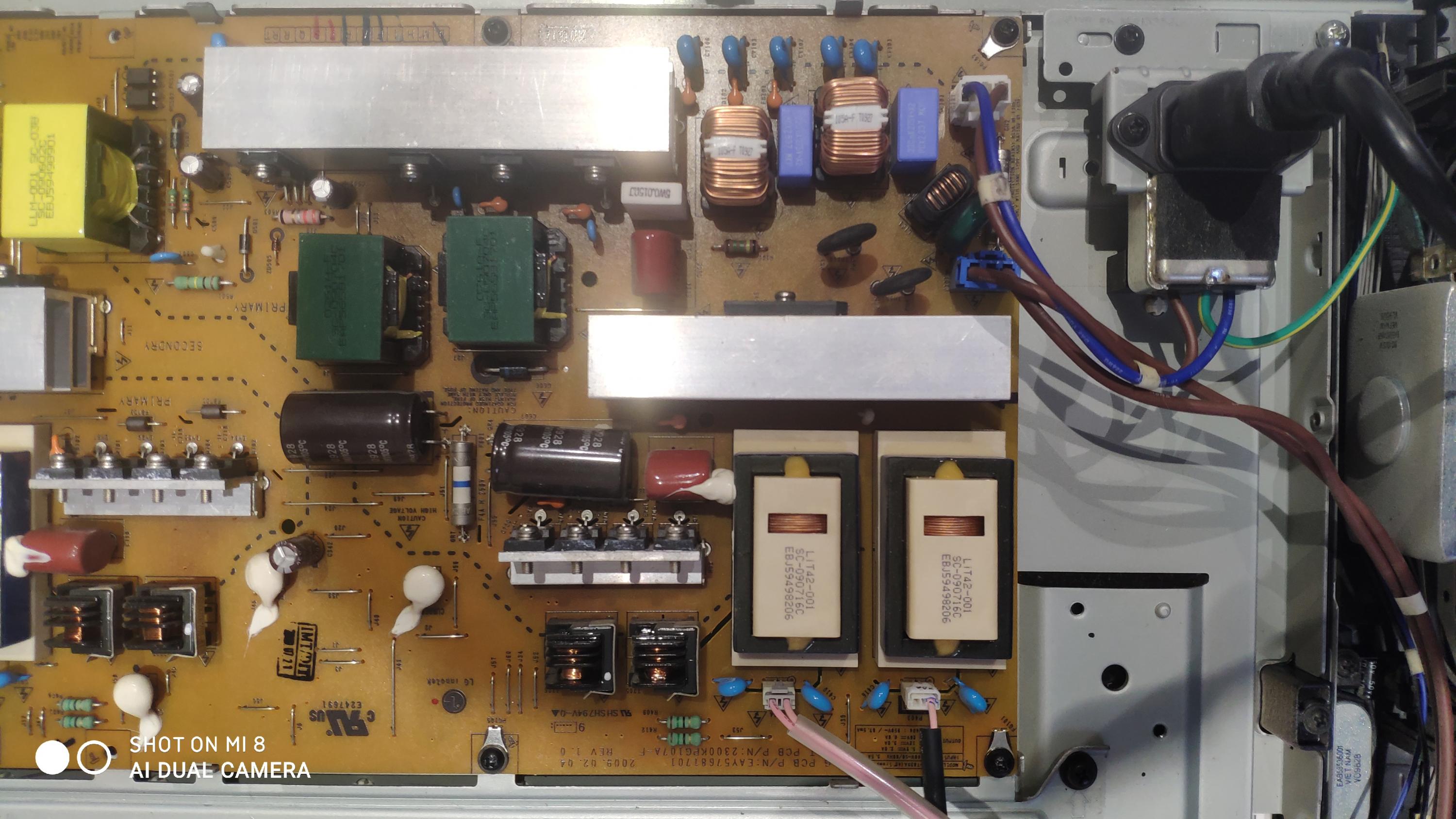

    Hi guys i need your help. I m trying to repair this tv, my friend says a lightining strike killed it because the hdmi peripherals connected to it are dead aswell.
    i excluded power supply, i shorted +5v with power on and on/off pins and led lights works.
    Power led is on but tv stays off
    voltage are these with no shorted pins
    error : +5v (with mainboard disconnected, when connected drops at 3.3)
    +5.2 volt present all the others pin are 0.
    when shorted +5v with pow on and on/off pins ( and mainboard disconnected obv) i have +20 volts and +12v and the leds go on.
    pdim1 and pdim2 +3v
    adim : 1.7
    error pin go 0
    so i think mainboard is the issue right?

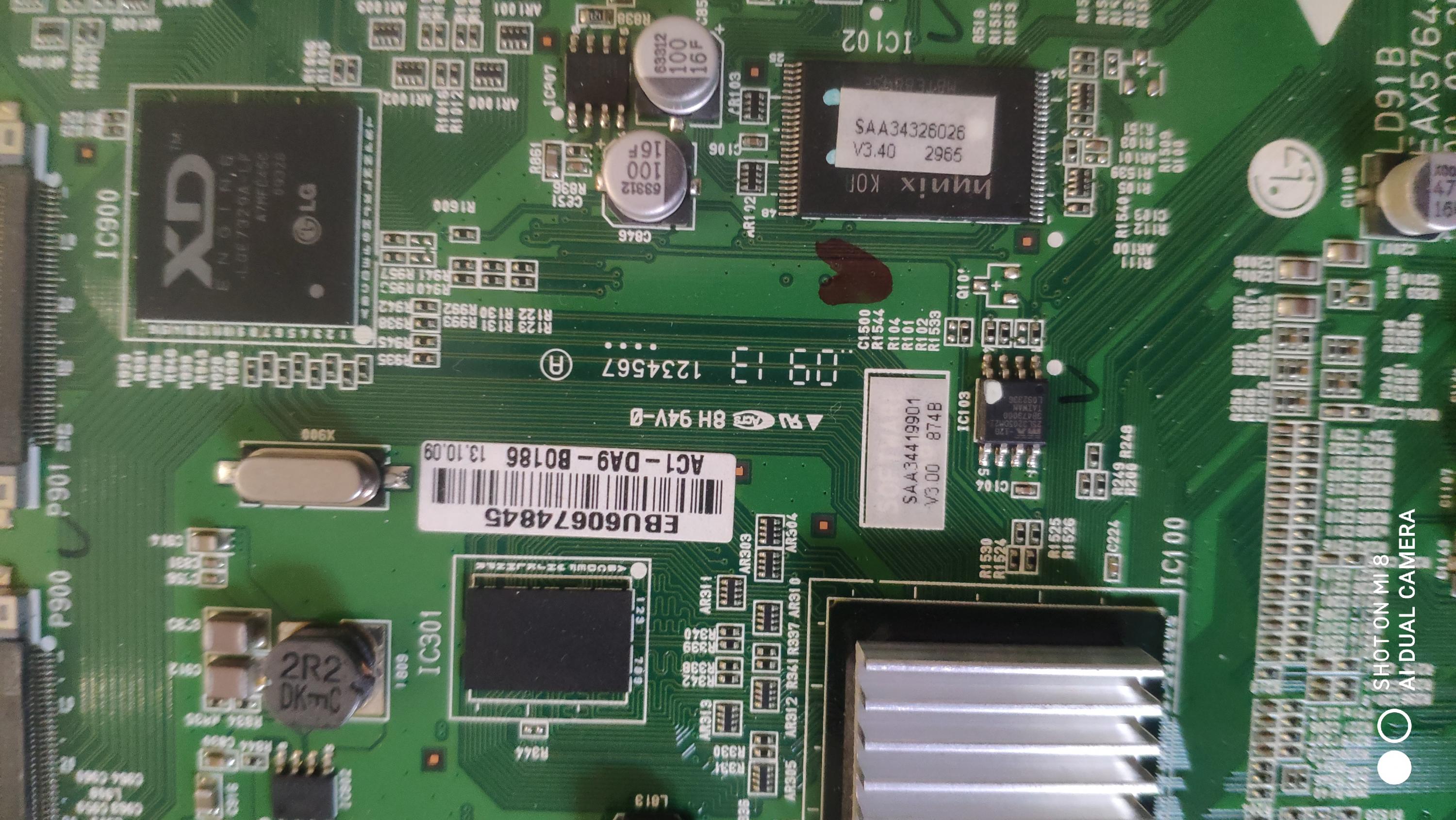

    Re: Help for LG 42LH5000-ZB
    Main board issue.
    • Dowhile
      • Sep 2020
      • 35
      • Italia
      Originally posted by budm
      Main board issue.
      Is there a service manual or something like that in order to repair it? Should i check vdd voltages on ic's?
