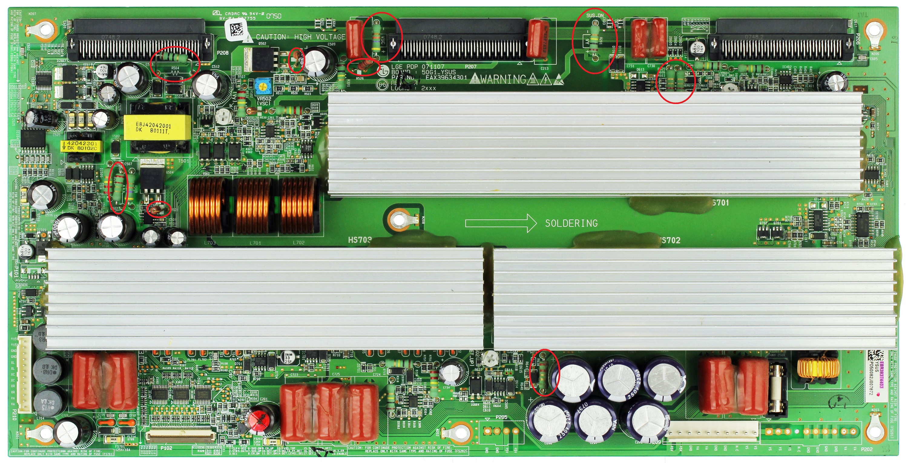

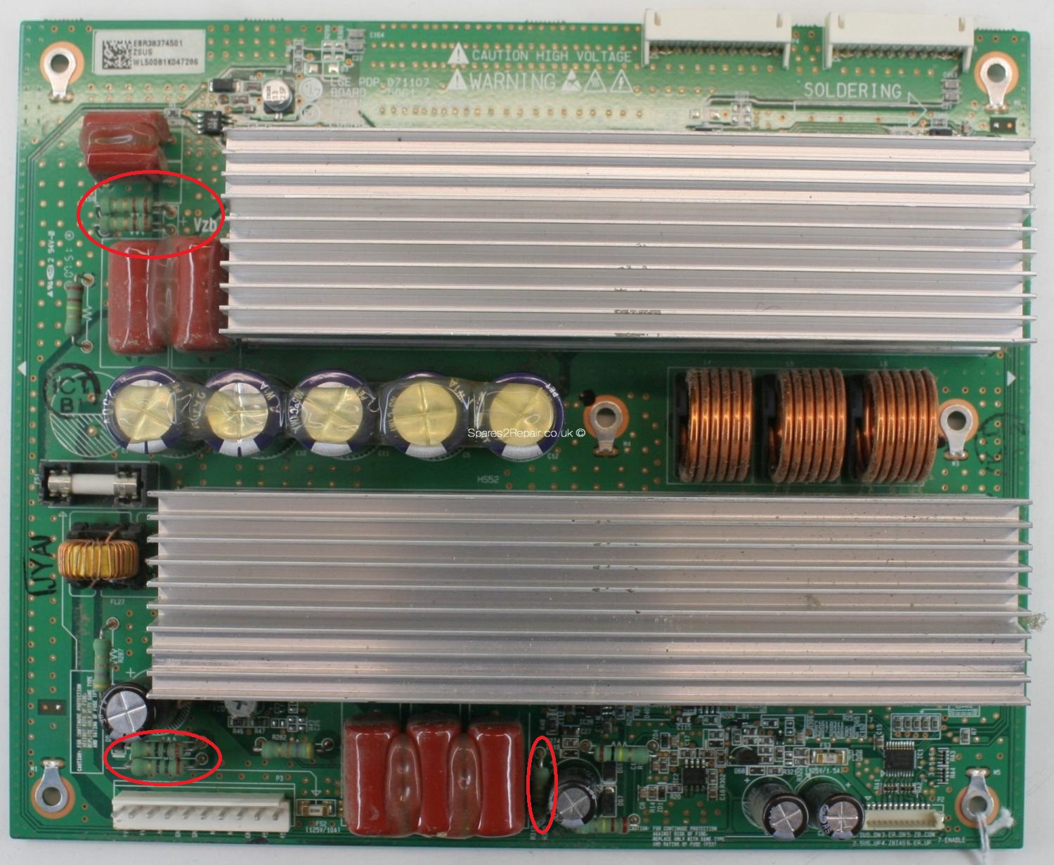

                  Re: LG 50PG3000 Plasma - No Display
                  Highlighted are resistors for measuring VSCN (47kOHMs top) and -VY (100kOHMs top) and some others that fail when IGBTs short, they should not measure open or more than they're rated for.
                  VZB you measure from that resistor + to chassi ground.
                  I always solder a flexible small wire between the AUTO_GEN pads shaped like a U, to ensure there's no problem with poor contact.
                  Should also add, I've had one of these TVs with a defective top buffer, none of the output pads were shorted, but some SMD capacitors in parallel with the ICs were measuring 40 OHMs, and the Y-SUS VS fuse was open, nothing else damaged, replaced the fuse but the TV actually worked with half the lower screen, so a bit different than your fault.

                    thanks for the info. The z-sus board looks fine, however y-sus board appears unhappy. There is less than 0.5V showing on both VSC and VY. So, you're certainly getting me in the right direction it would appear. Some of the resistors are showing different values than their banding but I'm guessing that is because they are still in circuit? None are showing open or dead short.
                      On the Y-SUS board there are 2.2, 1.0 and 10 OHMs resistors circled, some 2.2 are in parallel, so should be 1.1 or less. I forgot to circle one below VR502, a red vertical one
                      If the resistors are good or bad, and the VS fuse on Y-SUS is good, you need to remove the board from the TV and check every IGBT and MOSFET in the heatsinks. Anything below 300 OHMs between C-E/S-D is a bad sign.

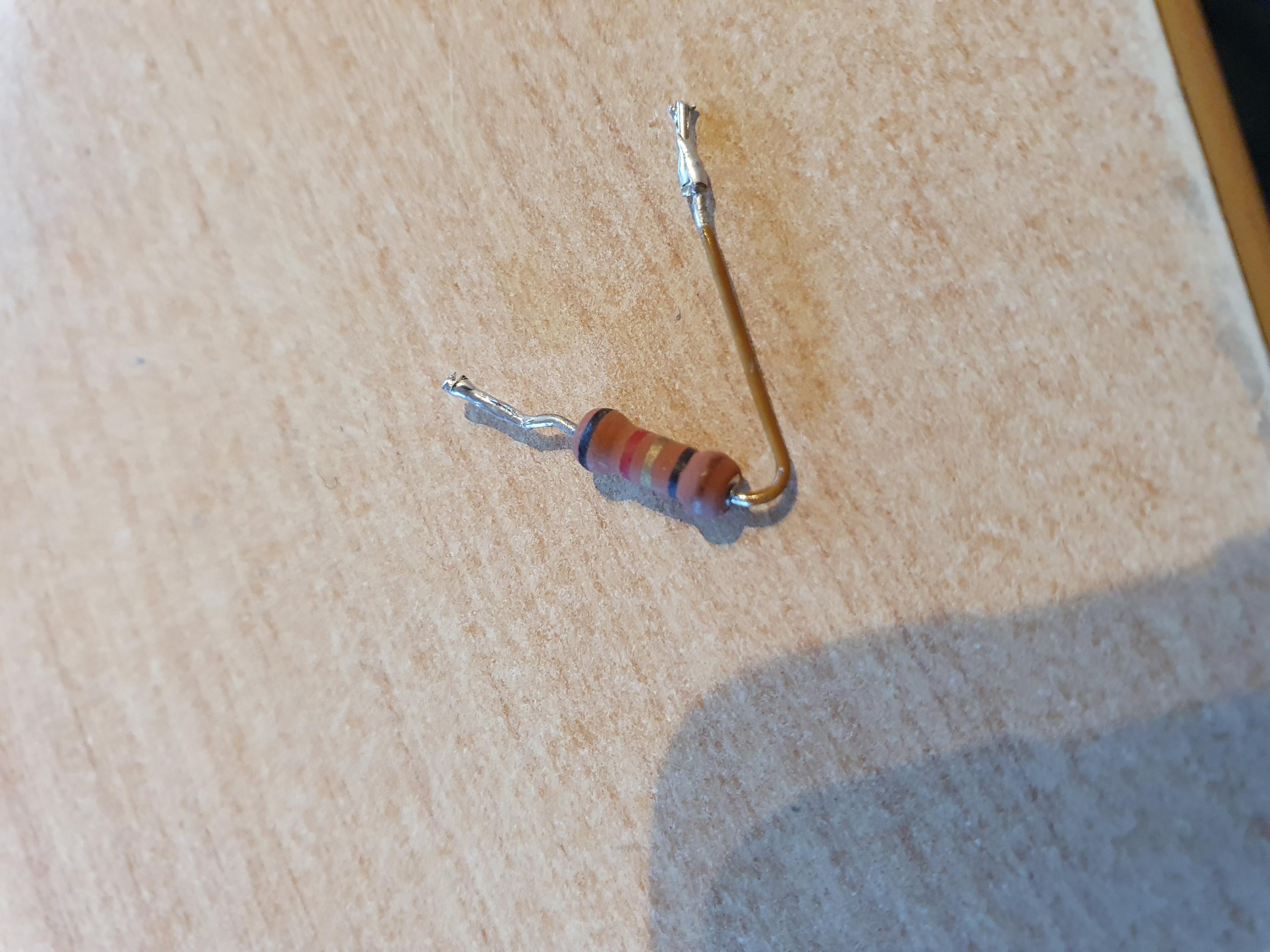

                        apologies for the massive edit. I checked both VR502 and R513 with my LCR tester. Approx 1.34 ohm which I suspect is within range.
                        Or am I going nuts?? Should these be 10.4K? Any help greatly appreciated!
                          I couldn't see the exact value because the on the photo they're vertical, the reading seems normal, they have 5 bands which confuse which way they're supposed to be read.
                            I think they're Brown / Black / Gold / Red
                            or possibly...Black / Red / Gold / Black but that doesnt seem to work either
                            The fact they're both reading roughly the same on the LCR tester makes me think they're ok
