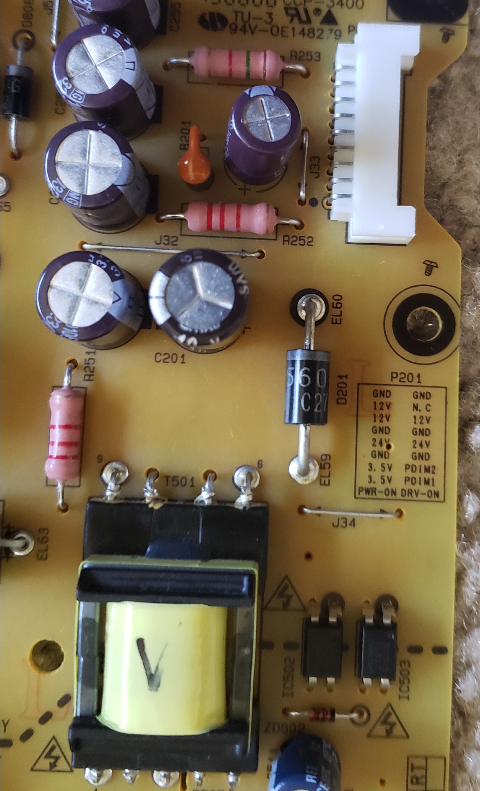

    I have smps board which is not powering up. I'm getting 3.5 standby voltage though. After shorting PS ON with ground not getting any other voltages like 12V , 24 V on other pins. Any help would be appreciated.

    Disconnect the cable between the main board and power supply, and connect around a 1k resistor between standby & pwr-on, it looks like it needs a logic high, not low to turn it on

      With the mainboard disconnected from the power supply, I believe you need to jumper the standby voltage to Power On using a 1K resistor so as not to damage anything.

        Thanks for quick reply guys on this. I have shorted the 3.5 standby pin with PWR-ON with jumper. Will that be an issue? Also after jumping power on, I'm getting 14V to IC SSC9527s as an source voltage to it.

          Yes in this case you can short stb3.3 to pwr-on, there is a 470Ω resistor already there. Have you checked F101? When you say source voltage do you mean VCC? 14~16 volts vcc is about right.

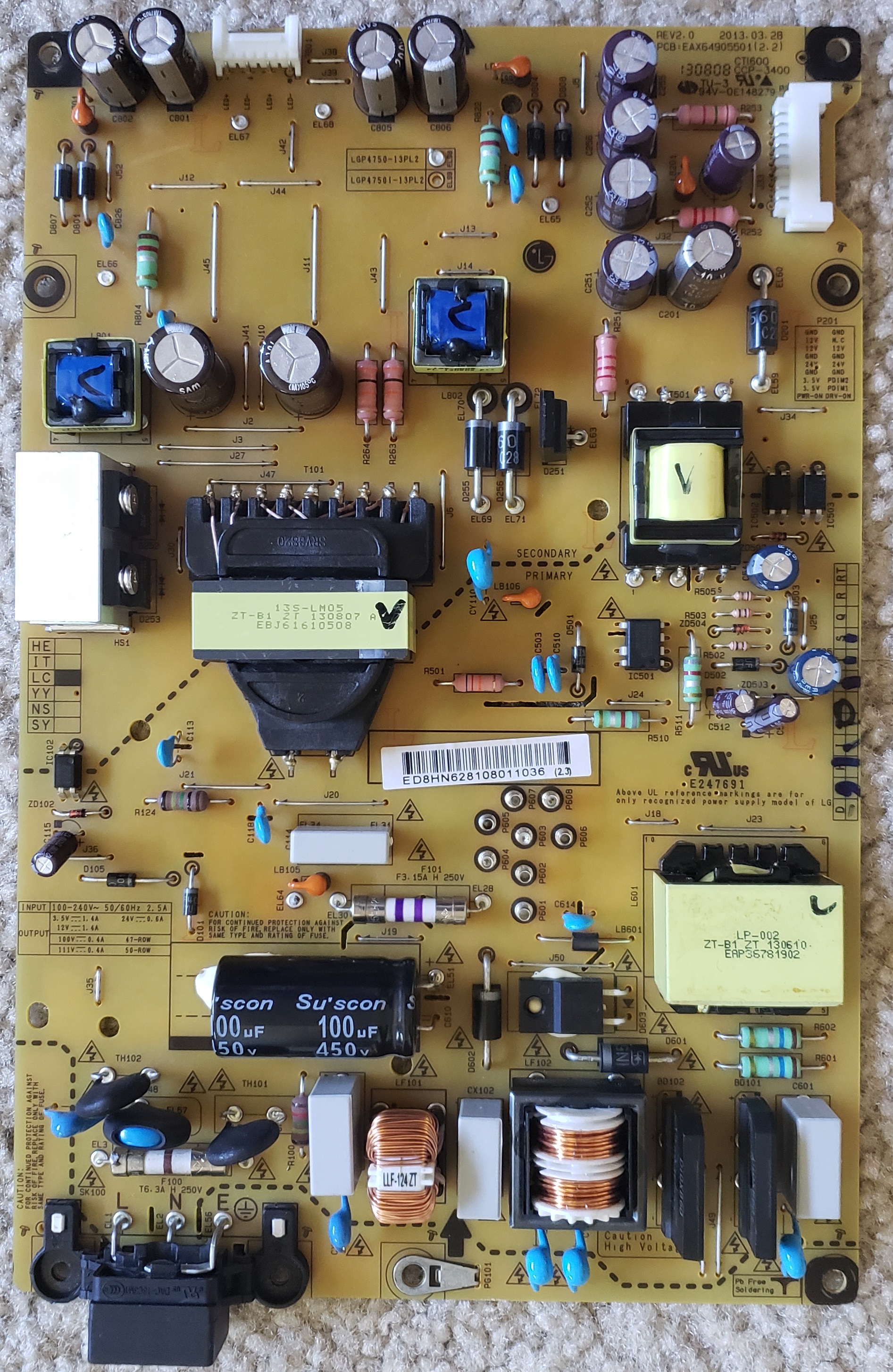

            Yes all fuse are good and I have basic checks all looks good. I'm getting 172V on Darin of Q101 however its not present on Q102. Not getting any voltage on transformer input EL35 and EL36. Actually SMPS was working fine but I shorted the leads of main capacitor c510 to discharge after disconnecting the power. But then it never turned on after that. I'm getting aroung 173V on main capacitor C510. Any idea whats going wrong?

              You likely blew up the pfc circuit. check D601,D602,D603, but you may have damaged ic601, Q501,Q502. IC101 may not operate wit the low B+ of 172v, it needs the pfc boosted voltage which is around 385vdc
              NEVER discharge the main cap by shorting it out. If you must discharge it you need to do it with a resistor.

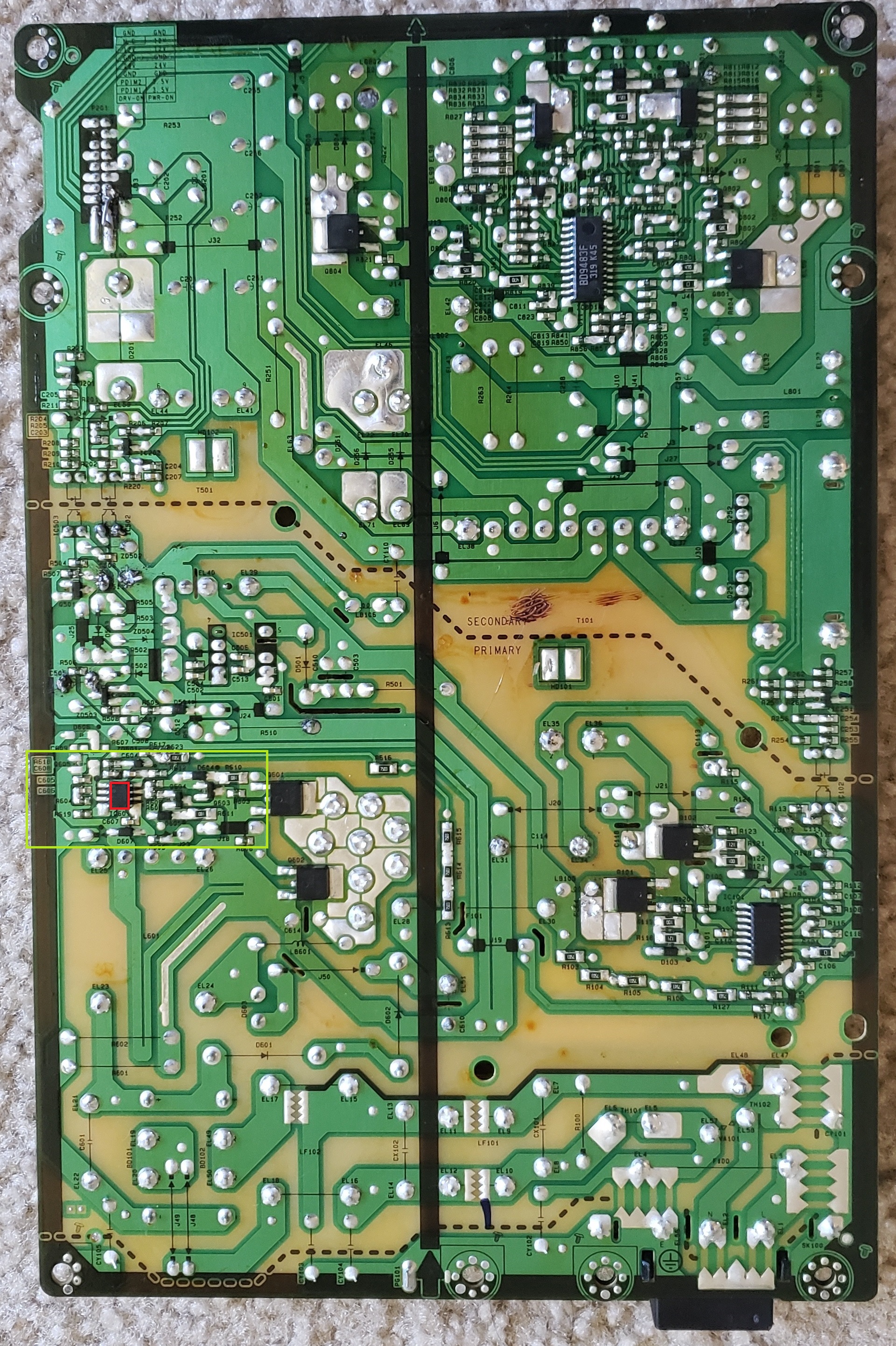

                    Also I have tested other IC highligted with RED color, not sure what IC is it. Not able to see the part number on it. But I'm getting below voltages on that IC 601 -
                    PIN1 1V
                    PIN2 2.6V
                    PIN3 4.2V
                    PIN4 2.6V
                    PIN5 0V
                    PIN6 0V
                    PIN7 0V
                    PIN8 14V
                    Also as you said there is only 0.6V on VSEN for IC 101. I have tested all the resistors on the area marked in GREEN color and look good to me.

                      Forgot to add photo.

                        When you short out a capacitor with 170 volts on it, you do damage. You can check zd602, if it is not shorted, start by replacing ic601.
