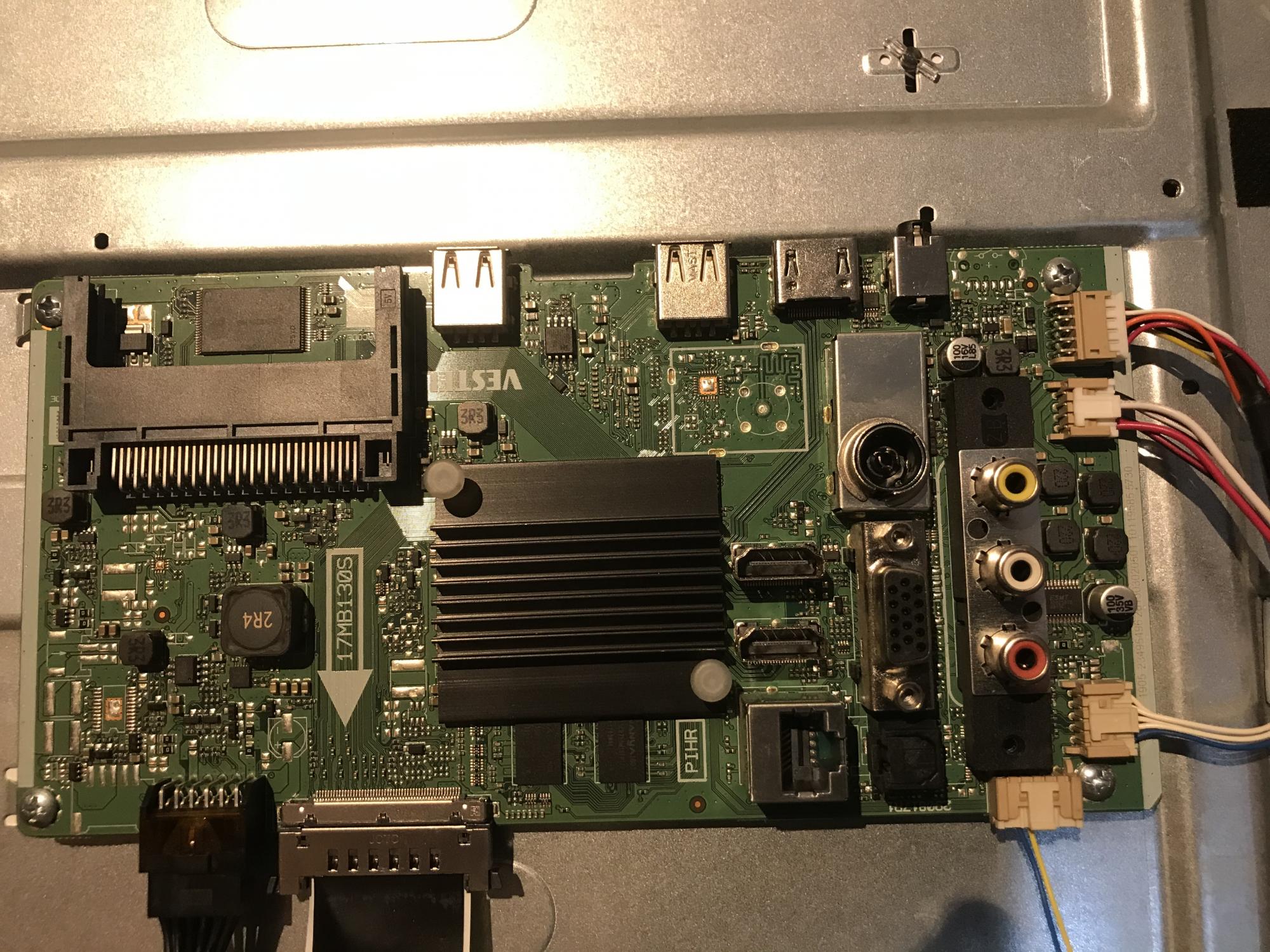

    I have put the code in for the remote control wrong and loaded the profile and now I am stuck at the language screen at first instulation aaaaaaggggggghhhhhhhhh!!!!!!!!!!!!!
    VESTEL 17MB130S BOARD
    I changed it to KAS49128 which is a Panasonic r/c but I now think that is just a model number for the r/c and not the correct code?, I was using it on RCA_43XX_RC5 UNIVERSAL R/C
    FUCK, Please tell me there is a way out of this as I have tried Vertual remote and usb mouse and neither worked??? when I had a keyboard last time this happened it moved the cursor around but the enter key did not select a choice, in fact not one key on the whole keyboard selected a choice so I was stuck then, I have tried every code in the universal remote and it won't work so I think I have frosen it now!!! BOLLOX I AM SUCH A DICK HEAD.
    PLEASE HELP???
    If any one knows a way out please help, even if the board has to come out.
    I have firmware files to re-flash or download it onto board but no ok or enter key to get it to accept the software at first power on??? and I changed the profile back to the one I was using but also cant get into it to upload them???
    Help Please????!!!!!!! Lee.

    again notice this. yours mb130_hwprofile.bin you uploaded over here.. it show under USBPorts -- Number 0x00000001 mean the finlux firmware had only one usb.. infact yours tv havve 2 or more i guess.. so only one USB socket will work... this why you need to use usb hub so you can try the mouse and usb of firmware at same hub.. ( working socket)
    so try this to play OK key on the tv in order to flash complete firmware again hope this will help
    1- use wired USB mouse in the tv and press on the mouse the left Key ( keep press ) while you plug the tv in wall socket.
    2- connect the tv with LAN cable , and download from google store Vestel Smart Center to use the net work remote OK key.
    your tv are blind now.

        tools need the IP address of the tv. but as you are now at first page of first installation i think the TV will signed to the IP only after passing Network installation.
        this why you can use USB to UART adapter or also programmer if you have CH341A by changing the jumper to become serial adapter.
        using the TV RX to Adapter TX & TV TX to Adapter RX. you will be able to flash firmware... or switch the ftp on all by command..
        best place for you xda-developers forum for example. you will find allot of stuff to learn how to.

          picture of my board.
          Lee.

            easy to find the rx and tx and connect serial to communicated instant of remote control by command
            see attached pdf which command to send via rx and tx points to take full control on the set.
