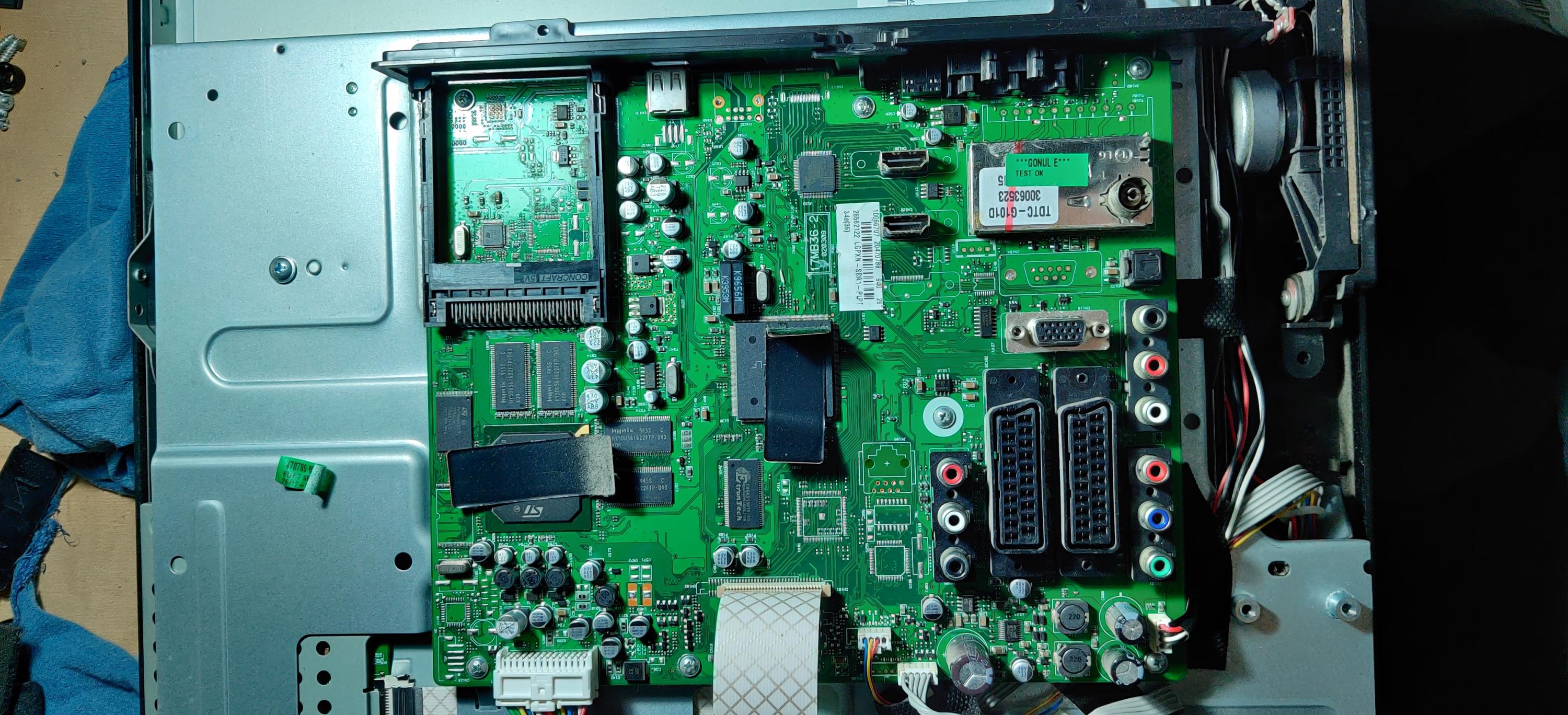

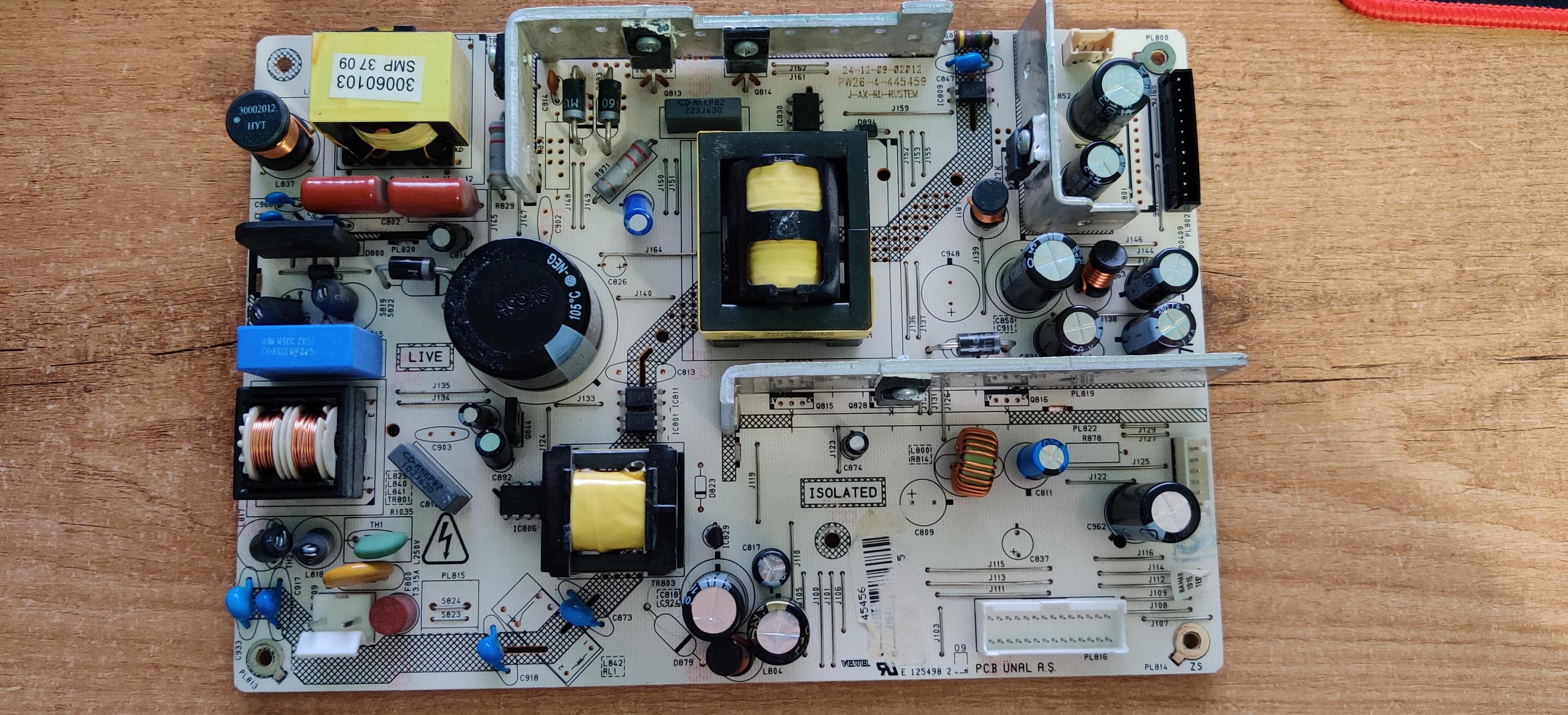

            Can we see good clear straight shots pictures of the boards so we can see what we are dealing with?
            What is the power supply board number?

              • rafa805
                • Oct 2013
                • 19
                • Portugal
                Re: Vestel 17PW26-4 V.1
                Sure, here they are.

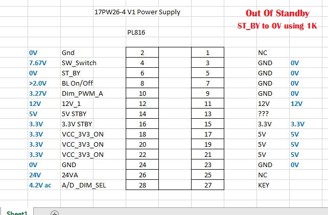

                    With the mainboard disconnected from power supply jumper ST_BY to +5V using a 1K resistor. Then check for +12V & +24V.
                      If the schematic in post #7 is matched to this power supply board, the ST_BY (PS-ON) is active low, so if you run the power supply board by itself without any pull-up resistors, all the switched power supplies output should be present.
                        Well I can tell you that doing this in pins 11 and 12 I get 12.1V and in pin 26 I get 24.5V. what does this tell us? Main board issue?
                          So it looks like your power supply is working.
                            If that is the case, then the switched power supplies section are working, but the schematic does not match your board.
                            If you have all the board connected back together, what DCV do yo have on the ST-BY (PS-ON) pin when TV is off and when TV is turned on?
                              Let me rectify that. Those values where when I plugged the resistor between ST_BY and GND. Now I did it again but this time like you said the second time, between ST_BY and +5V and now I get 22.47 on pin 26, and on pins 11 and 12 it keeps changing constantly from 0 to around 5/6 volts, it almost feels like it's increasing and then suddendly it drops to 0.
                                I am confused, so if you put the resistor between ST_BY and GND you will get steady output from all the switched power supplies, correct?
                                But if you put resistor between ST_BY and +5V then the switched power supplies output are not on steady, correct?
                                  Precisely!
                                  With the resistor in ST_BY to GND in pins 11 and 12 I get 12.1V and in pin 26 I get 24.5V;
                                  With the resistor in ST_BY to +5V I get 22.47V on pin 26, and on pins 11 and 12 it keeps changing constantly from 0 to around 5/6 volts.
                                    If the supplies are correct when ST_BY is connected to ground then that will be correc way. I had it the wrong way round. So Budm has given the correct method for testing.
                                    Edit
                                    Found some notes I made in the past.
