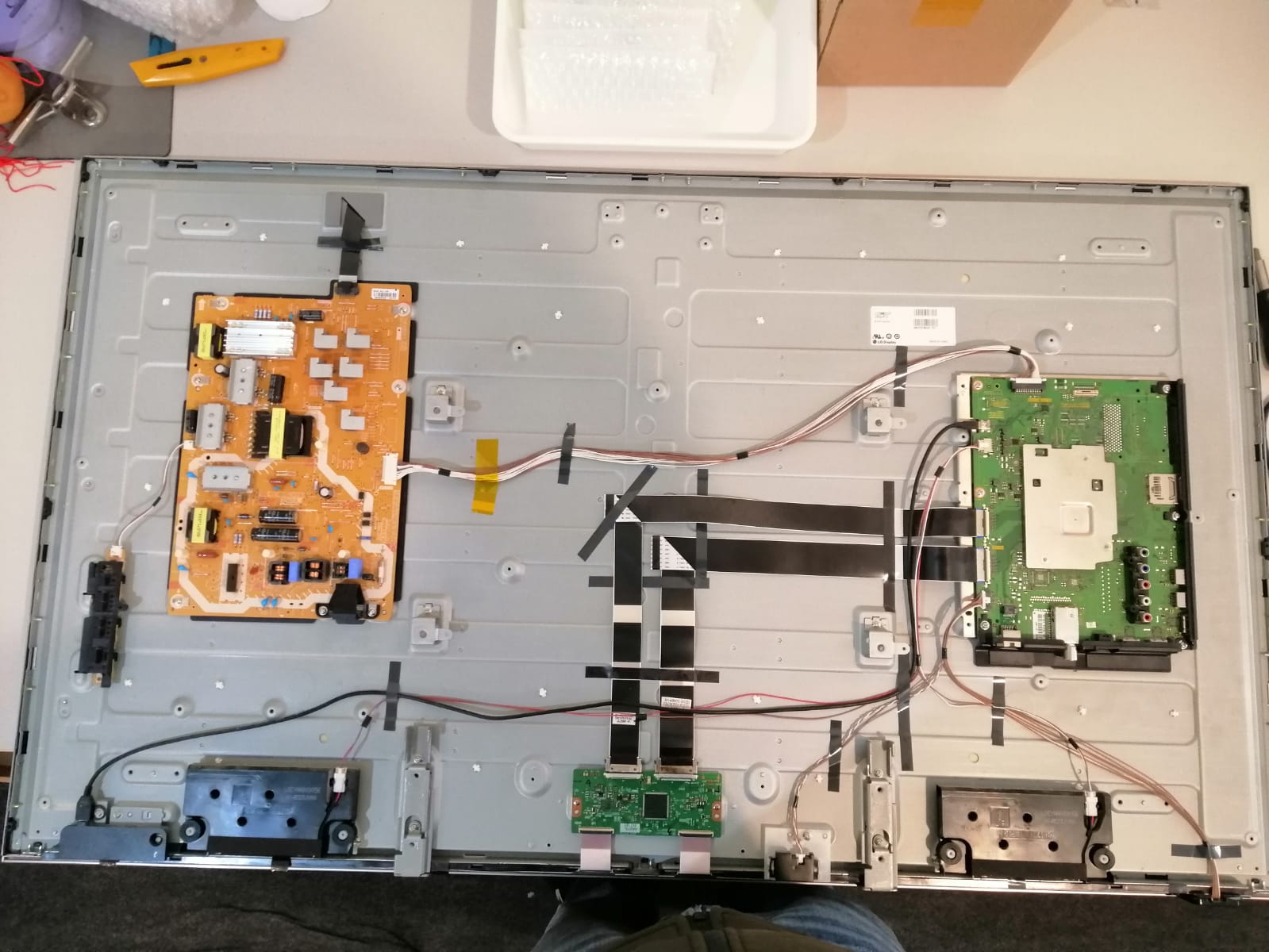

    Hi, I am new to TV repair and I have Panasonic TH-50AS700 TV to repair. It goes off when I change the HDMI cable or sometimes it goes off itself after some time, say half an hour. Once it goes off, the red bulb blinks continuously (should be a single blink) and can't turn on using the remote. When I turn off from the wall, it works again.
    I tested LEDs without opening the case by giving supply of a Chinese LED tester via a ribbon cable. all inputs yields the same voltage. Does that say all LED strips are good?

          Does it stay on longer if you reduce backlights to 50% or less?
          The LED tester you have probably puts out 30mA not in the hundreds as in operation in TV.
          What inspection and Voltage testing have you done when TV works and when it does not work?
          Can we see the pictures of the whole backside of the TV showing all the boards so we can see what we are dealing with?

            1 blink code on a Panasonic is bad backlight so you likely have an intermittent LED in the string that is failing at higher current than your LED tester can put out and when it warms up. Take Budm's advice and lower the backlight level to see if it stays on longer. Also turn off any ambient light sensor setting that could crank up the backlight in a bright room.

              Re: Panasonic TH-50AS700 - Can I rely on LED tester results?
              It was in 60 Backlight and I increased it to 100. It went off in about 10 min. Now doesn't come on and red light keep on blinking.
              An image of the boards of the TV we are working attached herewith.
              What kind of reading should I take?

                It looks like you caused an intermittent LED to fail completely by turning up the backlight level. Recheck your measurements with the LED tester. A one blink code can be confusing since it looks like its just blinking.

                        Say if there are 4 output pairs from the PSU to backlight, if all pairs give the same voltage for LED tester, can't we predict that at lease at that particular moment strip sets are working equally? intermittent LED failure are a different case.
                          So at this point can you still get the TV to come on and stay on long enough for you to get to the user menu to be able to turn down the backlights level to as low as you can?
                          In post #1: When I turn off from the wall, it works again.
                          BTW, can I see good clear straight shots of the whole power supply/LED driver board?

                            Intermittent LEDs are tougher to track down with a low current LED tester. Clues are slower to turn on, flickering, or reading higher or lower voltage. As indicated before, a basic LED tester puts out around 20-30mA while your TV will run at 300mA or more.

                              Thank you for very useful explanations. I am planning to replace LED strips. Before doing that. I got reading from backlight connector using the LED tester (after disconnecting from driver).
                              1st pair: 28.1V
                              2nd pair: 28.2V
                              3rd pair: 28.2V
                              4th pair: 26.4V (about 2V difference)
                              5th pair: 28.2V
                              6th pair: 28.3V
                              The only issue is buying LEDs from this part of the world.
                              Can we make a dummy set of portable backlights (for different sizes) to make troubleshooting easy since replacing LED is a time consuming process?
                                That 4th pair looks suspicious. Try leaving the LED tester on that pair for a long time and see what happen to the Vf reading.
                                So the strip show about 28.2V Vf, driving the LED at 30mA will give 3V LED Vf of about 2.8V (or 5.6V for 6V LED), so the LED string has either ten 3V LEDs or five 6V (Dual LED) LED's.
                                If you have CV/CC bench power supply that can go up to 30V Min and min current of 300mA then you do true drive current through each LED string to test, start at 100mA first.

                                    I opened the backlight and found that one LED is not working in 4th pair.
