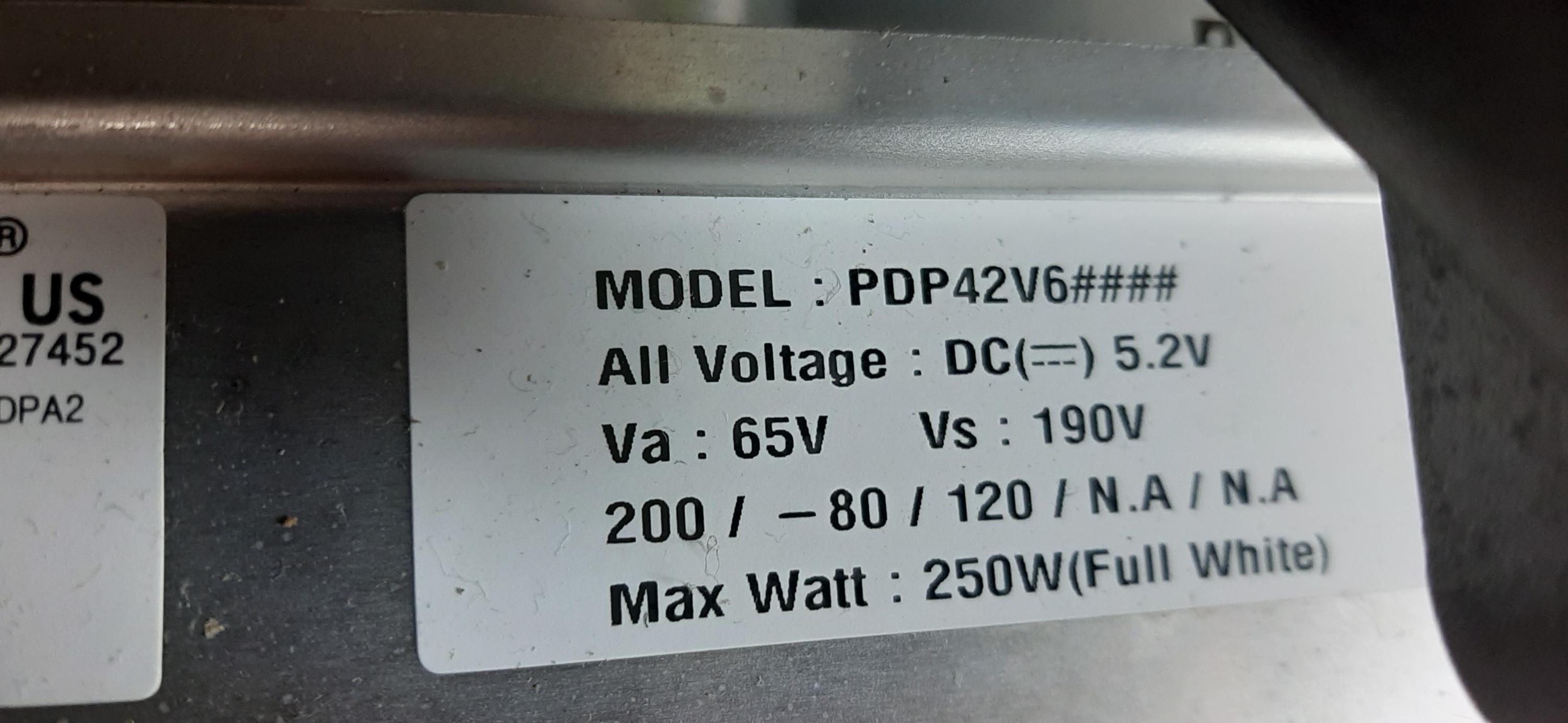

        I took the back cover off, and checked the voltages to the sticker on my panel: Vs: 190v, Va:65v
        Vs: Was 187v, so i adjusted to 190.1v and it's now better but it still flickers a little bit.
        Va: Was 65v, OK.
        Other Voltages:
        VSCW: 115v
        -Vy: -90v
        VSetup: 219v
        NO bulged capacitors were found in all boards.
        BTW, it's a PDP42V6 screen
          Va: Was 65v, OK.
          Other Voltages:
          VSCW: 115v
          -Vy: -90v
          VSetup: 219v
          Adjusted Some voltages. Still flickers and no voltage change while flickering.
          VSCW: 115v , Adjusted to 115v
          -Vy: -90v , Adjusted to -80v
          VSetup: 219v, Adjusted to 200v

            When the flicker occours, use the multimeter on VA and VS, they should be stable, then VSCN, -VY and VSetup.
            If VA and VS are not oscillating more than normal with the flickering the power supply is not to blame, when the screen turns white it's normal for them to drop 1 or 2 volts.
            Does it flicker on cold boot with a white screen? Or only when it's hot? On that video, was it losing the signal also and displaying channel information and going into menus by itself? If then it could be bad mainboard solid capacitors.

                All voltages are rock solid when the ficker ocurrs, even the 15v supply on the Y Board.
                I found out that if i follow the sticker voltages it flickers a lot, so i reverted VSCW, -Vy and VSetup voltages back to "factory default". So the only adjustment I made was the Vs from 187v to 190v.

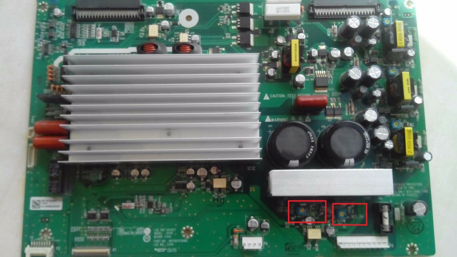

                BTW what does the SET_UP and SET_DW potentiometers adjust on the Y board?

                  SET up/down are for adjust the final picture of the tv, they come calibrated from factory for each display, it messes with the black levels, if you adjust them off the optimal point it will increase image retention on the panel and introduce random pixels on white and black backgrounds.
                  At this point, maybe the logic board is going bad, or some capacitors (these solid capacitors do not bulge, they dry and stop working properly), cold soldering joints on Y-SUS or Z-SUS, notice anything on visual inspection?
                  On Z-SUS there is one trimpot for adjusting probably Z-BIAS, but there is no Z-BIAS test point provided nor voltage information on the panel sticker.
                  Can also try slowly increasing or decreasing -VY, VSETUP and VSCN one at a time and see which one affects the flickering the most.
