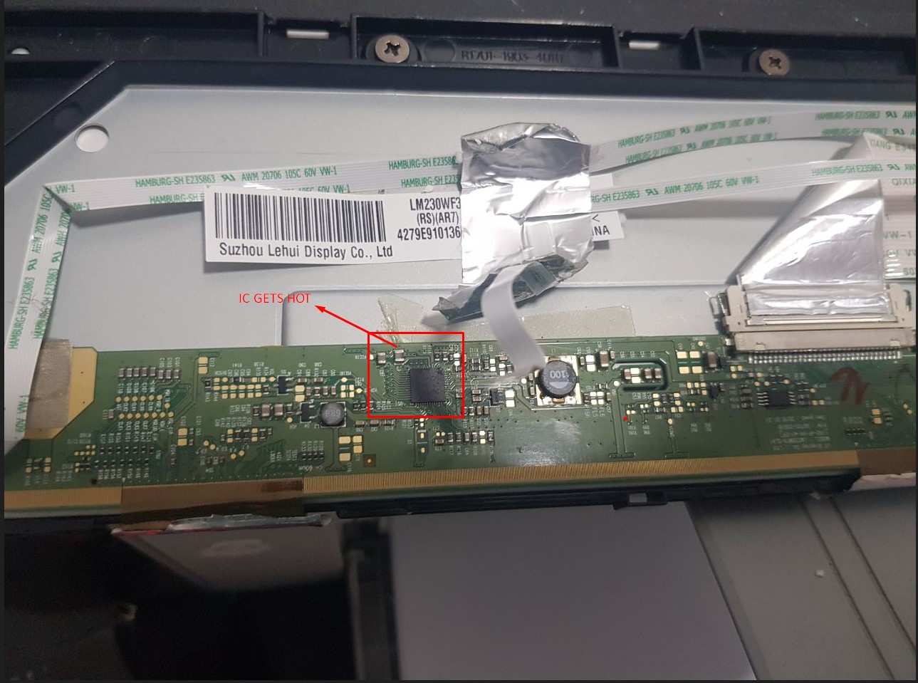

    Acer SA230 Flickering Issue
    I got this flickering issue as in this video
    https://drive.google.com/file/d/1MHr...hcpjotoN_/view
    The monitor keeps flickering for like 5 seconds and it gets solved after 5 seconds. First I thought it is the power/display board so I purchased one from eBay but the issue persisted.
    Checking the board where cables are connected I found out the SM4047 IC is getting hot.
    The image of the board is attached. Is there anything else I should check before I order the IC?

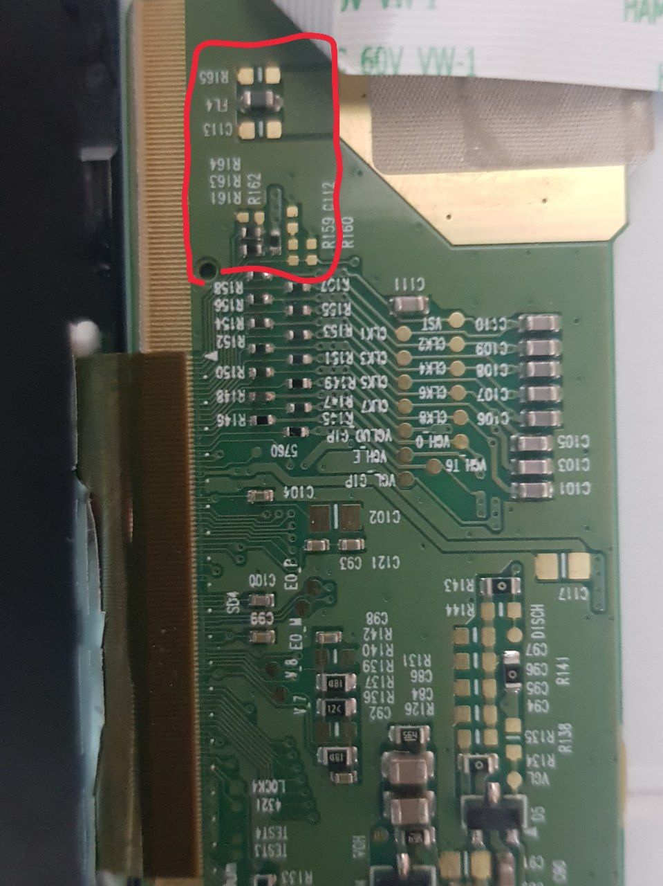

    Re: Acer SA230 Flickering Issue
    Checking further I found out all of these marked components are shorted to the ground. shall I start removing the components before removing the IC?
    Thank you
