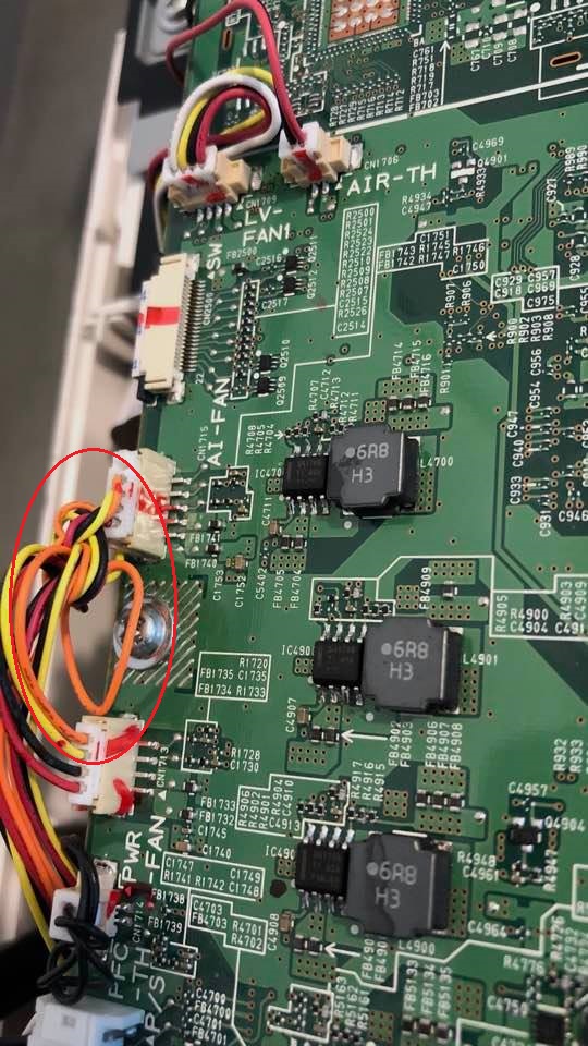

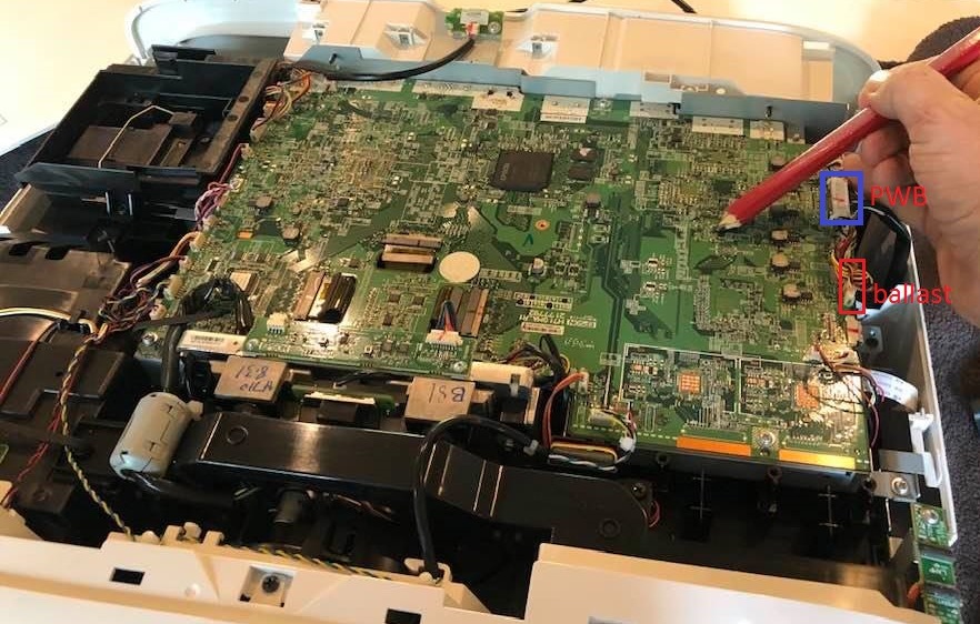

Re: Epson 5040UB Projector No Lamp Strike Stuck in Startup - Blinking Status/Lamp Lig
Thanks for the update. I wonder what component he was referring to in the optical assembly, doesn't seem to be a lot there. I might send him an email.
Epson 5040UB Projector No Lamp Strike Stuck in Startup - Blinking Status/Lamp Lights
Re: Epson 5040UB Projector No Lamp Strike Stuck in Startup - Blinking Status/Lamp Lig
It's honestly not looking good. I am pretty sure the issue is in the main microprocessor. I can jump start the ballast and the main power supply is fine. That main IC is getting very hot and I can't find any other parts that are relating to the issue.
To replace that IC is not an option. It's not available and it has software flashed on it that I can't get. The best option is an entire mainboard/optic assembly which is pretty pricey. I can look at used but then we're not knowing the history or how long it will last. Im OK with used electronics but used optics is another story.Last edited by vestaviascott; 02-07-2022, 11:37 AM.Leave a comment:
Re: Epson 5040UB Projector No Lamp Strike Stuck in Startup - Blinking Status/Lamp Lig
Have you had any luck with this projector? I have mine torn down. I've tested most components on the power supply, but haven't found anything wrong with it yet. This is a very common failure on these projectors. It'd be great if we could figure it out.Leave a comment:
Re: Epson 5040UB Projector No Lamp Strike Stuck in Startup - Blinking Status/Lamp Lig
thanks budwich to share with us yours experience with yours projectors.. here as most new PROJ. the ballast communicated to MB as receive and send digital signal 0/1, this cant be tracked at home user equipment's. so the only left typical component check at ballast and PWB.
i am afraid this EPSON had during normal projection the LAMP blow up.. i can tell this set was open before OP open it.
so i will let the talk about what will happen if lamp blowing up at projection... let hope some things not serious. depend on OP work and clear photos always provided over this threat.Leave a comment:
Re: Epson 5040UB Projector No Lamp Strike Stuck in Startup - Blinking Status/Lamp Lig
It appears to be the original projector lamp (or atleast it say "EPSON" on the housing). I'm not following you I'm afraid. You said you could tell the projector has been opened up before I opened, it. How?
You also said the lamp "blew up" exploded during normal operation. How can you tell?
2- about lamp. if impervious users ignore lamp change warning several time depend on the use and how many time the lamp used hours reset via after service menu.. the FW will send high pules to kill the lamp ( command kill you before kill me ) lol... this you have the AY part at high pules which become warm.
well all above theories but of sure i think it was opened and lamp explosion
don't lost the hope... nothings impossible.Leave a comment:
Re: Epson 5040UB Projector No Lamp Strike Stuck in Startup - Blinking Status/Lamp Lig
What does "PWB" stand for? Nevermind, I see above you remarked its the "Power Board".Last edited by vestaviascott; 08-09-2020, 02:43 PM.Leave a comment:
Re: Epson 5040UB Projector No Lamp Strike Stuck in Startup - Blinking Status/Lamp Lig
I really appreciate your help, but I'm not following you. The original bulb may in fact be blown, but it does not appear to be "Blown Up" in the literal sense. The glass is fully intact.
It appears to be the original projector lamp (or atleast it say "EPSON" on the housing). You said you could tell the projector has been opened up before I opened, it. How?
You also said the lamp "blew up" exploded during normal operation. How can you tell?Last edited by vestaviascott; 08-09-2020, 02:45 PM.Leave a comment:
Re: Epson 5040UB Projector No Lamp Strike Stuck in Startup - Blinking Status/Lamp Lig
Interesting. I could detect no signs of it being opened before. The screwheads I removed appeared to be virgin. Can you tell me what telltales you are referring to (both opened before AND "blown up" lamp) so that I may check closer?Leave a comment:
Re: Epson 5040UB Projector No Lamp Strike Stuck in Startup - Blinking Status/Lamp Lig
Beyond that maybe diah or others know what a typical ballast takes for input and you can possibly do some careful measurements in and around that connector to see if those are correct... careful is the operative word although I wound not expect very unusual / high voltages there.... but you never know.
i am afraid this EPSON had during normal projection the LAMP blow up.. i can tell this set was open before OP open it.
so i will let the talk about what will happen if lamp blowing up at projection... let hope some things not serious. depend on OP work and clear photos always provided over this threat.Leave a comment:
Re: Epson 5040UB Projector No Lamp Strike Stuck in Startup - Blinking Status/Lamp Lig
you still have allot to do lol... you need to unplug all sockets from MB ( main boards ) and the 3 LCD ribbon to take out the MB and to have access to the PWB ( power boards ) and the ballast.
NOTICE: don't scare about so many sockets.. EPSON arranged them by size and cable long too.. so no way to miss up with sockets when you put every things back.
There is a video of a similar projector teardown here that I'm taking notes on:
https://youtu.be/fN7dAm7DrWELeave a comment:
Re: Epson 5040UB Projector No Lamp Strike Stuck in Startup - Blinking Status/Lamp Lig
please for future photos to upload use uploads attachments not the external links for photos.
you still have allot to do lol... you need to unplug all sockets from MB ( main boards ) and the 3 LCD ribbon to take out the MB and to have access to the PWB ( power boards ) and the ballast.
NOTICE: don't scare about so many sockets.. EPSON arranged them by size and cable long too.. so no way to miss up with sockets when you put every things back.Leave a comment:
Re: Epson 5040UB Projector No Lamp Strike Stuck in Startup - Blinking Status/Lamp Lig
good work... not sure it helps me lots as I have only had my optoma apart for general cleaning and not really looking closely at boards and such. Same with my DLP rear projection sammy with LED light sources. Anyway, I was hoping that there some markings for some basic voltages in and around the areas to do simple checks. :-(
Not sure how easy it is for you to cause operation, in terms of interlock switches and such and do a few more cable unplugs to check system response / light outcomes... although it seems to be pointing at the ballast / bulb area. IF you can, I would unplug the ballast connector which I am hoping is just power / control to the ballast (while the output of the ballast goes directly to the bulb / connector somewhere else). IF possible, what is the result? Beyond that maybe diah or others know what a typical ballast takes for input and you can possibly do some careful measurements in and around that connector to see if those are correct... careful is the operative word although I wound not expect very unusual / high voltages there.... but you never know.
In general, the only way that I have seem a "ballast / bulb" problem overcome, it to have a known working ballast and bulb, then use a "substitution method" to determine which is at fault. Having said that, reads appear to indicate that there are some component level checks (non- powered) in the ballast that might indicate a failure if out of spec. It would appear that "general" ballast inpit voltages are in the <400v dc range so that might be a useful check.Last edited by budwich; 08-09-2020, 09:10 AM.Leave a comment:
Re: Epson 5040UB Projector No Lamp Strike Stuck in Startup - Blinking Status/Lamp Lig
THANKS! Here are the remaining close-up photos not posted above:
The lamp housing showing a portion of the ballast below (Black/White/Black wires are the lamp door switch):
Ballast below lamp housing and lamp blower fan:
Last edited by vestaviascott; 08-09-2020, 08:14 AM.Leave a comment:
Re: Epson 5040UB Projector No Lamp Strike Stuck in Startup - Blinking Status/Lamp Lig
I've attached a few closeup shots of the areas you indicate. The ballast is actually under the lamp at the top left corner of the photo you referenced. There is also a connector labeled BLT where the black sheathed cable is connected in that area.
Here are the pics of the area's you highlighted on the photo:
PWB?
Ballast? It appears to be labeled as a FAN circuit
Here is a photo of the connector near the lamp marked "BLT":
A photo of the BLT (bottom right) and the hot PWM chip (top right) in same photo shot:
Finally, here is a closeup of the connectors right next to the lamp and above the ballast area:
Last edited by vestaviascott; 08-09-2020, 08:16 AM.Leave a comment:
Re: Epson 5040UB Projector No Lamp Strike Stuck in Startup - Blinking Status/Lamp Lig
picture of some moderate close ups of the connectors areas might help.Leave a comment:
Re: Epson 5040UB Projector No Lamp Strike Stuck in Startup - Blinking Status/Lamp Lig
Leave a comment:
Re: Epson 5040UB Projector No Lamp Strike Stuck in Startup - Blinking Status/Lamp Lig
I made several attempts to get to the ballast, removing as many screws as I could from the components above it but finally had to call it a night. The ballast is under the lamp fan at the very bottom front right corner of the projector. I'm going to research if I can find any instructions on how to get to it short of taking the entire projector apart.Leave a comment:
Re: Epson 5040UB Projector No Lamp Strike Stuck in Startup - Blinking Status/Lamp Lig
OK, so the 200F reading would be normal for this chip then under this circumstance? In that case, perhaps my problem is somewhere else on the board but not necessarily showing up as a thermal tell tale? Also, why do you think the twin IC next to it, also an AY7397, is showing about half the heat signature of this one?
If its not the chip, would you say the most likely issue is the ballast? Or alternately, the replacement lamp I bought is bad? Its brand new, although not OEM and about 1/3 the cost of OEM. But if the issue is the lamp, I would expect the blink code to point to lamp replacement, not internal projector error, so perhaps signs pointing to ballast failure, explains why the lamp not lighting and explains why the chip gets hot due to lamp not lighting? But not an odd thing that this is the only chip on the whole board to react thermally to lamp not lighting?Leave a comment:
Hi guys gooday i have a Epson VS250 Projector that turns on and is also being recognized and detected by the computer when i plug the hdmi cable.The only issue the projector lamp is not working .Are these lamps repairable ? Or i should just forget repairing the lamp and just buy a replacement. Thanks...
by narfhi all,
first of all: i'm a (motivated) newbie, so please forgive me any stupid question i may or may not ask
i'm currently repairing a projector: Epson EB-U42 that doesn't start (no lights, nothing).
what i've found so far:
- the PSU does its job and supplies 12V to the mainboard via the connector.
- shortly thereafter, there is a mosfet (TS420-600B) where i can test 12V on the one side (in the data sheet this side is called Anode), Gate 0V, Kathode shorted to ground
- not far away, there's the first cap with a resistance of 0.7 ohms.... -
by magnetepazzoHi Guys i have this projector emp-x52 when power on the fan spin and lamp go on but after few seconds lamp go off and led temp flashing with fan at maximum speed. I have check the 2 termal temp but are good are 12.51 Kohm. Have suggestion for me ? TKS
by EVAN STUARTSHallo guys I need some help with this Epson projector I turn it on but it stops at power light it does not switch on
Pliz help guyz -
by hardboxNeed some idea of where to start to fix this projector. According to the user manual, when the temp and lamp lights are flashing there is an internal problem which doesn't give me much to work with. Need some input. The fans run for like two seconds when attempting to turn on then goes straight to the error code. Since it's not a lamp, fan or temp error, I'm leaning towards the power supply.
https://www.manualslib.com/manual/74...page=80#manual - Loading...
- No more items.
Leave a comment:
