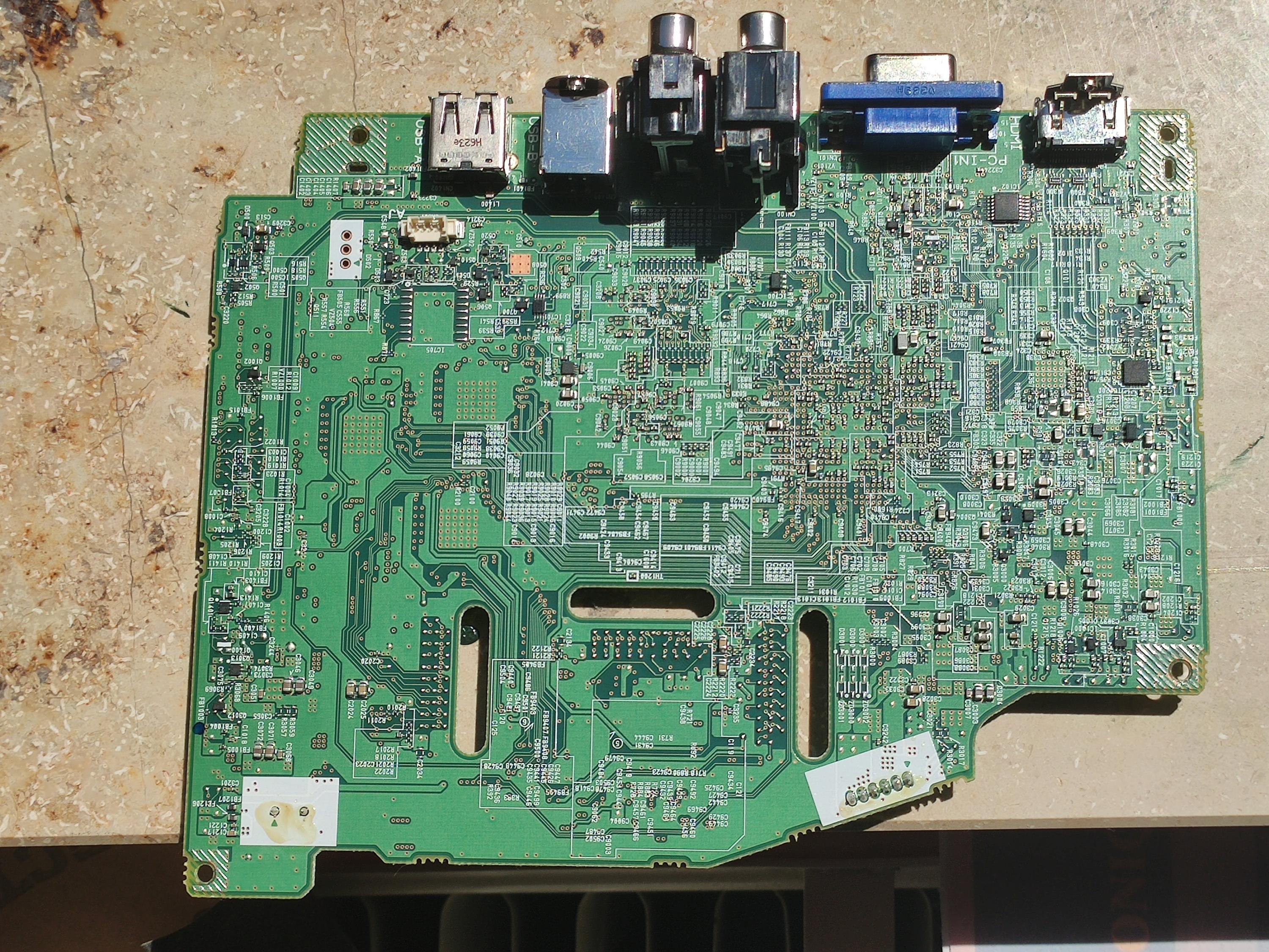

    I have a video projector Epson EH-TW570 that isn't displaying anything. It does power up but the Status LED is alwyas blinking. In the troubleshooting section of the user manual, this means that the projector is warming up. But unfortunately the lamp stays off so the projector can't be warm. The ballast as benn replaced and the previous owner says he replaced the lamp.
    I have found the service manual but it does'nt show the schematics or any testing procedures.
    I hope someone can help me with this
    Edit :
    I've already replaced the two temp sensor with 6k7 resistor but no luck.
    Here is the voltages from the power supply connector on the ballast.
    14,3 V
    14,3 V
    -3,16 V
    3,16 V
    0,414 V

                        would be helpful if you upload very clear photos for the main boards from both sides.
                        • bermo96
                          • Jan 2019
                          • 45
                          • Belgique
                          Re: Projector Epson EH-TW570 not Warming Up
                          Here some pictures of the main board, but unfortunately there is no micro switches for downloading.

                            Start checking all SMT FB parts specially on the downside close to EX FAN and SCI.. this boards had so many fuses need first to go over them.. then back to boot.
                            • bermo96
                              • Jan 2019
                              • 45
                              • Belgique
                              Ok thanks I'll do that.

                                        okay our thought was the boot.. so we have now when you plug it first time at wall socket power LED goes Red as standby. after pressing power the status blinking red and keep blinking..
                                        let trick it by make error.. to see the error section at boot will remark them and give asign or not..such..
                                        1- disconnect main FAN socket and try
                                        2-remove the lamp ( but put back the door )
                                        3- while its on standby.. if you press power on RC it response ? in case yes.. then press freez keep pressing and power it on from the panel switch.. same do it by pressing the menu on RC
