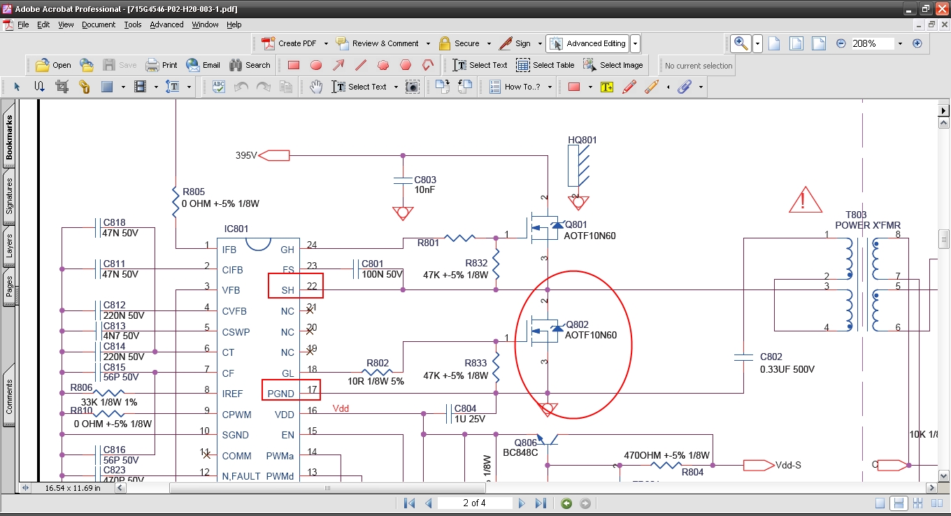

    I just see the IC801 is a UBA2071. Do you have a low resistance between pin 17 and 22 ??? Then the IC would be defective.

        Between Pin 17 and 22 meter says OL so that would be defective ?
        Also this IC is for the backlight ?
        • dick_barton
          • Aug 2015
          • 6642
          • Wales
          Re: Philips 47PFL4606 No Power
          OL on your meter means the resistance is higher than whatever ohm scale you are on. That is its resistance is higher than what you have set your meter to.
            What Voltage do you have on Emitter, Collector, and Base of Q707 when SB is not connected with 1K pull-up resistor and when connected to 1K pull-up resistor?
              Pin 17 (GND) pin 22 (SH) are connected to the Source and Drain of the low side MOSFET, so if that MOSFET is shorted out then it will read as low resistance, so based on your result, there is no low Ohm reading.
              The IC is part of the backlights inverter circuit.

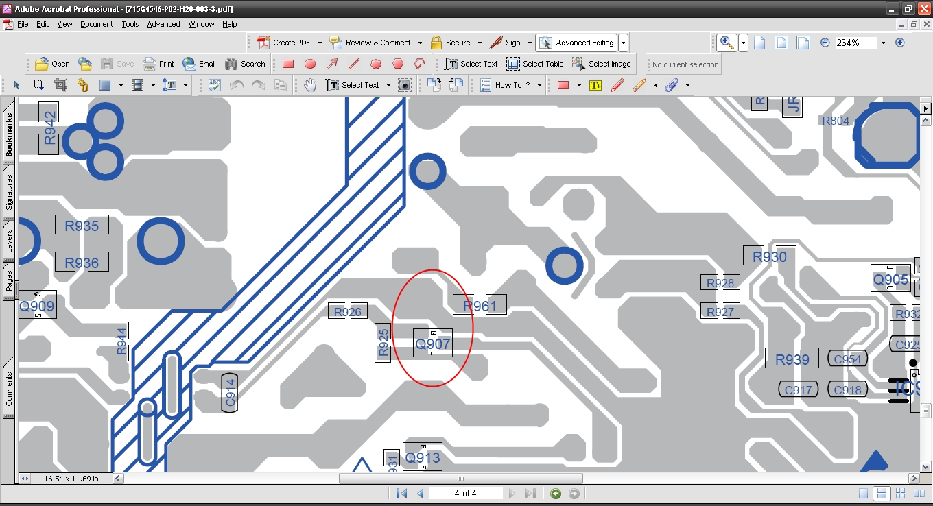

                  Can not find Q707 in the schematics ?
                  What do you mean cannot find in the schematic?
                  It is shown in the schematic of your PDF in post #1.
                  • trunks81
                    • May 2020
                    • 265
                    • Nederland
                    When i look in the schematics adobe can not find part Q707
                      See pictures.Sorry, it is Q907!
