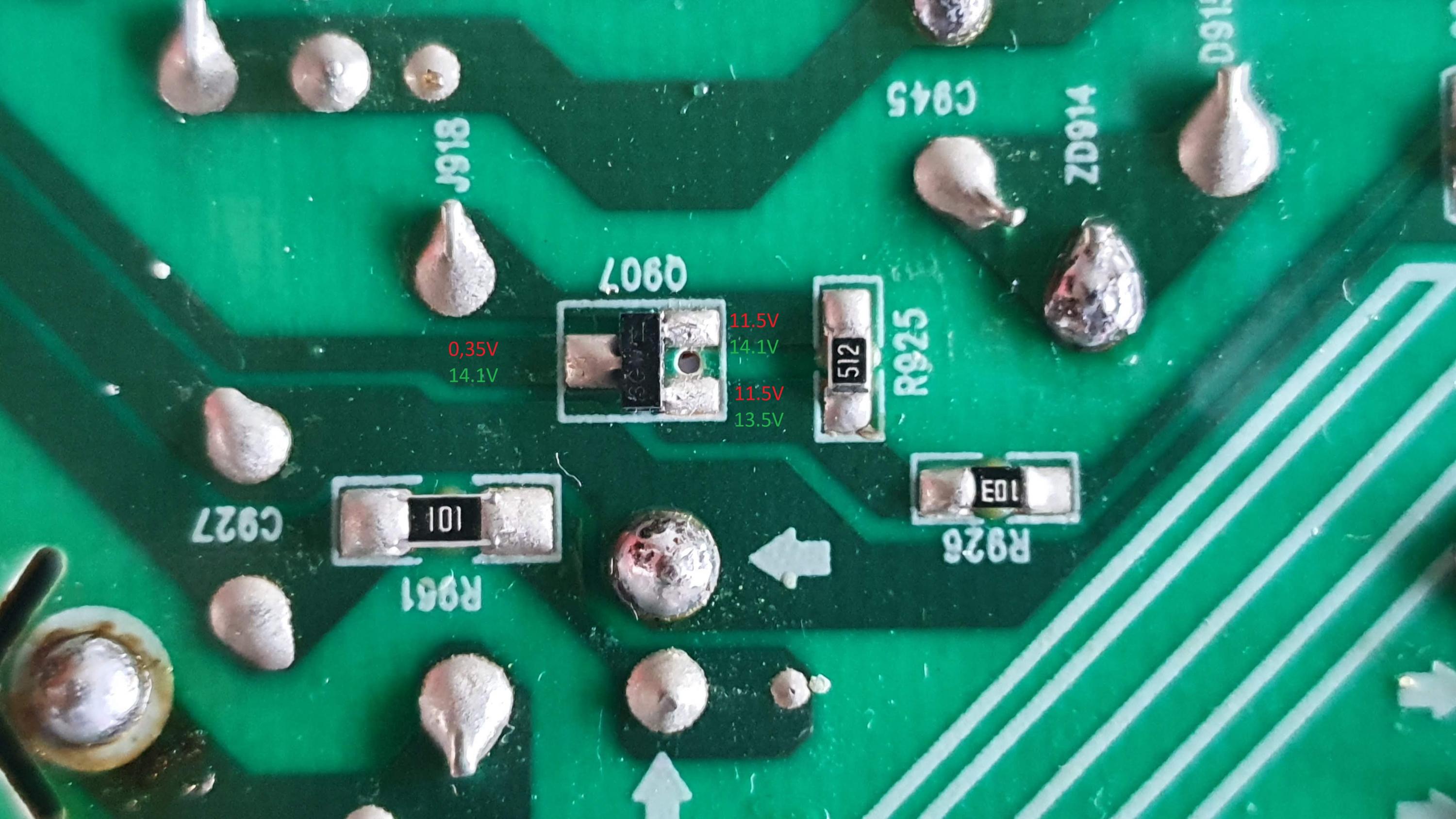

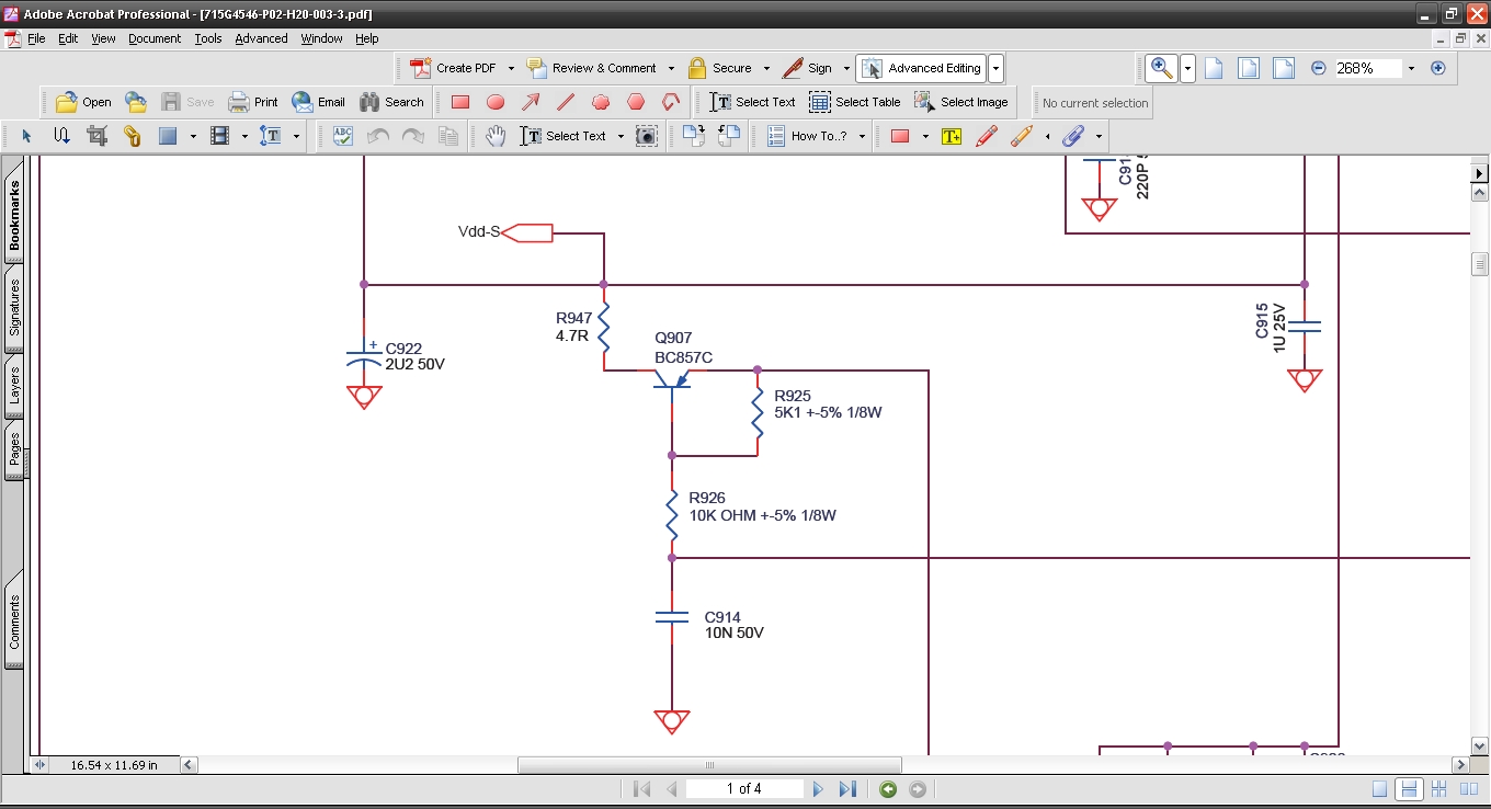

            What Voltage do you have on Emitter, Collector, and Base of Q707 when SB is not connected with 1K pull-up resistor and when connected to 1K pull-up resistor?
                Can not find Q707 in the schematics ?
                  Re: Philips 47PFL4606 No Power
                  What do you mean cannot find in the schematic?
                  It is shown in the schematic of your PDF in post #1.
                    When i look in the schematics adobe can not find part Q707
                      See pictures.Sorry, it is Q907!
                        Hello see attachment for measurement !
                        With the 1K resistor is Red and without is yellow

                            What did you use for meter ground? The negative leg of the main filter cap?
                            If that is what you use then 5V is not going to be enough to run the PFC and SMPS IC, it should be around 15 ~ 20Vdc range.
                            12V/24V SMPS IC901, NCP1271, startup Voltage is 12.6V
                            PFC IC902, FAN6961, startup Voltage is 12.5V
                            You may need to put 1A load on the 5V STBY power supply and then make the measurement again.

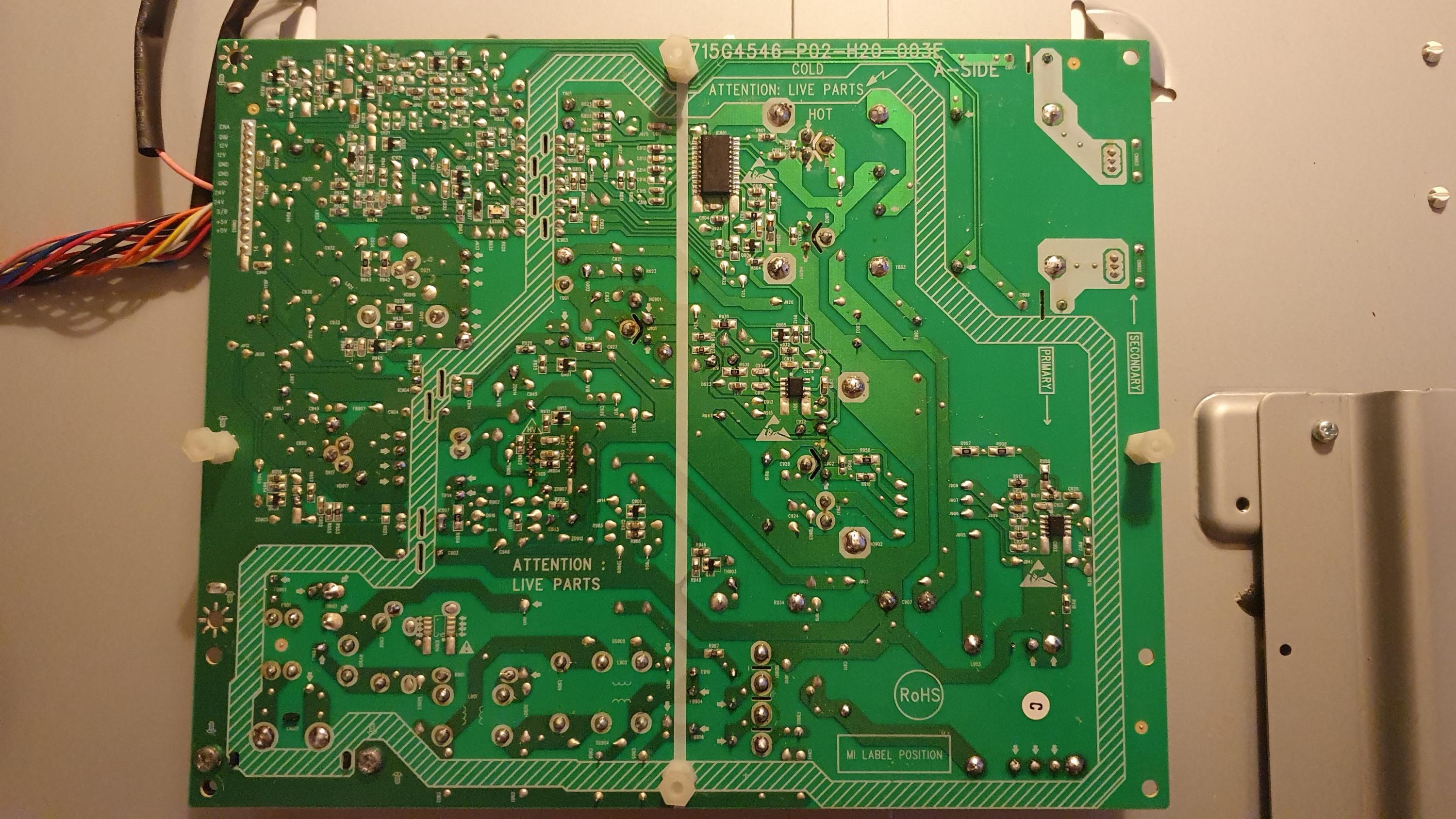

                                  Hello Budm
                                  After your tip to inspect Q908 and R954 ive found an strange brigde to an opto ?!
                                  After removing that bridge the power supply worked again.
                                  See picture for what i mean !

                                    1) Did some one work on this power supply before? I look at pictures in post 1, some one did put solder bridge (you can see the flux residue) on the LED side so power supply no longer have feedback to regulate the output. What kind of repair guy do such a thing like that?
                                    2) Please check the 5VSTB when TV is off to see what you get, it should be less than 5V if my calculation is correct and it should jump up to 5V when PS-ON is present.
                                    3) I would start another thread just make sure to put down the model number and the problem on the header, it is always good to put down the chassis number too.
                                    4) So what Voltages do you have now on Q907?
                                    5) So does the TV work now?
                                    6) I wonder now if the original IC905 may be OK.
                                      1.I guess someone did indeed work on it.. dont really know who and why they did make an bridge on that opto.
                                      2.When tv is off the voltage is 4.6V and when PS-ON it is 5V
                                      3. Going to do that.
                                      4. See Attachment !
                                      5.Looks like it going to put the tv on long term test.
                                      6.Iam wondering that to only the parts is allready in the bin
