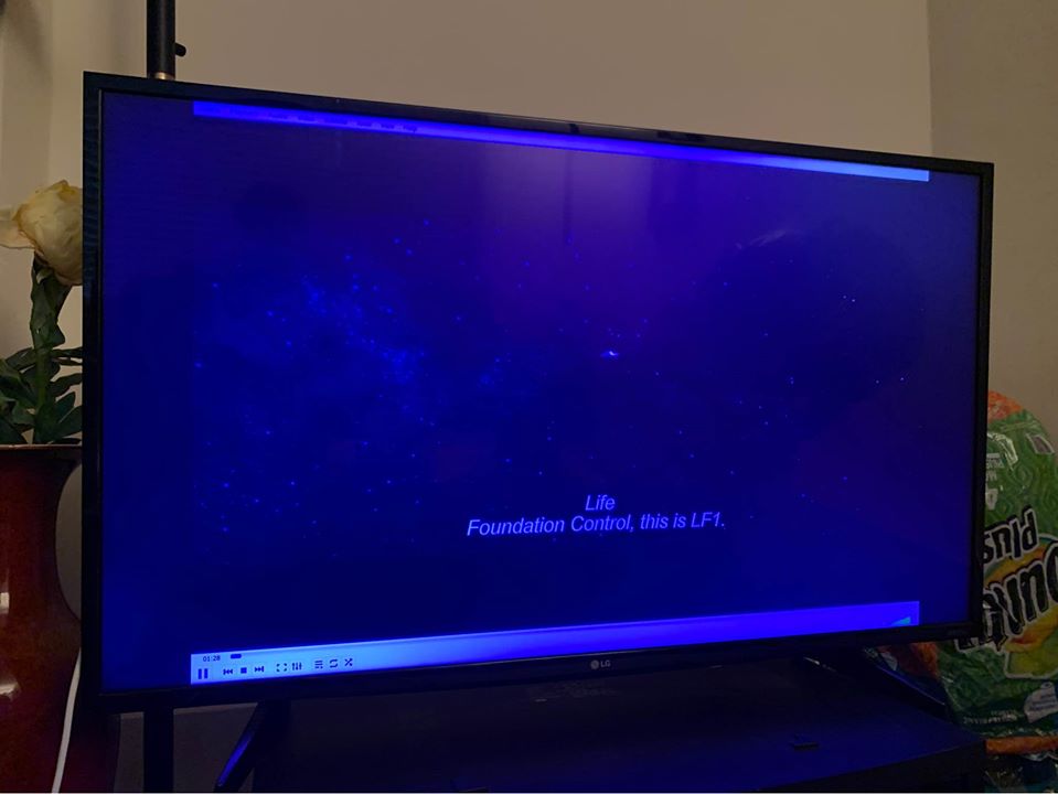

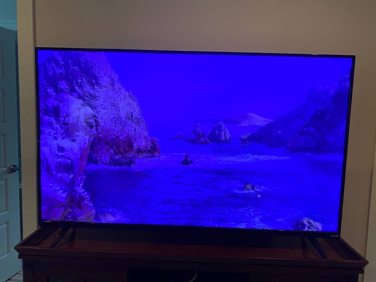

              Setting should be for backlight (not brightness). Also turn off any ambient light sensor feature than may turn up the backlight in a bright room.
              Just picked up a Vizio D58U-D3 with blue backlights. It's going to take months to get the strips delivered by epacket from China so I put it away for now. Also got a repair job today for a 43UH6100 with blue backlights. Found strips on ebay so can get delivery by speedpak which currently takes around 2 weeks.
