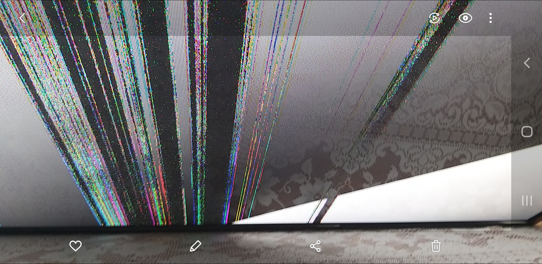

    Samsung PS51E450 screen issue

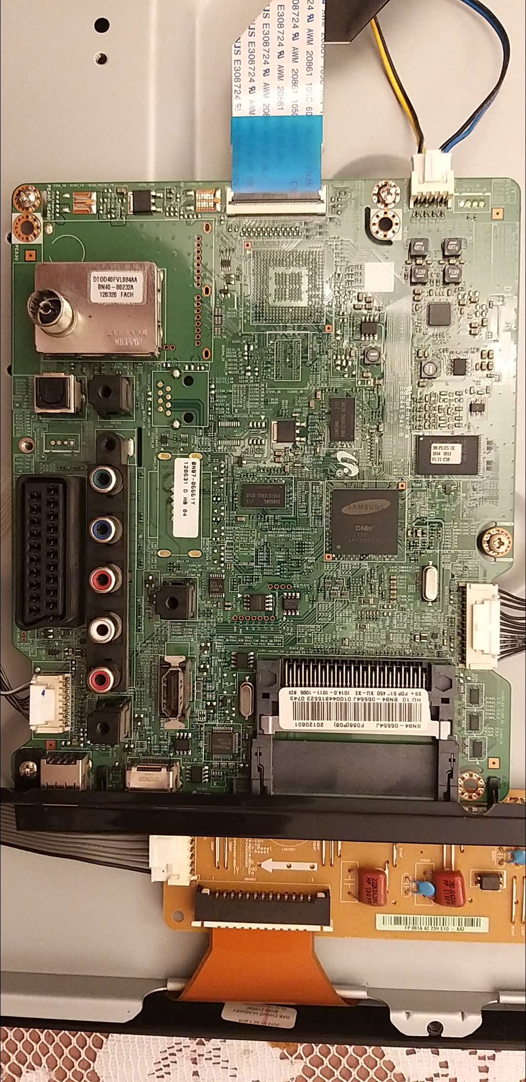

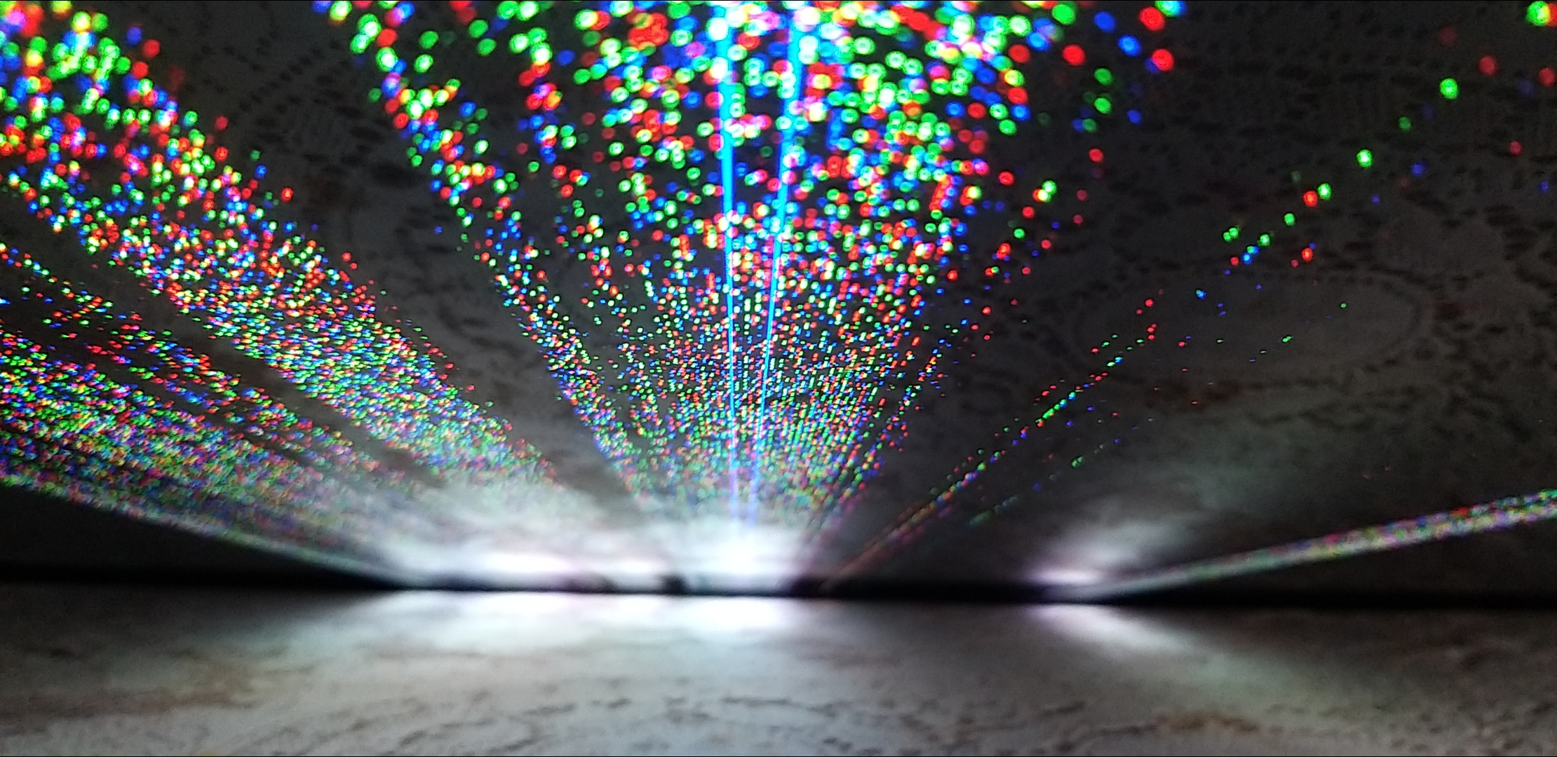

    Whats the general thoughts on this one?
    Plasma panel!

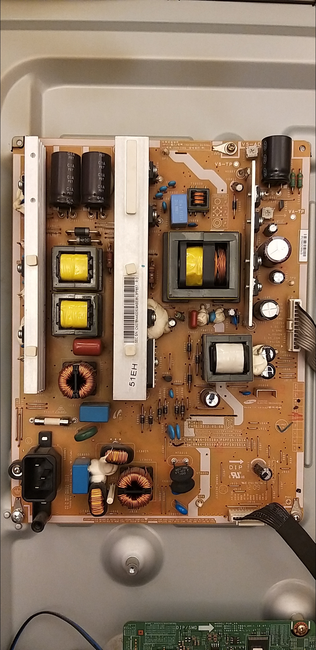

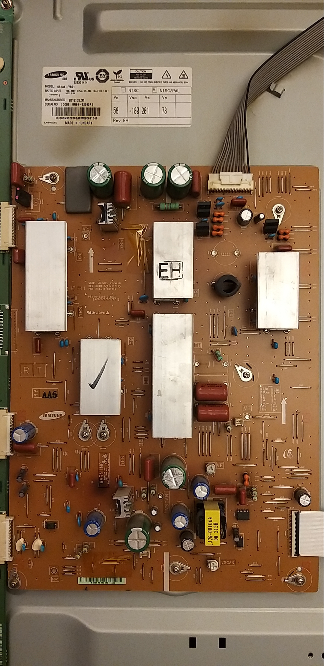

    Re: Samsung PS51E450 screen issue
    Va 58v
    Vsc -180v
    Vs 207v
    Ve not getting 78v, jumping around 200,400,600 etc...
      Should I adjust Vs down as its reading slightly high?
      Strange, it is reading 201v now!

      • dick_barton
        • Aug 2015
        • 6643
        • Wales

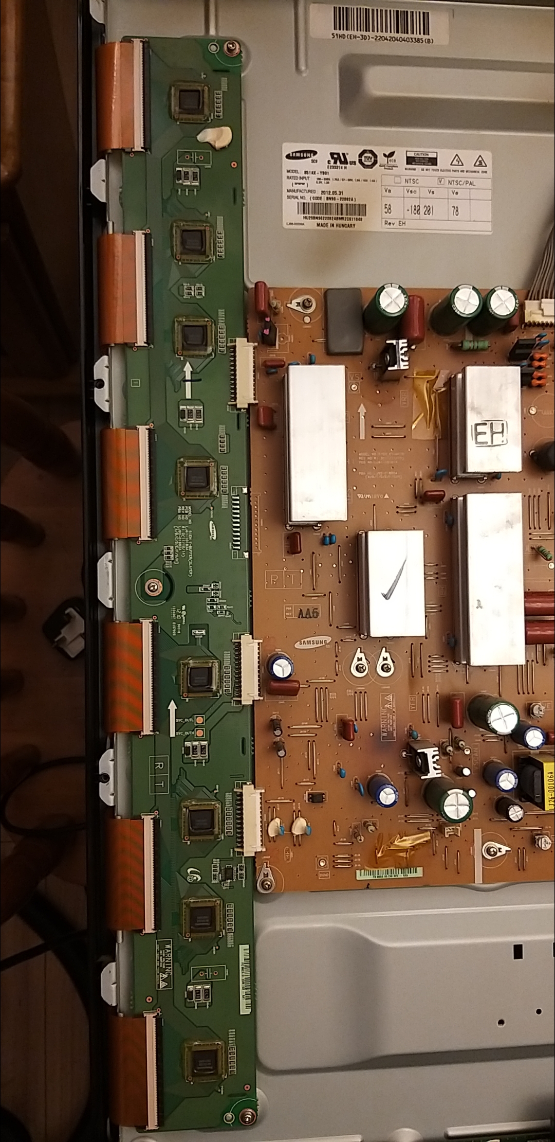

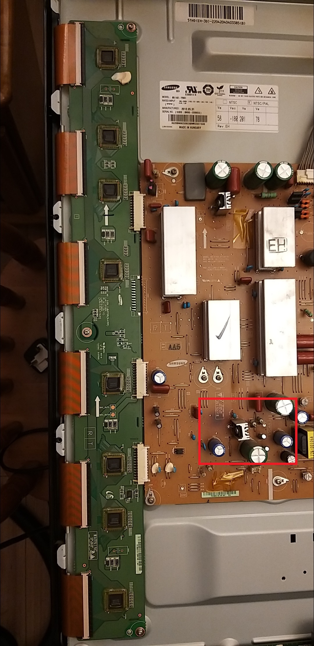

        One area looks like it's been getting really hot. I would check the components on the underside and all the solder joints in that area.
        Have you tried running just the test pattern check.
        • notallbad
          • Oct 2012
          • 1190

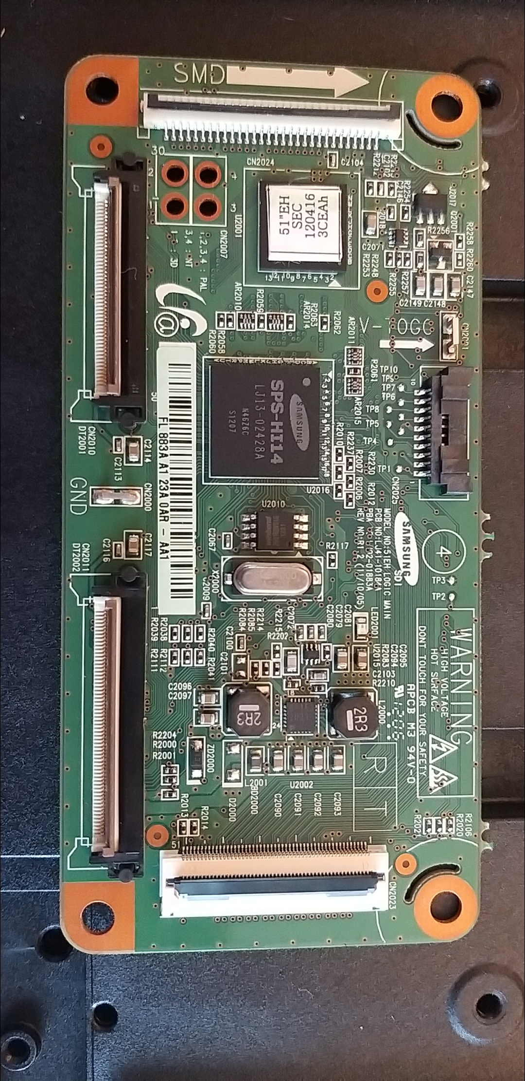

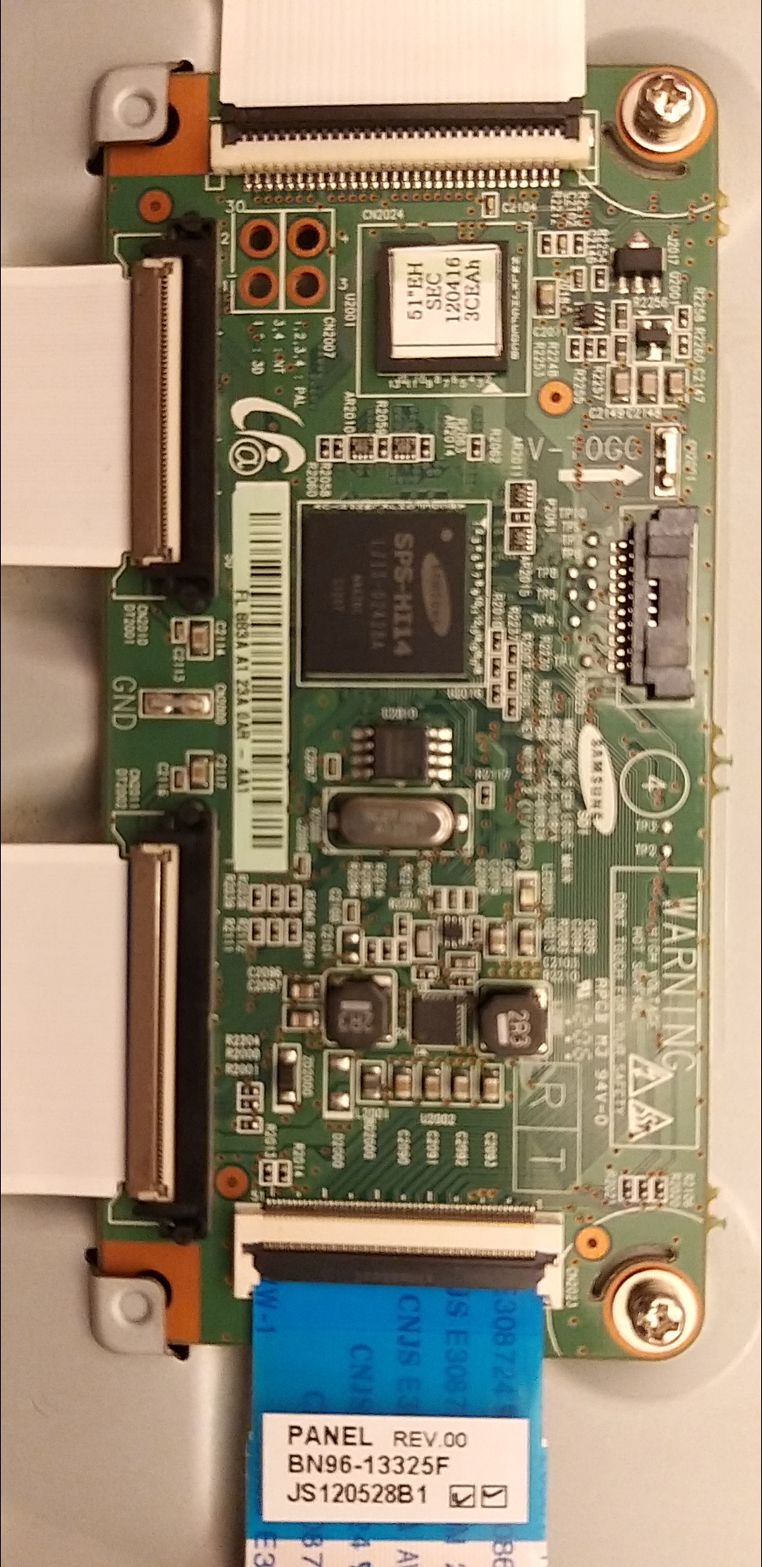

          How do I get the test pattern check on?
          Yh, I did notice the scorch mark, will check it our.

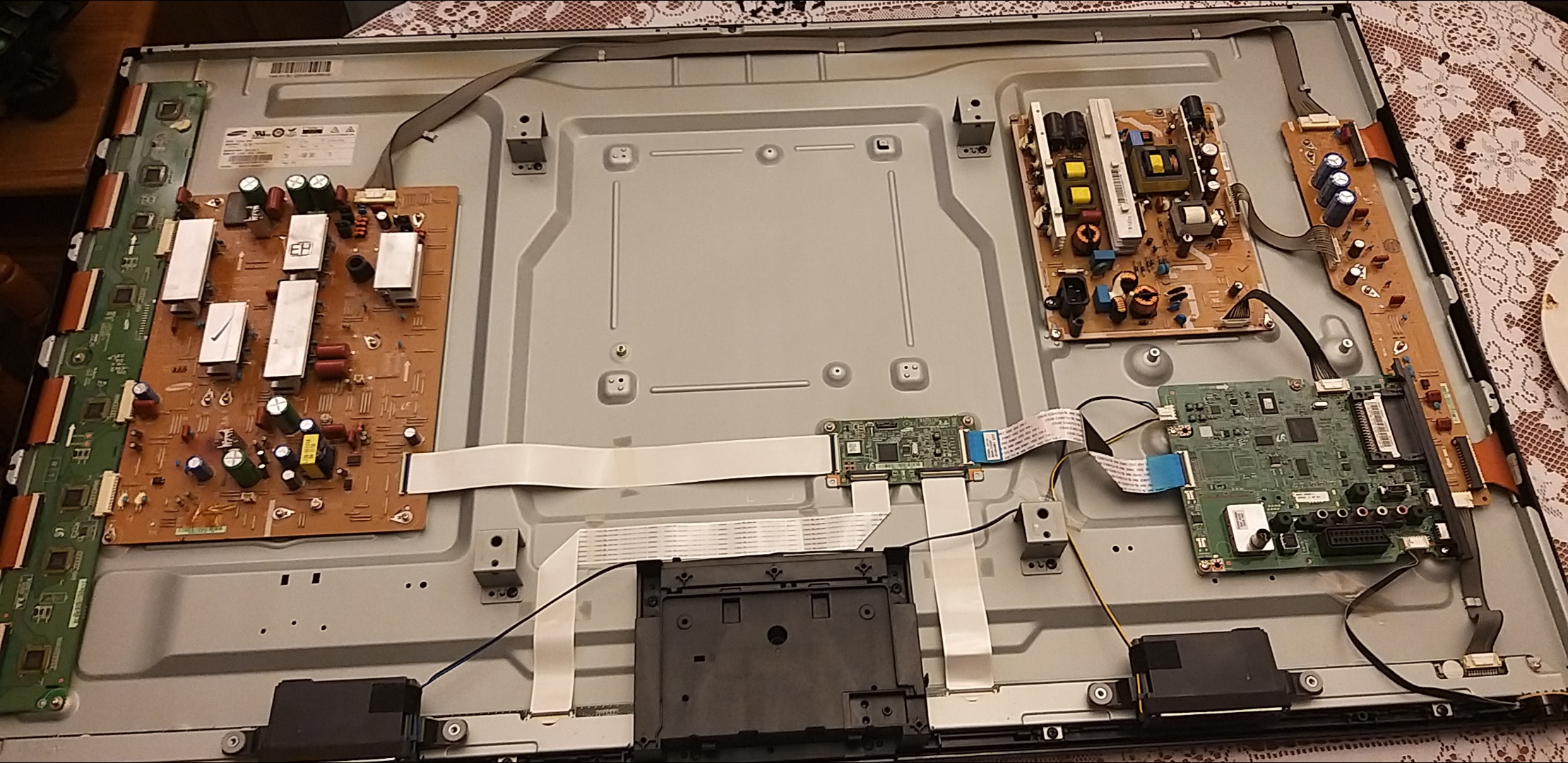

          • dick_barton
            • Aug 2015
            • 6643
            • Wales

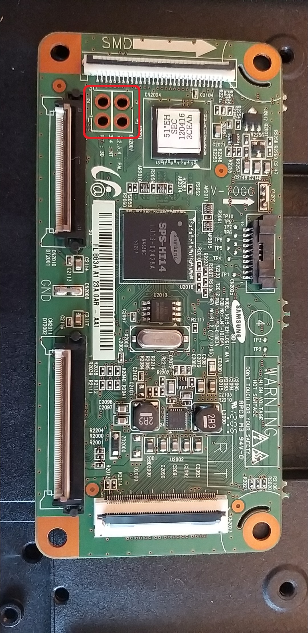

            Do a search on this forum to get the right info.
            For many sets it's disconnect the mainboard ribbon to the logic board and jumper the Auto-Gen pins on the logic board then power up.

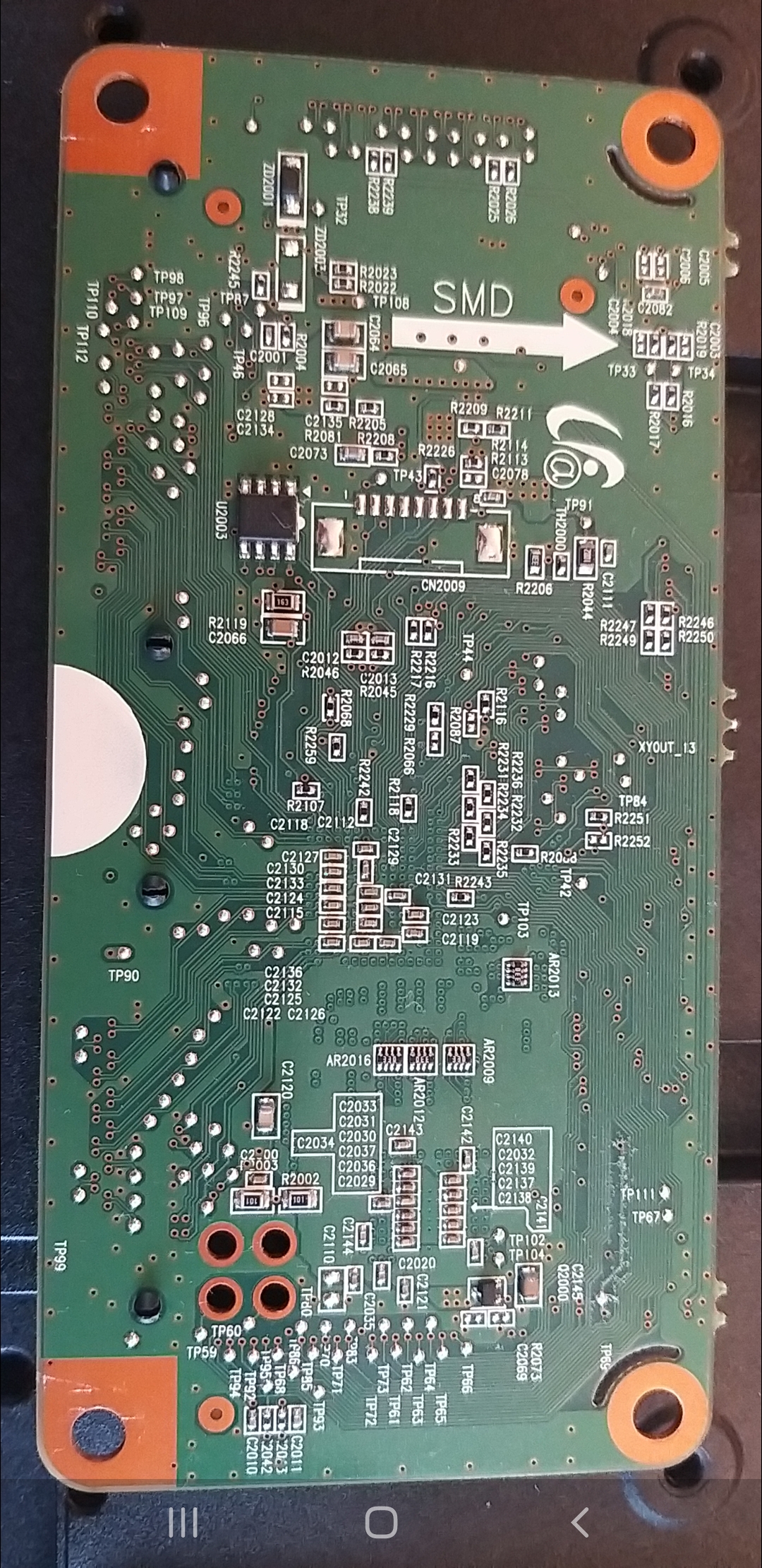

            • notallbad
              • Oct 2012
              • 1190
              On reverse of scorch mark is a SMK630 N-ch power mosfet.
              • notallbad
                • Oct 2012
                • 1190
                can't find test pattern jumper on logic board
                • dick_barton
                  • Aug 2015
                  • 6643
                  • Wales
                  It seems to suggest that it's 1 & 2 shorted together and also 3 & 4 shorted together for PAL but I'm not 100% sure.
                  • notallbad
                    • Oct 2012
                    • 1190
                    well, won't know unless someone tries it, so here goes.
                    So put the jumpers across and with the main (cn2023) ribbon cable disconnected power up, yes?
                    • notallbad
                      • Oct 2012
                      • 1190

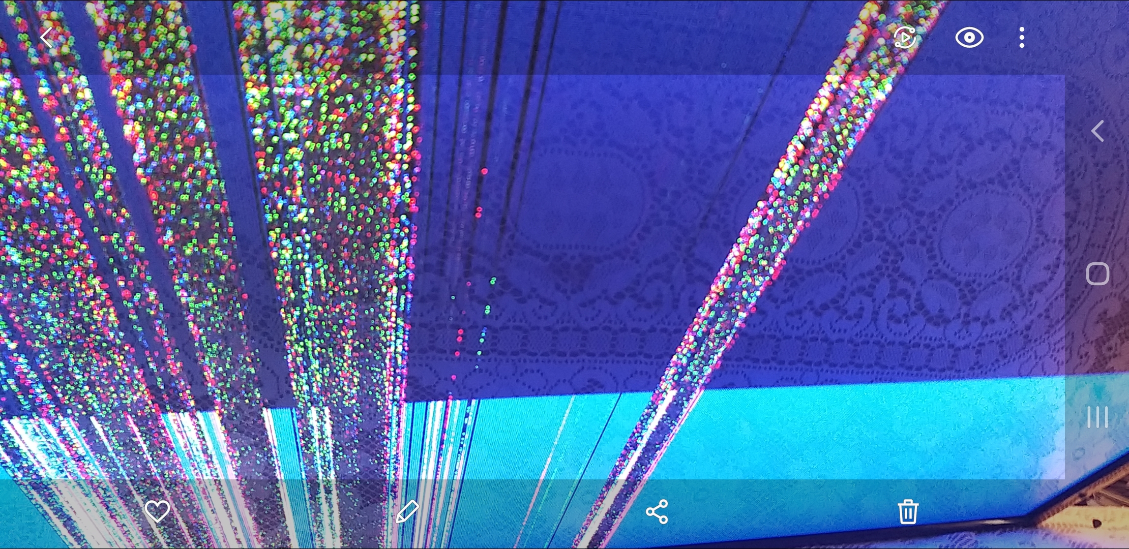

                      Well, just a black screen with the sparkles (discharge) still.
                      But what I do notice now is 2 thin blue lines down the middle of the screen. Not looking good.
                      With the jumpers back off and main disconnected its just a black screen. Just for info.
                        Try with just 1 & 2 shorted and CN2024 (if that goes to mainboard ) disconnected.
                        Edit
                        Is Ve back to 78V . If not this would need to be resolved. Previous posts on this model suggests a plasma screen fault, but you never know.

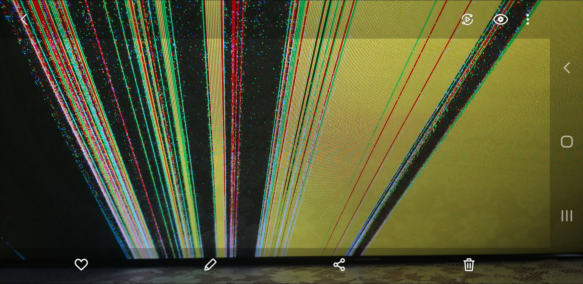

                        • notallbad
                          • Oct 2012
                          • 1190

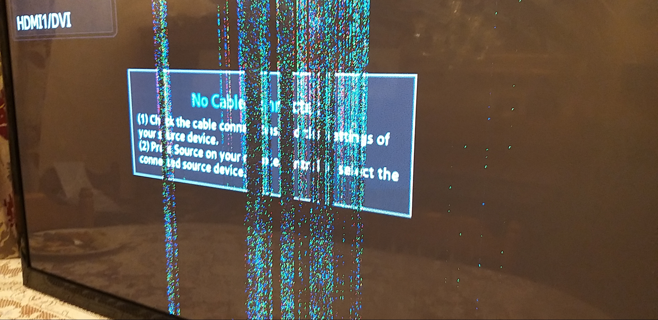

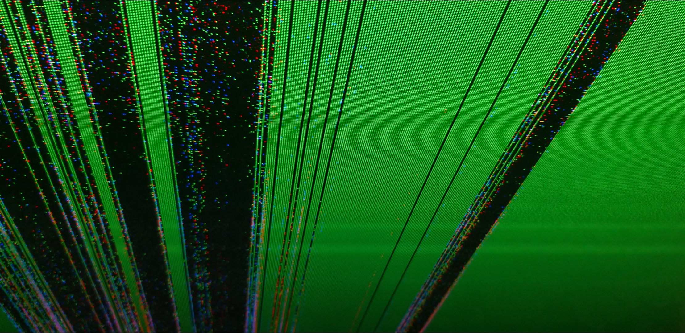

                          Yh, that done it.
                          1 and 2 jumpered and main disconnected.
                          Screen white. blue. red, green etc ..
                          Would agree now, screen damage!
                          I believe this was caused by liquid damage, attempt to clean the screen possibly.
                          VE still jumping around like crazy!
                          • tvtimmy
                            • Mar 2015
                            • 1160
                            • usa
                            Screen is bad.
                              Yh, quite sure too so just gonna strip it down for spare components from the boards.
