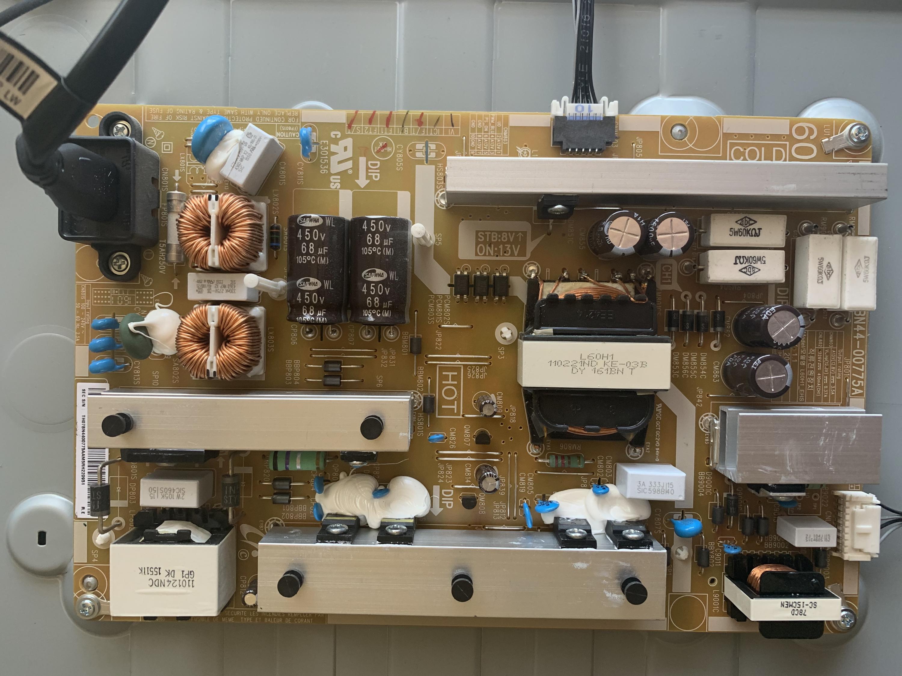

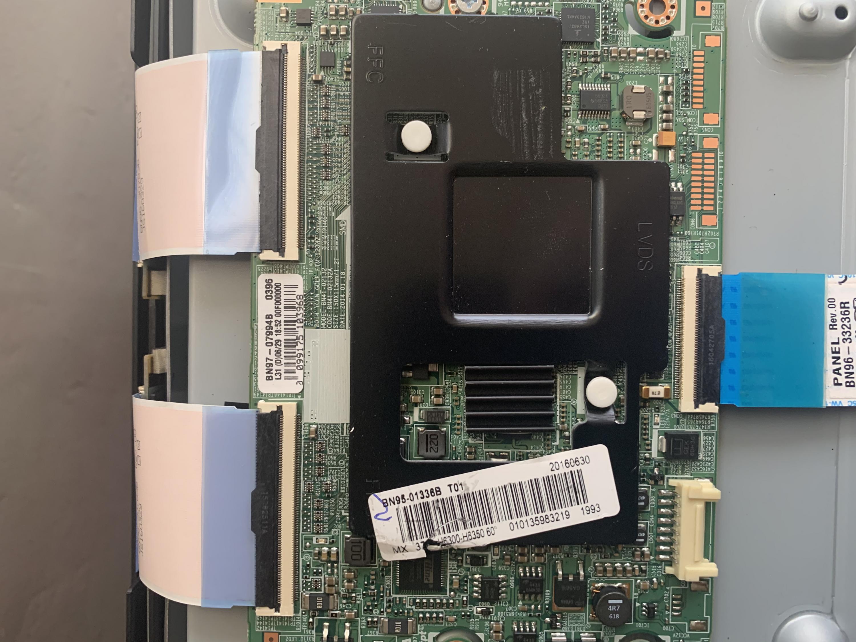

    I have a Samsung UN60J620DAF that did the classic progressive flashing the picture on and off while sound remained on until finally flashing picture all the way off never to return. I ordered and installed new, LVDS cable, TCON board, and Power Board in that order, re-trouble shooting along the way.
    Got picture back once TCON was installed, but the picture began blinking rapidly, slightly lighter to slightly darker. New Power Board did not resolve the issue.

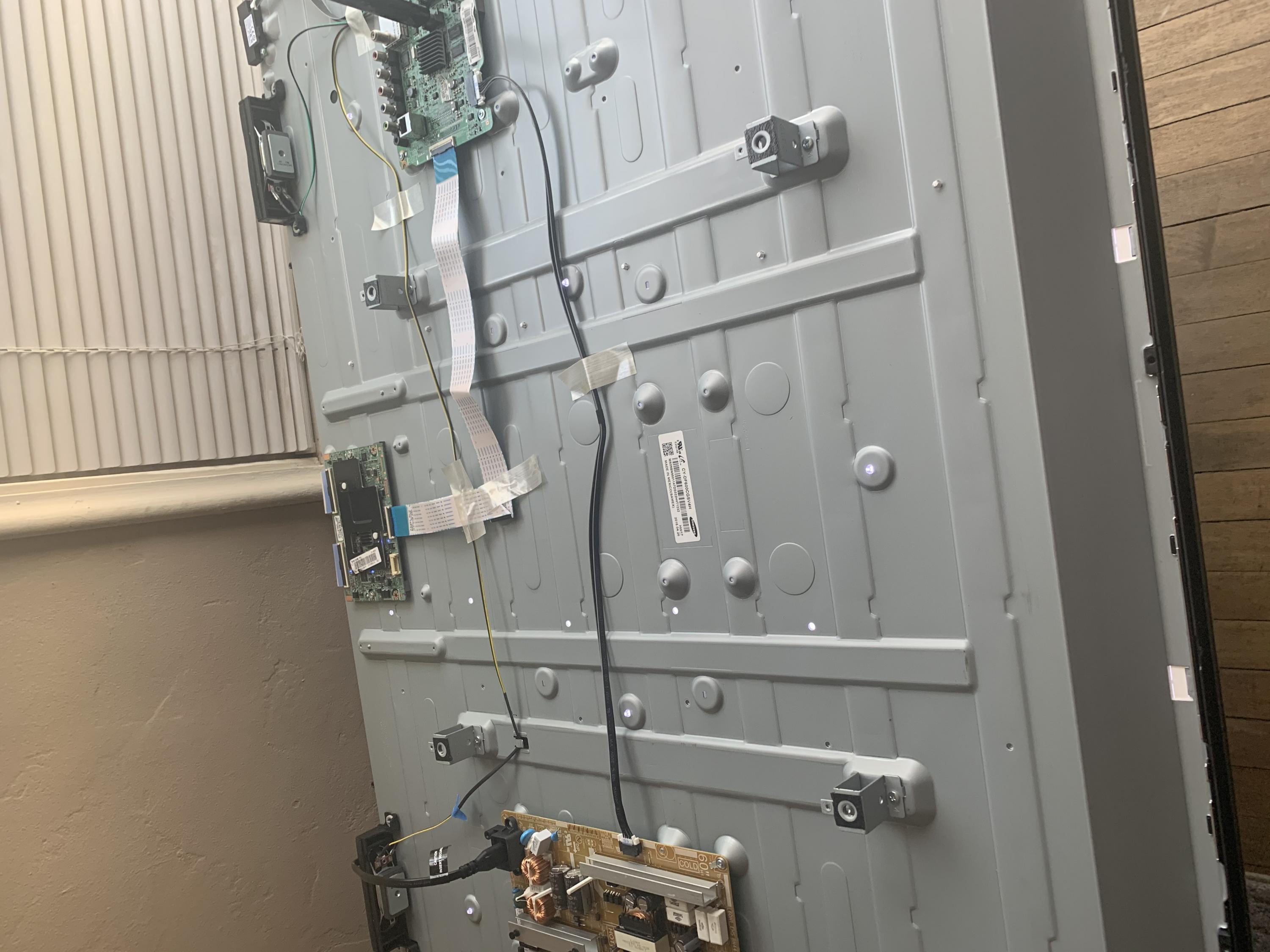

    Pictures attached of TCON, Power Board, Video Board, and back chasis / boards layout. That is the original video board, practically the only thing I have not replaced, that and the LEDs.

        An update: Somehow, during the reassembly, one of the driver tabs got burned in the center of the ribbon, and is now displaying a bar of vertical lines in the screen in relation to its placement on the driver board. Is there a repair for this ribbon? There is a visible burn mark. It is also hot to touch when the tv is powered on, I learned this inspecting it, thinking it could have been moved improperly and was causing the vertical lines.

          Sorry, a damaged Tab cannot be repaired, the original fault was the screen matrix and this was obvious, so you can sell all of your boards as good. Bye..
