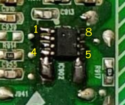

        Post the voltages on the pins of IC902

          Re: Philips 37PFL4606 No Power
          iam getting a very strange measurement, This is with 1K in place
          1=0.88V
          2=0V
          3=0V
          4=0V
          5=9.76V
          6=0V
          7=0V
          8=0V
            You have lost the supply voltage (VCC) for the IC. Check you still have the 5VSTBY. If you do then you need to check the voltages on Q907.
            If you don't then it's back to measuring the voltages on the pins of IC905

                What voltages do you have on the pins of IC902. The voltage at the collector (Q907) appears low. I seem to remember Budm mentioned it as being 15V which it currently is not.
                  Only getting an voltage on pins
                  1=0.88V
                  8=9.8V
                  All other pins are 0V
                    This is starting to confuse me.
                    The transistor Q907 has 9.8V at the emitter which goes to IC902 pin 8 via R947 but Pin 8 has 0V on it? Are you reading the IC pin numbers correctly
                      My bad.. i whas counting the pins wrong.. apparently the pins goes like this
                      1=8
                      2=7
                      3=6
                      4=5
                      and i whas counting like this
                      1=5
                      2=6
                      3=7
                      4=8
                      1=0.88V
                      8=9.8V
                        You need to recheck this one and your other thread for previous readings given if you have been miscounting the pinouts.
                        The pin count goes anti-clockwise in a circle. Normally pin 1 is marked on the board or has a dot on the IC next to pin1.
