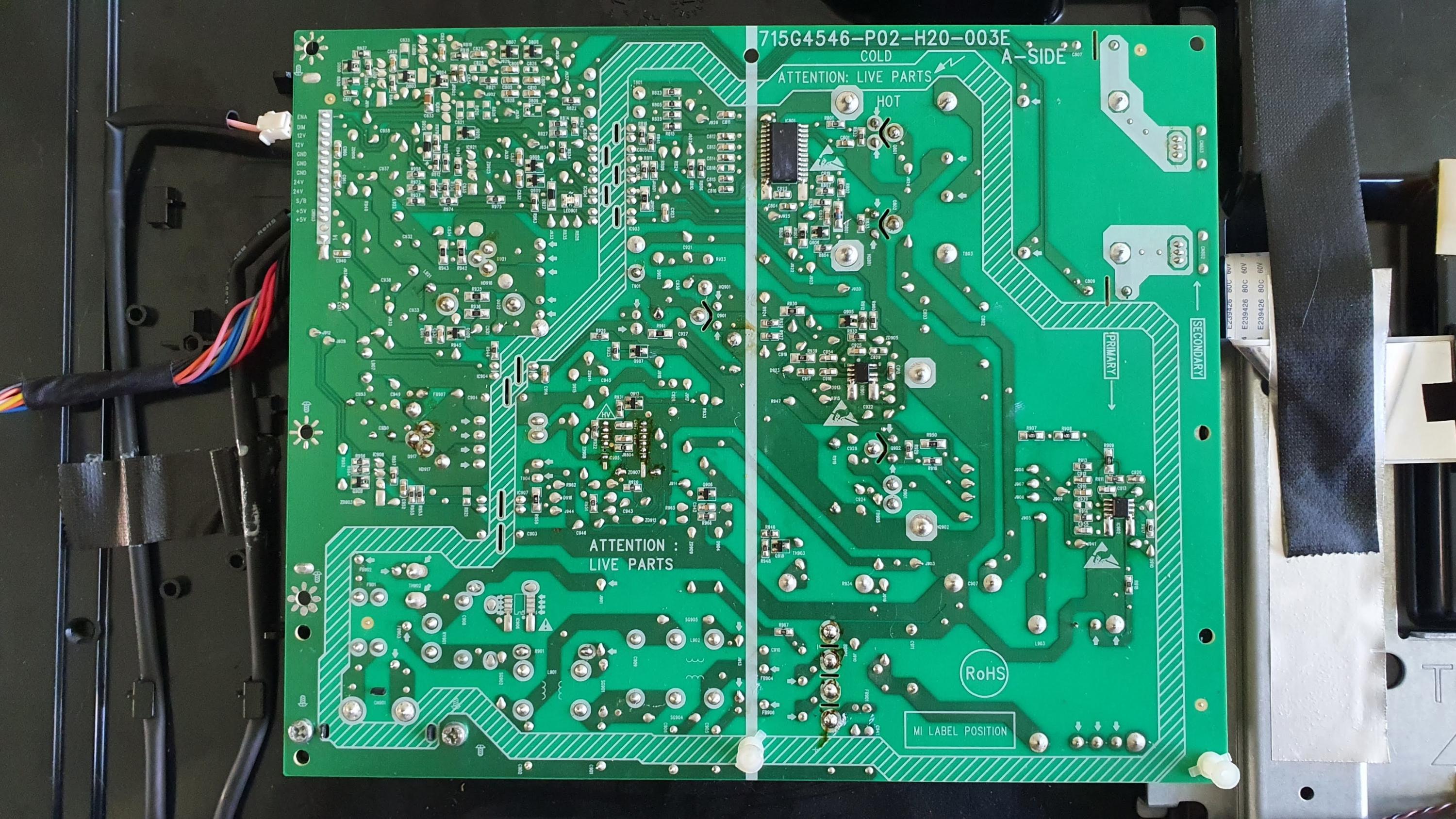

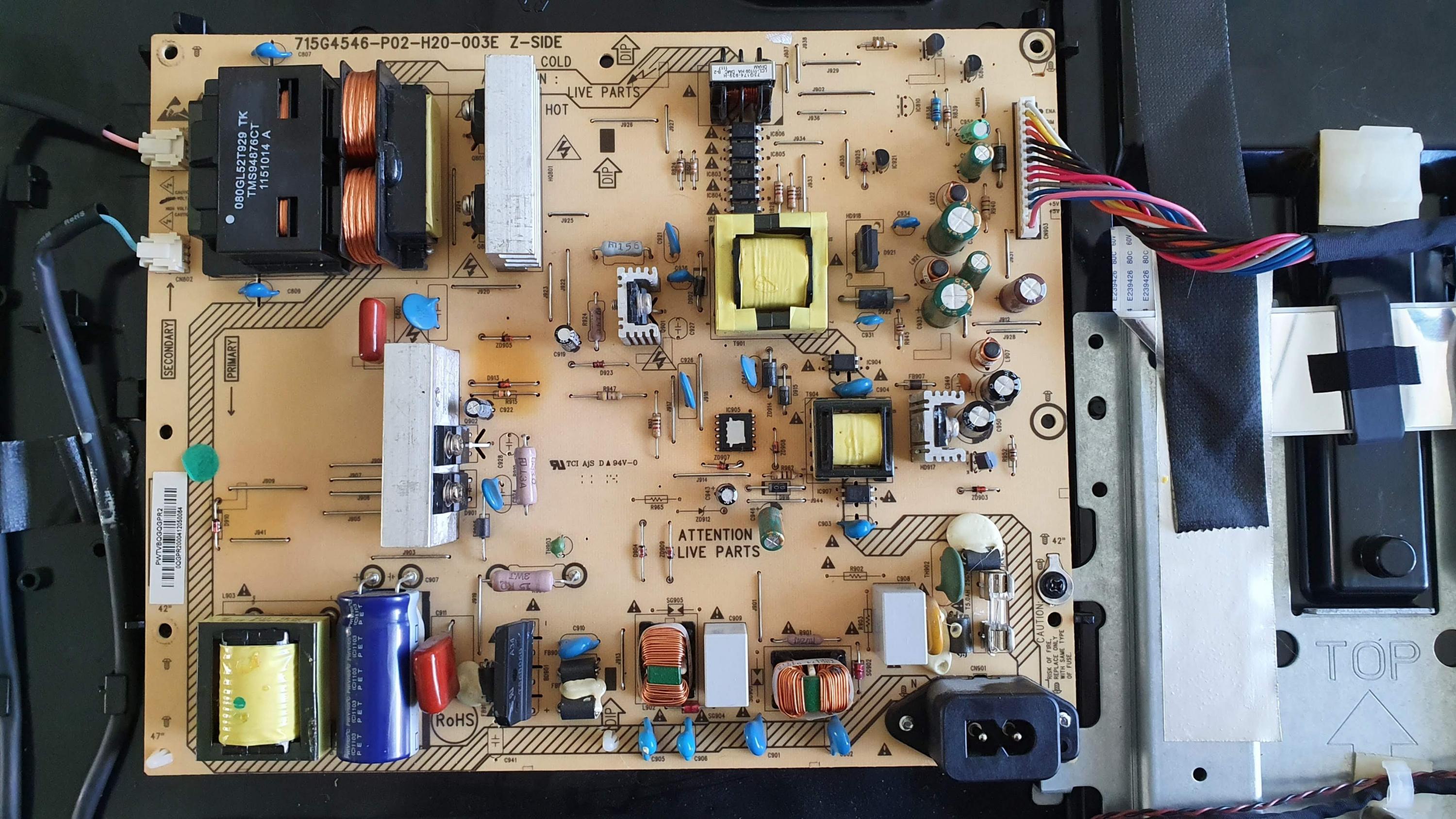

    Hello
    Iam new to this forum an got an question right away !
    Ive got this powersupply and it is not powering on
    The standby led on the chasis is on and when powering on it goes off and then 5 secs later its back.
    Also the blue led on the back off the power supply goes on and then fades away.
    Iam measuring on the + and - on the rectifier 313V ! on C907 iam getting the same 313V.
    On CN903 iam getting +5V even when connecting S/B to +5V iam only getting +5V so no 12v/24V
    What did i miss ?

    Disconnect the mainboard from the power supply and connect a 1K resistor between 5V and S/B pin then check you have 12V and 24V supply.
      Re: Philips 37PFL4606 No Power
      Can we see good clear pictures of what we are dealing with?

        Hello, i cant test at the moment because i dont have an 1k resistor.. its on the way
        also i attached the photo's from the power supply i more pictures needed let me know

                  might be wrong but it looks like to me that its been worked on before

                    Edit is allready replaced D901,Q902 and R919 because board whas doing notting in the begining
