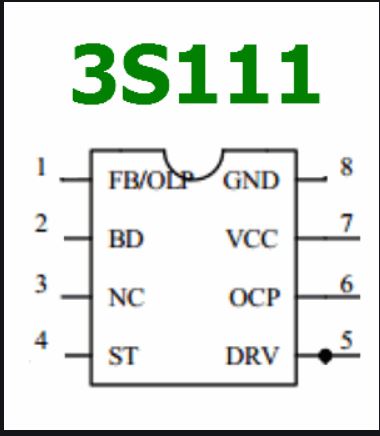

              • afnan
                • Jun 2020
                • 20
                Re: bn44-00604F No Secondary Power
                what is the part number of the ic driving the mosfet?
                3s111
                  With the set powered off check the resistance between ST and GND and also between DRV and GND and VCC and GND
                  • afnan
                    • Jun 2020
                    • 20
                    ST - GND = 0.5 MOhm
                    DRV - GND = 1 kOhm
                    VCC - GND = 170 Ohm
                      VCC - GND looks a little low but it's not a short circuit. If you power up can you check the voltage between VCC - GND
                        VCC - GND looks a little low but it's not a short circuit. If you power up can you check the volage between VCC - GND
                        VCC and GND is 0.49V DC
                          I would check your mosfet again. If there was no current sense resistor in circuit it may have blown again.
                          I don't know what the VCC should be for that IC but would expect it to be between 10 - 20 V. Once again I would check the components around that IC and Mosfet.
                            I will try to source sense resistor and change the MOSFET to see if it does the job. All components in that area report OK.
                            What I can't understand is that the transformer has 4 pins on the primary. One is connected to + from the bridge, second to MOSFET drain, third is to Bridge - and 4th to the MOSFET driver VCC.
                            I guess attached is a typical schematic for it. Now on ST, I have 124 v or something. Since I have good ground and ST voltage, I believe the transformer is not turning on to give feedback and constant Vcc. The reason could be missing Rsense. I have tested MOSFET its fine. I have other new ones I will swap anyway.
                            Am I proceeding in correct direction?
                              If the mosfet was shorted and the sense resistor was open, then the ic is bad. When the mosfet shorts and the sense resistor goes open, then the 311vdc connects to ic101 via R104 damaging it. Maximum voltage on pin 6 (ocp) is 6 volts
                              The transformer has a primary winding connected to B+ and mosfet drain, the second winding is to supply VCC voltage once the circuit starts working. The ic has an internal startup cell that supplies a small amount of voltage to start the ic, but once it starts it requires that the vcc be supplied externally.
                                    According to the datasheet and the circuit shown in post #14 above, capacitor C103 should charge up to 15V before the control circuit starts operation. (Taken from datasheet) This voltage is derived via R103 and the zener diode connected to ST input.
                                    I would check both and if OK then I would tend to agree at this point with RJ that the IC may well be damaged.
