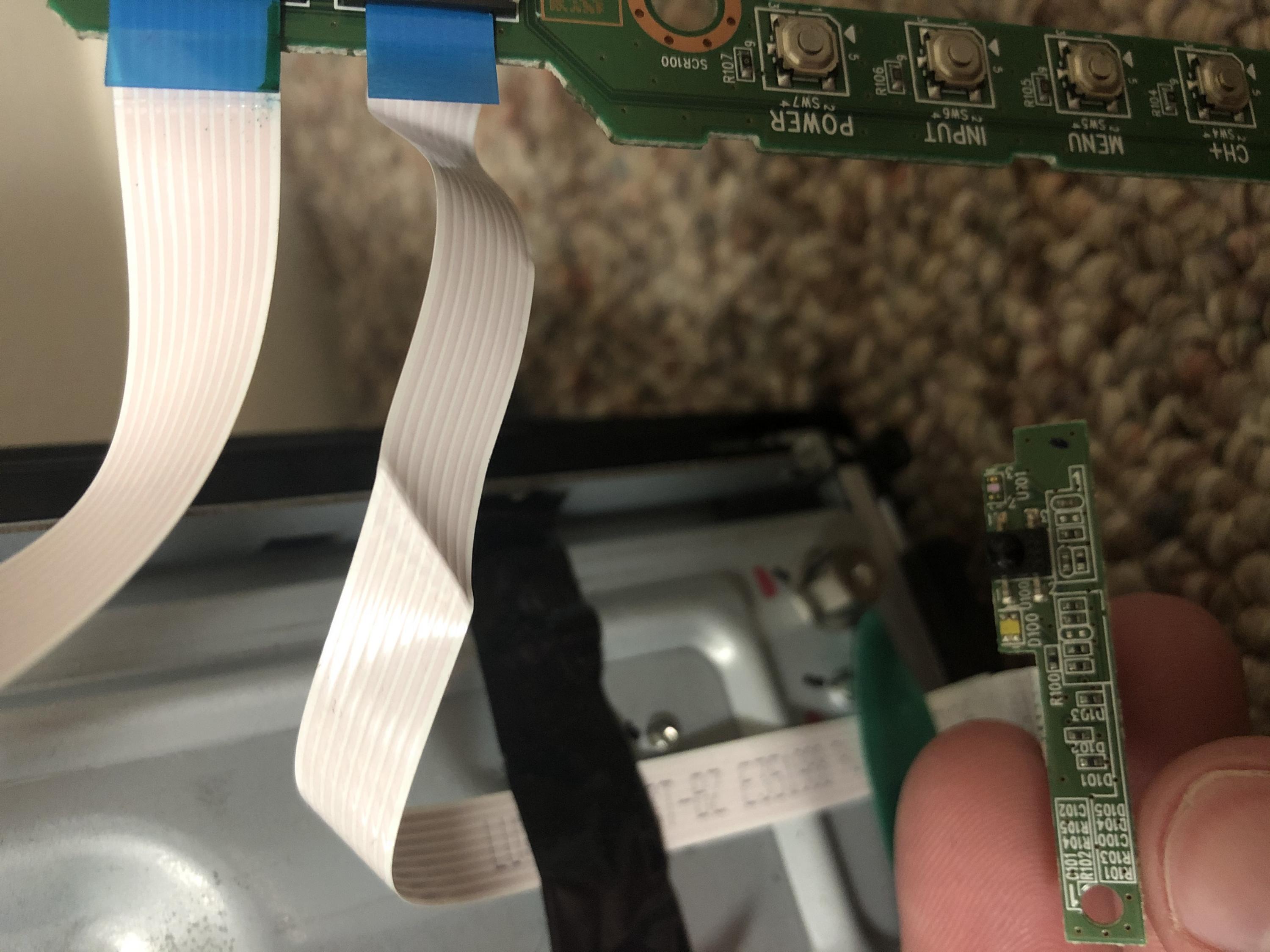

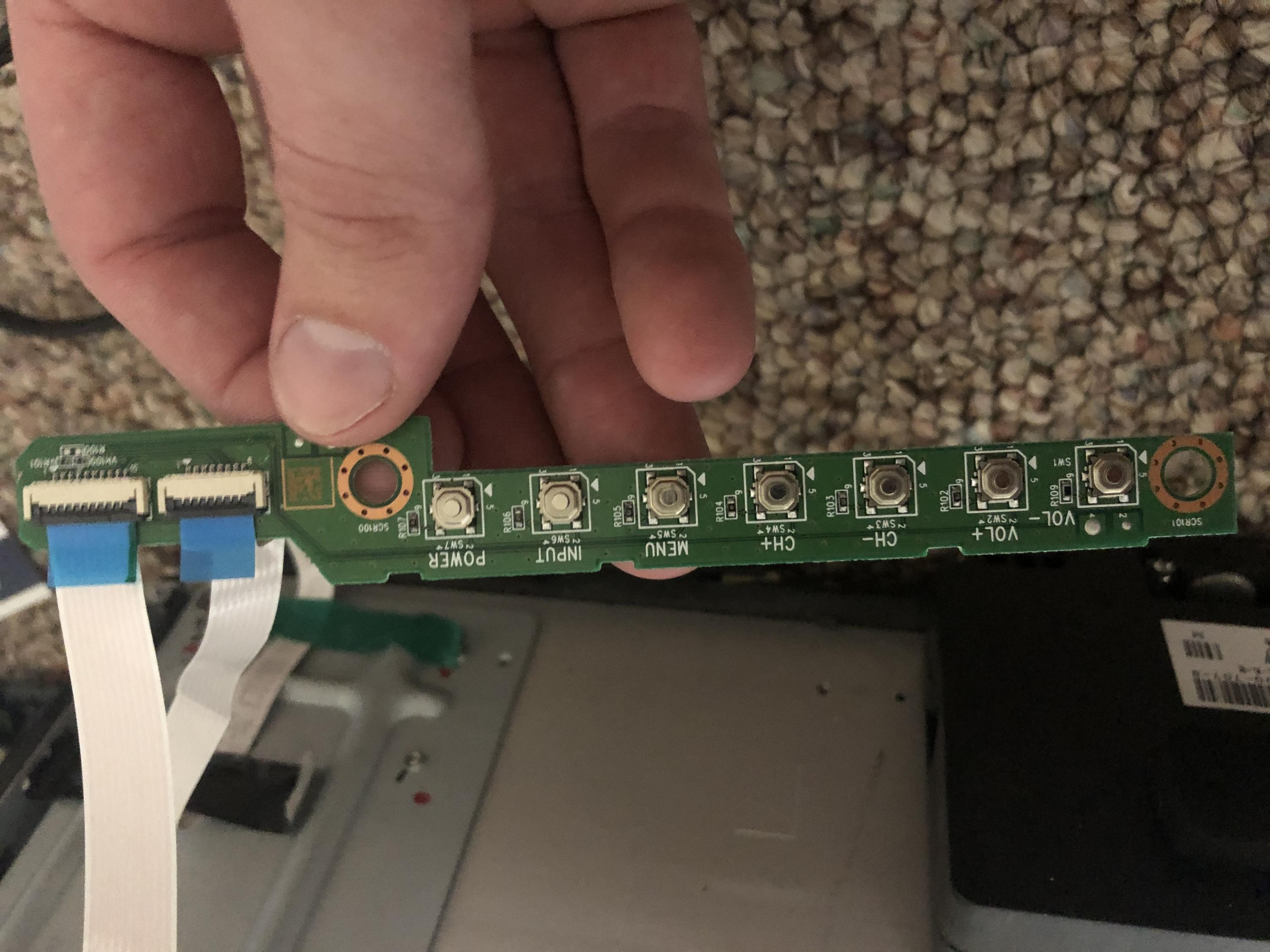

    - After inspecting the cable from the buttons to the main board it seemed like it was kinked and broken (My original thought was it stopped working after the move because maybe I didn't install the cable properly and laying the tv on its back ruined the wire?)
    - In testing I ran a jumper wire, with the cable still in, from the pin on the main board to the button board. (on the side of the supposedly broken wire inside the cable). Doing this caused the speaker to start popping a little for a sec until I moved and lost the connection.
    - I think I accidently touched the wrong leads (pin 1 main board jumped to pin 2 on button board) the 2nd time around and it started lightly sparking on the buttons board. I realized what I was doing was probably dumb and stopped.
    - I purchased a new cable to run from the main board to the buttons and am still having the same issues

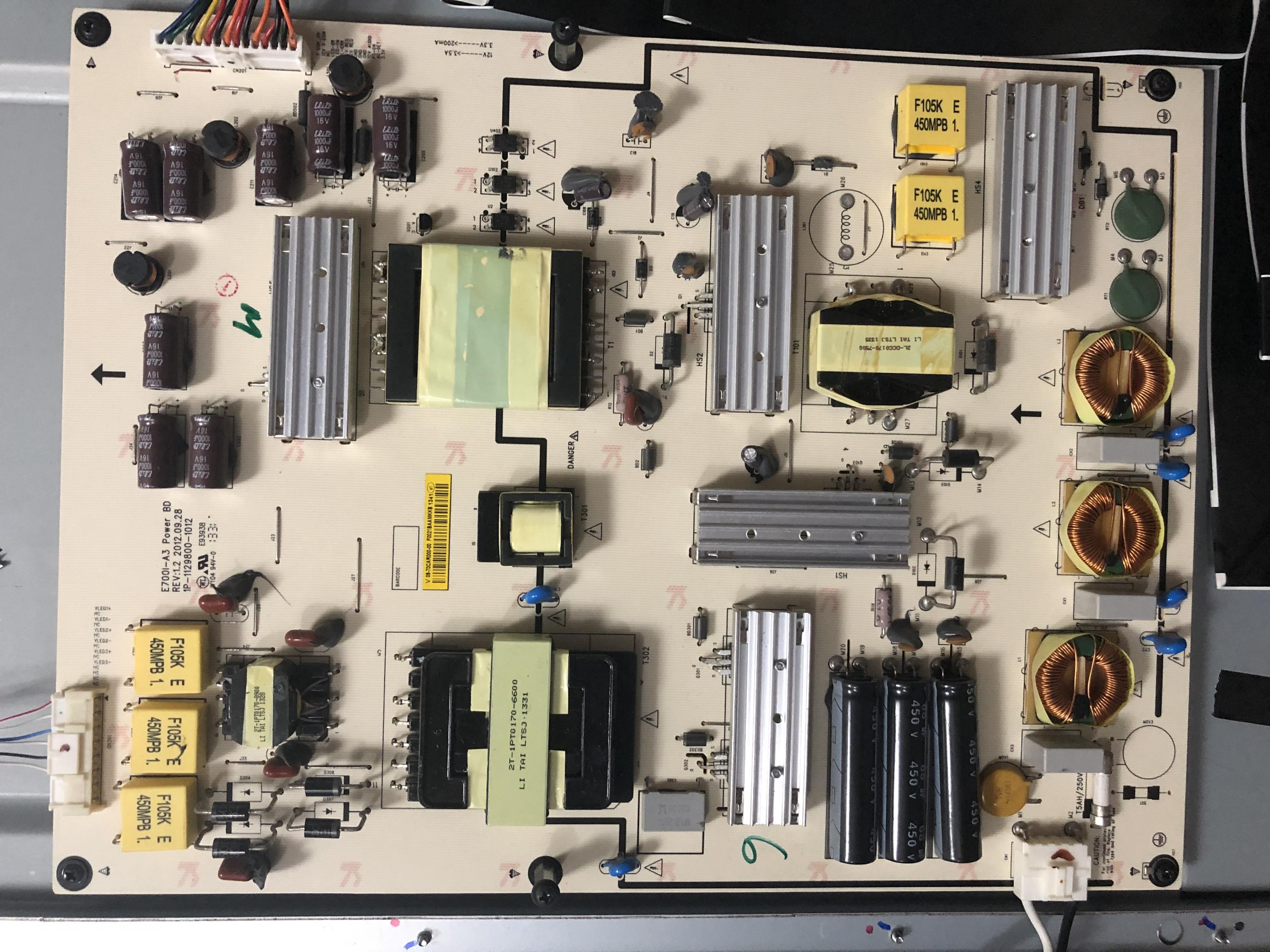

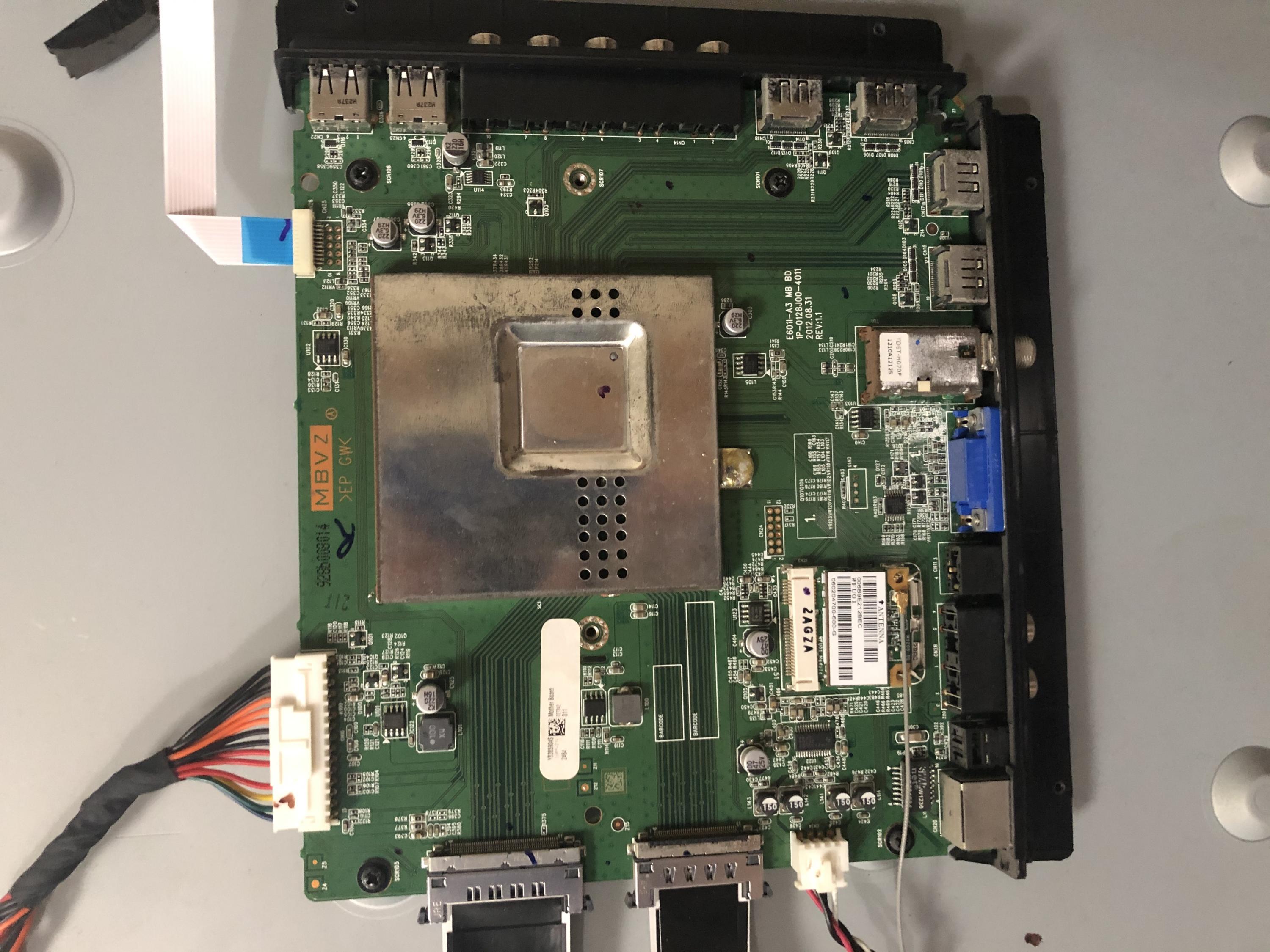

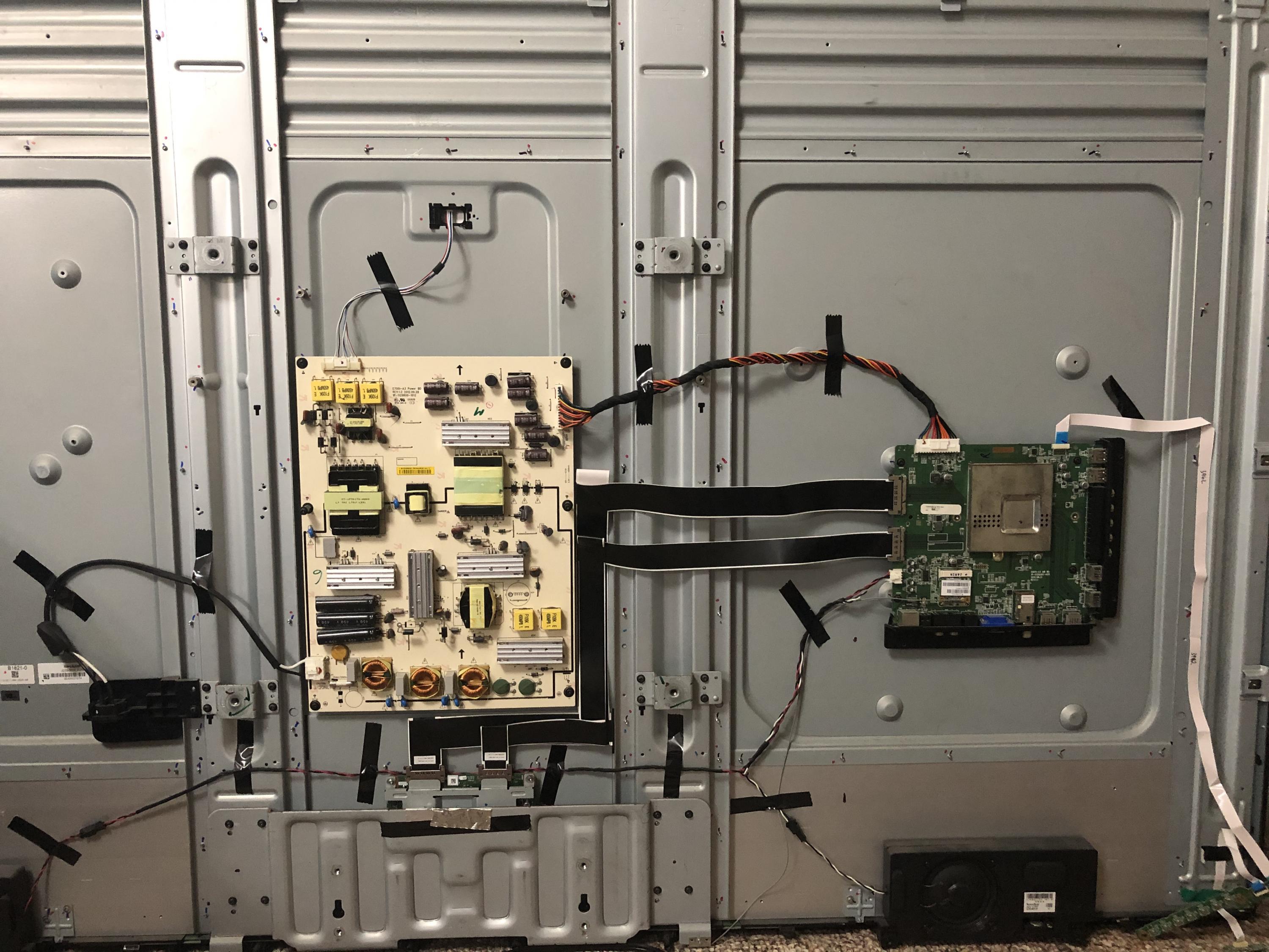

    Throw up some good clear straight on pictures of each board and one of the whole back to see how they are all connected, try test number 3 below, try to do it just as instructed ala pin name/description pin number and voltage both in standby which is plugged in but not powered on and then when powered on.

      Ok I did what you asked and this time with a nicer voltmeter, I'm not sure what you meant by "ala pin name/description pin number" but I measured pin 1 on the power supply board that is labeled "3.3v" that connects to the main board and I read 3.33v on standby. When pressing the power button or using the remote, nothing changes whatsoever and I still read 3.33v. No new sounds or anything when attempting to power it on.
      Attached are some images of the boards and the whole tv. Let me know if you would like more/ better pictures.
      Thank you!

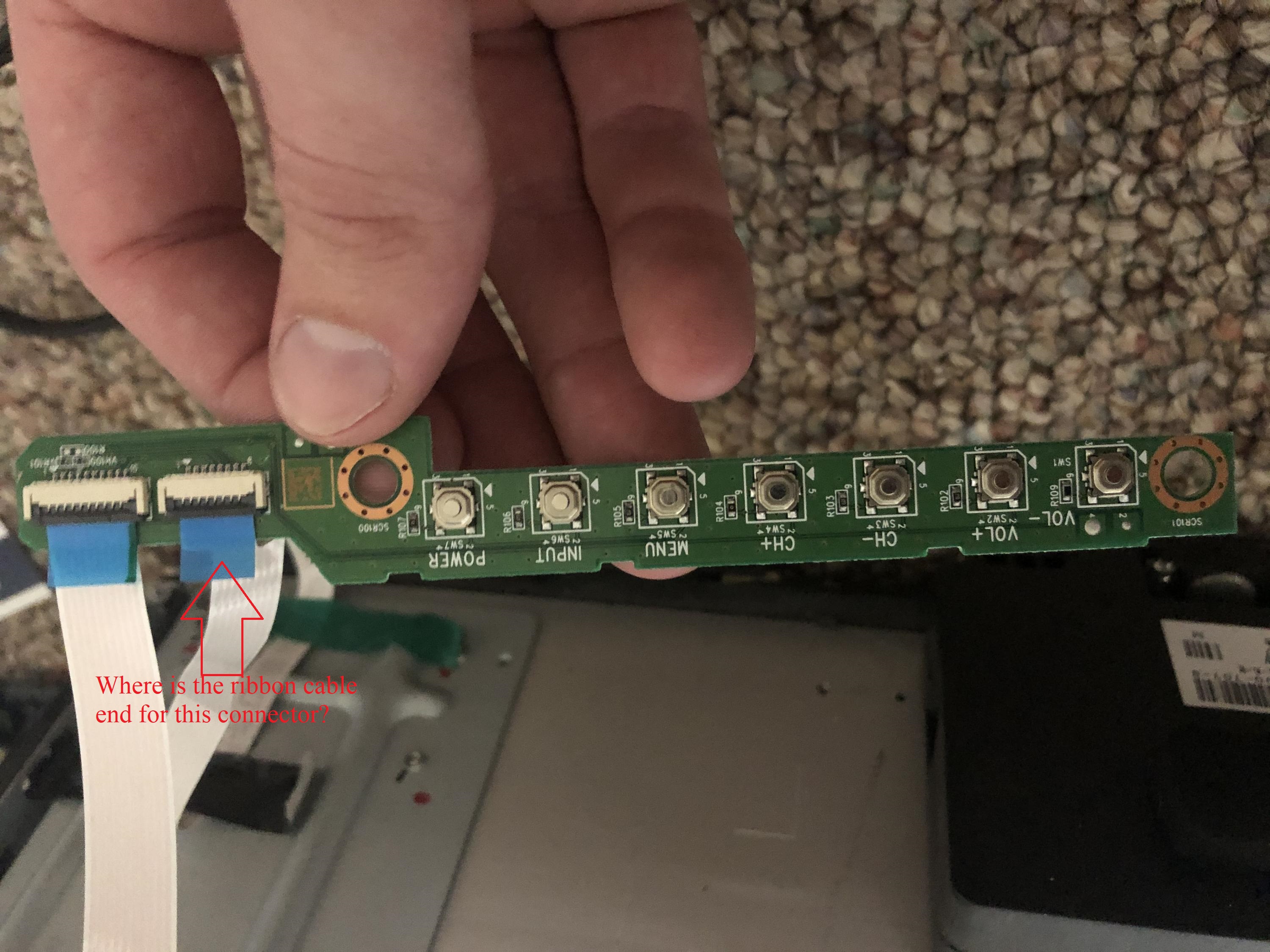

        Where is the ribbon cable end for the second connector. I can see the blue tab but not the ribbon attached to it?

          The 2nd ribbon cable from the buttons board goes to the IR board that is positioned towards the front of the tv (see picture)
