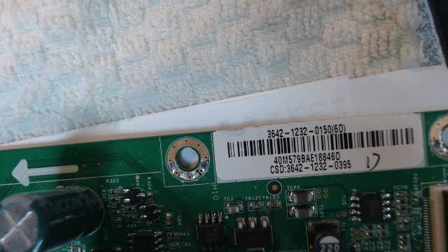

    Vizio Main bord Question
    Working on a Vizio E421V0 the sticker on the main board says 3642-1232-0150 (6D)
    I bought an eeprom on eBay for a 3642-1232-0150 and did not work out but the guy is telling me I bought the wrong one because of the (6D) I was told by a guy from ShopJimmy that this would not matter. So who is right? Whats the 6D for?? and nothing is listed with 3642-1232-0150 (6D)

      Re: Vizio Main bord Question
      Shopjimmy is right as long as the main board part number matches. The number in the ()is the version number so you have version 6D and most eeproms are not version specific as far as I know. Did you replace U18 and U21 or just the eeprom?
