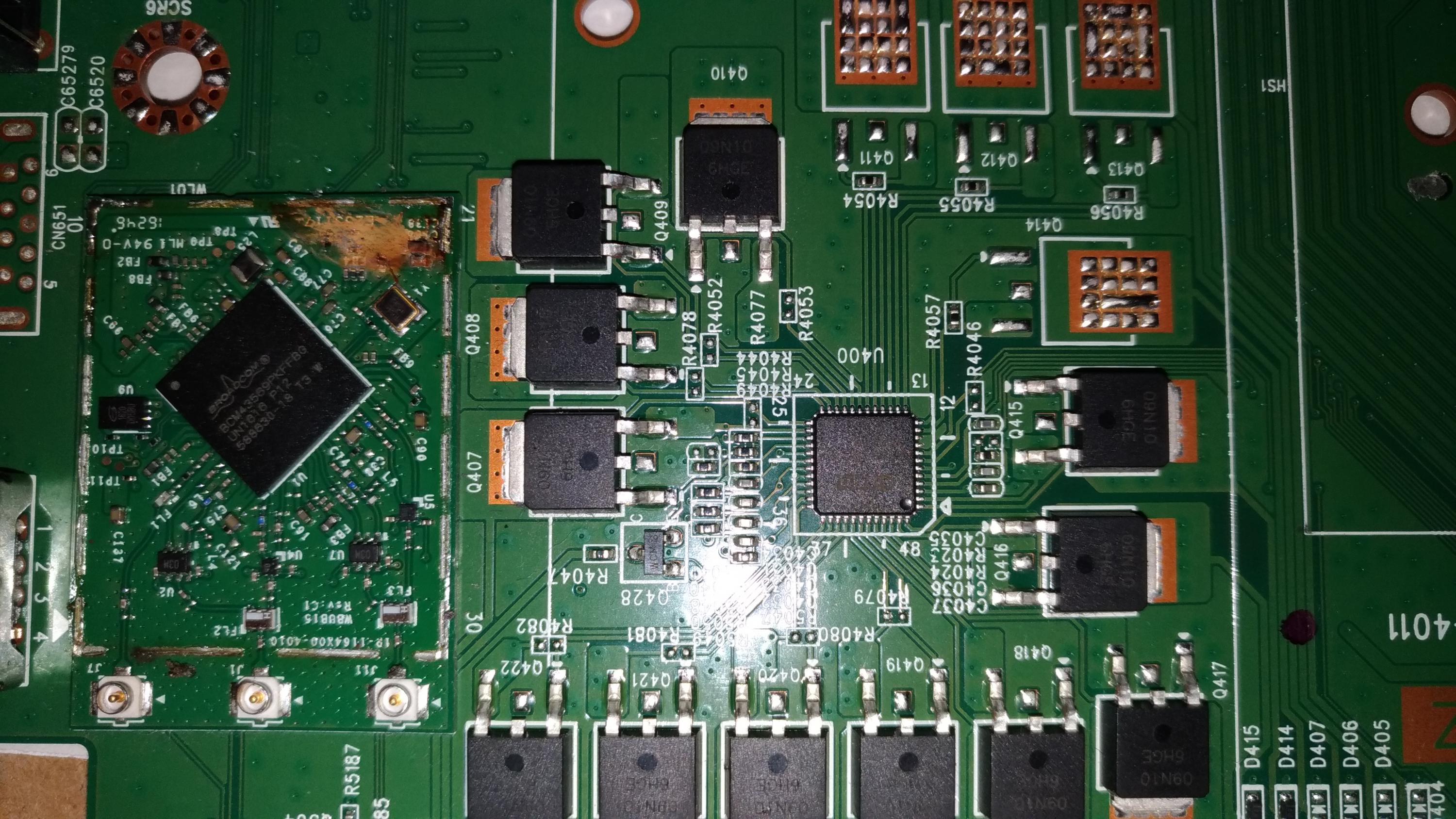

              I injected DC into the "output" of L201 because it looked like too much of a PITA to remove. I started with one power supply, then a bigger one and then a much bigger one (300watt). I injected 1 volts and then upped it to 2 volts. The circuit drew 6 amps with the PS on current limit. It took a lot of feeling with my hands but the problem seems to be a short inside the FOXCONN WiFi module. I will pull the shield off and see if I can fix it. Probably a bad cap in the module.

                  I traced the problem to the WiFi module due to the heat it was giving off from forcing current into the shorted MLCC cap(s). It must have gotten pretty hot inside the shield.

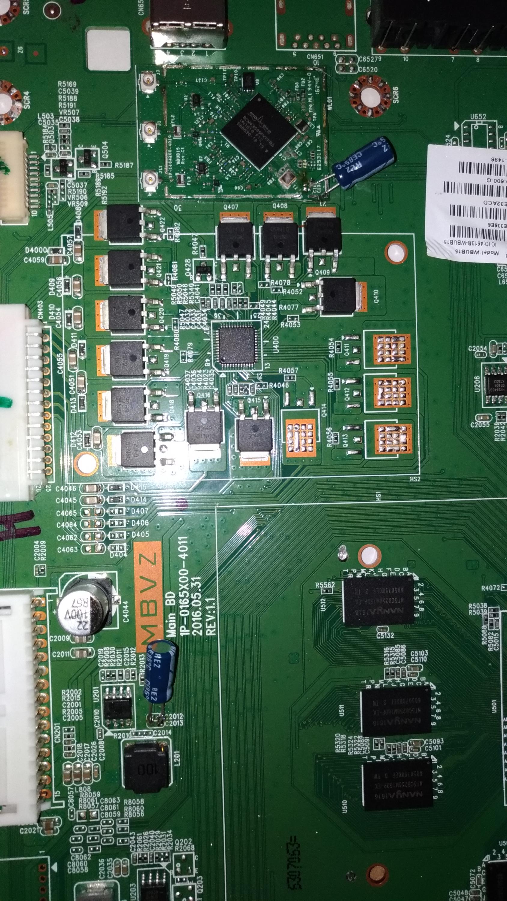

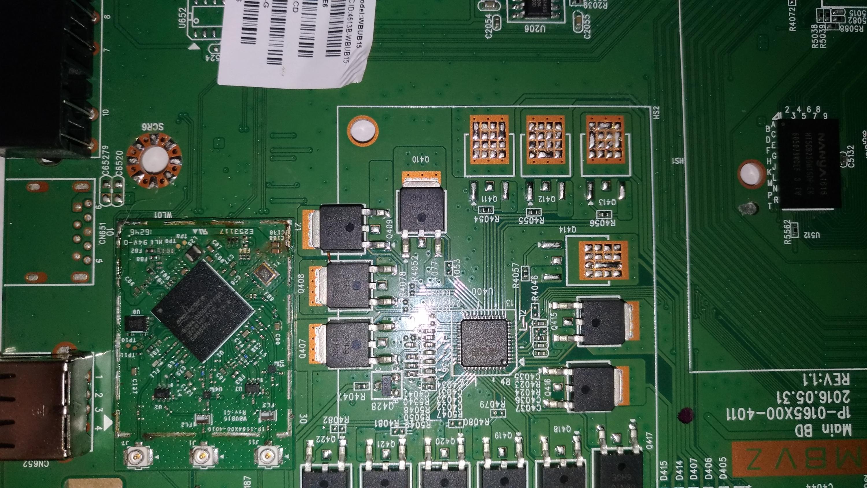

                  I replaced the 2 MLCC caps in the WiFi module and 2 MLCC on the output of L201 with cheap two 10uF axial aluminum electrolytic caps. The 2 MLCC caps on the output of L201 were OK but I didn't want to reuse them. Desoldering the shield off the WiFi module took a lot of heat from a 80 watt soldering iron. I didn't reattach it.
                  I cannot say which of the 2 MLCC caps in the WiFI module were shorted. I toasted the area pretty good with 2 volts at 6 amps as shown in the pic. The second pic shows the 2 caps. Lucky the vias and traces could handle the current. The TV seems to be working though I didn't check if WiFi is OK. Not my problem anymore....
