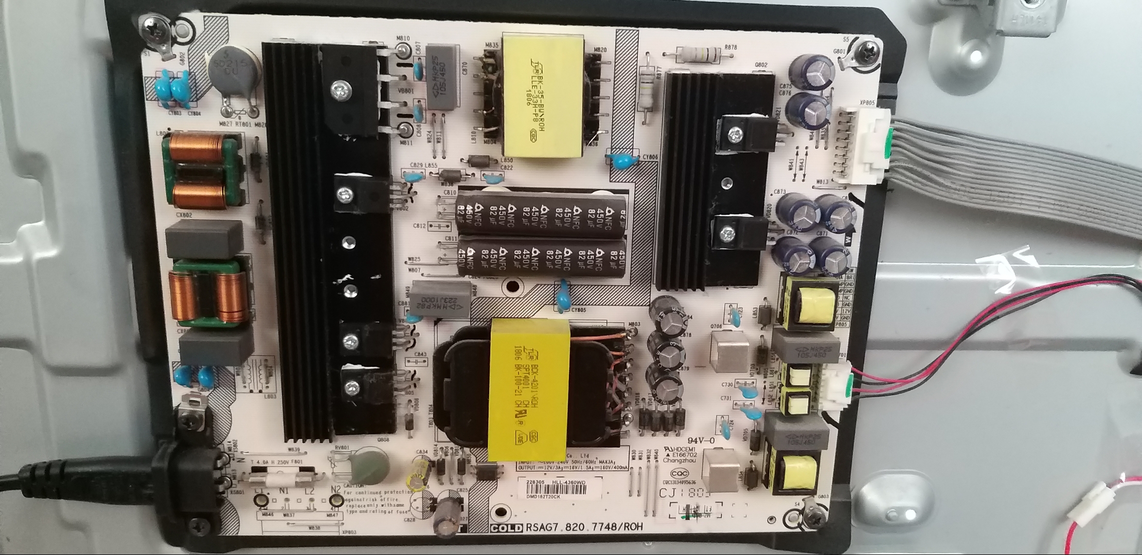

    PS: RSAG7.820.7748/ROH

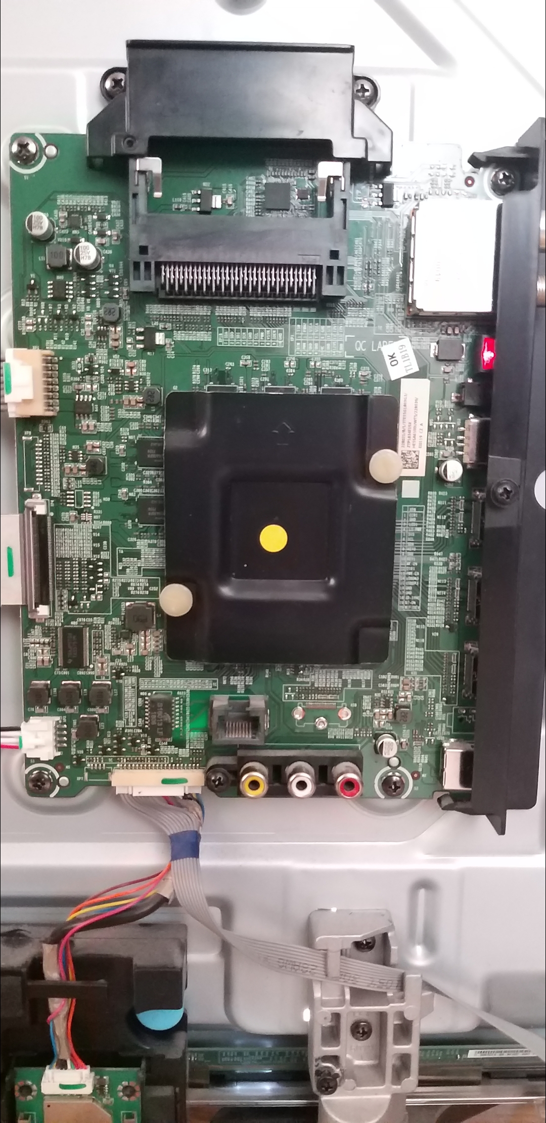

    Main : RSAG7.820.7970/ROH

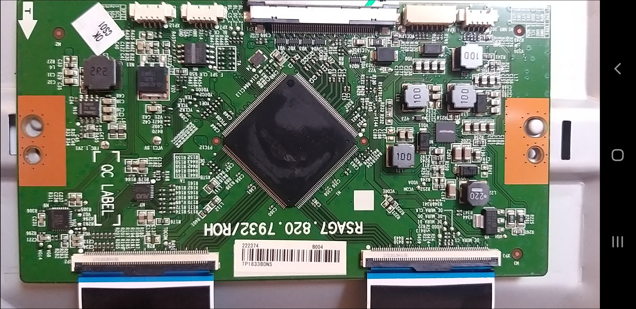

    T-con : RSAG7.820.7932/ROH

    PSU voltages:
    XP701
    Stby-----On
    110------125.7
    0----------0
    110------125.7
    0----------0
    XP805
    ---------Stby---------On
    gnd------0----------0
    ana------0----------0
    vamp---18.4-----18.6
    stb-------0.05-----2.69
    12v------9----------12
    sw-------0.03------4.69
    bri-------0.03------1.53
    gnd-----0-----------0
    nc-------0-----------0
    12v-----9-----------12
    gnd-----0------------0

          I notice the board says 12V @ 3A, 16V @1.5A and 160V @ 450mA
          Do you have the 16V and 160V supplies?
          Edit
          Just noticed that it looks like the 16V is the 18V supply

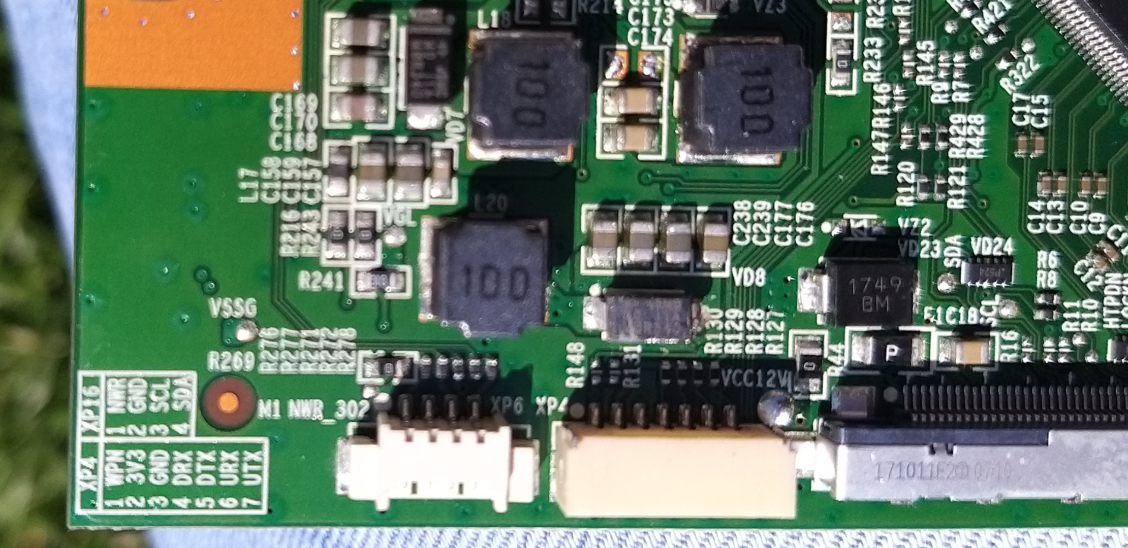

                    Yh 12v on both sides of fuse and 1.8v on vcc1.8 and 1.2v on FRC_1.2V1.
                    Appears to be a short across VD8 - MR340, even with one side lifted the short exists between the pads, not the diode.
                    Short across caps C238, C239, C177 and C176.

                      Is the MR340 the correct number?
                      https://tinyurl.com/y788q8ep and it appears to be a mosfet
                      Where is it on the tcon? top or bottom?

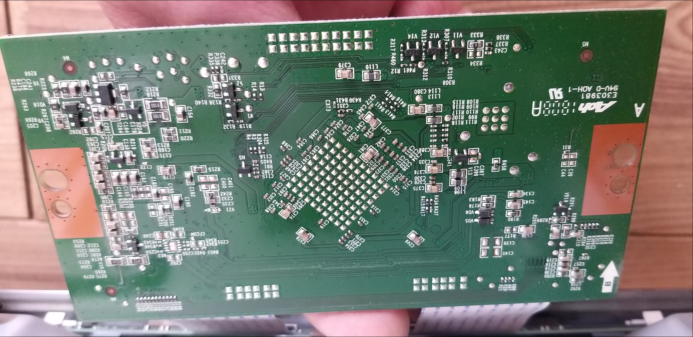

                          M8R340 or MBR340, top right. DMM on diode setting get a reading of 120 one way only.
                          On the pcb pads get a short.
                          Sorry, picture upside down.
                          T-con disconnected from main and panel.
                                    It is possible that one of these caps are responsible for the short circuit.

                                        So, it would seem C177 was shorted.
                                        Removed C177 and the cap is shorted.
                                        The short across the other caps and the M8R340 has gone.
                                        Also on the reverse side, VD5 showed as a short, but also now gone.
                                        But what to replace it with? Its tied to the 12v rail. 0.1uf???
                                        Dare I try it without this cap attached?
