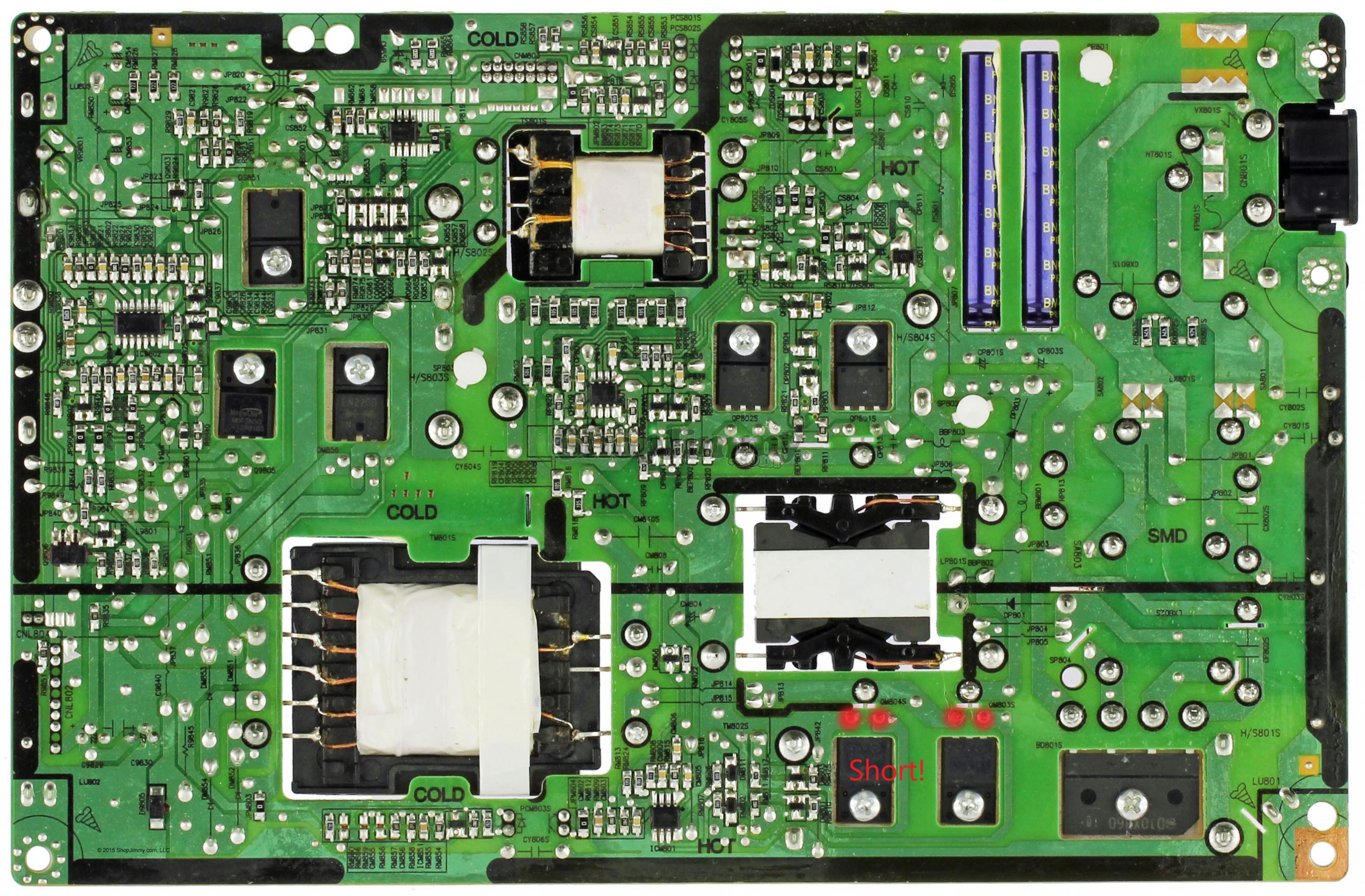

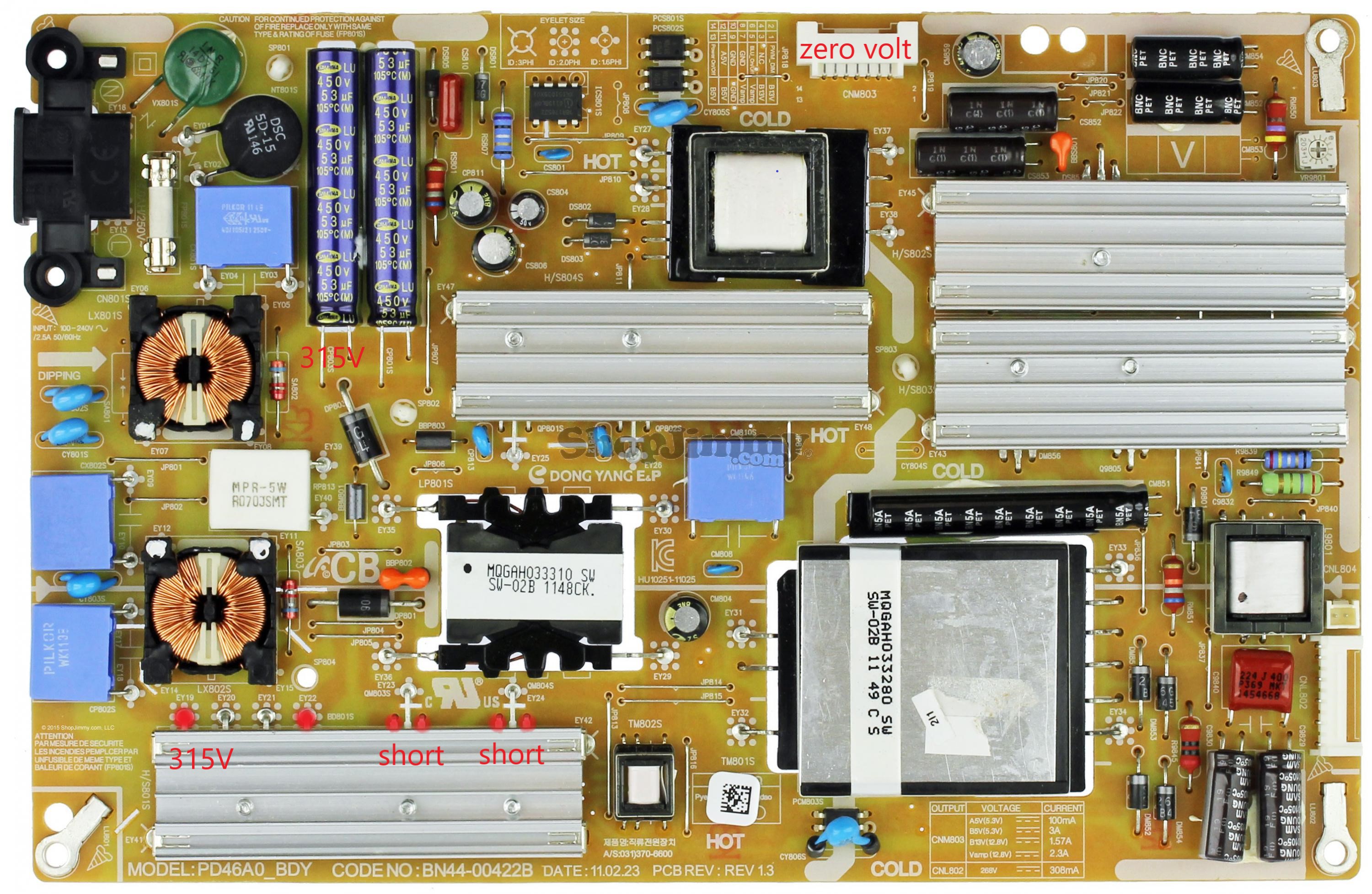

    Hey guys ,
    It's been a while but i was given a dead 40 inch Samsung LED tv.
    I dont know the history of the tv but there is no visible damage on the tv or boards.
    I attached 2 pictures of the powerboard. Bottom and top of the board and i marked what i measured.
    I got zero voltages on the connector going to the mainboard so the main problem must be in the "hot" area.
    What i measured :
    - zero voltage on the connector going to mainboard.
    - +/- 312v on ac/dc converter and the 2 capacitors.
    - +/- 312v between VCC and Drain on the SMPS ( 3BR1765JZ )
    - Short on the pins from 2 mosfets ( ndf05n50zg ).
    - zero voltage on the optocouplers.
    I took the mosfets of the board and they are ok. The short is still present on the board.
    Hope someone can help me. I could order a new PS but i would like to repair this one and learn a bit more about LED tv's.

        So dead then, no led indicator lit on front, check all the diodes on powerboard, easy enough to check if you didn't already.
        • Moreno83
          • Jun 2014
          • 2008
          • The Netherlands
          Re: Samsung UE40D5000 , completely dead!
          Yes indeed , i did the basics and the diodes read fine. Just dont get the short on the board.

                      Do those 2 mosfets (post #1) face downward when viewed from the top of the power supply.
                      If they do then it looks like a Gate - Source short so possibly the BAV70's otherwise if they are OK it should read 47 ohms between gate and source

                              Can you post a close up picture of the bottom of the board in that transformer area?

                                  My picture request was for the transformers starting with indicators TM, may not be your problem but sometimes a solder bridge breaks and you get similar symptoms, it's troubleshooting, not always easy.
                                      Thanks , i already noticed that the solder wasn't that great so i reflowed most of the board.
                                      I also replaced the 47uf and 22uf caps just to be sure.
                                      Hope someone can help me , im not that great with fault finding in powersupplies. I'm more plasma tv's....
