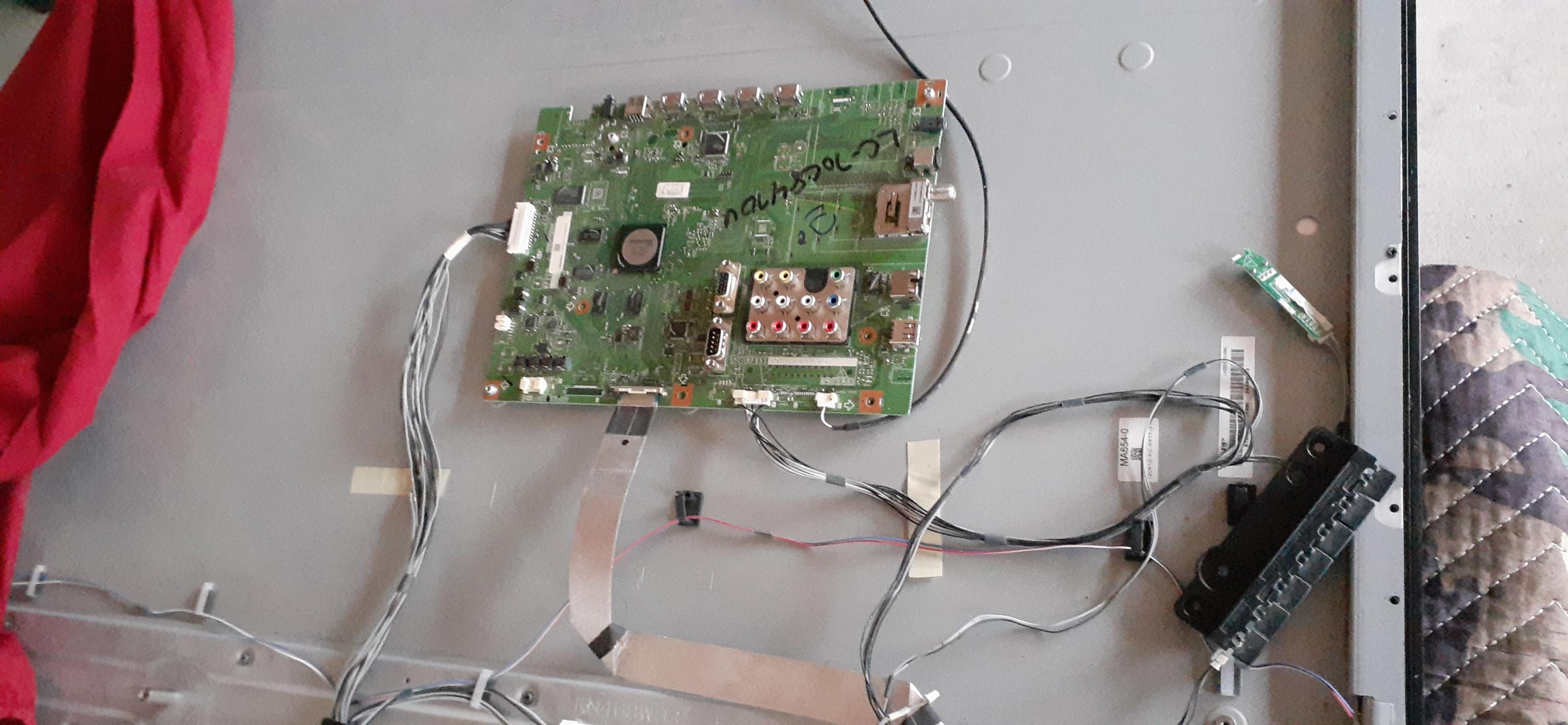

Sharp LC-70LE745U no backligth no image
  • hmendez86
    • Jun 2015
    • 344
    • united states

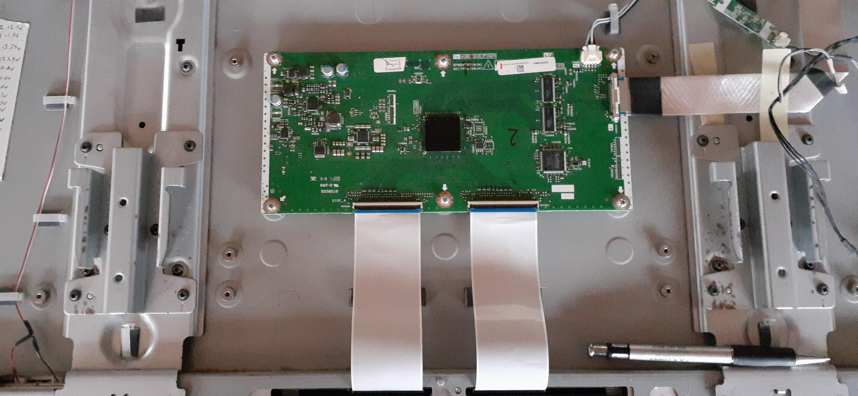

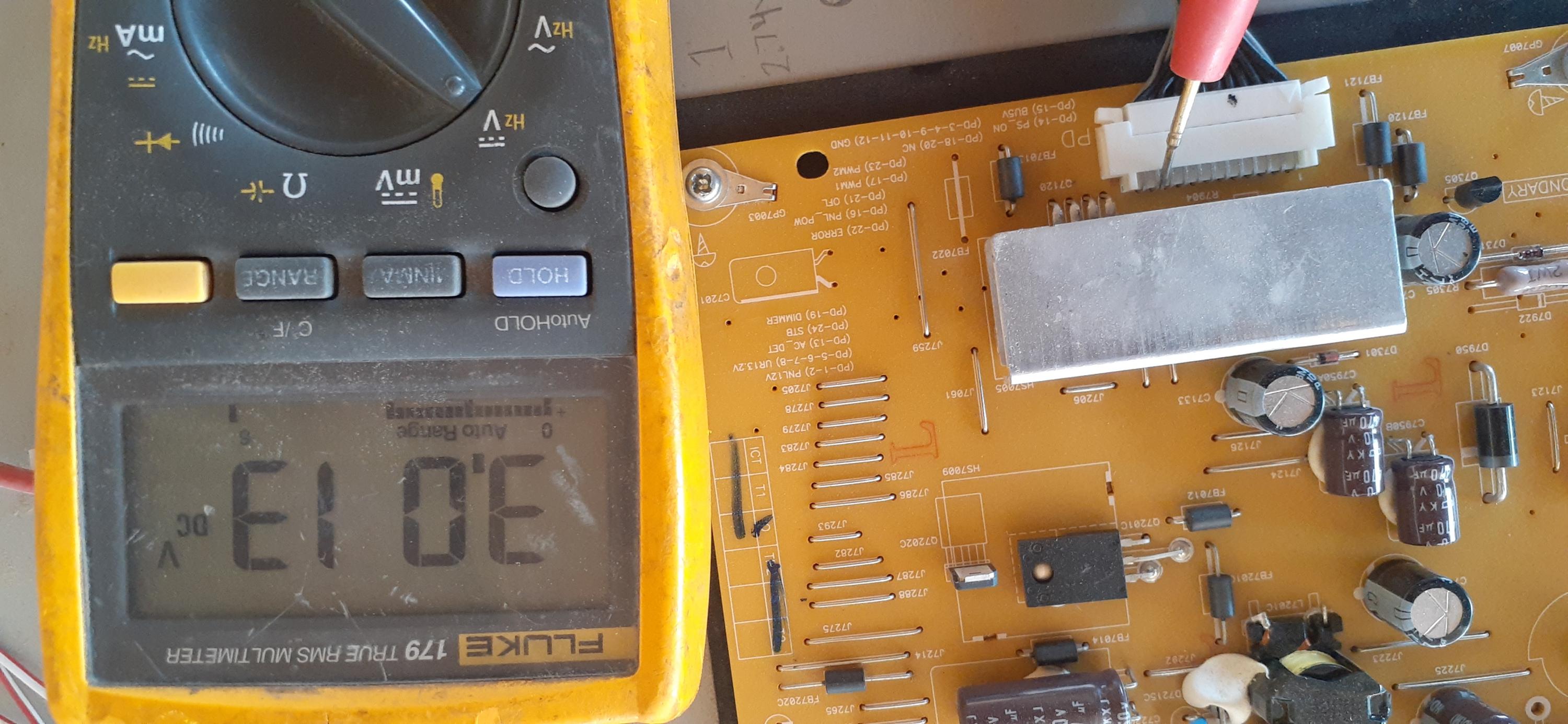

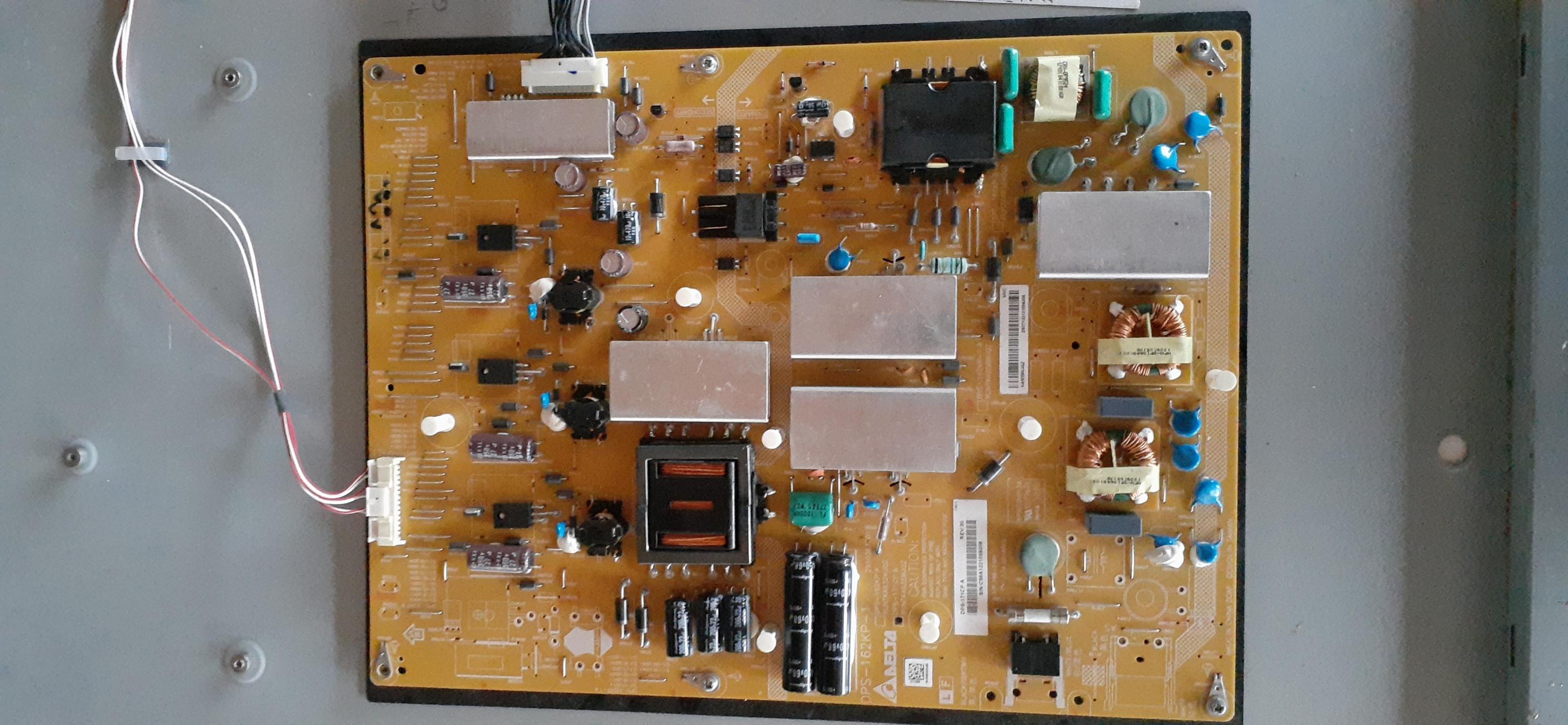

    I got this led sharp 70' inch.....i turn on the tv and i did get the geen ligth pulse on the main board and itblinks and 12v on t-con....on the power supply side am getting 83.4v for leds output....i was thinking that regulator on the power supply but neither too is working fine getting 13.2v

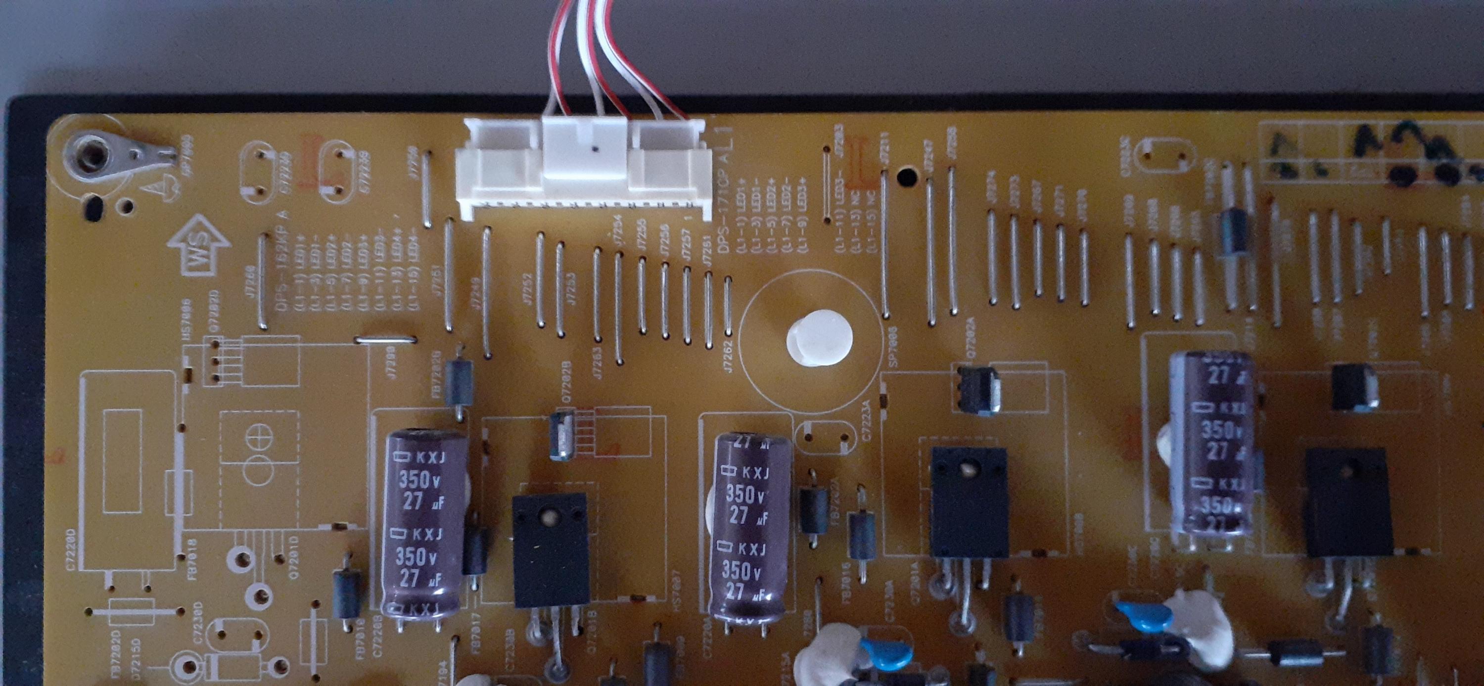

      Try test #3 below, try to do it just as instructed with the pins numbered and labeled.

        I change the power supply.....change power supply cables to main board....and still nothin.....i removed the bar leds and they all work well with my led tester...

              Re: Sharp LC-70LE745U no backligth no image
              1.pnl-12v
              3.gnd-0.0
              5.ur-13.2v
              7.ur-13.2v
              9.gnd-0.0
              11.gnd-0.0
              13.ac-det-3.3v
              15.bus-5v
              17.pwm1-0.0v
              19.dimmer-0.0v
              21.ofl-0.0v
              23.pwm2-0.0v
              2.pnl-12v
              4.gnd-0.0
              6.ur-13.2v
              8.ur-13.2v
              10.gnd.-0.0v
              12.gnd-0.0v
              14.ps_on-3.0v
              16pnl-pow-3.3v
              18.nc-33v
              20.nc-3.3v
              22.error-0.0
              24.stb-3.3

                              17.pwm1-0.0v
                              19.dimmer-0.0v
                              21.ofl-0.0v
                              23.pwm2-0.0v Looks like problem there if those are with power on, if ofl is same as bl-on then it looks like the mainboard isn't sending the on signal??
                              • hmendez86
                                • Jun 2015
                                • 344
                                • united states
                                On pin 21-ofl am now getting 3.0v
