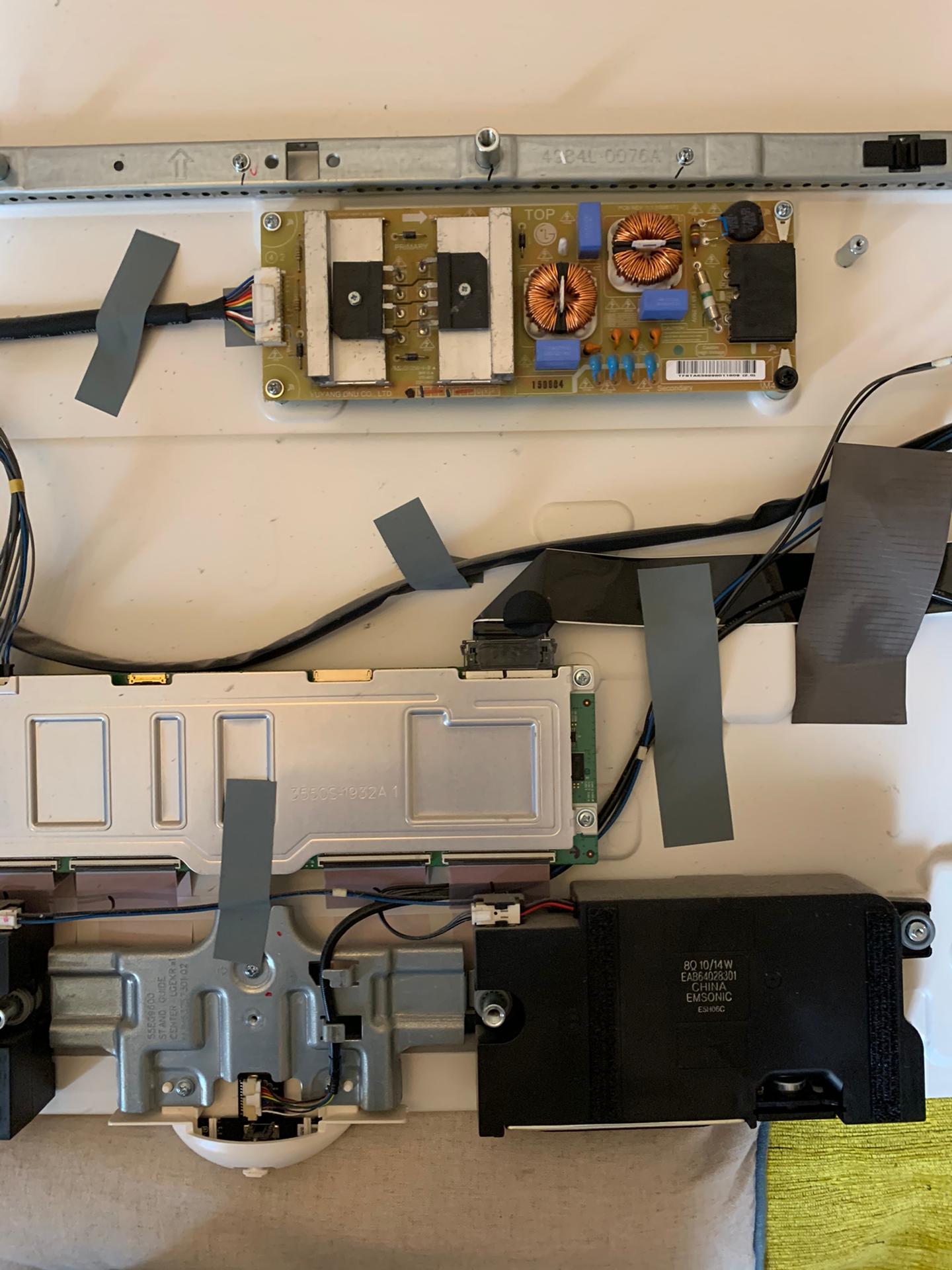

    Hello all, thank you in advance for any help
    I'm trying to find out what's wrong with an LG 55eg910v - curved screen OLED
    - issue is that when the TV is turned on it has sound but no picture, it lights up but all you can see is some marks/ shades of the last picture it displayed on a totally black screen, no moving at all.
    Also when we turn it on there is a white horizontal line that moves from top to bottom in like 3 seconds
    - changing channels and the sound from every channel is reproduced fine
    - I just opened the back panel and did a visual inspection all looking ok
    T-com, motherboard? what is more likely?
    this tv is out of warranty, LG sent some tech to check it and the guy just said it would be about 1000€ to repair, some bad panel, unfortunately I wasn't there at that time :/

    Throw up some good clear straight on pictures of each board and a picture of the whole back so we can see how they are all connected, can use the go advanced then manage attachments.

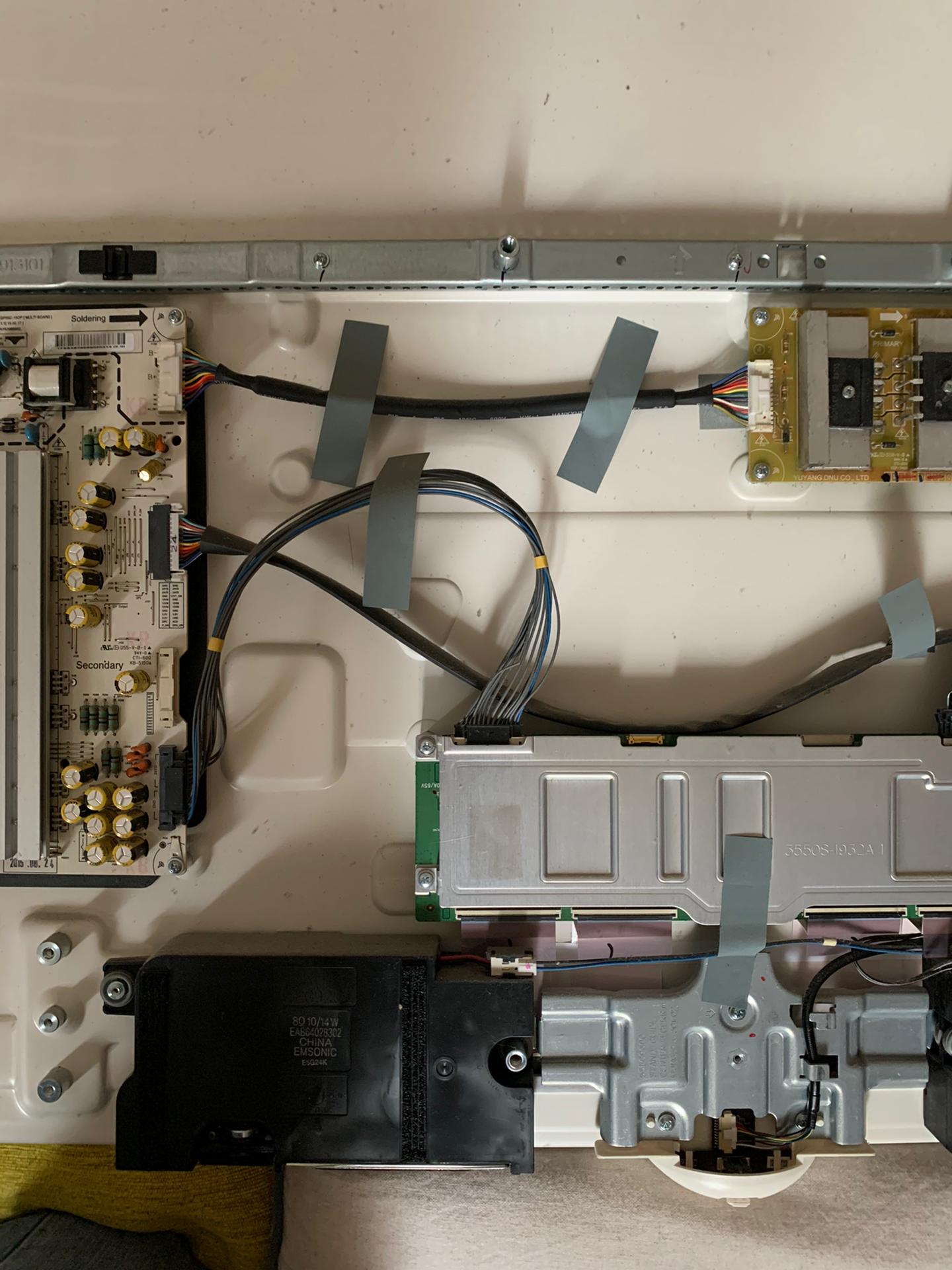

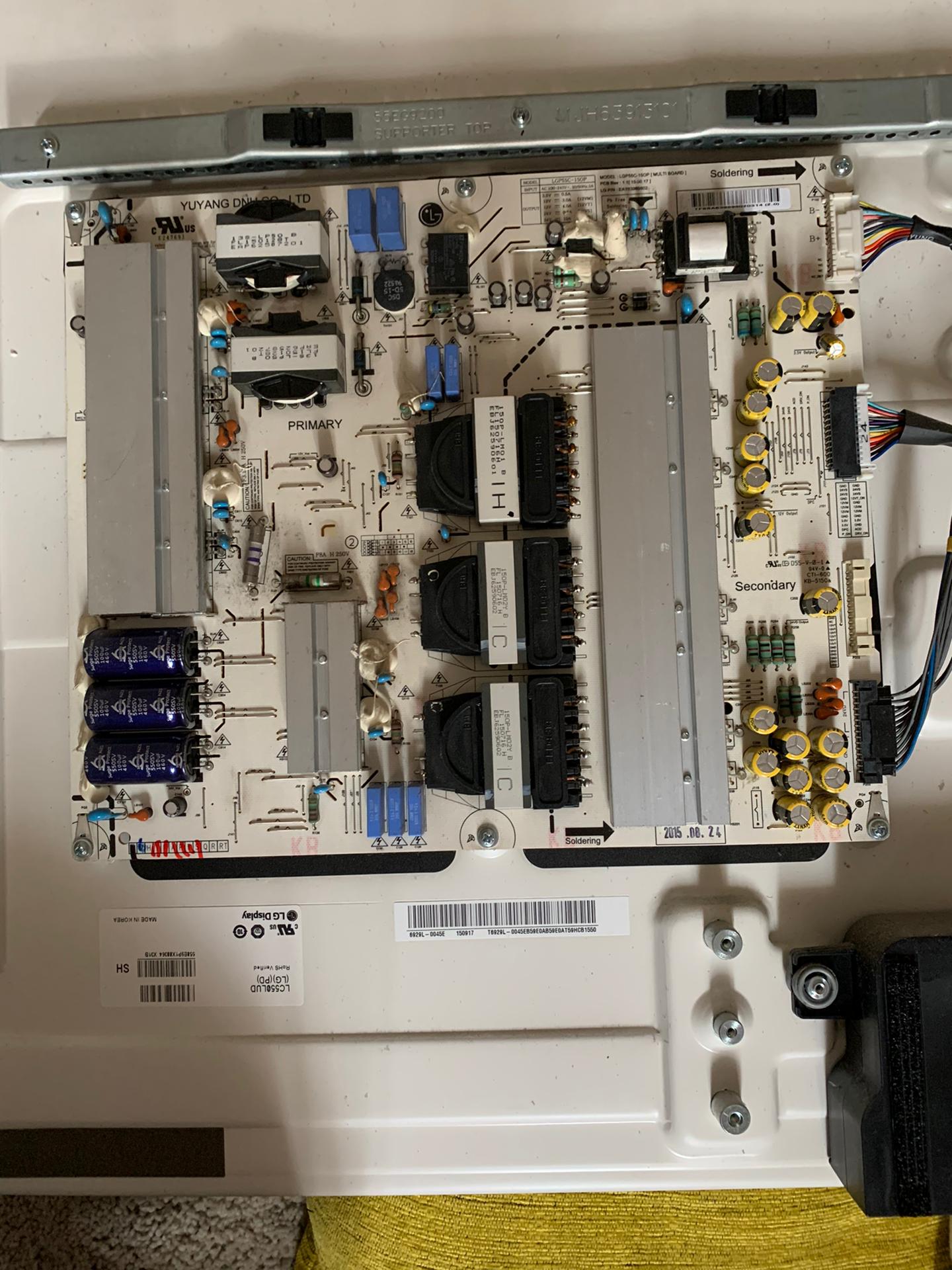

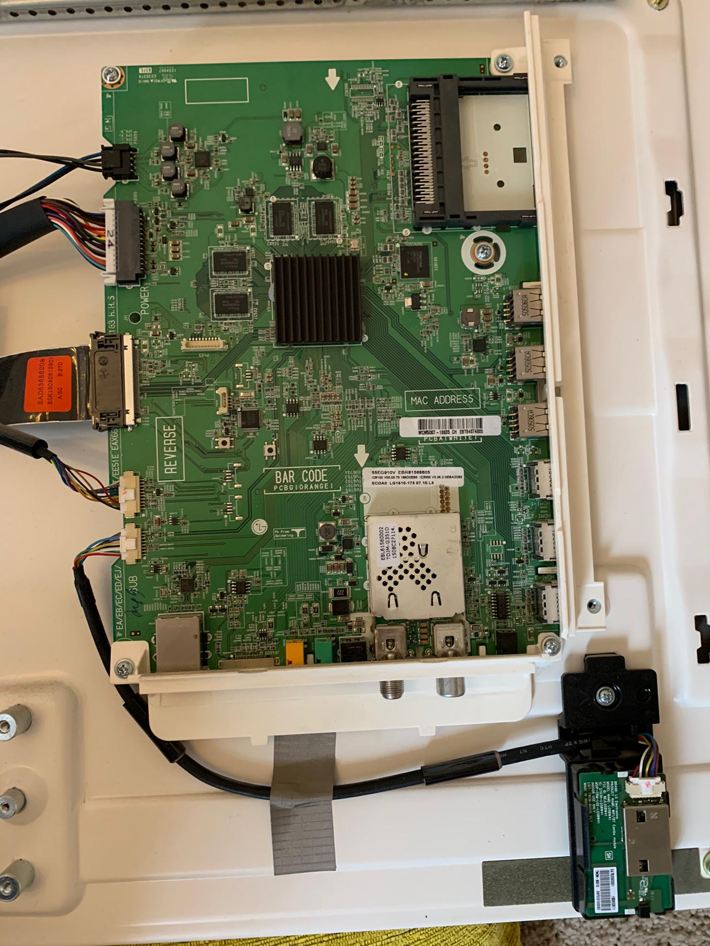

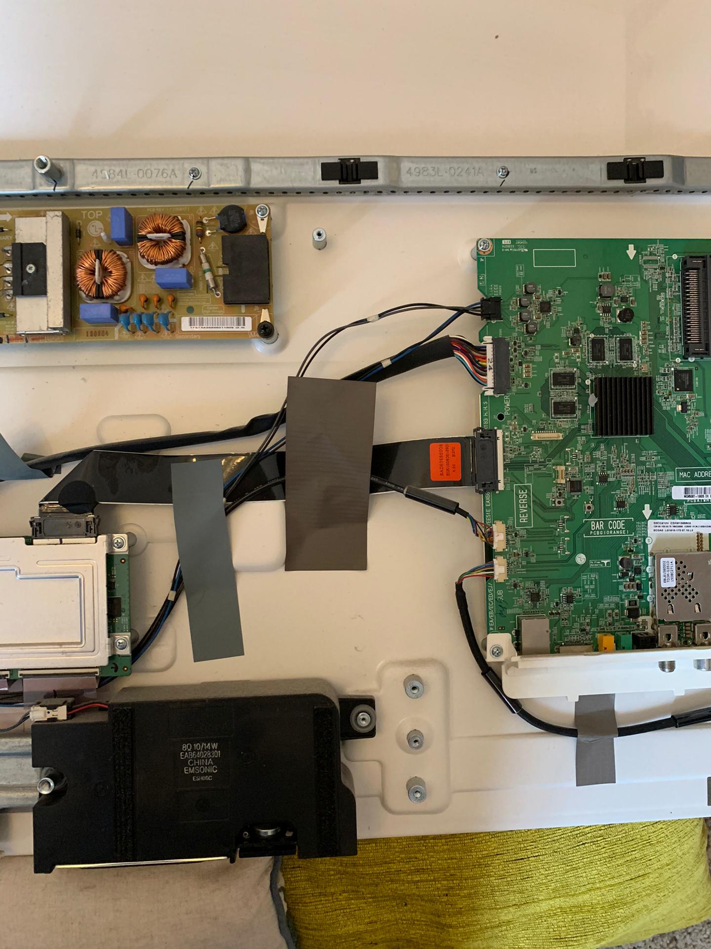

        I have the pictures from all parts attached.

                    Maybe try the disconnect one or two ribbon cables from the tcon to panel test, one side at a time and see if you get half a proper display(always disconnect and reconnect cables with tv unplugged from power)
