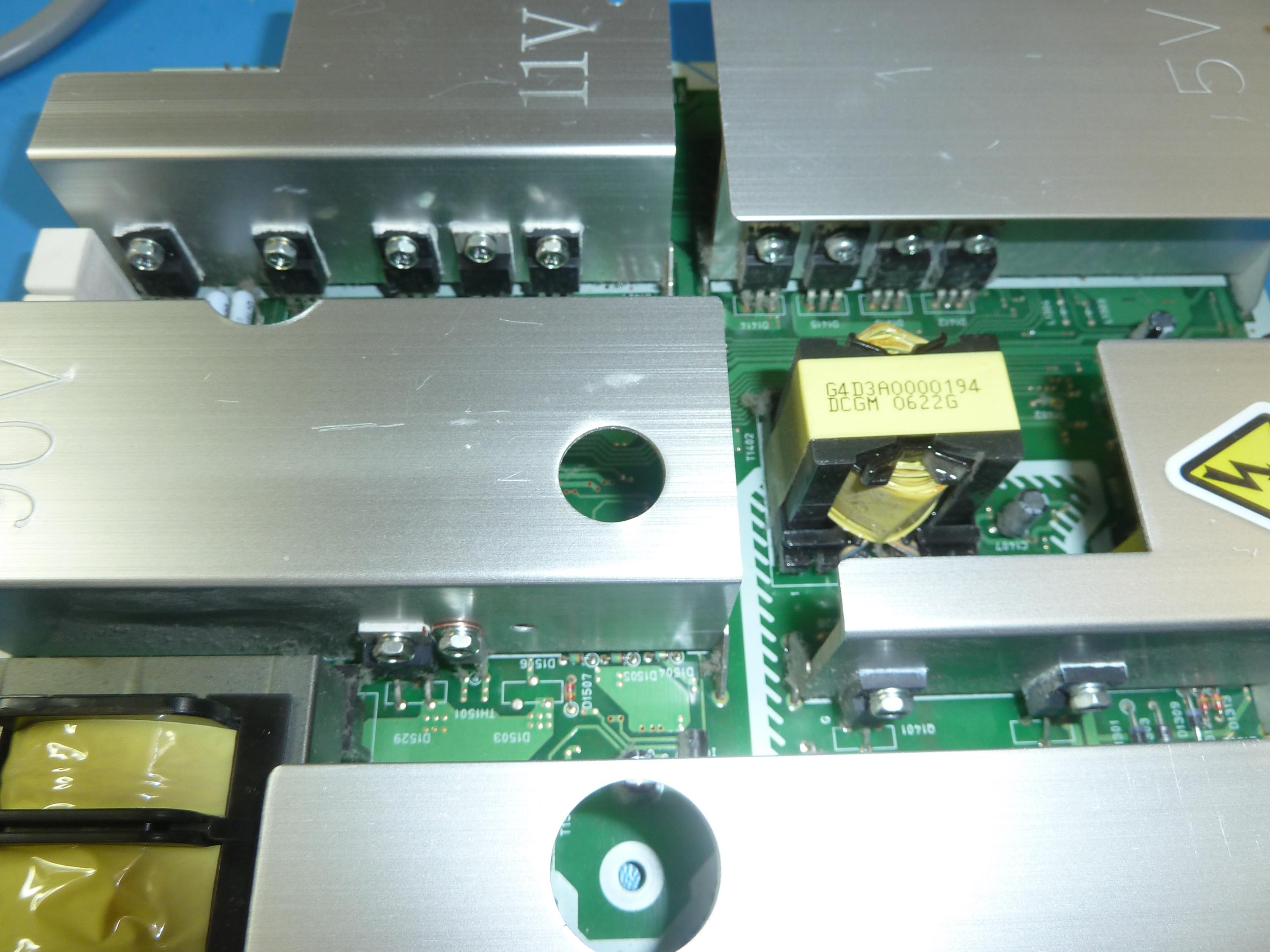

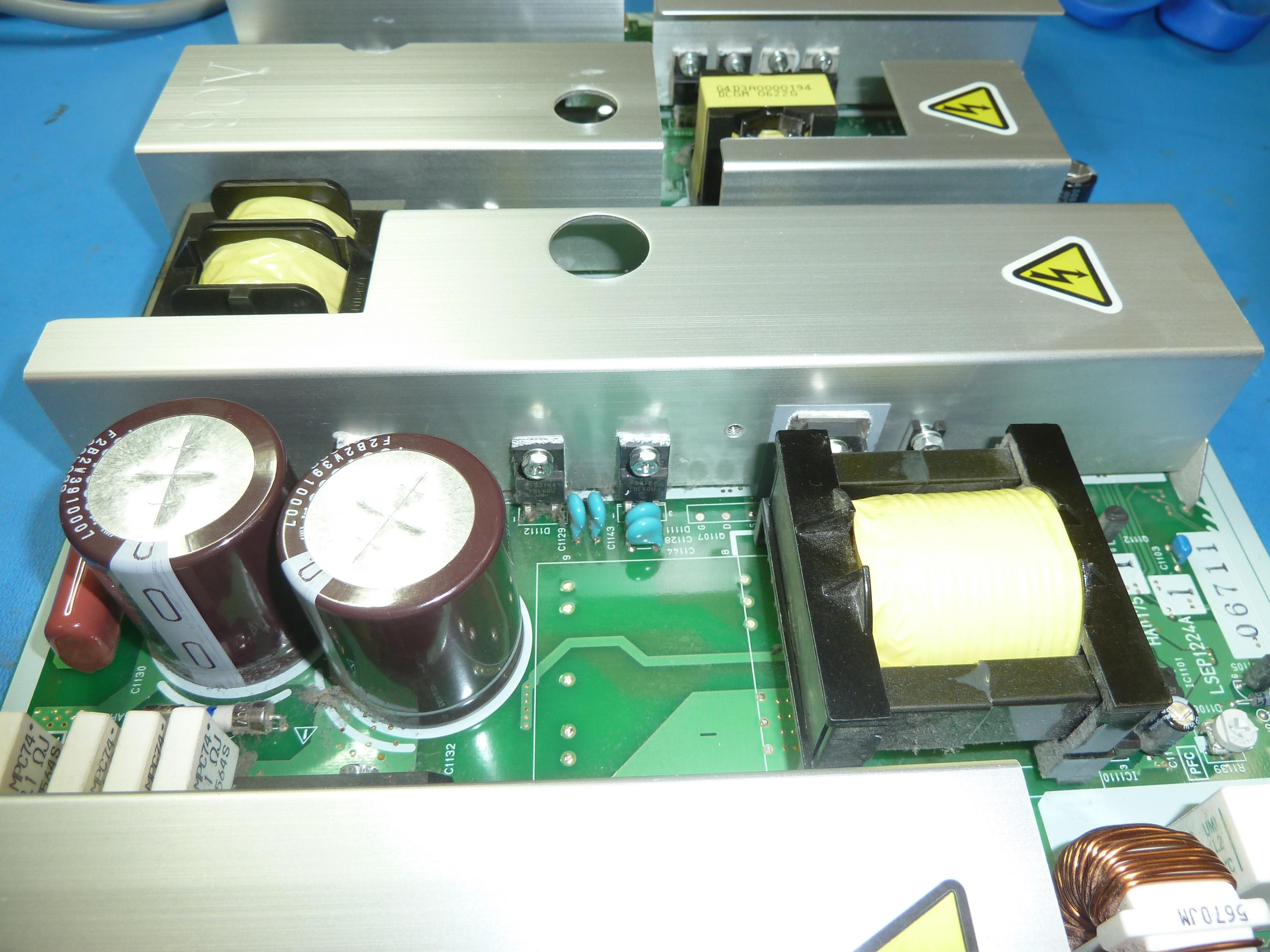

    One thing that I found interesting is that there are 3 heatsinks on the power supply board that each have a voltage labelled on them. There is 5V, 11V and 90V. When the TV is powered up with the output connector disconnected, the 5V and 11V heatsinks both have the listed voltages present on them when measuring between the heatsink and the chassis. However, the 90V heatsink does not have any voltage on it. I don't know if this is significant or not.

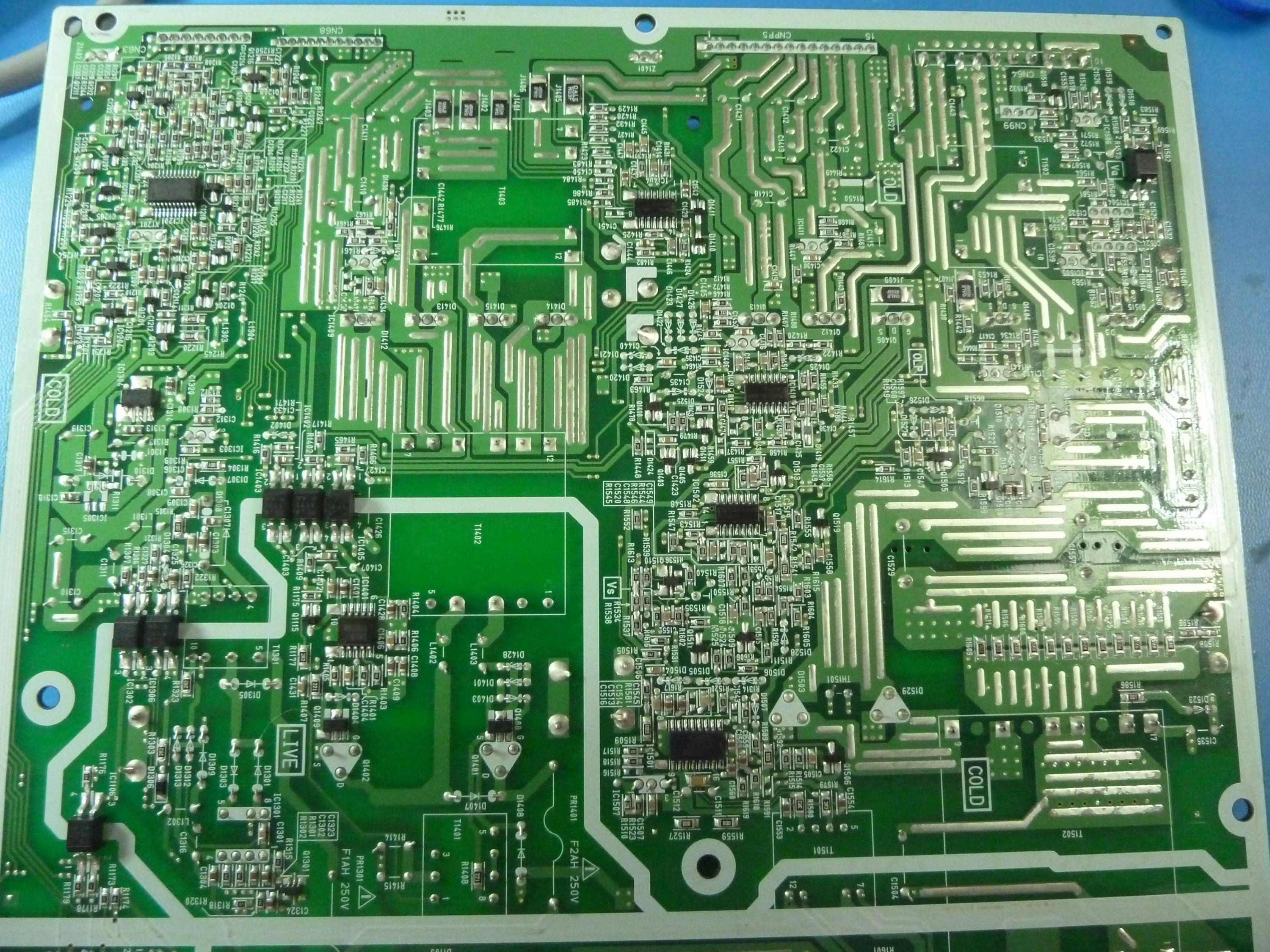

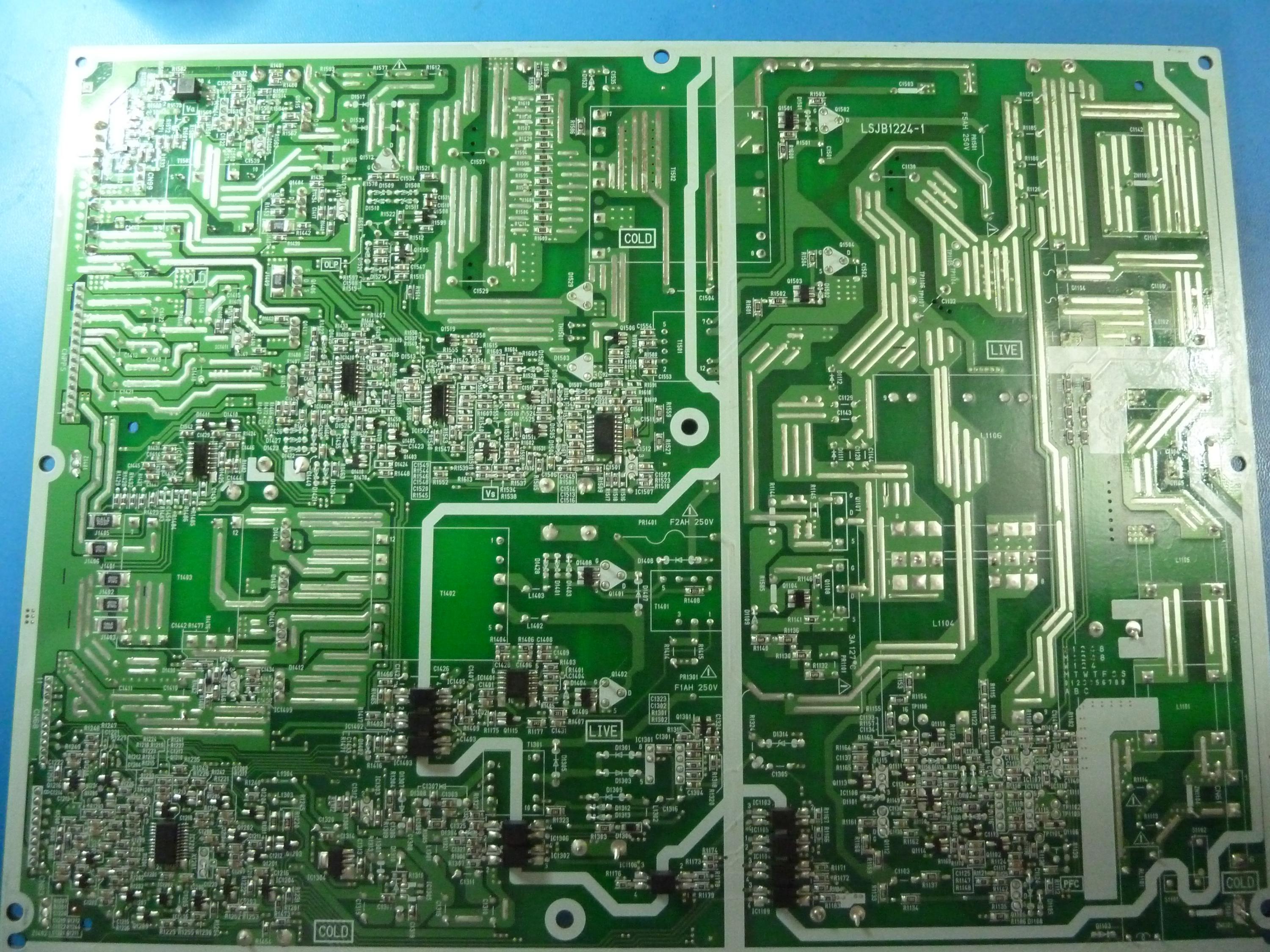

    Re: Hitachi 55HDX99 Plasma Tries to turn on then shuts off

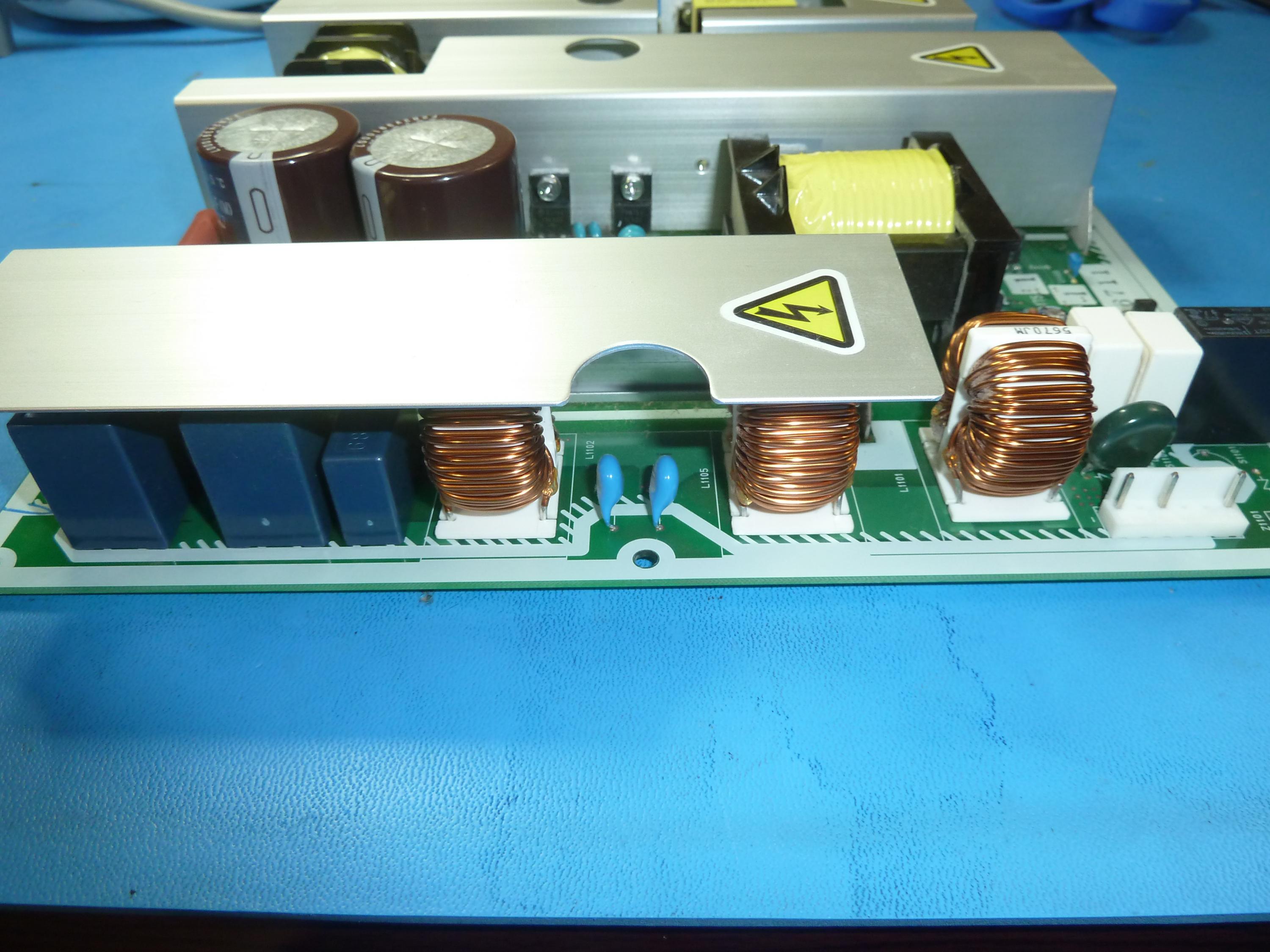

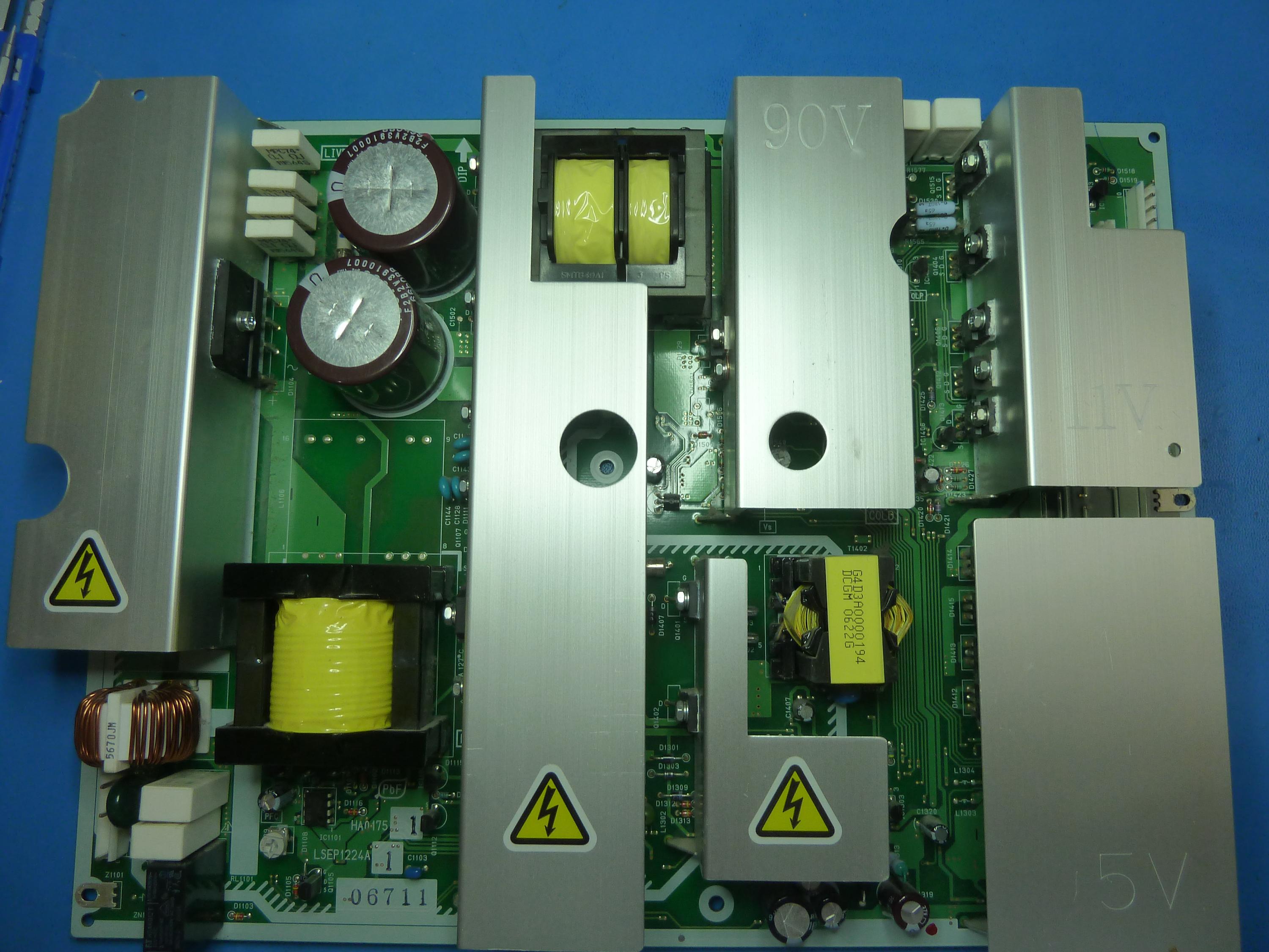

    Hey there - maybe transfer some of the photos from the original post over here?
    Would you please post a clear picture of the power board and and markings on it? Time to look up service manuals or at least pictures of this board from ShopJimmy.com
    I suspect you have at least a blown FET somewhere.
    Have you checked for shorts across the two and three terminal parts that are heat sinked? Be careful. Make sure the caps on that board are discharged first before you touch anything. I would recommend removing the power board and ohm'ing out the two/three pinned TO-220 parts that are attached to the heatsink first. You can easily do this by looking at the bottom of the board.
    Do this for the "hot" (AC) and "cold" (DC) sides of the board.

      Sorry, I thought I did upload some pictures. Looks like they didn't attach. I downloaded the service manual for the TV but it doesn't have any board schematics in it which is a shame.
      I will do those tests on the power board and report back.

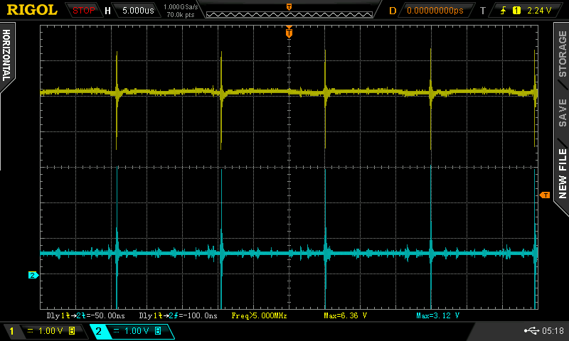

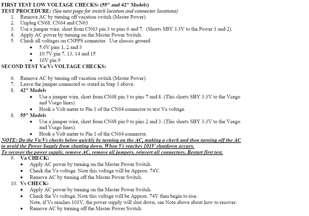

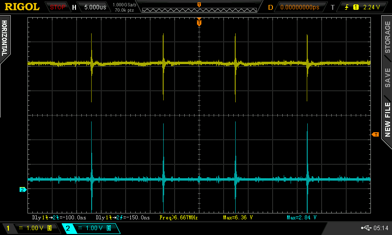

          I have attached some waveforms of the voltages at the plugs when the tv is being turned on. With the plug connected to the power supply I get the 5V rail but the 60V and 90V rails only get up to about 0.5V and stay there for a few seconds before the TV shuts off. When the plug is disconnected, the 60V and 90V rails behave exactly the same, however, I no longer get the 5V rail. With the plug disconnected, the TV will stay powered up until I turn it off. Doing this must trigger some failsafe because when I reconnect the plug, I still have no 5V rail and the TV stays on. After a long enough time it will go back to shutting itself down.
          I originally had a bad buffer board on this TV and the symptom was that the TV would stay on, but the screen wouldn't come on. Right now it just turns itself off which is a different symptom than with the bad buffer board. Just to rule it out I tried it with the upper board disconnected and then the lower board disconnected. Both times the symptoms were exactly the same and the voltages on the plug of the power supply were the same. It powers up, then as soon as it is about to fire up the actual screen, it shuts down. I am measuring the voltages at CN64 on the power supply board and have attached a page from the service manual specifying what those voltages should be.
          Since the power supply connects to the X-sus board and then the Y-sus board connects to that, I disconnected the power cable between the X and Y sus boards and it responds exactly the same as it does when the cable is disconnected right at the power supply. This seems to suggest to me that if it is not a power supply fault, then it must be on the Y-sus board.
            You can test the power supply by itself but you will need a load on the Vs output, you can use a 60watt incandescent lamp as a load and see if the supply stays up.
            If the Vs exceeds 101vdc the power supply will go into shutdown and will remain that way untill reset

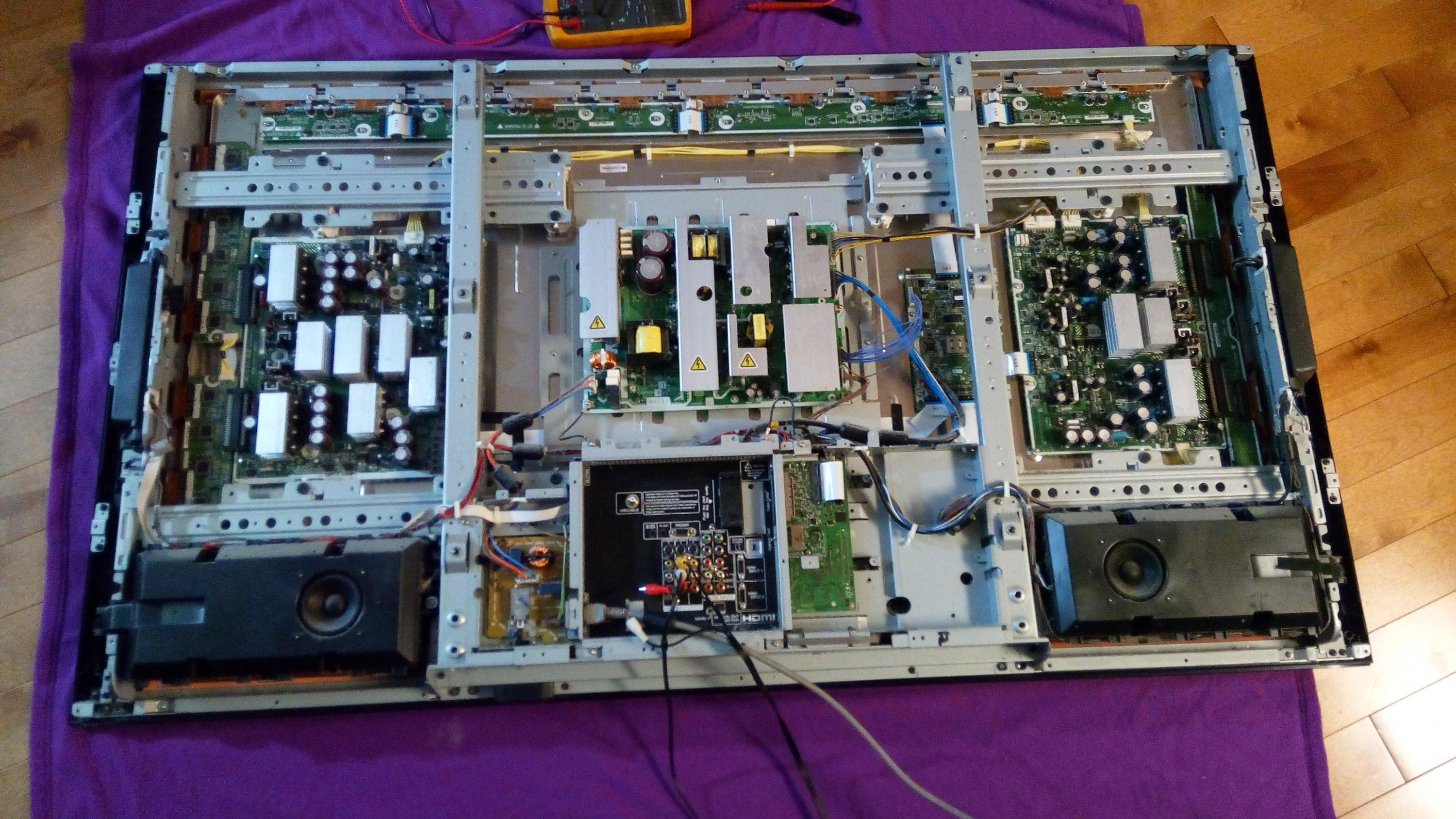

                          Ok, so I took the power supply board and the little filter board with the ac jack on it out of the TV and to the bench. I connected pins 3,6,7 on CN63 together and pins 2,3,9 on CN68 together. I connected the light bulb across the 90V pins and ground pins on CN64 and also connected my multimeter across the light bulb.
                          I applied the power and got no voltage on the multimeter and no glow from the light bulb. Very shortly after the power was applied, the relays clicked and the power supply shut itself down.
                          I double checked that I had all the correct pins connected on the right connectors and everything was good. So I'm not sure why I'm not getting any voltage out of it.
                          I also followed the procedure you posted for testing the board in the TV and got the same results. All of the low voltages are present in the first test, but I have no Va or Vs voltages and the power supply shuts itself off very quickly. After disconnecting and reconnecting the jumpers, the power supply resets itself.

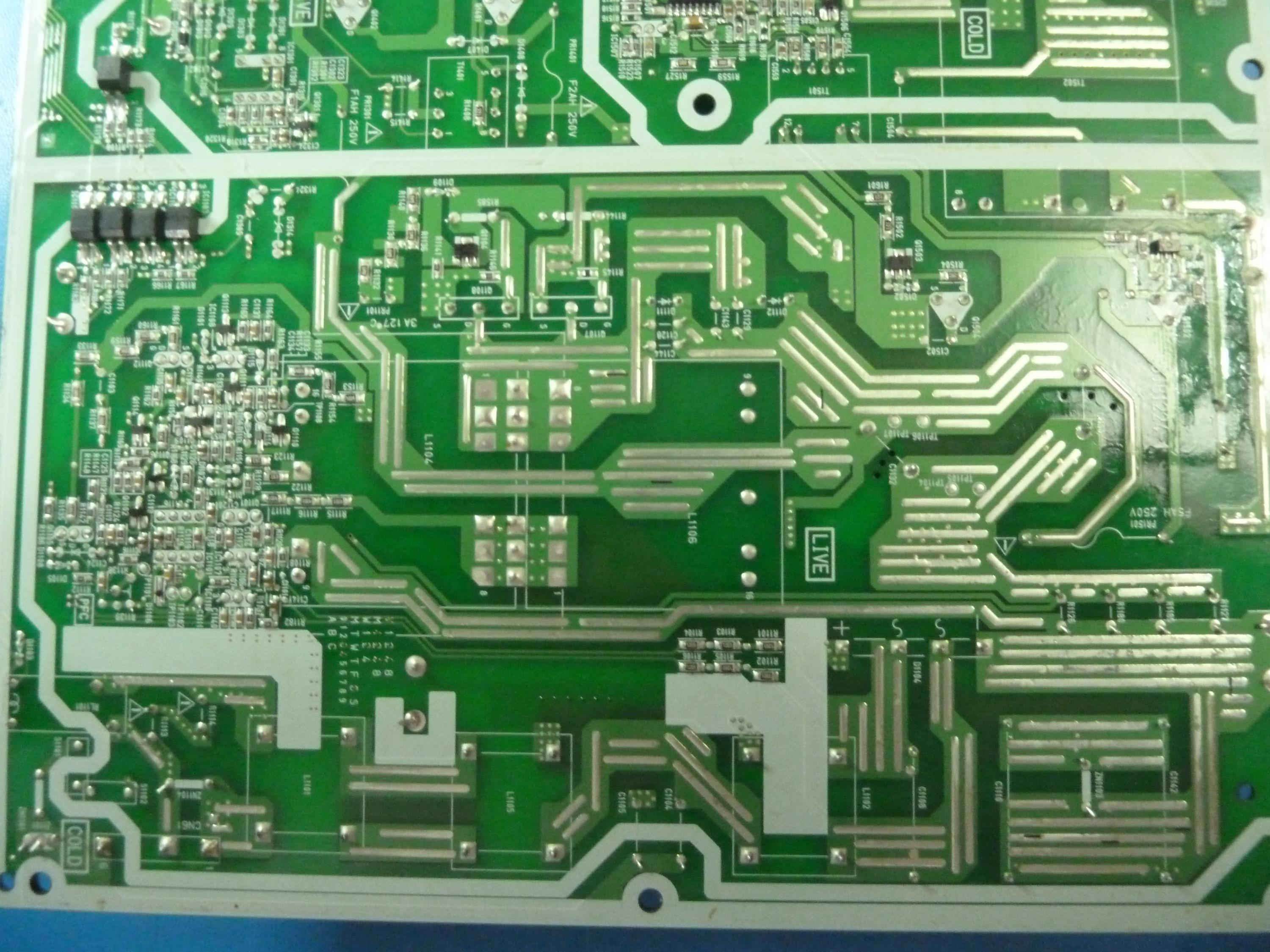

                              I tested the PFC voltage with the board in the TV and all the other connectors plugged in and I get 336V on that fuse the whole time the TV is on until it turns itself off. With CN64 disconnected so that the TV stays on until I shut it off, I get 336V the entire time the TV is on.
                              The solder joints on those two transformers looked fine but I reflowed them all with plenty of flux just to be sure. It had no effect on the symptoms.

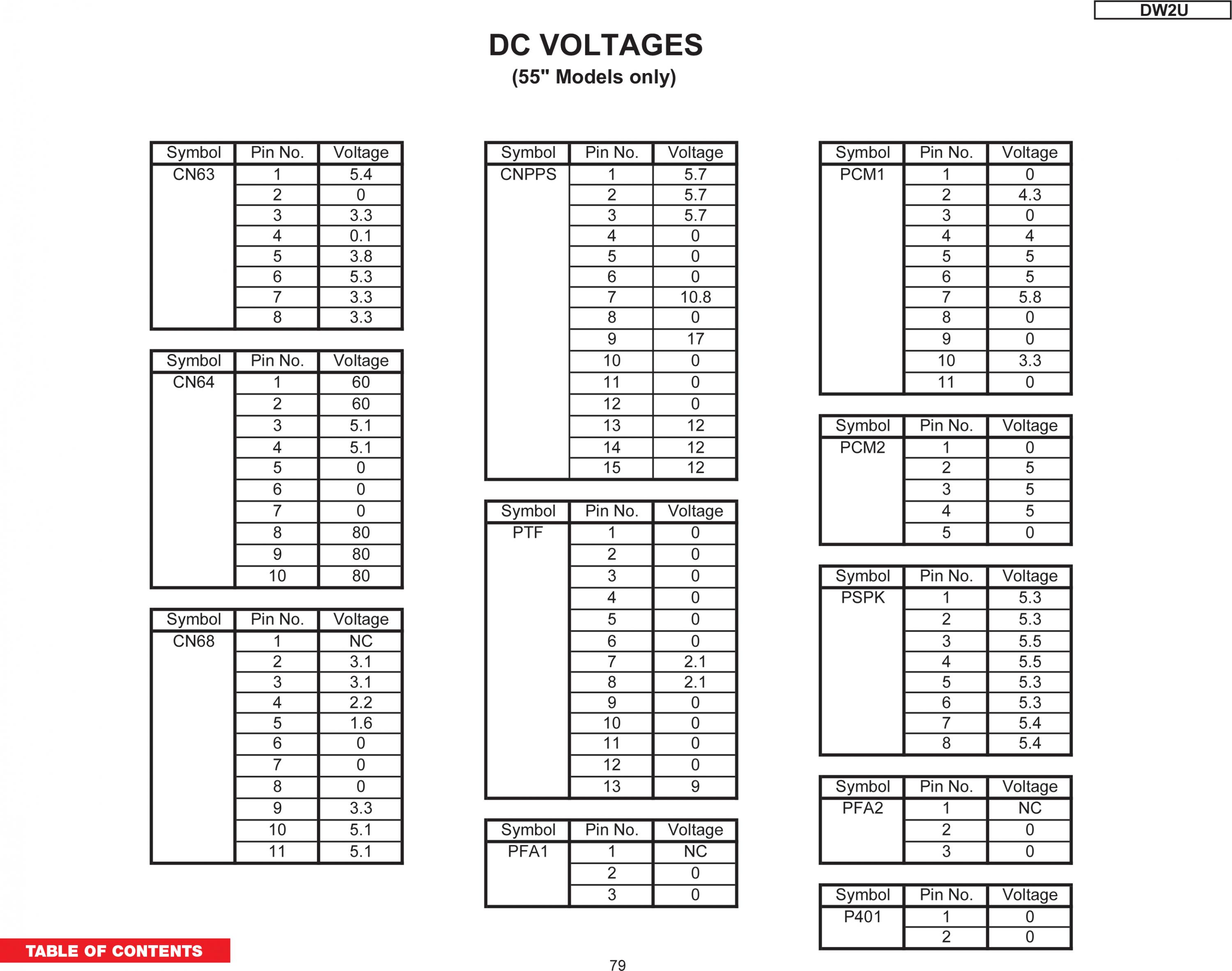

                                Have you checked that you have all the voltages on plug CNPPS, when ON
                                pins 1~3, +5.7v
                                pin 7, +10V
                                pin 9, +16V
                                pin 13~15, +12v
                                Pins 4,5,6,8,10,11,12 GND
                                Also that pfc voltage seems low, There could be a small fuse (PRI101) open.

                                  All of the voltages are present except pins 13-15 have 10.8V instead of 12V. On the test procedure you posted, it says pins 7,13,14,15 should have 10.7V which is what I am getting.
                                  canadaboy25
                                  -Sometimes the light at the end of a tunnel is an on-coming train
                                  • R_J
                                    • Jun 2012
                                    • 9627
                                    They are correct, +10.7 is what they should read. there is very little information on these tv's. Did you check that PRI101 (thermal fuse) is ok. it is just for the pfc circuit.
