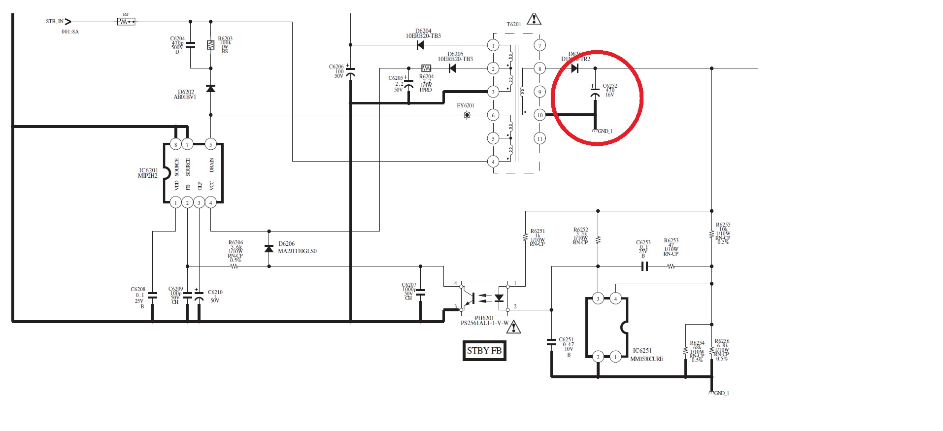

Sony 46HX900 power supply dead

    Re: Sony 46HX900 power supply dead
    So you are saying that you took those caps off and checked them with an esr meter??
    All checked all ok
      thanks to all
      problem solved
        Are you going to say how it was resolved?
          Uh...yeah what Dick said...how was resolved??
            due to bad cap C6252 470uf 16v was leaked
