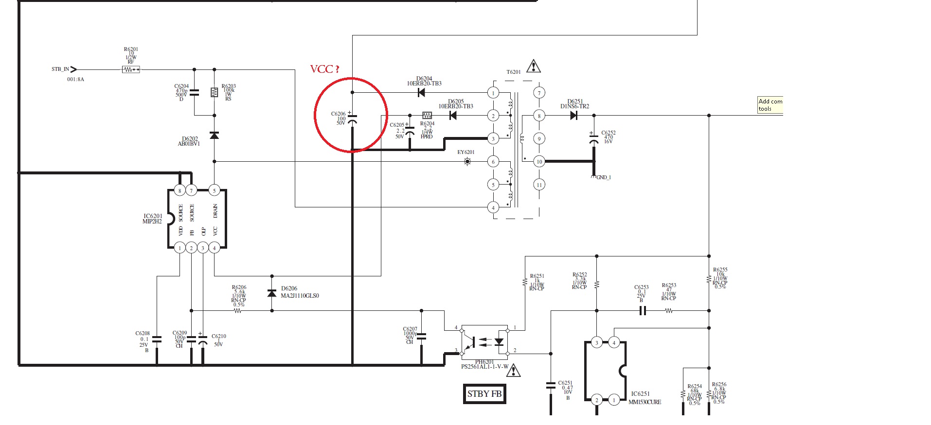

    Sony 46HX900 power supply dead
    please help me to find volts PRI_VCC on C6206 sony G6 power supply

    Re: Sony 46HX900 power supply dead

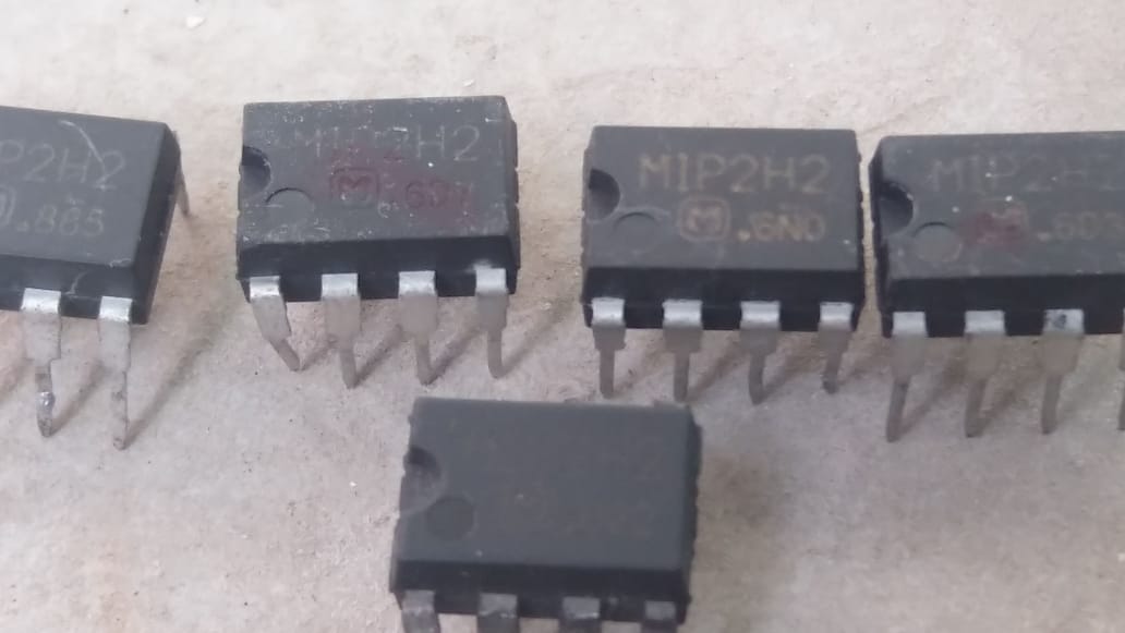

    friends i am unable to find IC MIP2H2 so going to change its stanby control.
    i have need output volt from D6204 on C6206

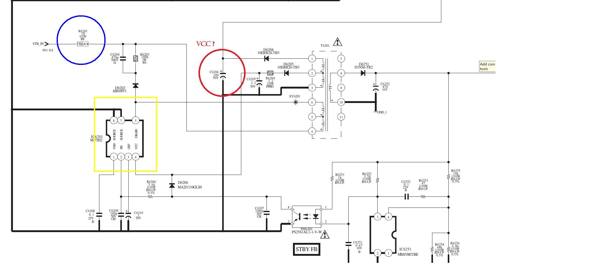

      1) What do you use for GND test point when you are measuring Voltages on the HOT side of the circuit?
      2) Did you check the Fusible resistor (10 Ohms) R6201 to make sure it is showing 10 Ohms.
      3) What Voltage do you have on STB_IN?
      4) What is your country AC Voltage, 120V? 230?
      5) Upload the schematic of the power supply you have.
        Like budm said, check R6201, if it is open, IC6201 is likely bad, you will need to replace both
            So what Voltage do you have on the VCC pin of the IC?
            R6204, D6204, D 6205, C6205 are good?

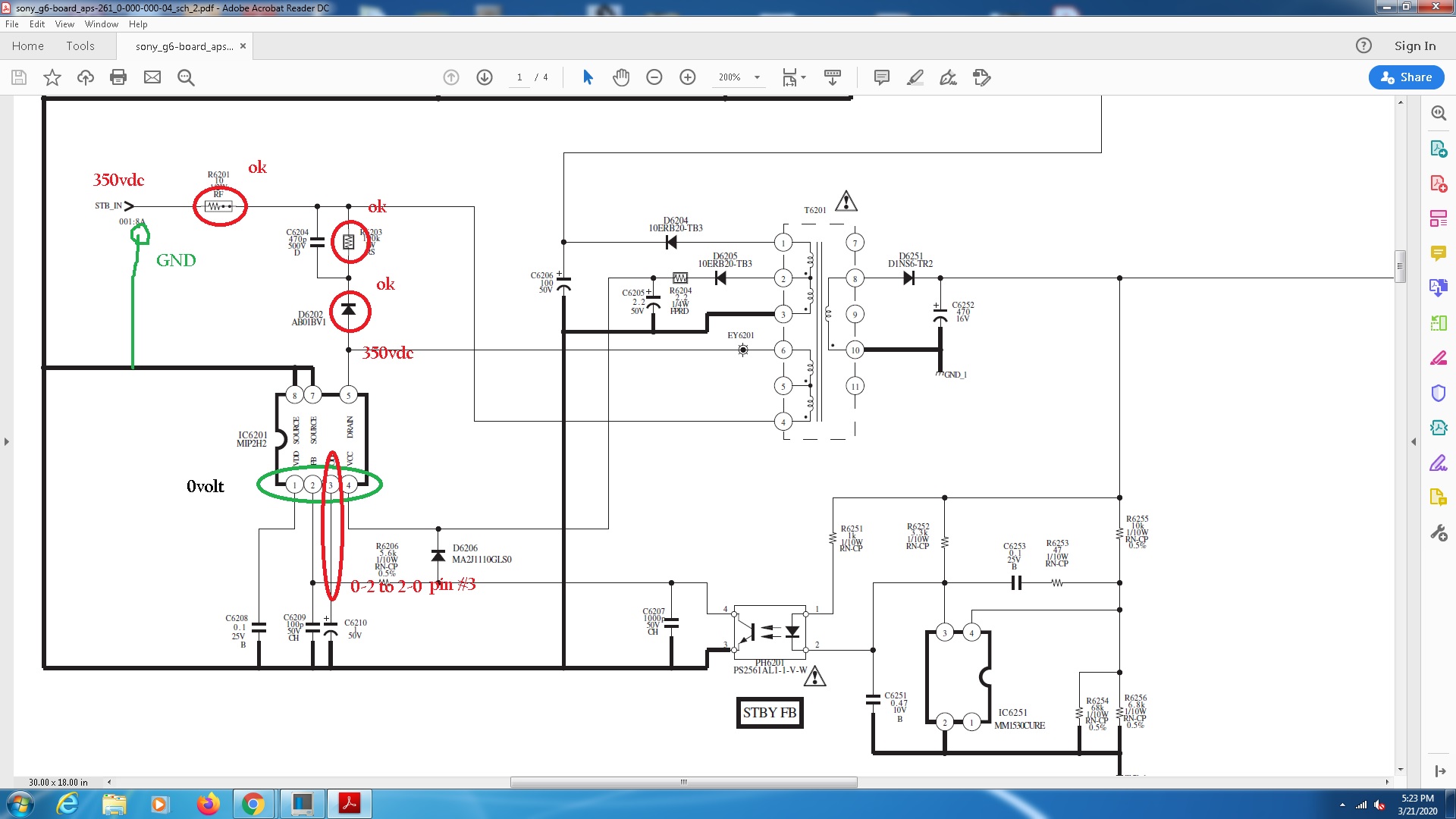

              R6204, D6204, D 6205, C6205 are ok
              pin1 0
              pin2 0
              pin3 0 0 1 2 then comeback 2 1 0 repeatedly
              pin4 0
              pin5 350
              pin7 0
              pin8 0

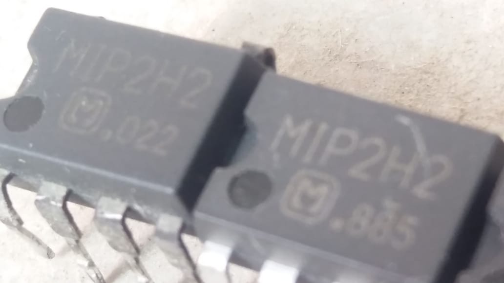

                  Did you replace the MIP2H2?

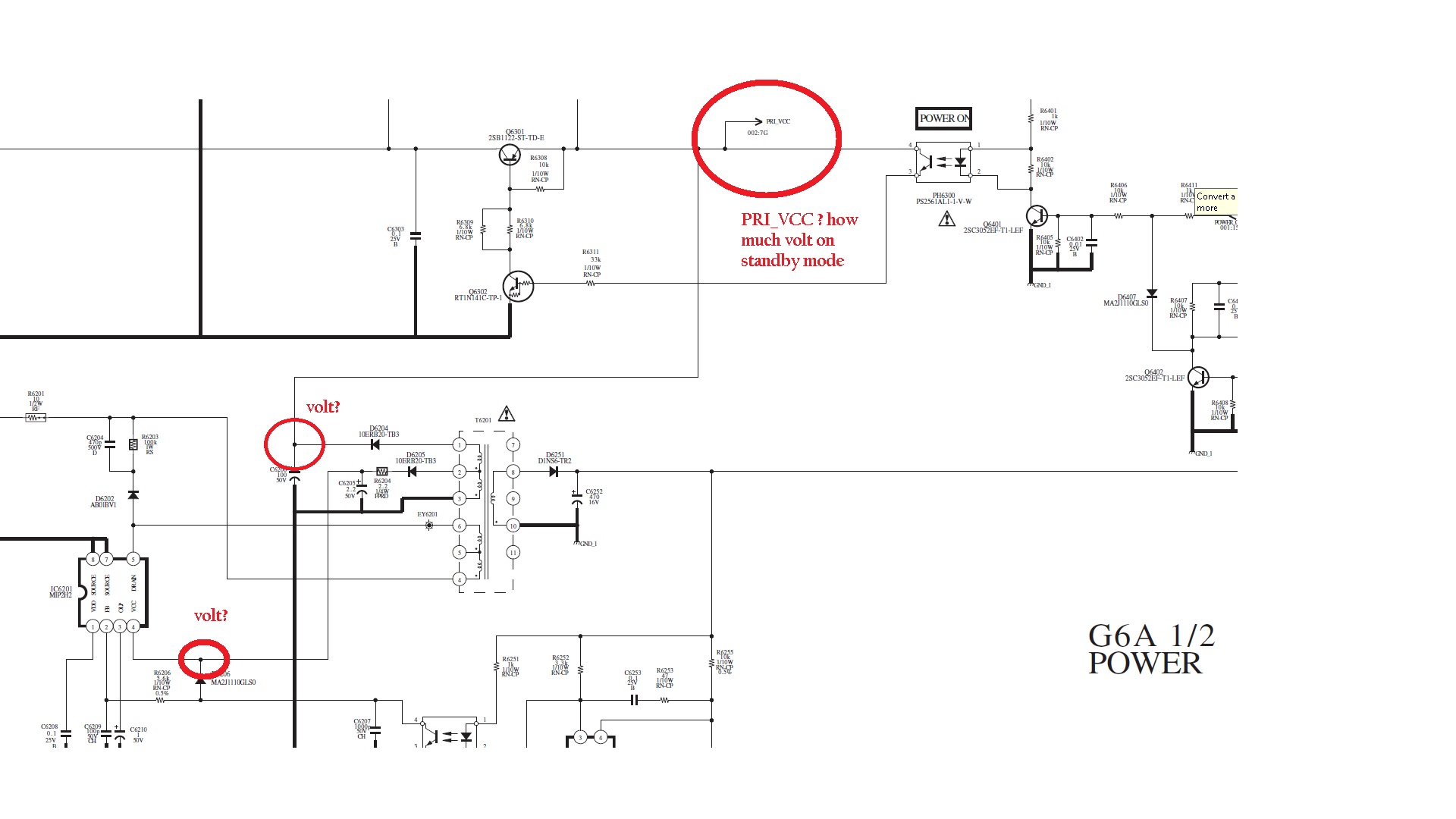

                    Ic is not available in local market so going to modify standby circuit i have just to confirm its PRI_VCC volt.
                    12v, 5v or other
                        i have replace the ic
                        volts on ic
                        pin1 5.8v
                        pin2 1.8v
                        pin3 0-2v 2v-0 repeating
                        pin4 4v
                        pin5 350v
                        Pin 7,8 0v
                        voltage on pin3 are varying 0-2 2-0
                        plz help to resolve this issue
                          Is C6210 ok?
                            Is the STBY_3.3 voltage stable?
                            Have you checked the following components?
                            D6204
                            D6205
                            D6251
                            C6205
                            C6206
                            C6252
                            R6204
                              i m getting same voltage after changing on all ic's
                                D6204
                                D6205
                                D6251
                                C6205
                                C6206
                                C6252
                                R6204
                                All components are ok and STBY_0 voltage ,
                                i have replace the ic. new and old both ic's giving same voltage
                                all ic (MIP2H2) giving same volts
                                pin1 5.8v
                                pin2 1.8v
                                pin4 4v
                                pin5 350v
                                Pin 7,8 0v
                                • nomoresonys
                                  • Jan 2013
                                  • 12081
                                  • U.S.
                                  So you are saying that you took those caps off and checked them with an esr meter??
                                  • dick_barton
                                    • Aug 2015
                                    • 6642
                                    • Wales
                                    You are getting 4V on pin 4 which is the supply input for the IC. That voltage is coming from somewhere.
                                    What point are you using as ground (negative lead of meter) reference to measure the voltages on IC6201
                                    • dick_barton
                                      • Aug 2015
                                      • 6642
                                      • Wales
                                      What point are you using for the ground reference (negative lead of meter) to measure the voltages on IC6201
                                      • renee
                                        • Jun 2010
                                        • 21
                                        i am using C6510 negative point
