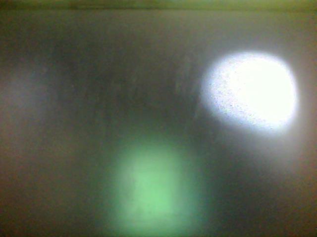

    Okay,
    Since we are in lockdown (excuse me "Enhance Quarantine") here in Luzon Philippines I am trying to keep busy by troubleshooting things. This Toshiba was working fine last month when I sat it aside. Now it has a what area in upper right corner. It looks like a pressure spot to me but it was stored upright without anything touching it. Ignore the green blur in the photo, its the reflection of the laptop screen. I had to use the webcam. The crystalline appearance of the white spot is actual.It is transparent and video is well visible behind it but it is annoying
    Many thanks for any assistance.
    Bill

    Re: Toshiba 24HV10E white spot on screen
    Maybe the lens has fallen off the led?
      He dropped a lens from a led.
        Thanks for the lead. I have watched a couple of videos on replacing the caps and it looks straightforward. I am hesitant to try it right now though with the grandkids inside because the quarantine.
        Again thanks, guys.
