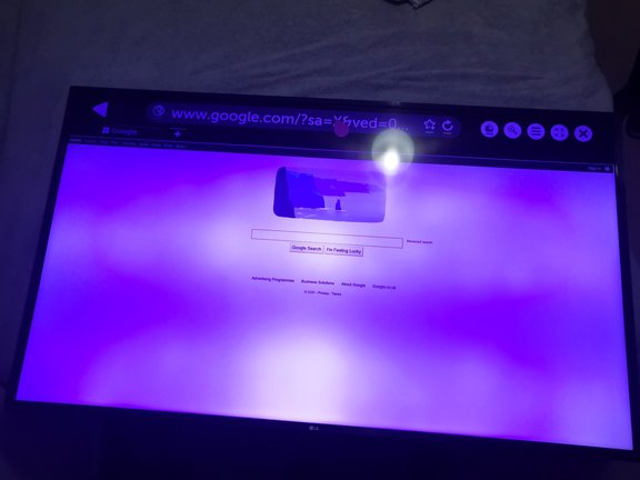

    Lg 60uj630v led problem
    Just picked this tv up. The whole screen has a blue tint and on a white background it's very patchy with darker and lighter spots. Does this look like dodgy leds?

    Re: Lg 60uj630v led problem
    https://www.badcaps.net/forum/showthread.php?t=80139
    Looks like the same style of LEDs if you google the strips for that model. A big flat round lens with 4 black glue dots.
      Thanks for that I've picked a doner set up with a cracked screen hopefully they will be ok
