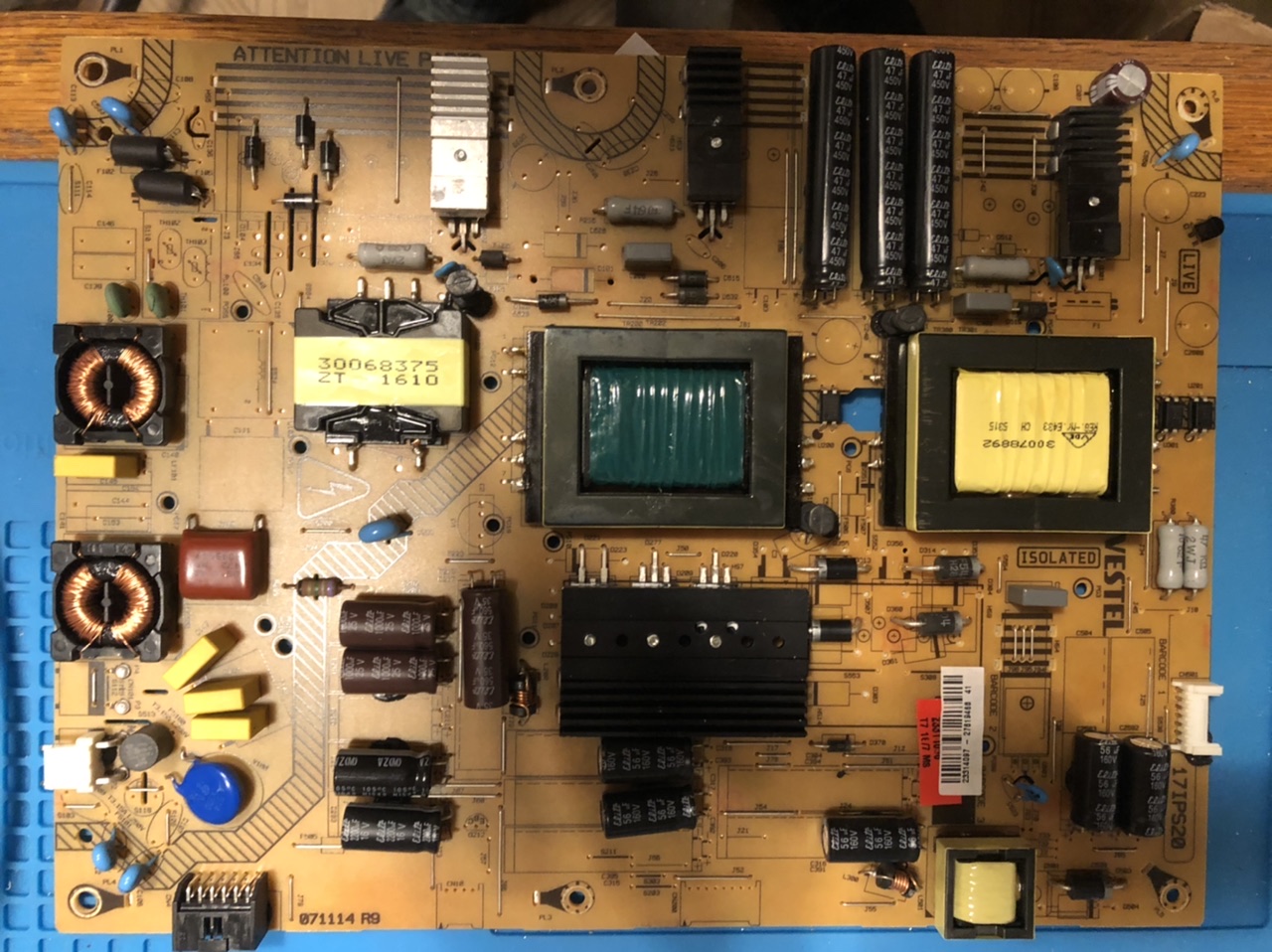

      I don't know the version of your power supply so post some pictures, I would suspect the small elec. caps. like C240 & C207

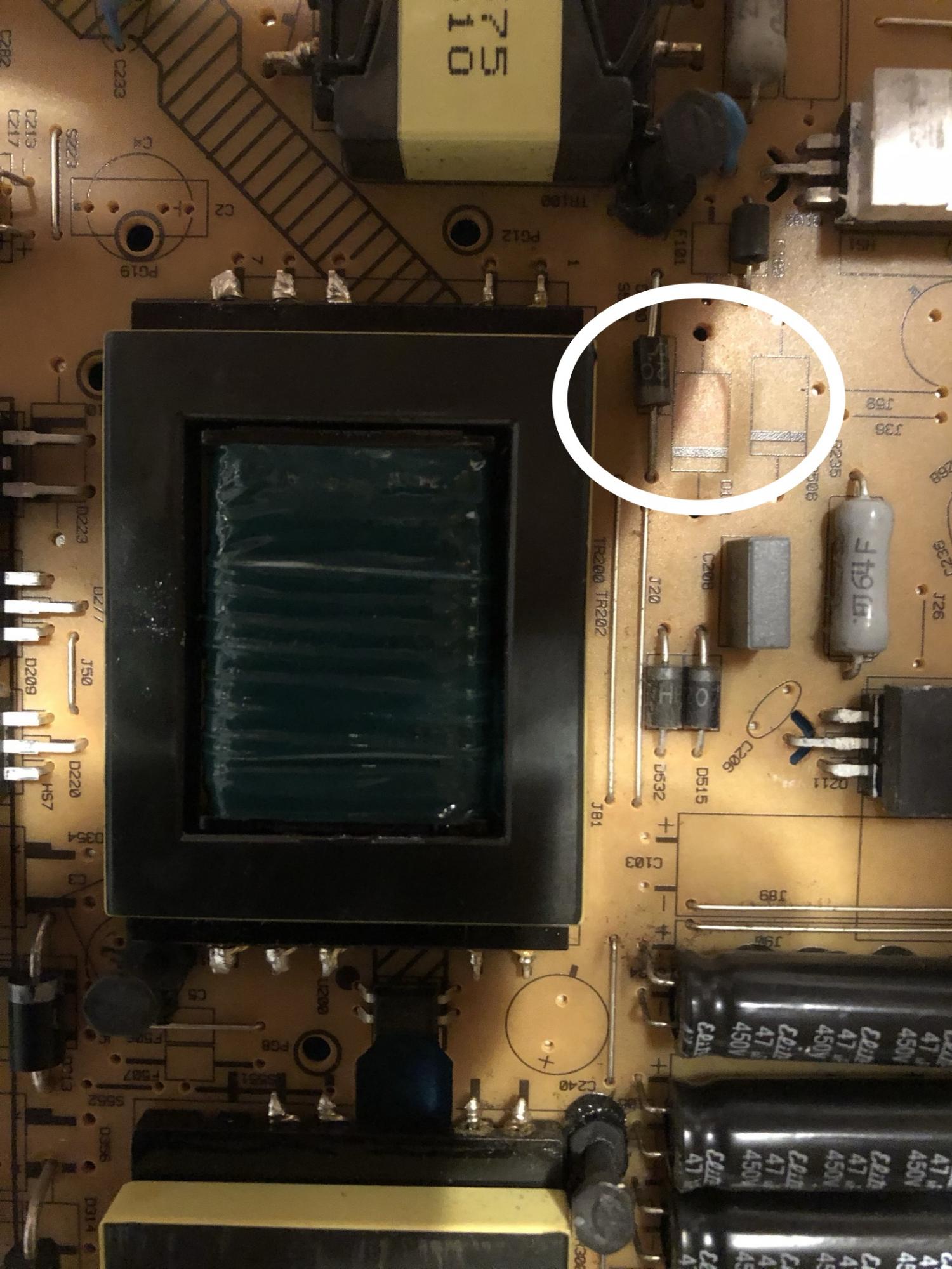

        just checked and D101 MUR460G is shorted fully both ways. Just ordered some from cpc farnell.
        I'll update when they're fitted.
          Re: Celcus 48UHDSB-0/1 - intermittent shut down
          Where is this D101 located on the board? Pictures of the board will help.
          I cannot see how shorted diode will allow the TV to be working for 45 minutes then shutdown.
            Looks like the diode is in the B+ line just after the PFC fet, so it was likely a low B+ condition allowing the tv to work for a short time.
              Here are the pics of the board
                So that means boosted PFC Voltage is not present if the PFC Diode shorted out and the circuit does not have have PFC Voltage shutdown either to keep the cost down
                  Replaced Diode and running perfectly now😊
                  Thanks for the explanation of what was happening.
