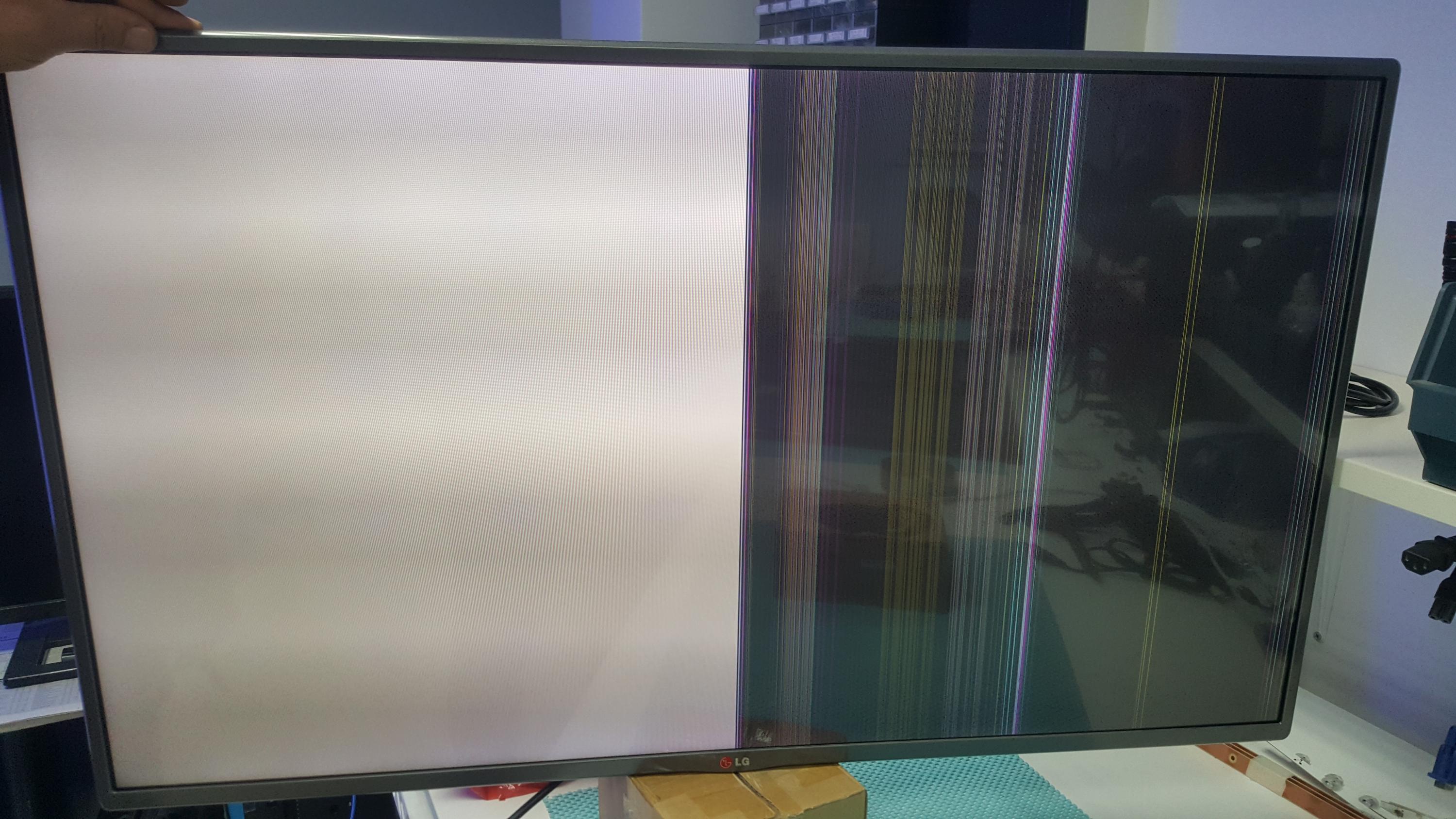

    Hello, I have this TV and the screen appears to have a problem. Just wanted to make sure before I send it to the recycle bin. This is a faulty panel isn't it?

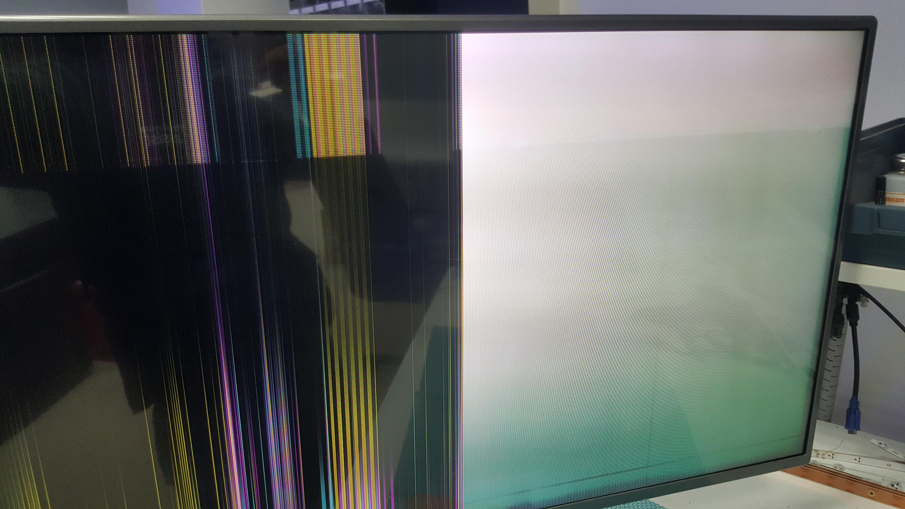

                                  Thanks for the very helpful tip brother, I have done as instructed but without the mainboard the TV does not turn on, therefore in order to do the test pattern the mainboard had to be connected. The pattern showed the cycle of colours but the problem with the lines was still there unfortunately.
                                  Could the problem persist in the test because I had the mainboard connected if it's the culprit?
                                  • Hamie
                                    • Apr 2014
                                    • 1383
                                    Re: Lg 42lb5610
                                    Your screen is likely faulty. If you unplug half the screen does the fault remain on both sides.
                                    Try one side check
                                    Then plug the other side in check again.
                                    If the fault is only present on one side of screen you may be able to use the old tape off method to "fix/mask over" it.

                                      I removed the left ribbon flex from the T-Con and the line is still visible.
                                      Then I plugged it back in and removed the right ribbon flex. The problem went away.
                                      • Davi.p
                                        Hobbist Tech
                                        • Sep 2009
                                        • 4537
                                        • Italy - Milan
                                        Re: Lg 42lb5610
                                        Ok you can use the masking method, post a clear picture of the tcon with pcb marking well visible.
