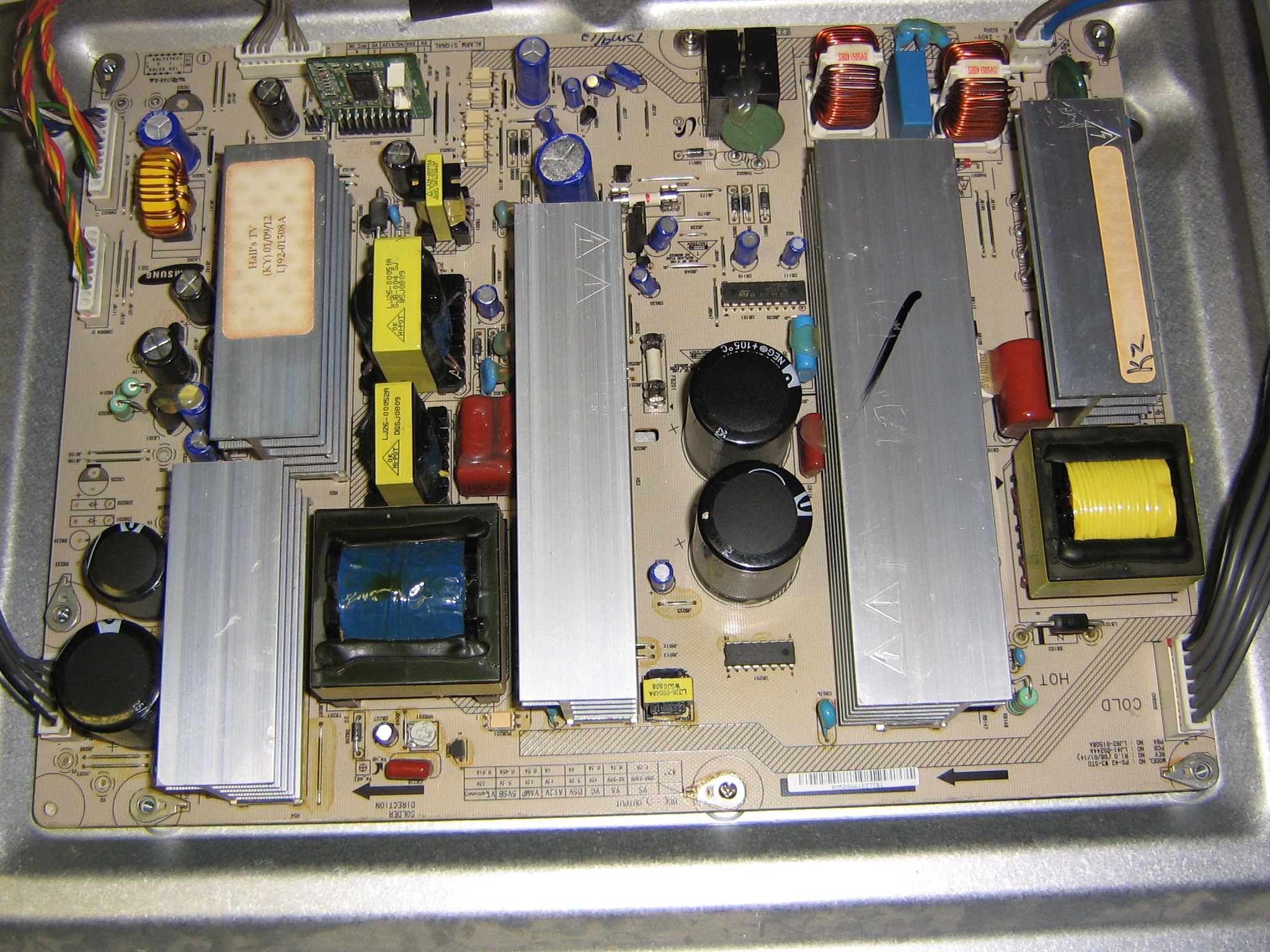

    picked up another TV. This time is a Vizio M65-C1. TV does not turn on. I had repaired another 60 inch vizio , Bad main board.
    When power button is pressed, the Power led indicator on the bottom right, turns for a few seconds and then it fades away. No backlight or Vizio logo on screen. Removed back cover and repeated test.
    This is the TV This TV is a little different from the Samsung I have worked on. Power supply is on the Left side, Main Bd is on the right side, T-CON , not in the picture is on the bottom. I am assuming that the boards in the middle are the LED...
