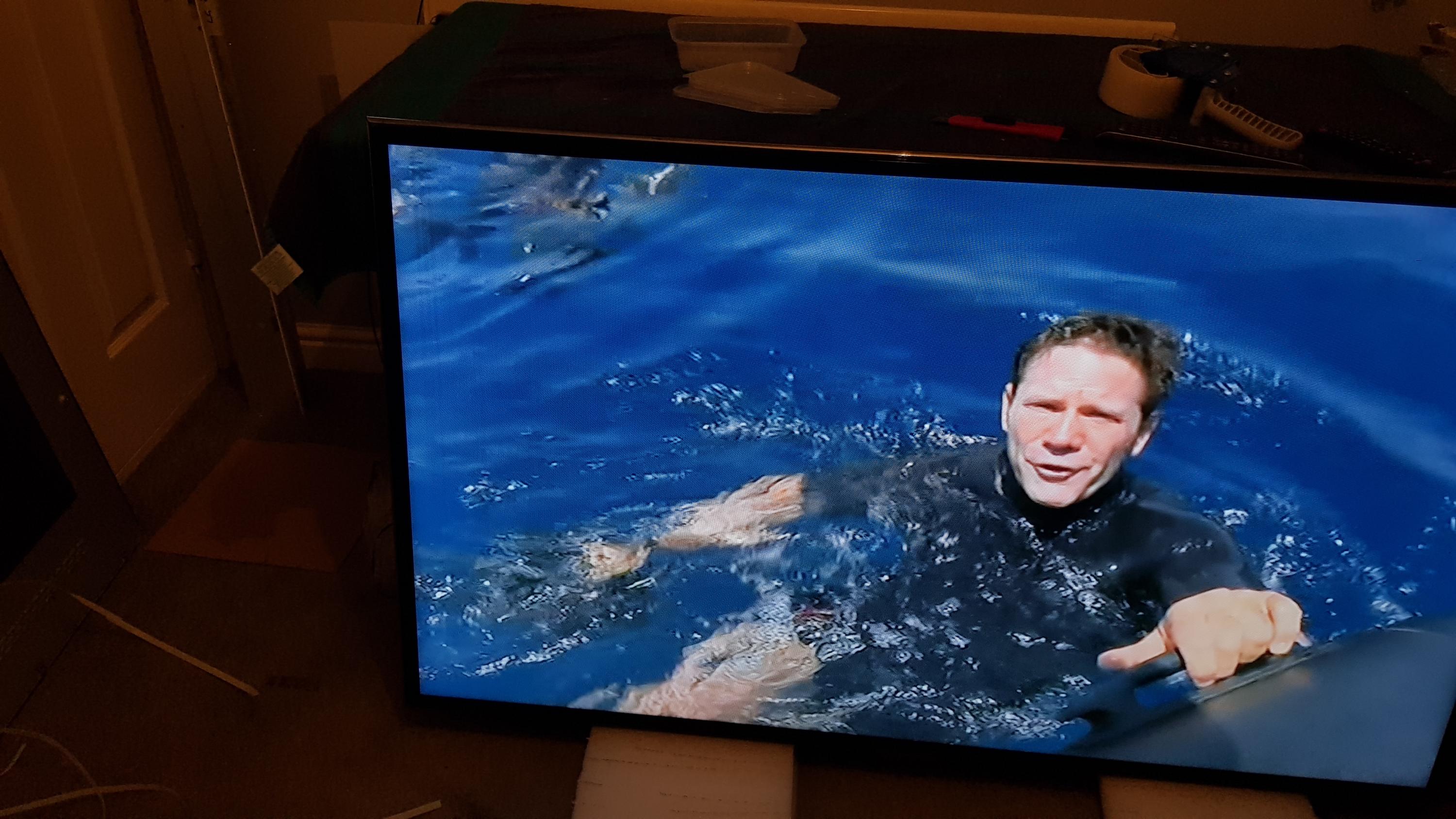

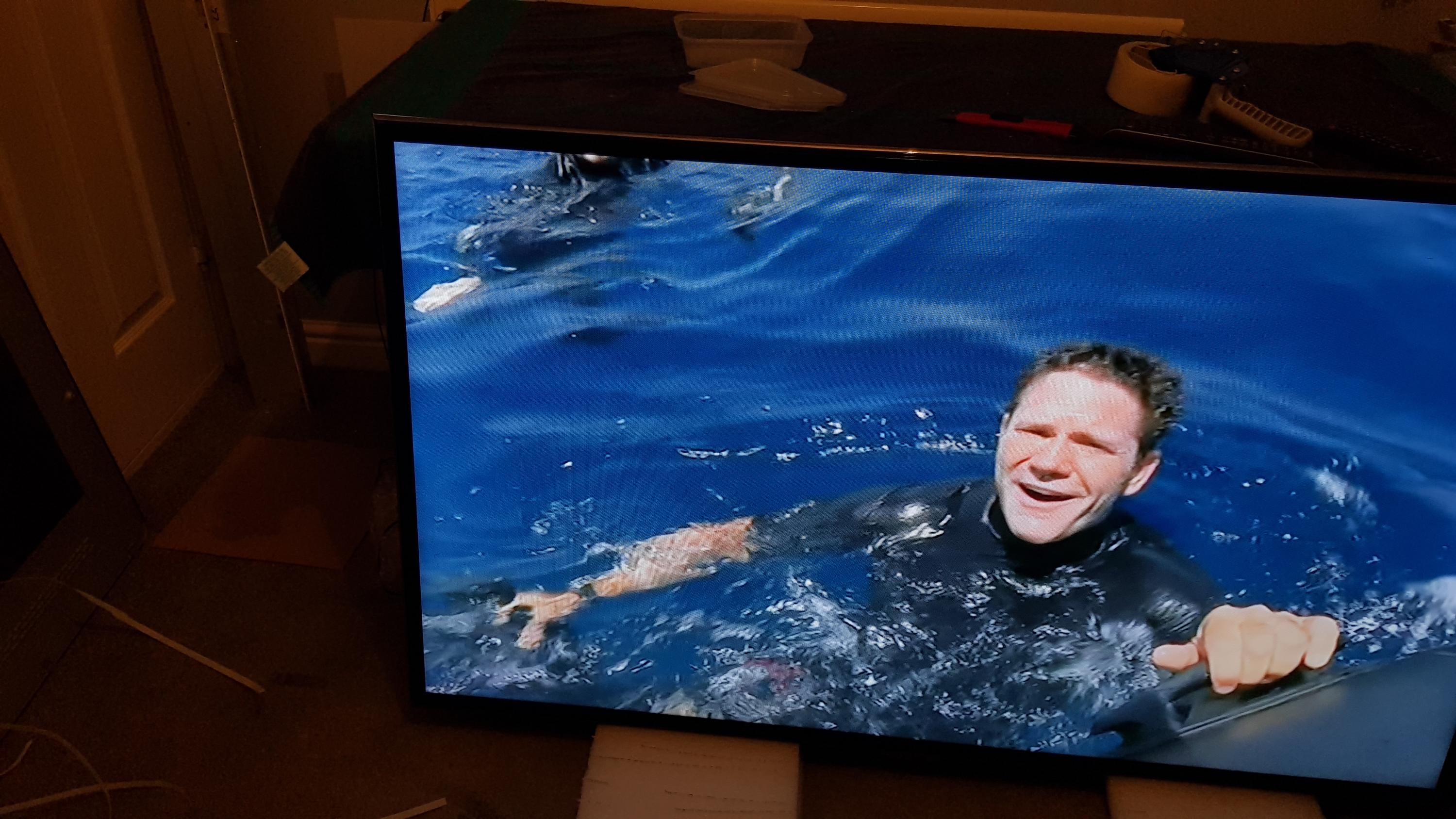

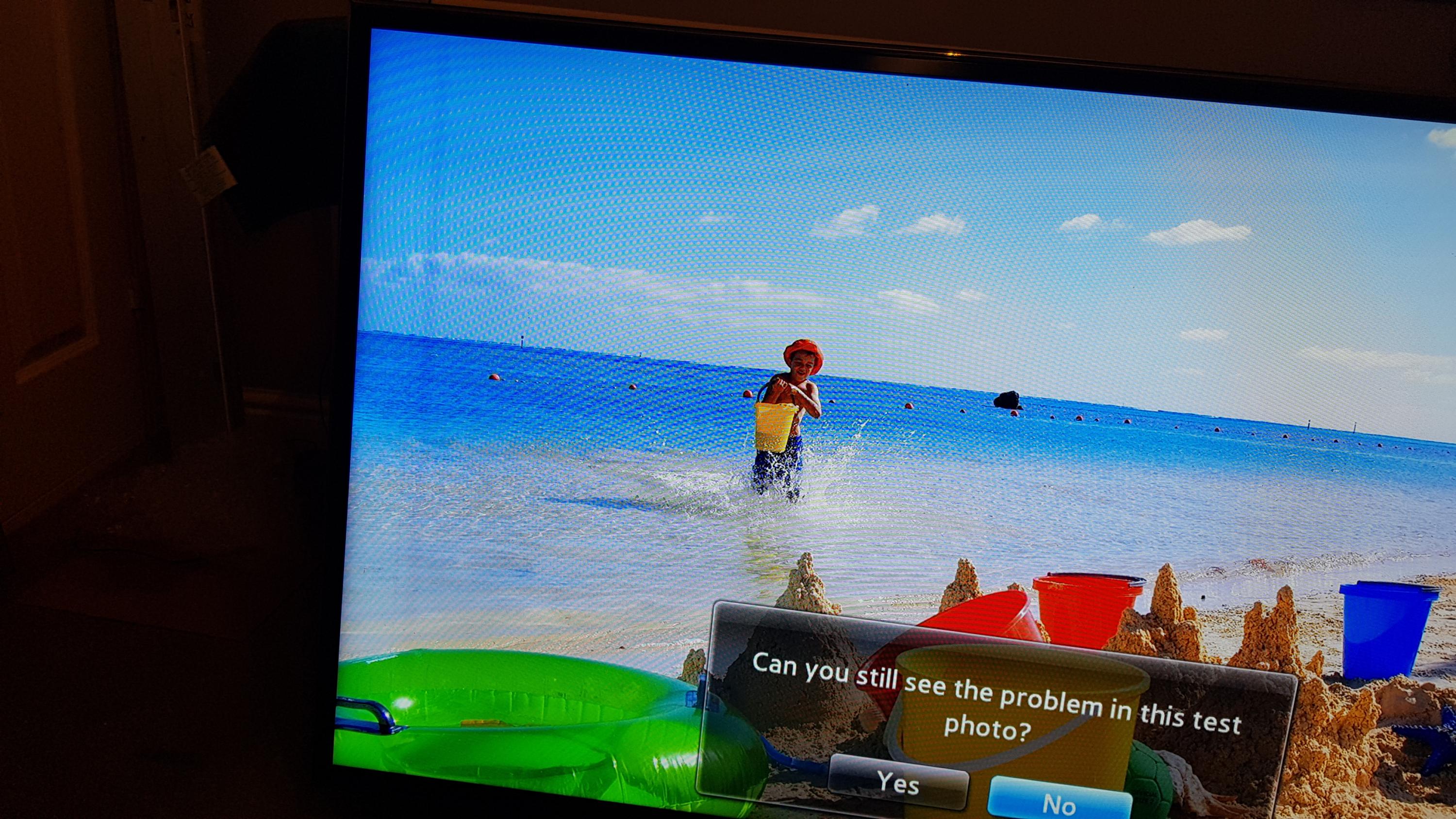

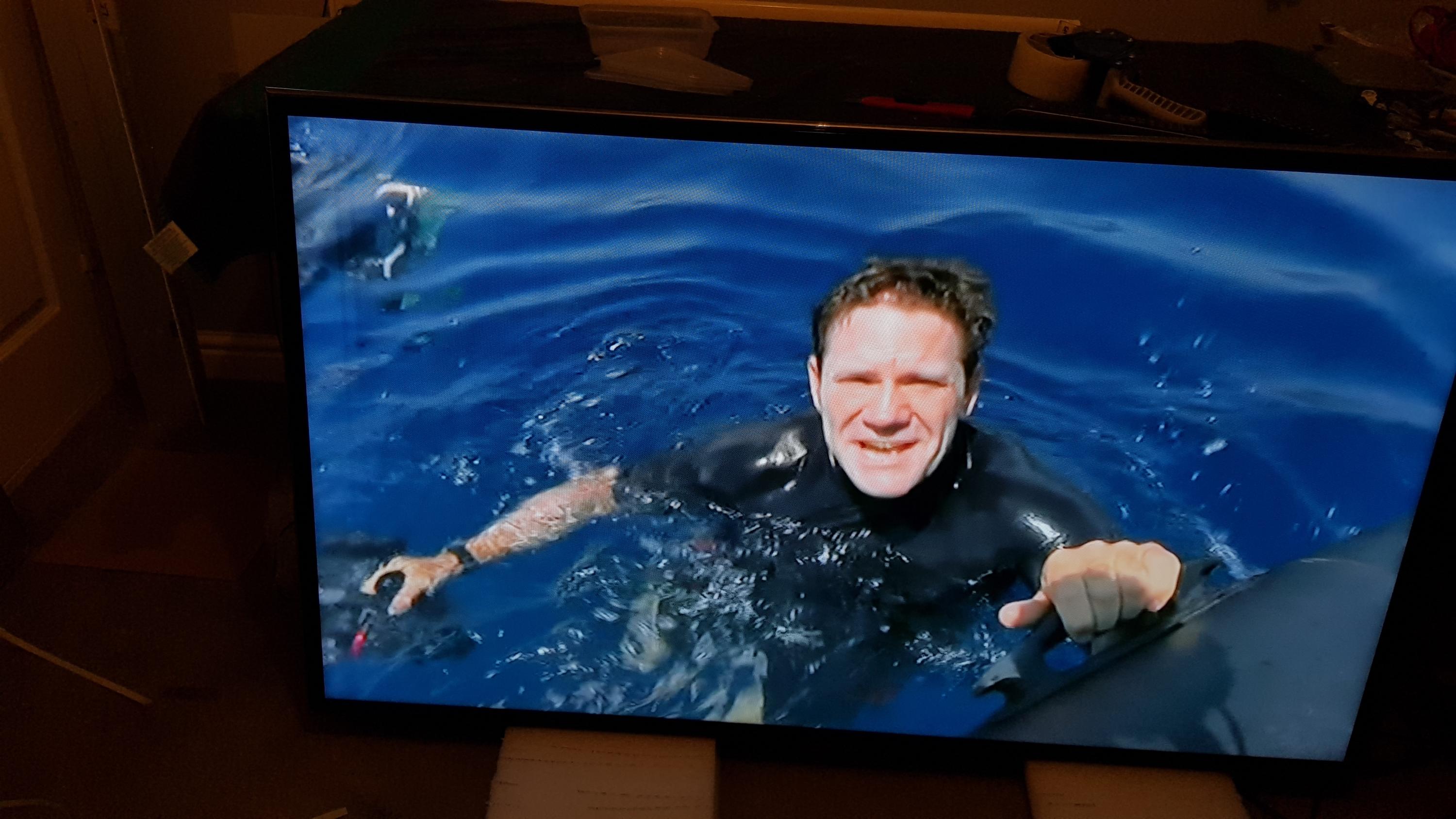

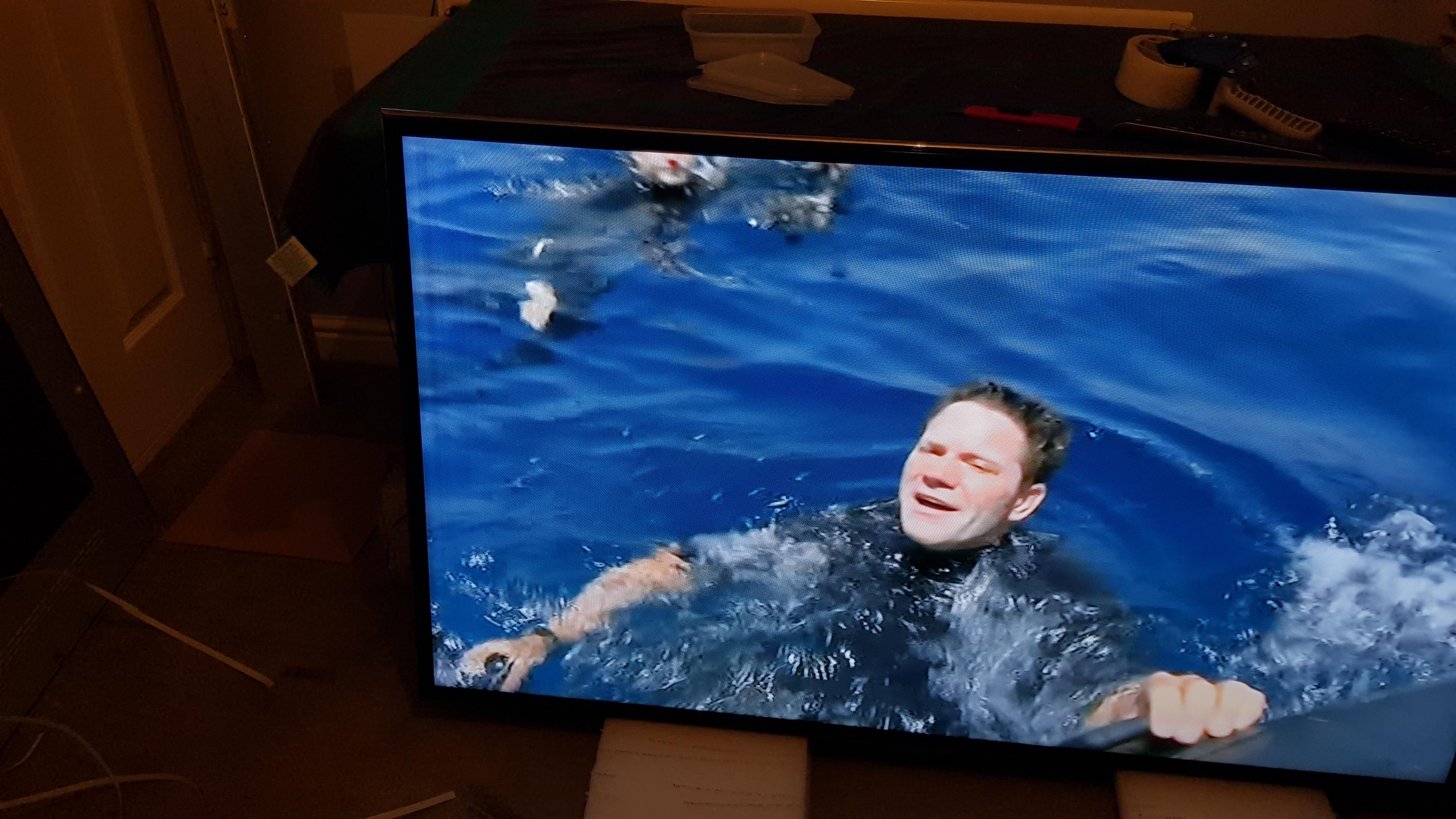

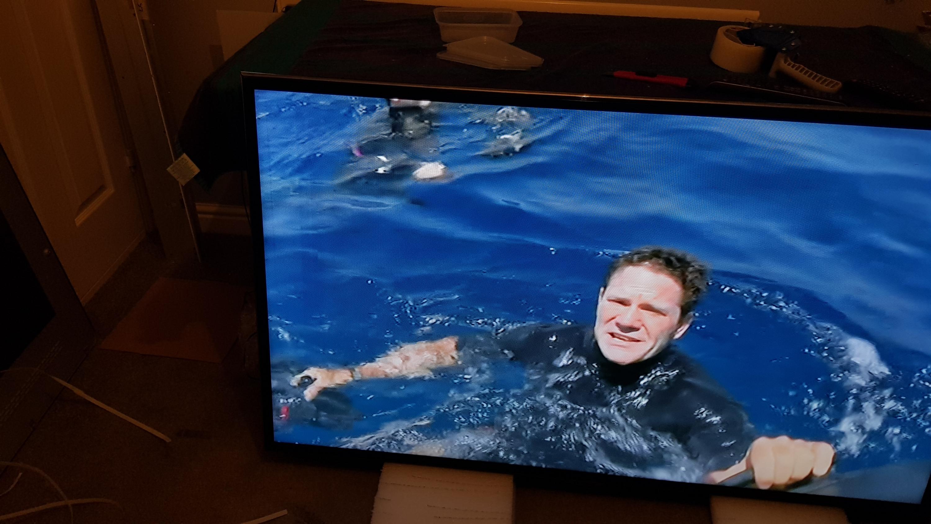

    Hi all
    I picked up a UE55ES6800 with bad colours to the whole screen and some faint lines on the left side. I found a burnt COF tab on the left/bottom so removed all the left side tabs. This fixed the colour issue but the vertical lines remain. The lines only appear in conditions where there's a bright object in the lower left corner area. All connections are clean and secure. I guess this is either a side effect of removing the tabs or there's a bad bond on the bottom edge? What do you think? Is there any hope for this panel?
    Many thanks

    Re: Samsung UE55ES6800 - Vertical Lines (moving)
    I think.you have to try reflowing the fartest tab's cof chip with the soldering iron gently under it on the amber side of.the tab.
      Thanks Davi.p but the TV is now stripped for parts.
