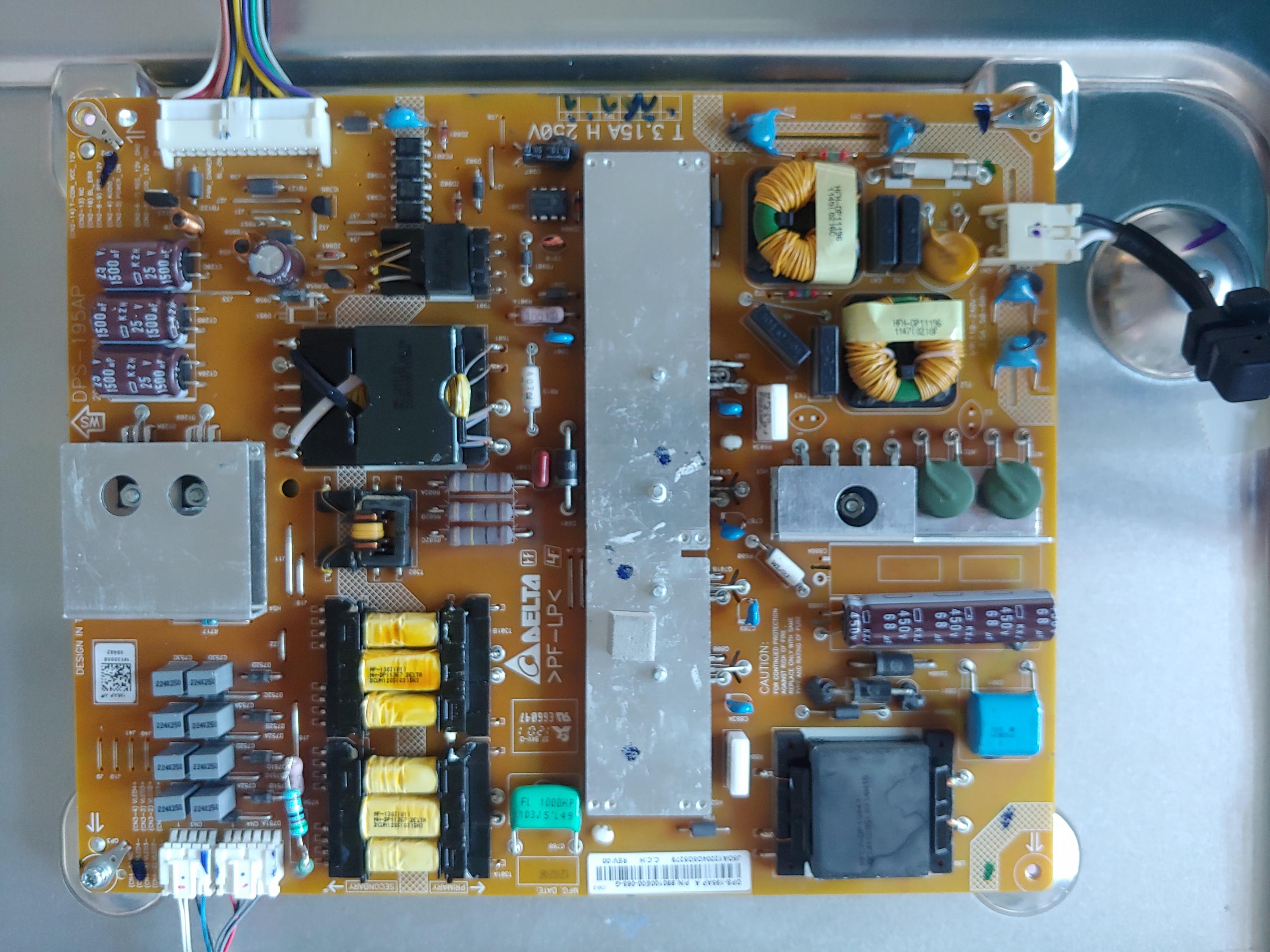

    This TV came with a defective LED, I fixed it, now is working but has a high frequency noise. When I touch a transformer leg (the yellow one on the right) the sound decreases.
