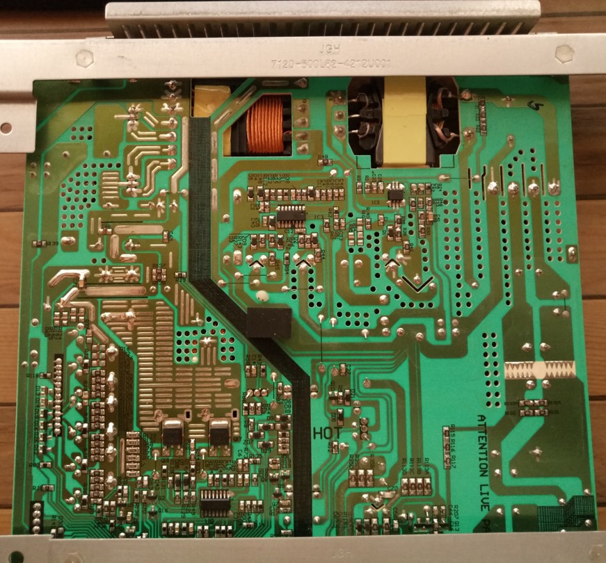

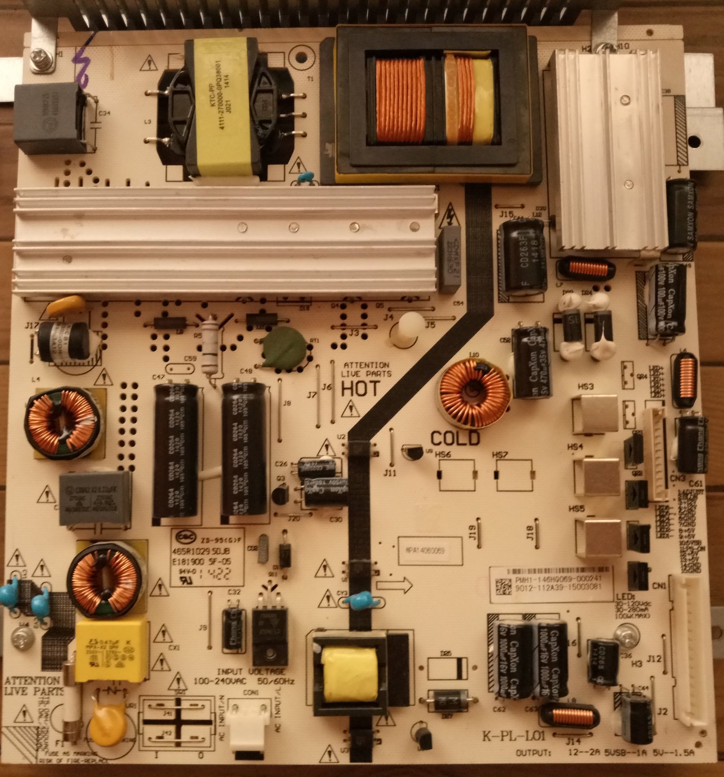

    Please upload good clear pictures of the whole backside of the TV showing all the boards, also good clear straight shots of the whole top and the bottom side of the power supply board.

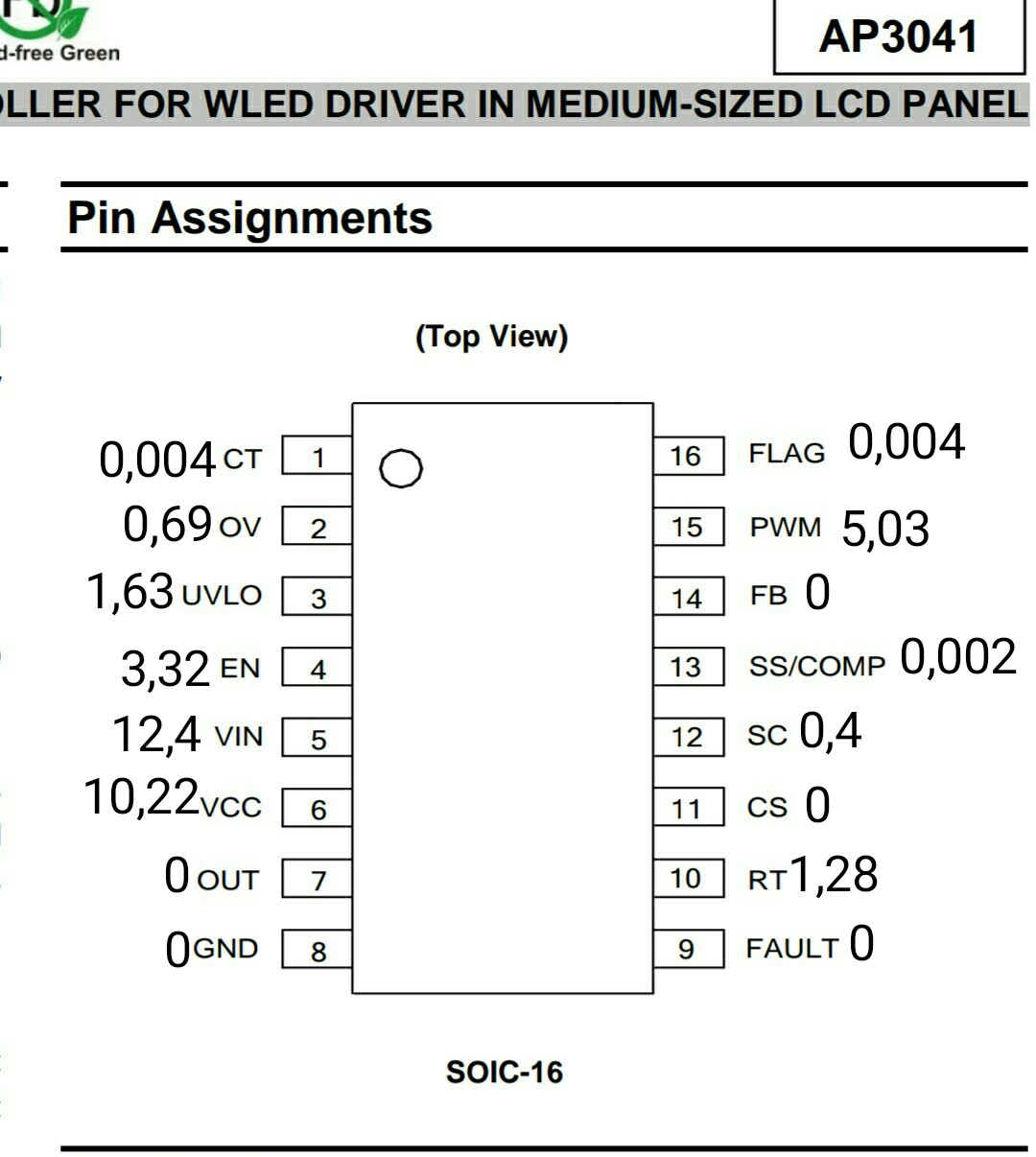

      What voltage do you have on Pin 5 of th AP3041. The maximum voltage at that pin should not exceed 27V.
          these are the values that I measured

                The voltage on Pin 5 as per your reply in post 5 is correct as per the data sheet you provided. The supply voltage VCC is well within the operating range of the IC.
                The data sheet also says that Pin 16 (FAULT) is 0 volts when the output is in short circuit condition.
                You also say "but when the LEDs are connected it has 51 vdc flashing the LEDs the protection is activated by decreasing the voltage."
                So are the backlights flashing when you switch on. If so if you reduce the backlight level (not brightness) in the menu, does the flashing of the leds slow down?

                  Sorry Pin 16 is the Flag indicator pin not Fault Pin as I said earlier. See data sheet.
