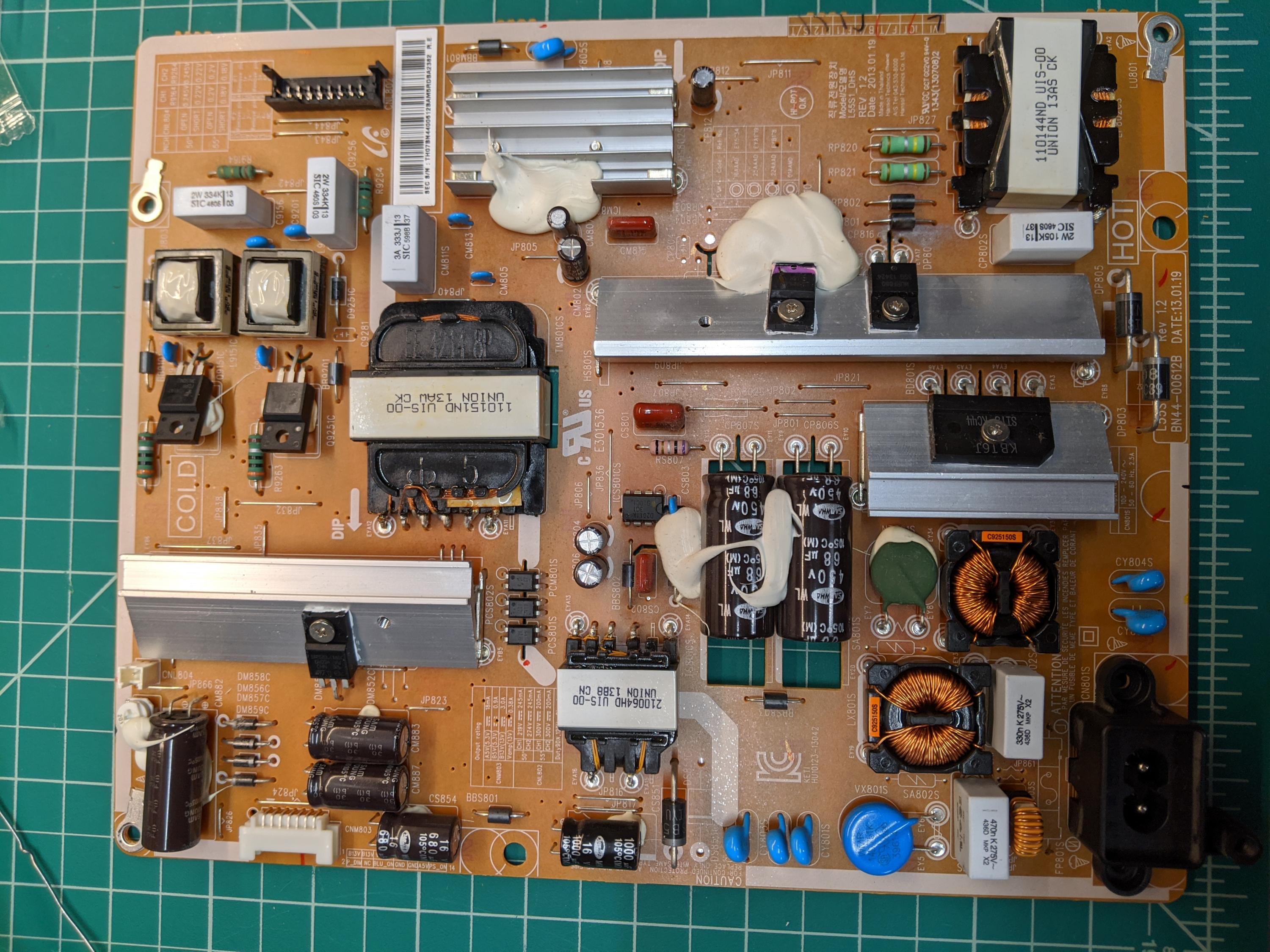

    Samsung l55s1_dhs bn44-00612b power suply
    I've been given a l55s1_dhs bn44-00612b Samsung power supply board to repair. The fuse is blown, and CP816 is damaged. Unfortunately the markings on CP816 have been damaged, so I can't get the values. Does anybody know the value of this cap?

    Re: Samsung l55s1_dhs bn44-00612b power suply
    Attached photo of the board with CP816 removed. (top right, hot side)
      220pf 2KV (instead of 1KV) should be fine.
      You should also verify that the PFC MOSFET and the PFC diode (DP80?) mounted to the heatsink are still OK.
        I have read this thread looking for my same board issue. Must I remove the DP801 and the QP802CS from the board to verify that they are not damaged?
