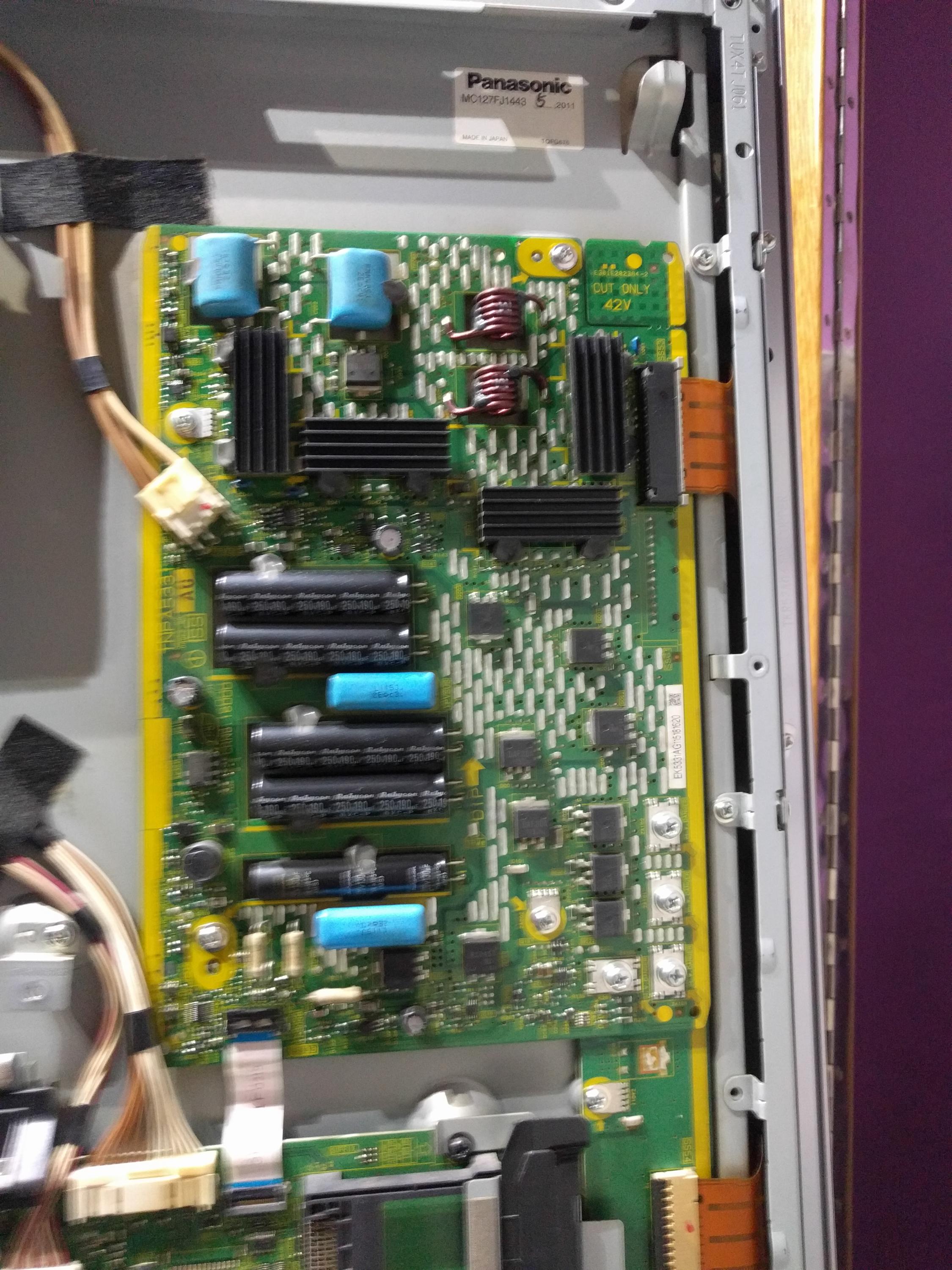

    I have a Panasonic TX-P50VT30E (2011 model), i have 7 blinks. I test the mosfet transistor in SC board and i get a bad result.
    I think change the mosfet transistors but finally i find a new board.
    In this new SC board the mosfet are ok.
    I change the old SC board for new board, but now when i power on TV i have 8 blinks.
    Any recomendation and test for get a solution?
    The problem is SD/SU, SS or A board? I read differents solutions in other threads.
    Thanks.

    Re: Panasonic TX-P50VT30E 7 blinks, change SC board and 8 blinks

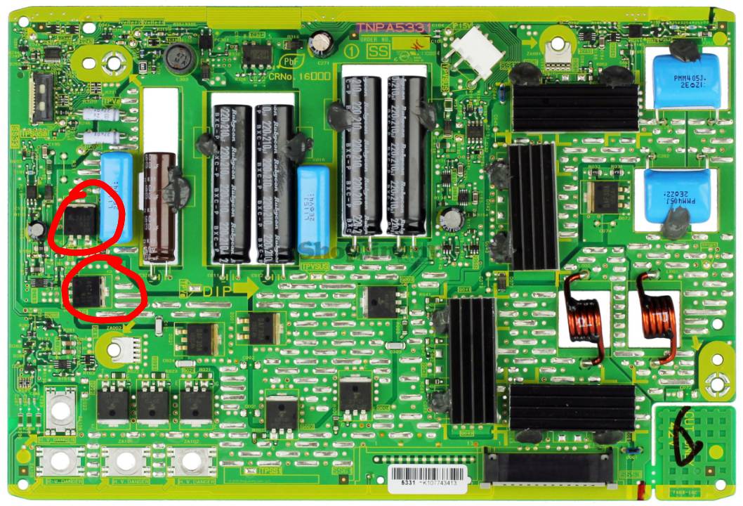

    Post pictures of your sc a d ss boards.

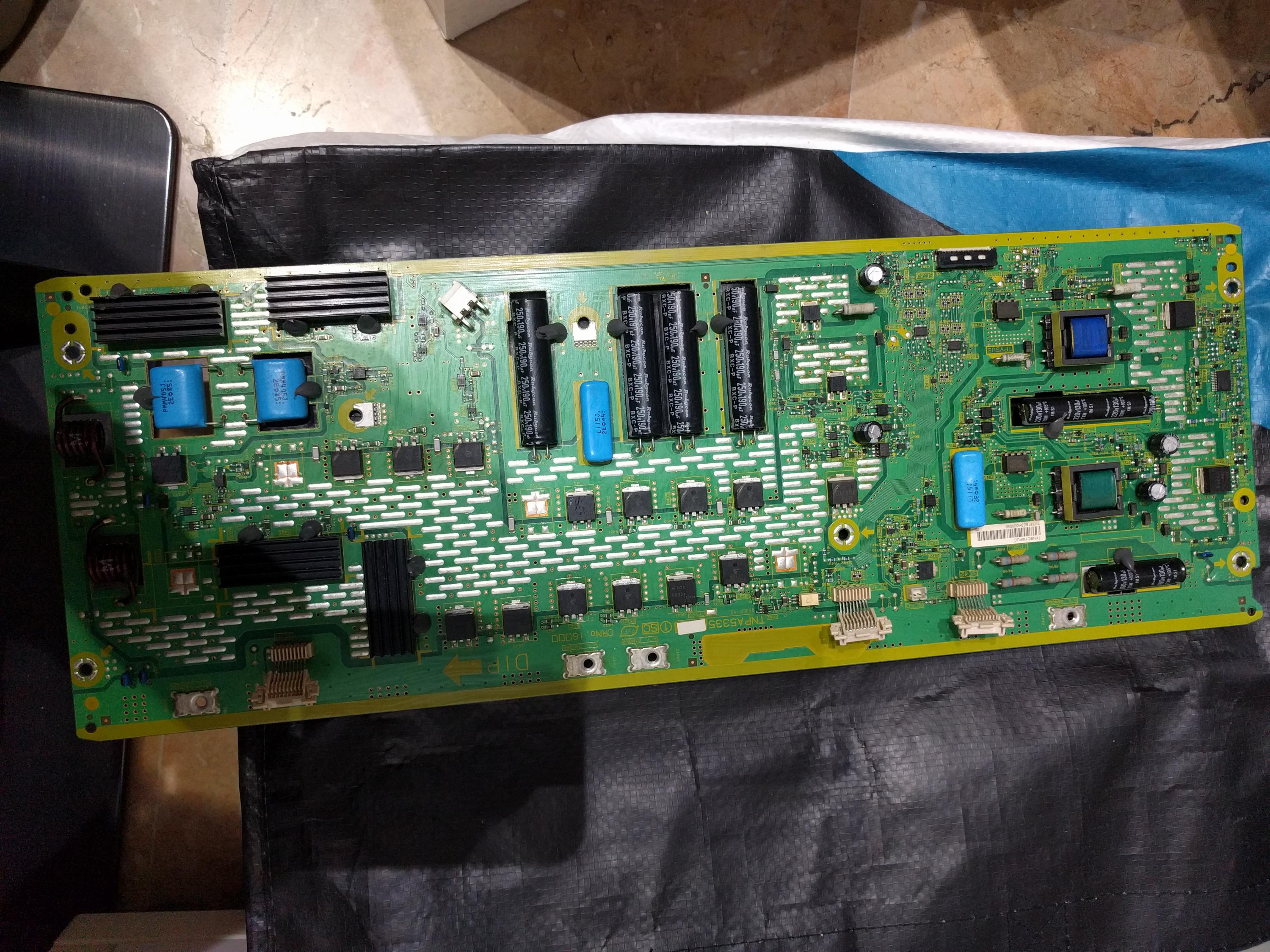

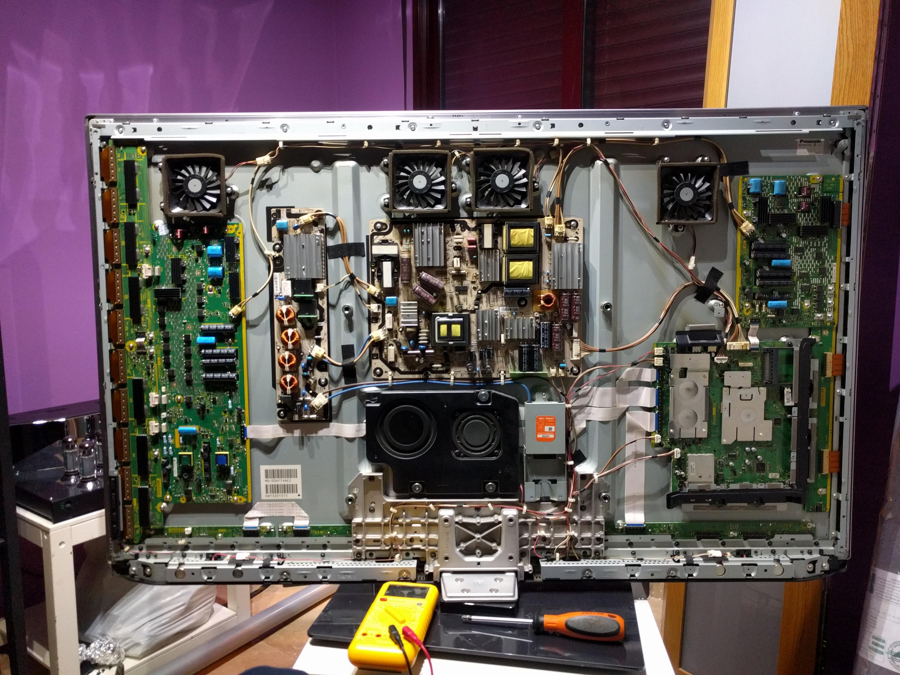

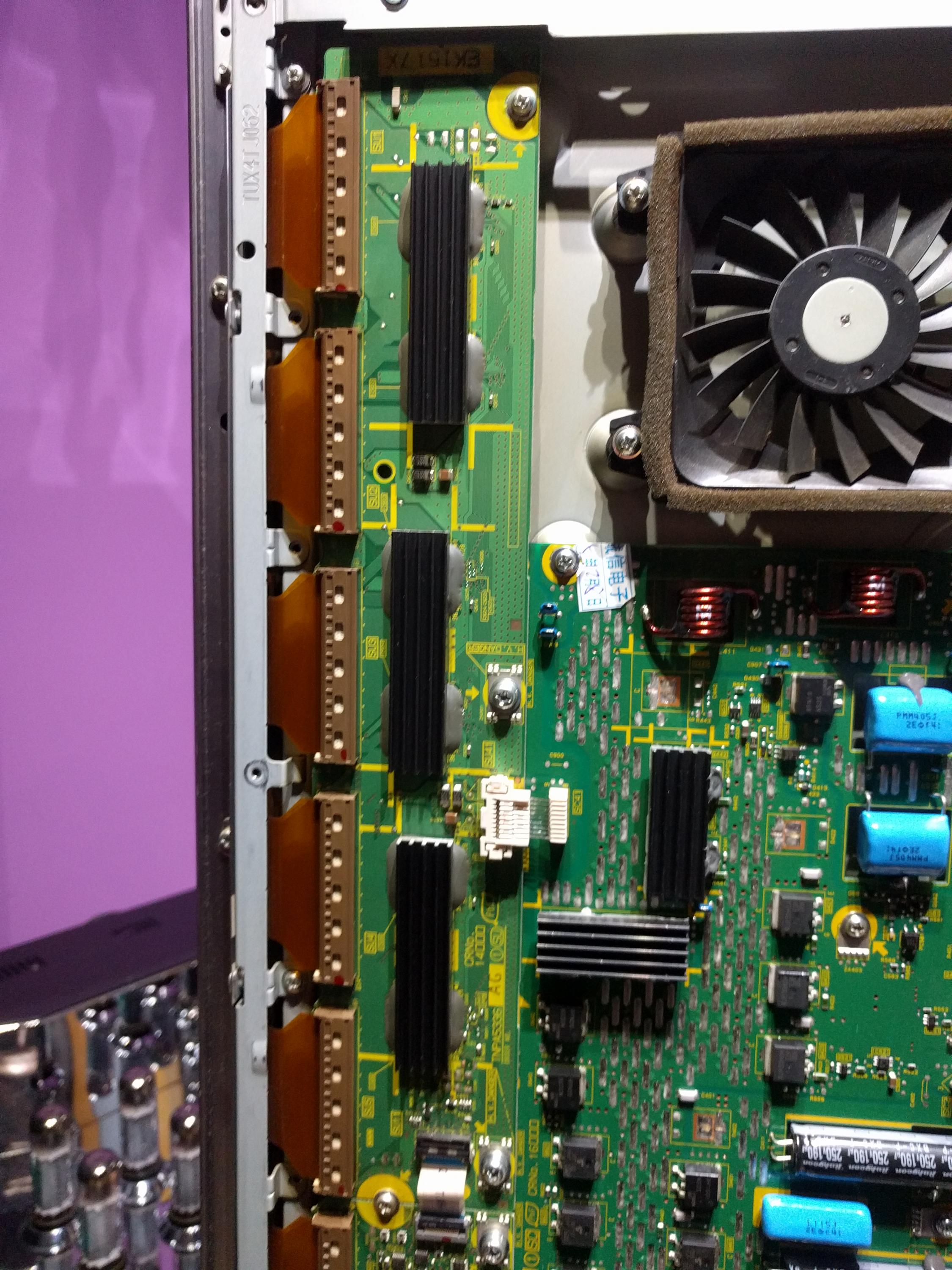

      Hello
      I add photos
      The SC board you can see mount in TV is a new, MOSFET ok
      The SC board yo can ser unmount os poder, MOSFET not correct
      I check MOSFET with multimeter.
      Thanks for your help

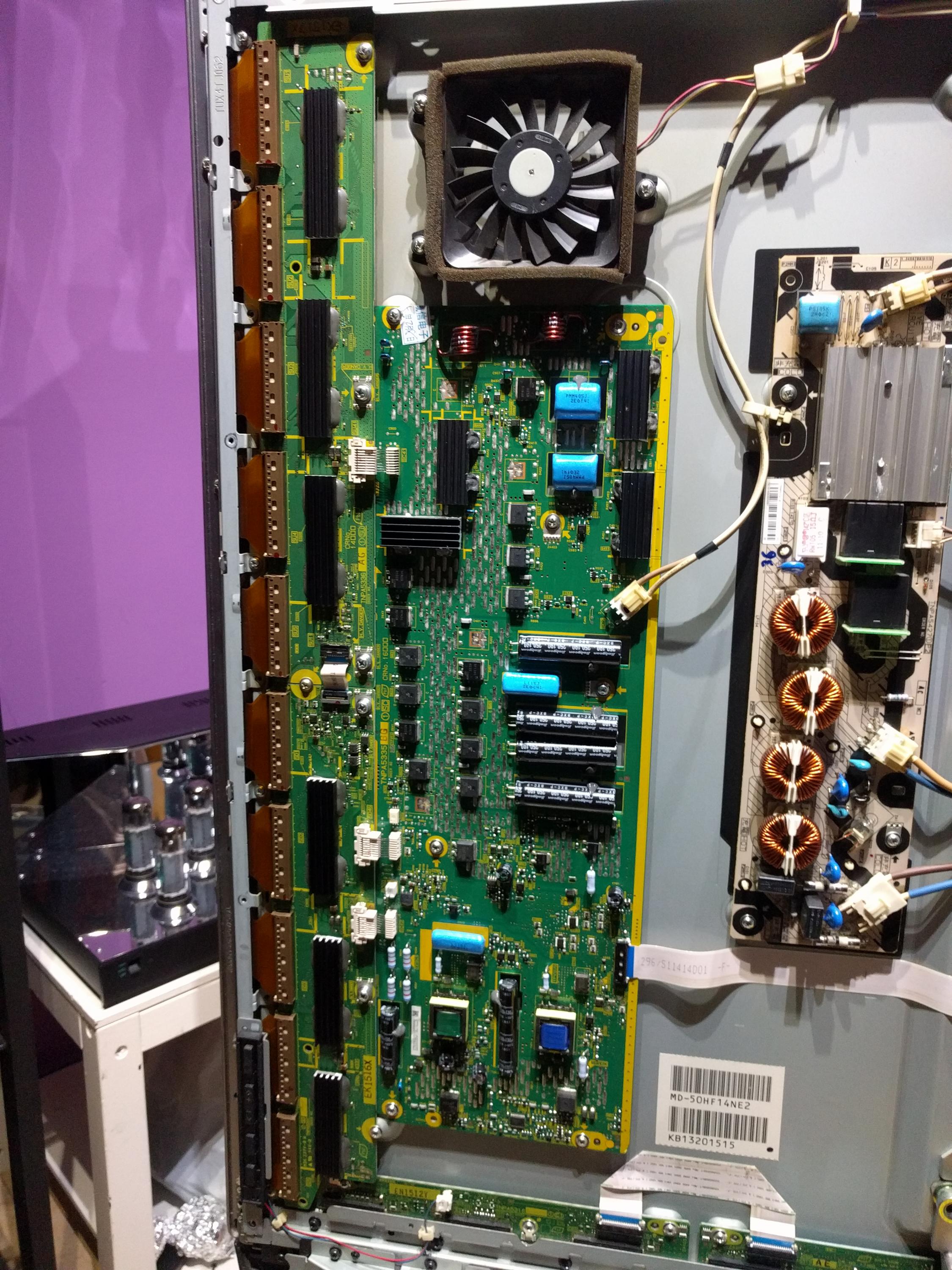

        Check these 2 components on the SS board.
          There are ok
          No short

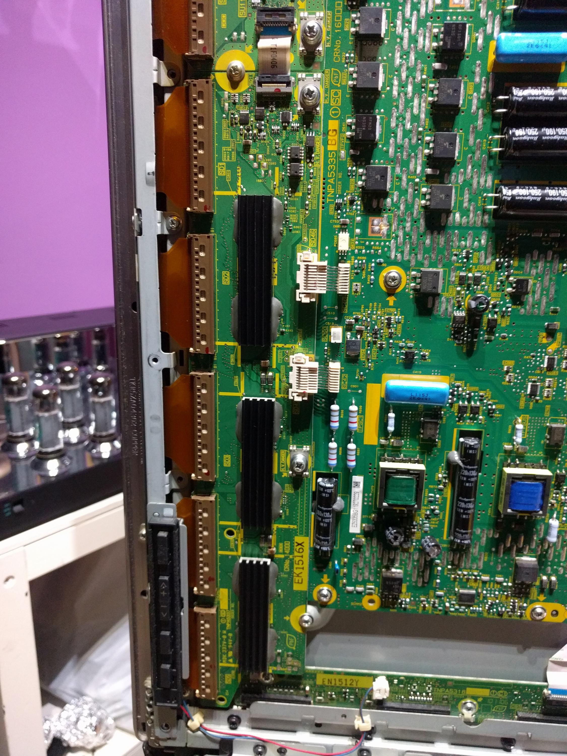

            I have a good news.
            We unmount SS Board and i power on the TV, The led is green and the display is black.
            I unmount and clean all connections of SS Board and I mount again.
            The TV is power on normally, it´s correct!!!

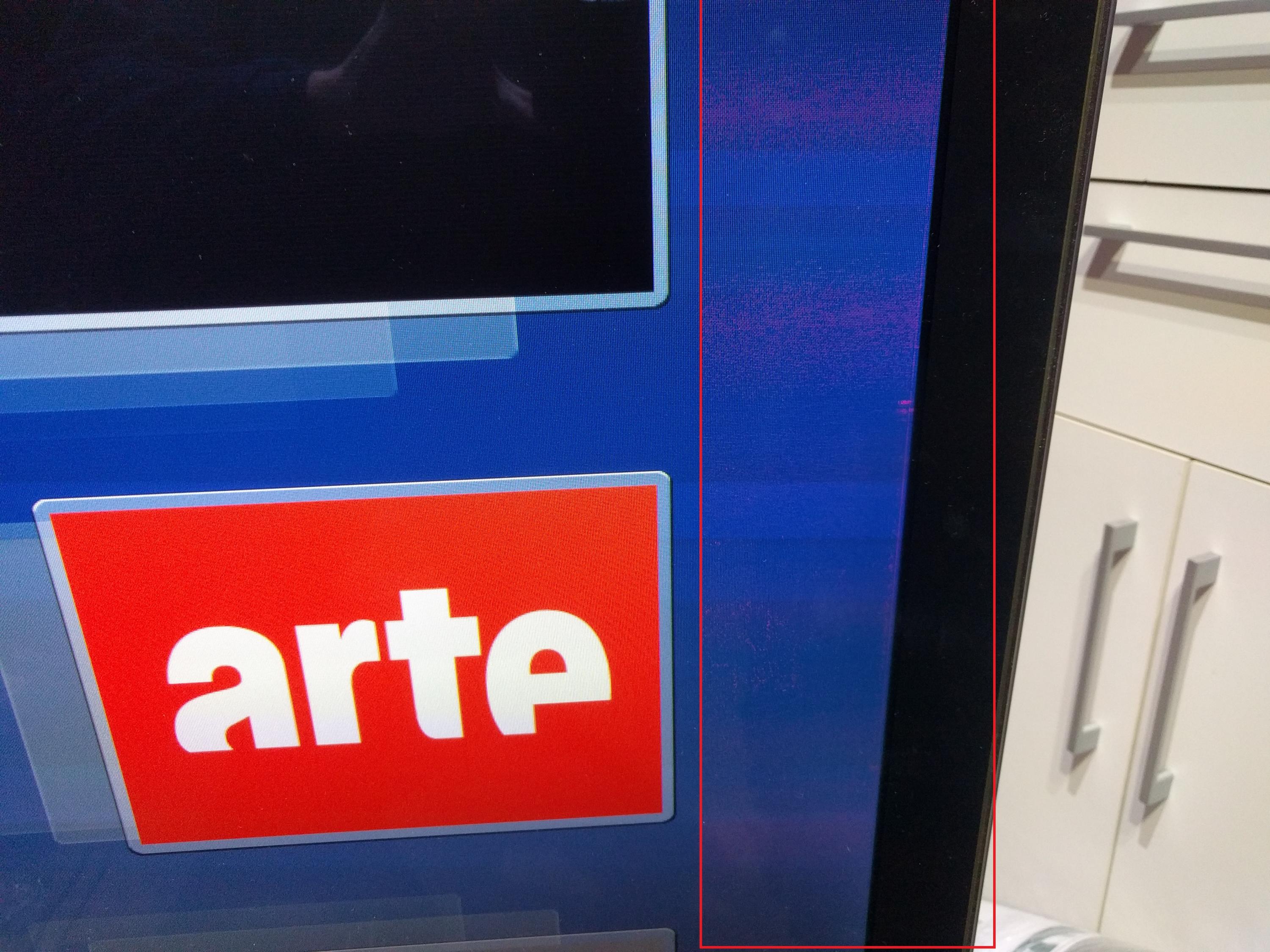

            But now i have a vertical pink band in right part of display, i add photo.
            I think is a bad connection, which board can generate this efect?
            At this moment:
            Firts, I have seven red blinks, I change SC Board.
            Second, After change SC Board i have eight red blinks, i think my problem was conection into SS Board and panel. I clean the connections and i get a solution.
            Third, I have a vertical pink band in right os display.
            Thanks guys!!!
