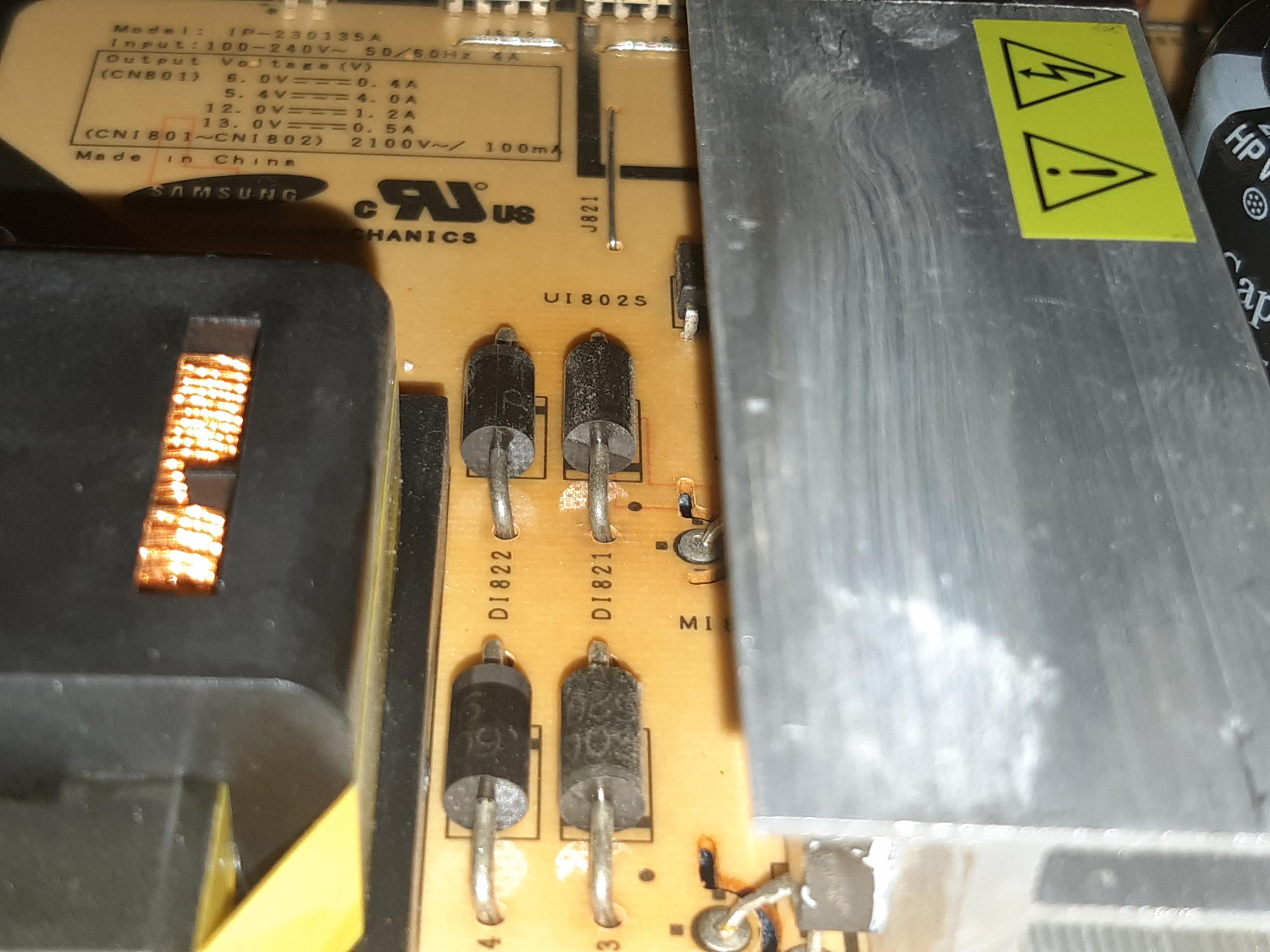

    Hello. I'm new to troubleshooting TV's and have the apparent dreaded Samsung no-power clicking situation. As I reaad about this issue, I noticed most of the time it was bad caps, so I thought "I can fix those!" and opened up the TV. I found no noticeable bad caps, so I read further and saw where people tested voltages at the power connector and what to do if you found LOW voltages. What I haven't seen is what to do if voltages are too high and that is what I am getting. At my 13 volt pin, I get 18v, but not stable at all. Goes down during the "clicking" cycle and comes back up to 18v. At the 3 12v pins, I get 26v, again, not steady and fluctuating down and back up. At the 5.4v pins, I get 5.4v, not steady and dropping and rising during the clicking cycle. I ordered a new board, which I found on ebay cheap and they have lots of these new btw if anyone needs one. It will arrive today, but I still am curious to what would cause these high voltages. Any info would be appreciated. Thanks!

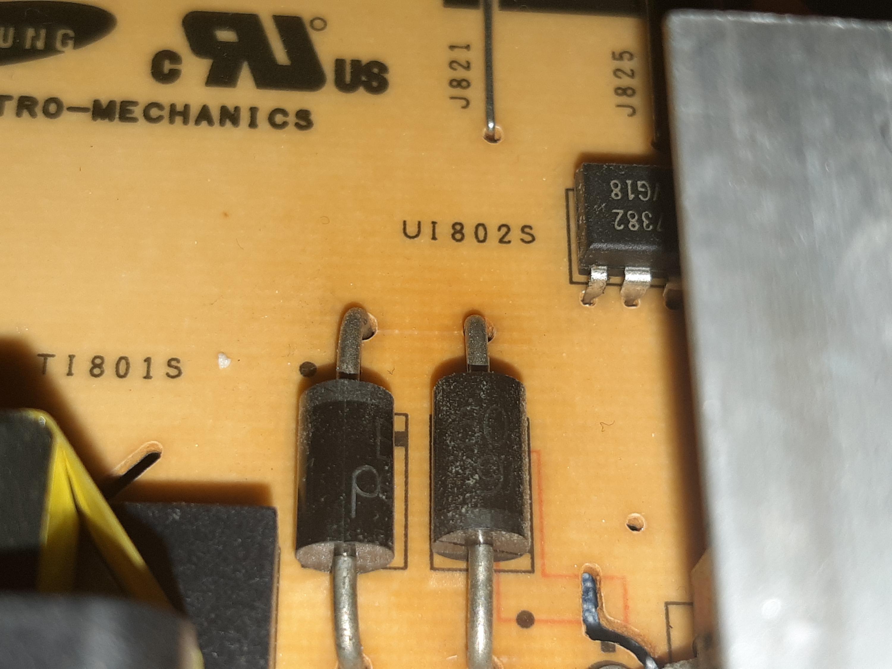

              OK, so all 4 diodes near the brown spot tested between 0.397 and 0.401, but I don't know what they are suposed to be. 2 of them have 506 and 209 on them and the other 2 have 506 and 605.

                Re: Samsung LN-S4051DX High voltages at power connector
                If you reverse your probes you get OL right? most of them will test between .3 and .7.
                  Yes, I'm getting OL when reversed....and I'm getting very fu*king pissed off trying to find the schematic for this. I have found several sites with the schematic, but so far, only 1 is actually for this TV and it's a .jpg file. Whatever I open the .jpg file with won't let me search the board (like for individual components D1823 for instance) and they won't even let me move around to see the whole schematic!! And the ones that are .pdf files where I can search around and move are for a 55" tv that has a different board!! Very frustrating!! Oh and I did find one tiny diode that reads 0.029.
                    .029, that seems bad to me, might be your only problem.

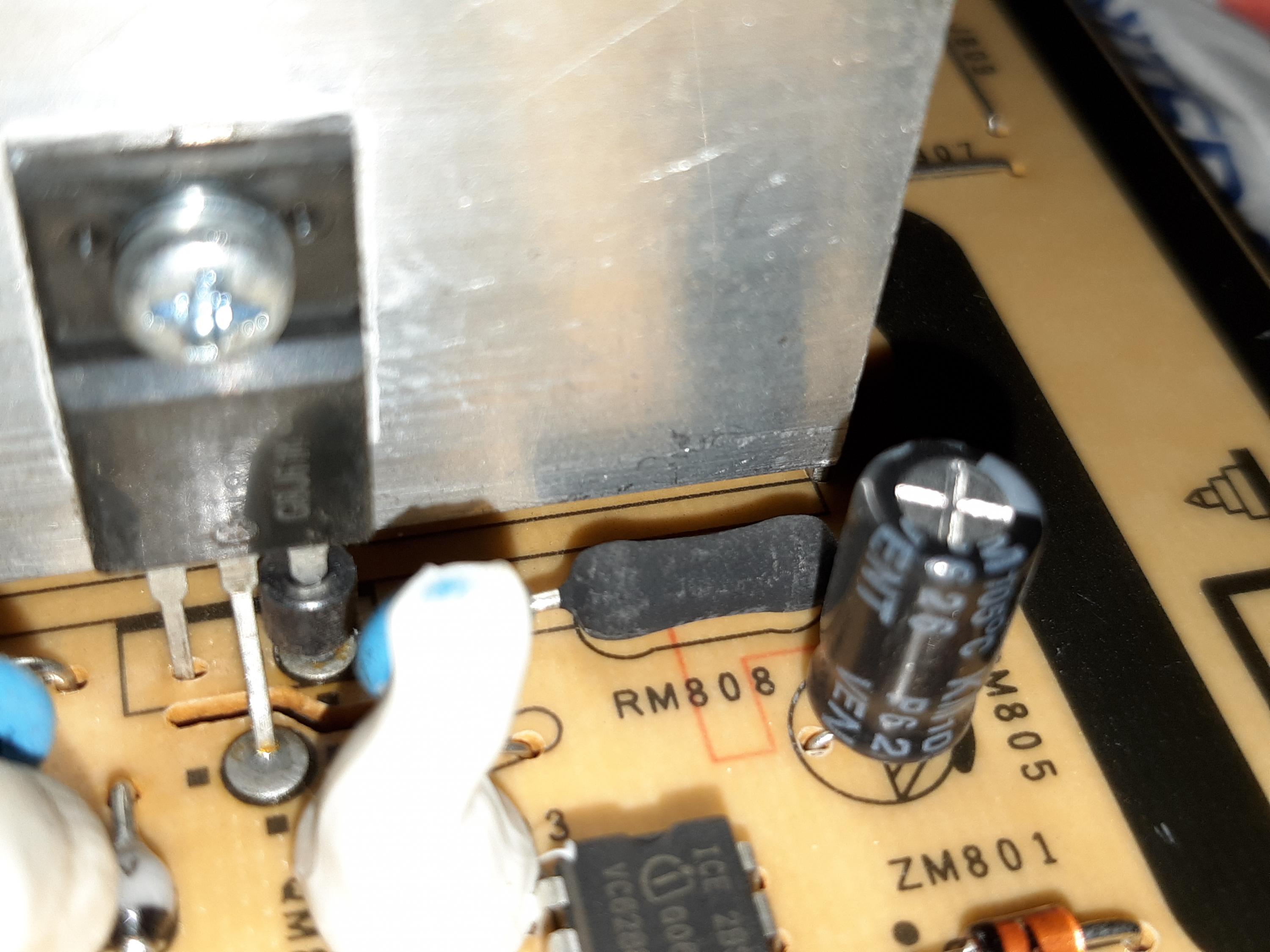

                      The other day I saw this resistor and thought man, that looks fried!But if you look at pics of other boards for this TV, they are also grey like this one. But shouldn't you at least be able to read the numbers on it? Cuz there's nothing on this one and it reads 0.000 both ways the leads are hooked up. And from what I can find on it it's 0.03 ohms.
                          That black resistor RM808 should be <1 Ohm if you set you meter to 200 Ohm scale, so not likely to have any thing wrong with that resistor. If the diode is tested bad then you need to test it off the board or at least lift one leg off the board, the diode may be connected in parallel with the other parts.
                          We need the Voltage reading of the power supply board connector that goes to the main board, each pin has label to tell you what they are so make sure to report the readings by putting down the pin name and follow by the Voltage reading for each pin so we can easily see if they are correct or not, they are important data so make sure to report them in the format as requested.
                            My meter just has AUTO, can't set it to a certain ohm setting range. I found the service manual on SCRIBD and it's a manual for 6 different models similar to mine. It has so much info it's crazy! BUT! In it's list of every part on all the different boards, it doesn't have RM808 or DB803, which tested to 0.029. It doesn't have other components either, so do they maybe list them different in these manuals? Like just R808 instead of RM808? I know it has to be in there somewhere, because it has like ......1,000 or maybe more parts. I wish I could somehow send you the manual. Also, it has a bunch of schematics, but only 1 power board schematic (that I found anyway) and it's for a different TV. Seems strange that the manual has so many fine details, but wouldn't have the PB schematic.

                              Resistor usually goes open circuit when it is bad, so doubt that anything is wrong with that resistor.

                                      It's not there. It's a revised board and neither of those diodes I mentioned are on it. And this board is the one that it shows in my service guide, which is why I couldn't find those diodes by searching for them.
                                        DB803 is across the coil of the relay, thats why it checks that way.
