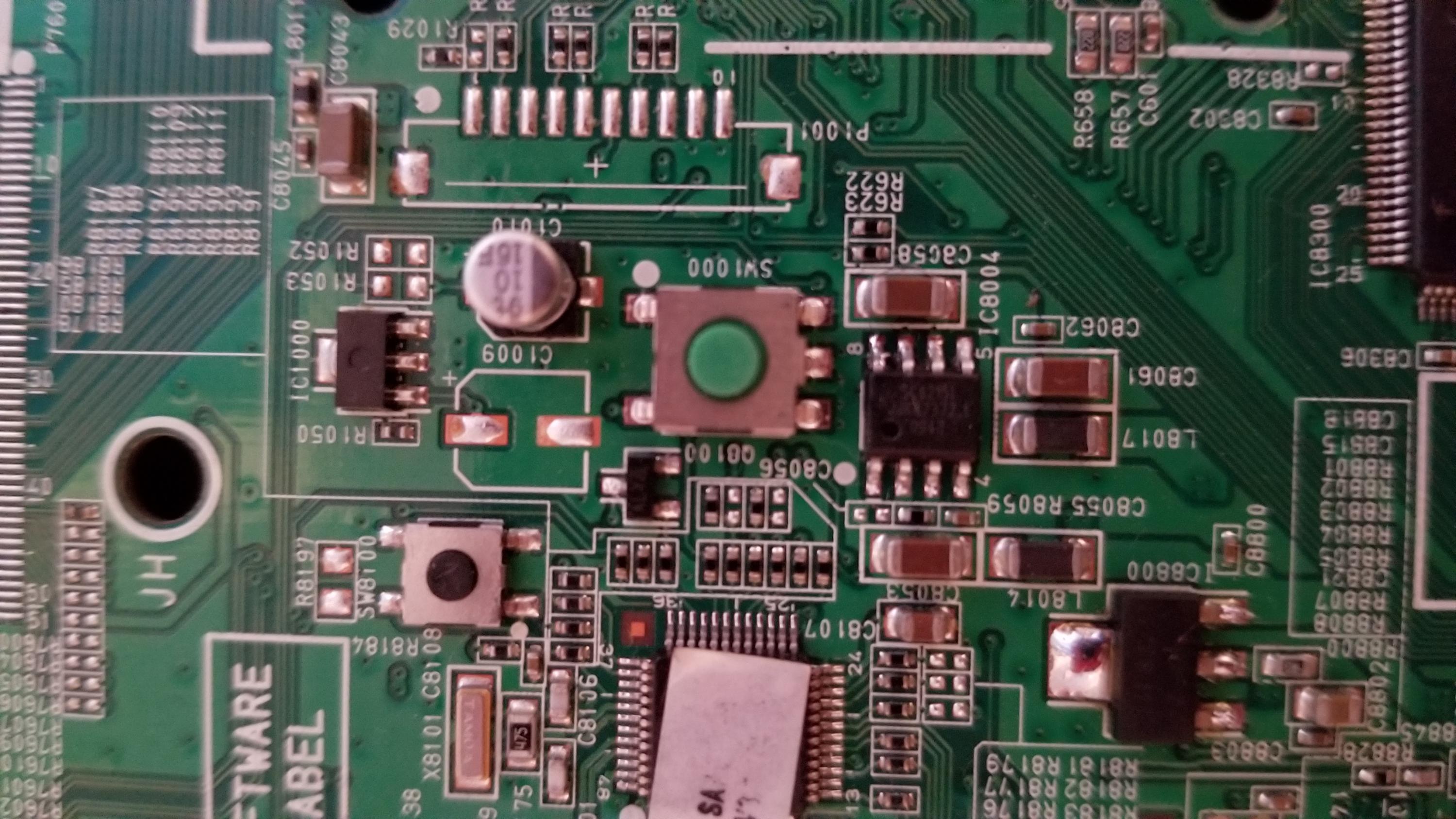

    There is a back button on the main board that when pushed, the back lights flash for a second and then go back off.

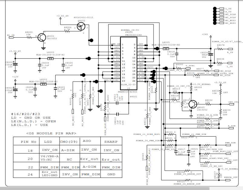

          " inv on,off 0.05" Needs to be 2.5 volts or more to turn on backlights, the inverter on signal comes from the mainboard so looks like a mainboard problem.

              Do you know what that little black button on the main board does? Cuz when i push it in, back lights come on for 1 second.

                            BudM do know what that green and black button on the main board does? after pushing the green button and then the black button, the back light comes on for a second. Then the TV shuts down back into standby.

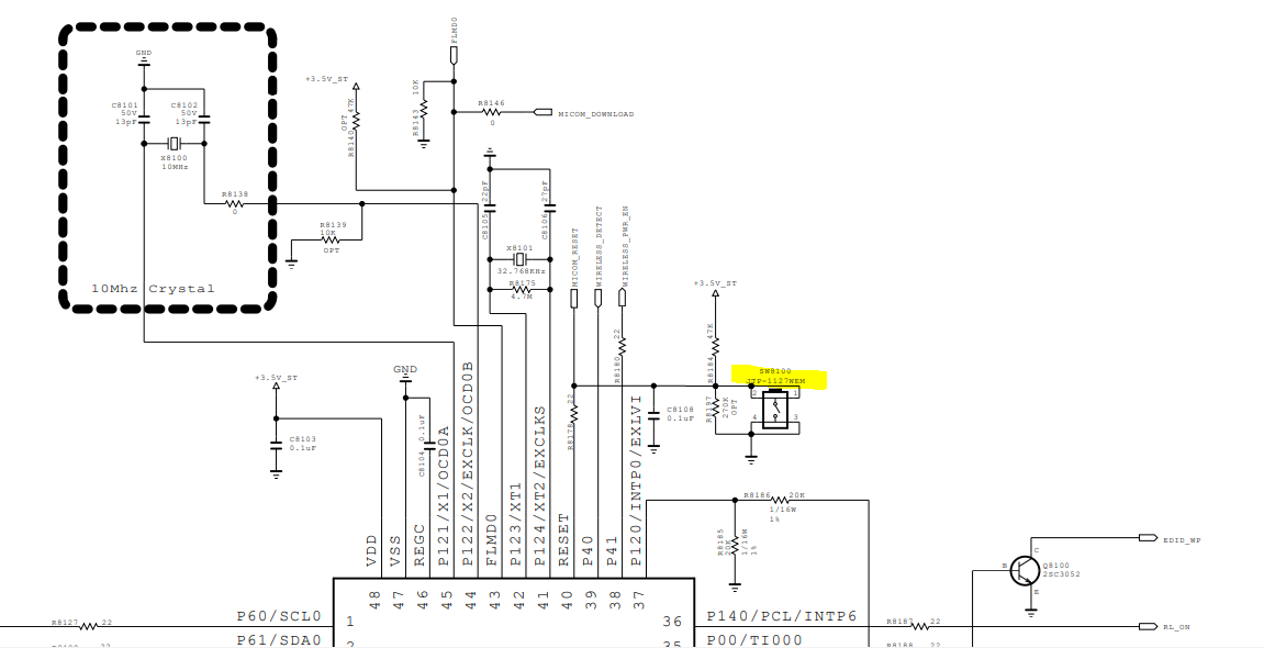

                                      So I was able to charge the INV/ CTR pin with 2+volts and the back-light comes on. So the power board is working. The red led on front bezel still pulses tho.
                                      The highlighted switch in the schematic when pushed enables the back-lights to flash for one second when the INV/ CTR pin is not charged. I think the issue is somewhere associate in this circuit, but im still not sure.

                                        Re: LG 42" 42LD550 start up.
                                        Remove all the test resistors then connect all the connector back in place then check the resistance between GND and INV on pin to see what it shows.
