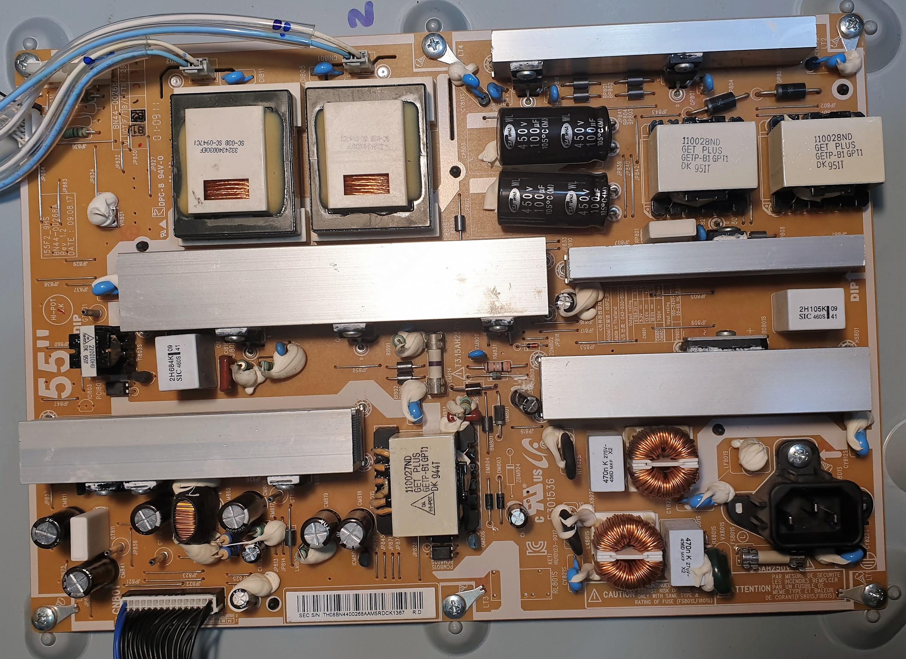

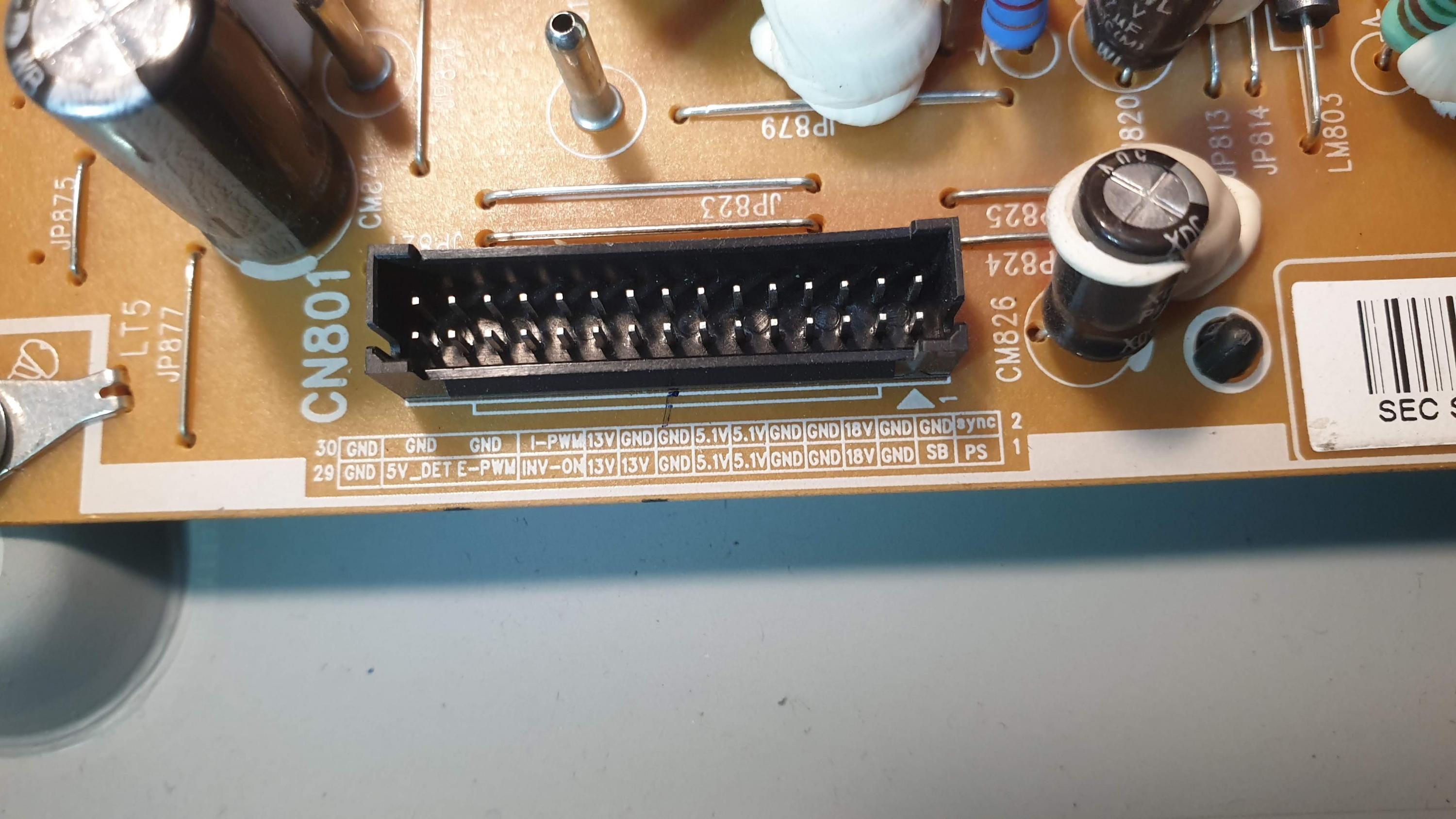

    Hi, I have a Samsung LA55B650T1F tv which died i.e. the red standby light went off when turning it on and it never came on again. I've disconnected the AC and left it overnight and reconnected it. Upon pwr on, it doesn't come up. I can sometimes see the leds on the ethernet connector flicker faintly on/off and then nothing.
    So, after opening up the tv, I did a visual inspection of the power board, connectors etc. All looked ok. I have checked all the electrolytes with an ESR meter and checked their capacity out of circuit and they are fine.
    When disconnecting CN801 between power board (BN44- 00268A) and the main logic board and then plugging in power, the back leds flash on/off twice and then stay on permanently.
    Measuring voltages on CN801 is as follows NOTE (Missing pins are not connected):

    I've also tried disconnecting everything from the main board, except the CN801 pwr cable and it still causes the fluctuation of the voltages.

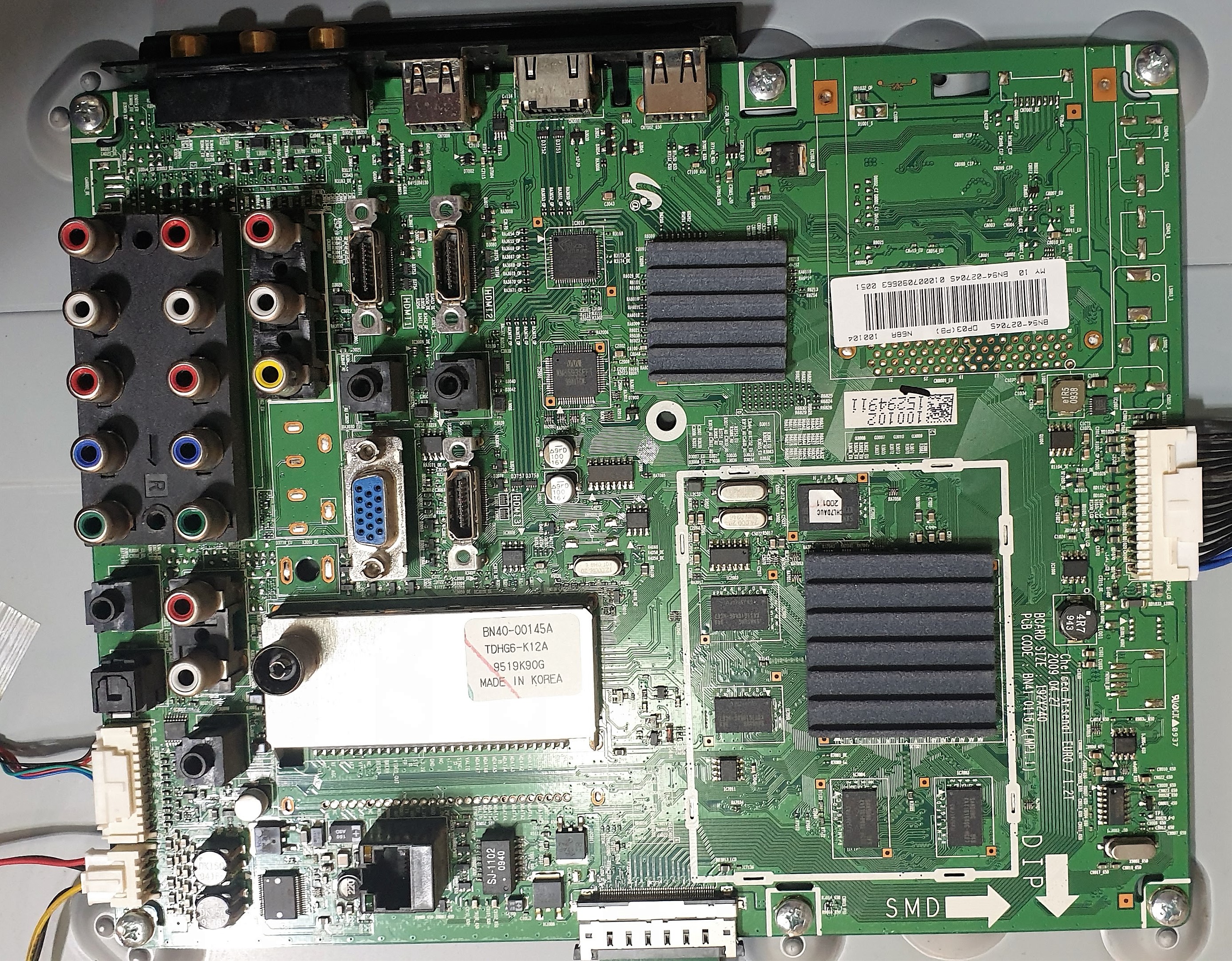

    I'm thinking the power board is ok, but the main board may have a problem. It would appear it's loading one of the supplies off the power board and then retrying to power it up again in a cyclic way. Has anyone seen this type of symptom. The main board has three smd caps and the ESR measures them in circuit within specs based on their capacity and voltage. They also look ok and no leakage to be seen.
    Any thoughts?

    At this point it looks to be the main board is loading down the SB.
    Try checking the resistance between SB 5V pin of the main board and the Ground pin of the main board to see what kind of resistance it has.

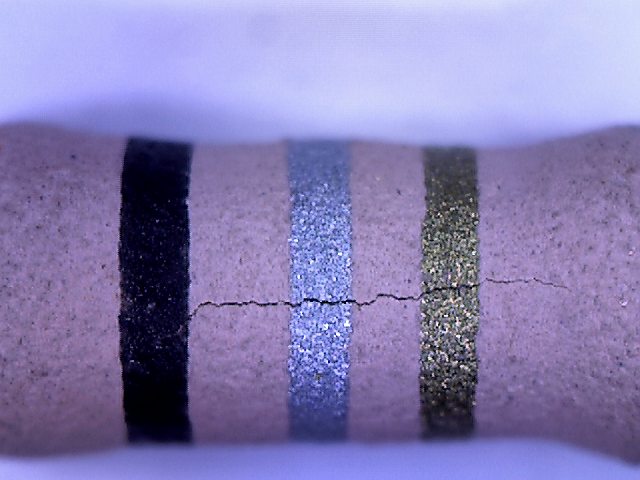

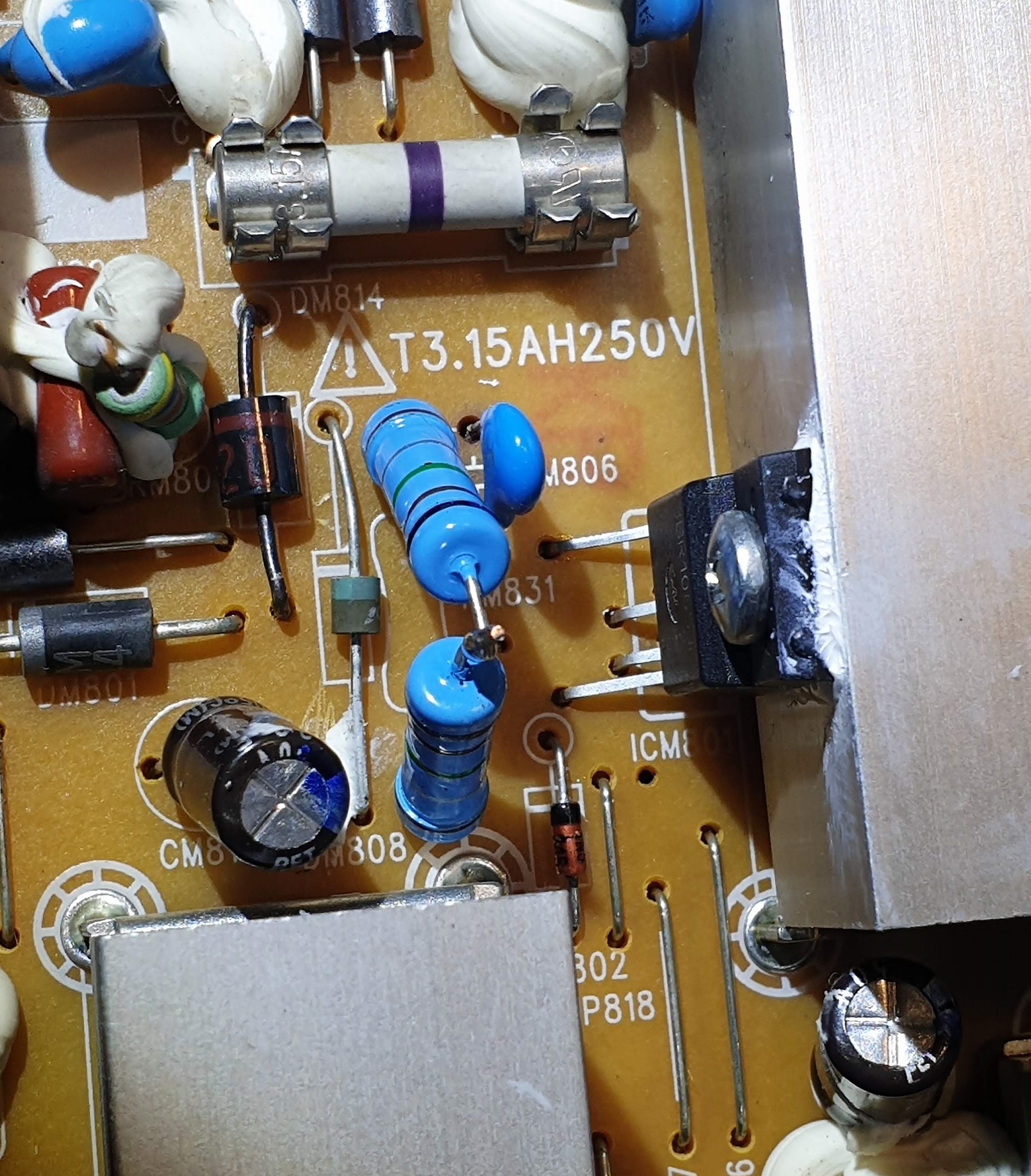

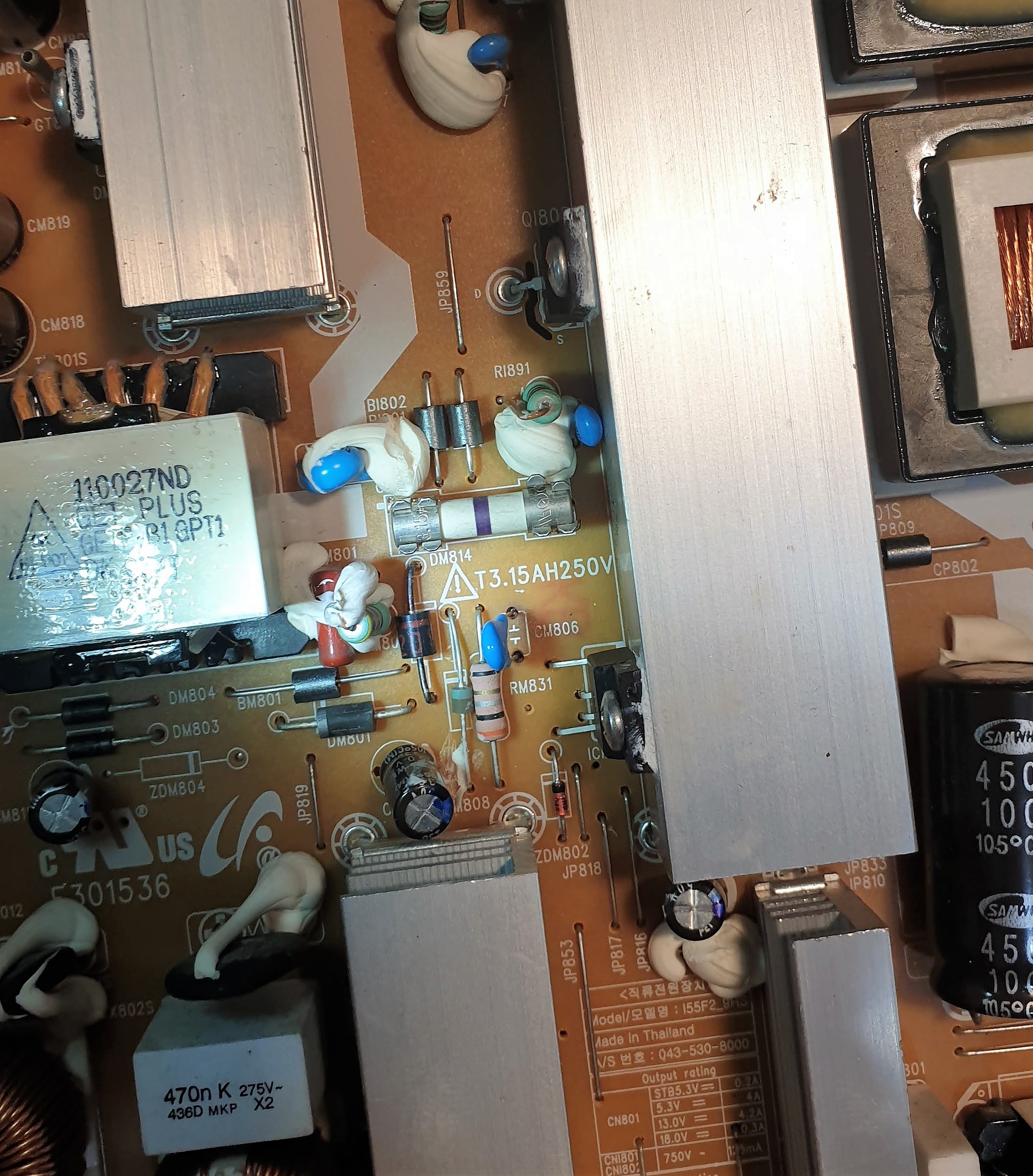

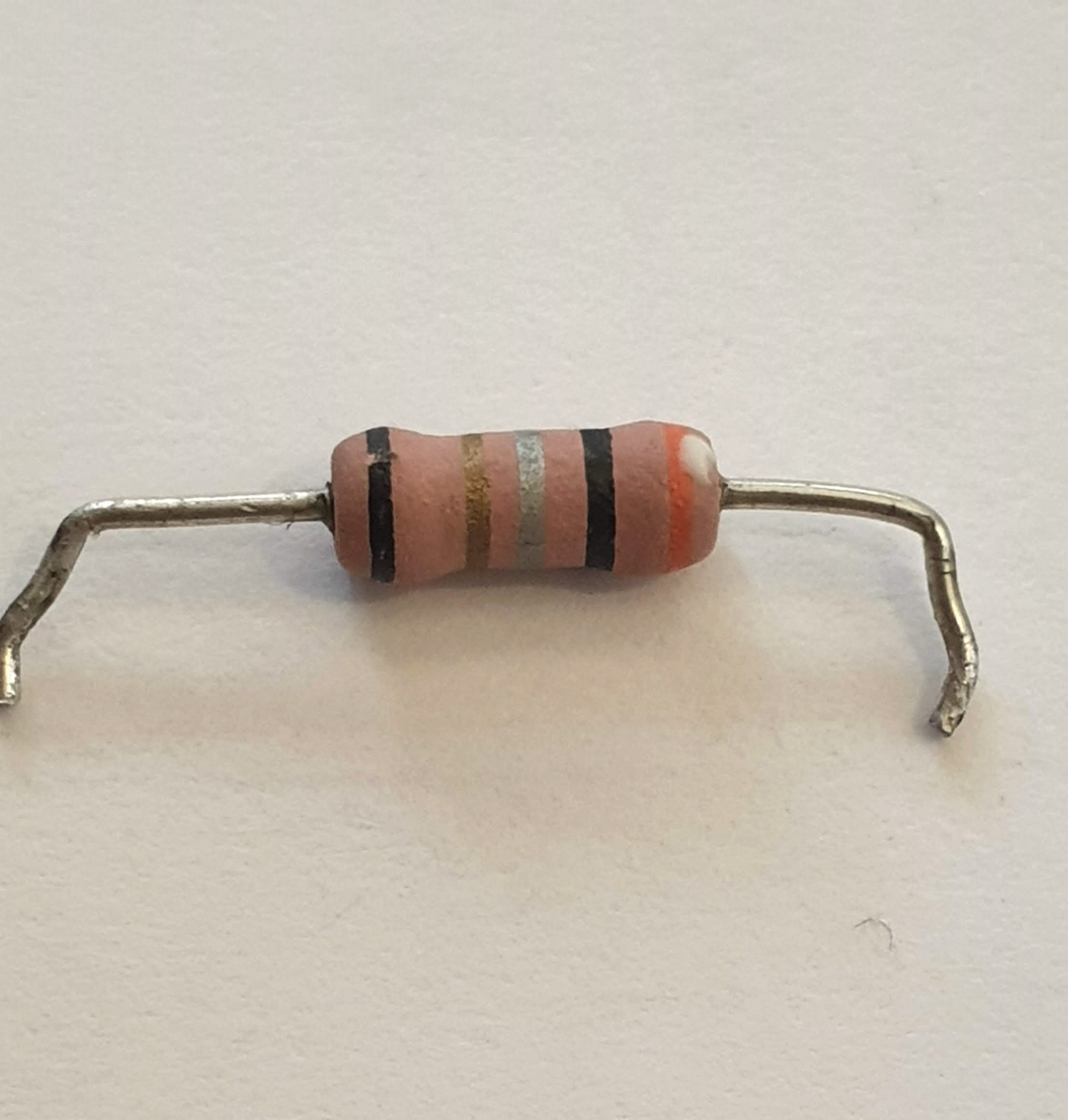

          After I measured the current drawn by the main board via a current limited power supply, I must have made a mistake. I repeated the measurements and checked again. This time, non of the voltages fed to the main board drew more than they should. Not sure how I goofed up the first time. This time they were all well within limits (5.3v stby 30ma, 18v 0ma, 5.3v 800ma and 13v 630ma). Thus I began to suspect that the main board wasn't the cause of this current overload on the power supply. I could not find a circuit diagram for this power supply (BN44-00268A), but I did find one for BN44-00264C) Although not identical, they both have ICE3BR1065JF SMPS Current Mode Controller. I began to suspect it might be misbehaving. What controls it is the current sense resistor RM801, which on my board is 0.4 Ohms. Visual inspection didn't show anything wrong, but when measuring in circuit I couldn't get a stable measurement. i.e. it was rocking up and down. So, I pulled it out and measured it out of circuit. I then discovered it was still rocking up and down in resistance. From about 0.4 Ohms up to several ohms. I put it under the microscope and lo and behold, two hairline cracks on either side! I didn't have a direct replacement, but put in two 0.15 Ohms in series. Now the TV works fine. So in summary, if you have these symptoms, make sure you check RM801 and/or the controller. See photos as well..
