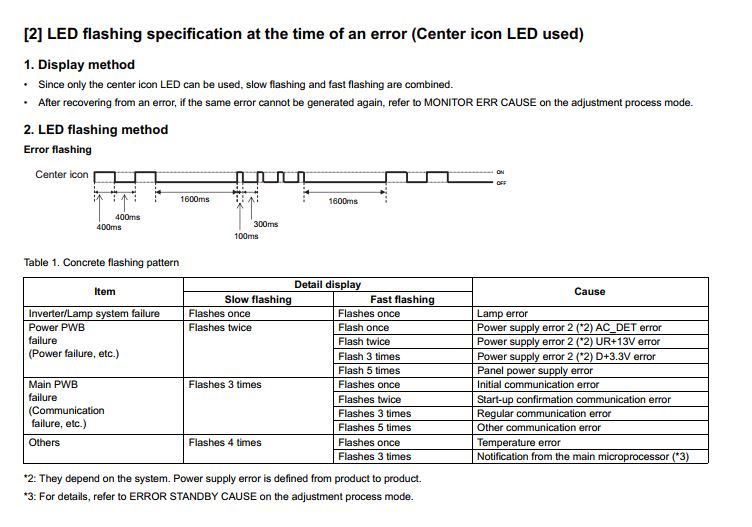

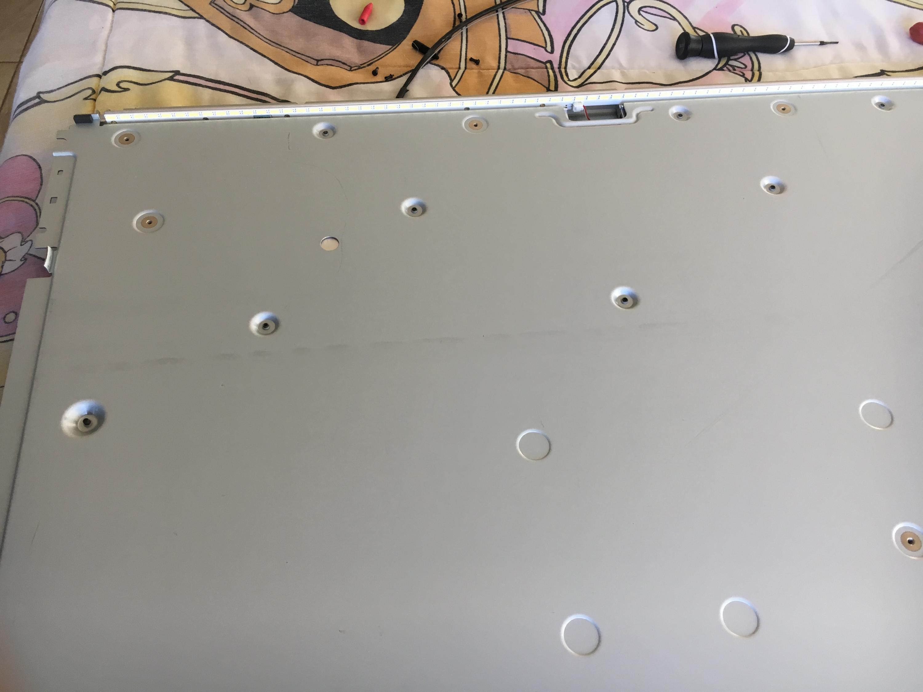

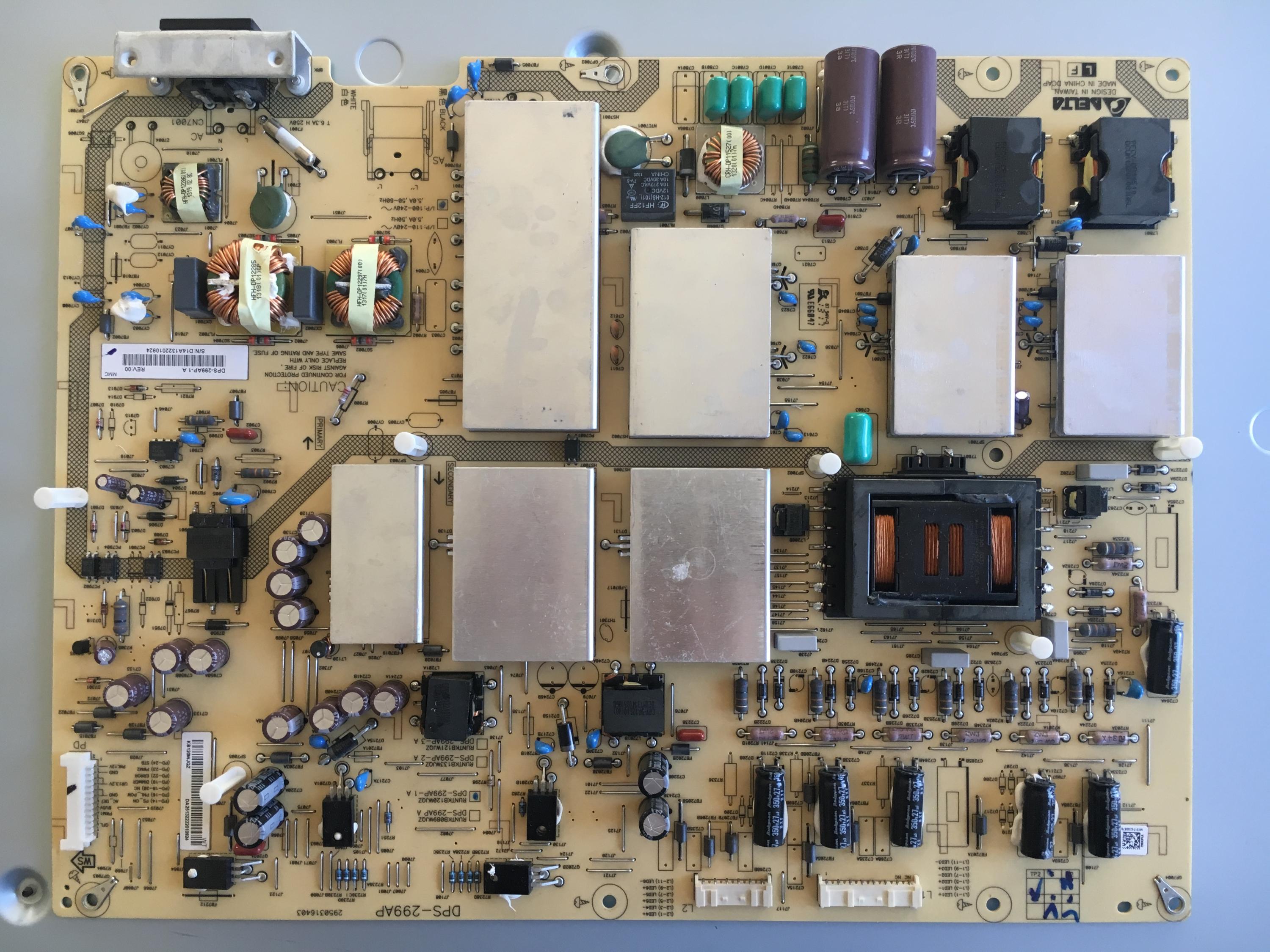

    Hello I have an LC80LE857U that was originally dead with a blown fuse. I ended up replacing the power supply from Buyqual https://www.buyqual.com/sharp-runtkb...led-board.html which is a RUNTKB120WJQZ. The TV was able to turn on and the backlighting came on for two seconds and it turned off. I took a look at the error code and it flashed 1,1 which I know according to the service manual its the LEDs. I did a hard reset and everytime it would go off after 2 seconds. It wasn't my first time around replacing the LEDs on the strip on a Code 1,1. https://www.ebay.com/itm/100pcs-LG-7...UAAOSwLnBX5IVn So I ended up taking it apart and injected current into the strips. Come to find out all of the strips are lighting up with a tester. Any tips is really appreciated.

            on the bottom left on your first post, 3rd picture there is a plug that goes to the main board. Post the DCV with pin name and DCV measured.
            For a minute I thought you may have the wrong PSU, but at SJ they had the same PSU # RUNTKB120WJQZ. Anyway... on that plug there are some pins like error, dim, etc... let's see what they say. The service manual sez this:
            ERR_PNL: failure(H). Inverter/Lamp error is detected.
            Note that after five detection counts, the lamp cannot be
            activated except in the adjustment process mode.
            Accumulated counts are cleared to 0 by the setting in the
            LAMP ERROR RESET on the adjustment process mode.
            Any possibility that you went over the 5 bad lamp detection count?

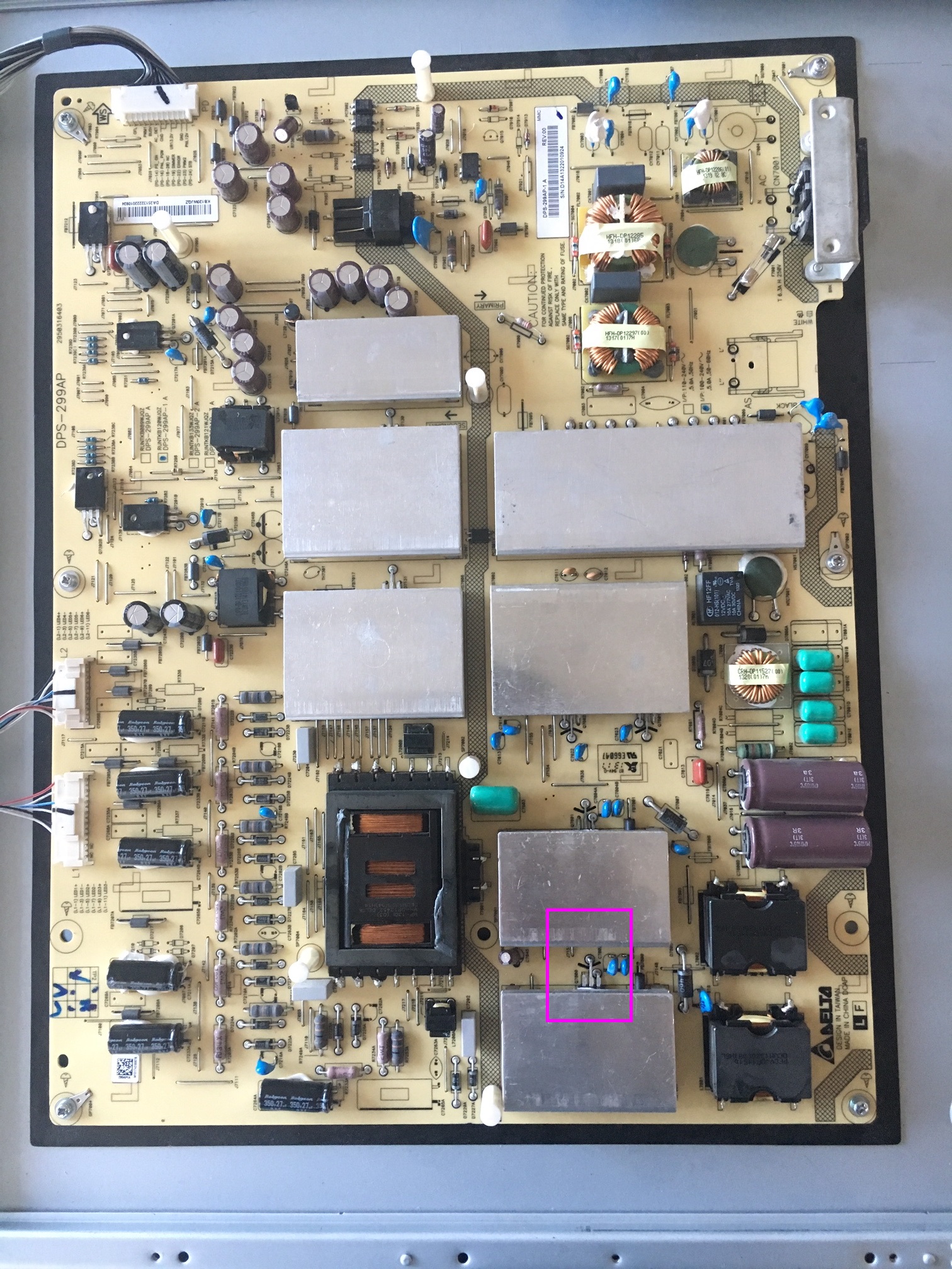

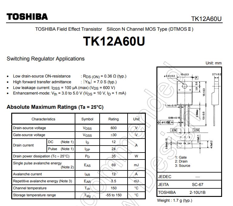

              OK I was able to fix the problem. I thought maybe the main board was a bad code. The Main Board did not fix it. I gave up on the power supply I bought from https://www.buyqual.com/sharp-runtkb...led-board.html I ended up repairing the power supply that came with the TV. I replaced the N-Channel Transistor at Q7800 with a K12A60U equivalent and the fuse. TV is working now! I'm stuck with the board from buyqual because it's going to cost as much to ship back to China. I appreciate every input that was given CapLeaker
