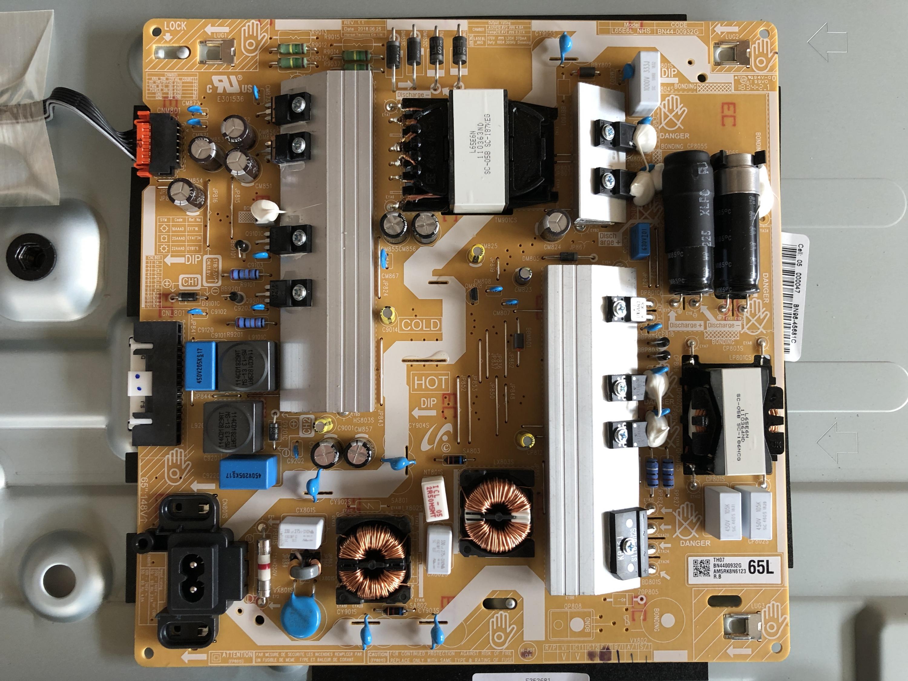

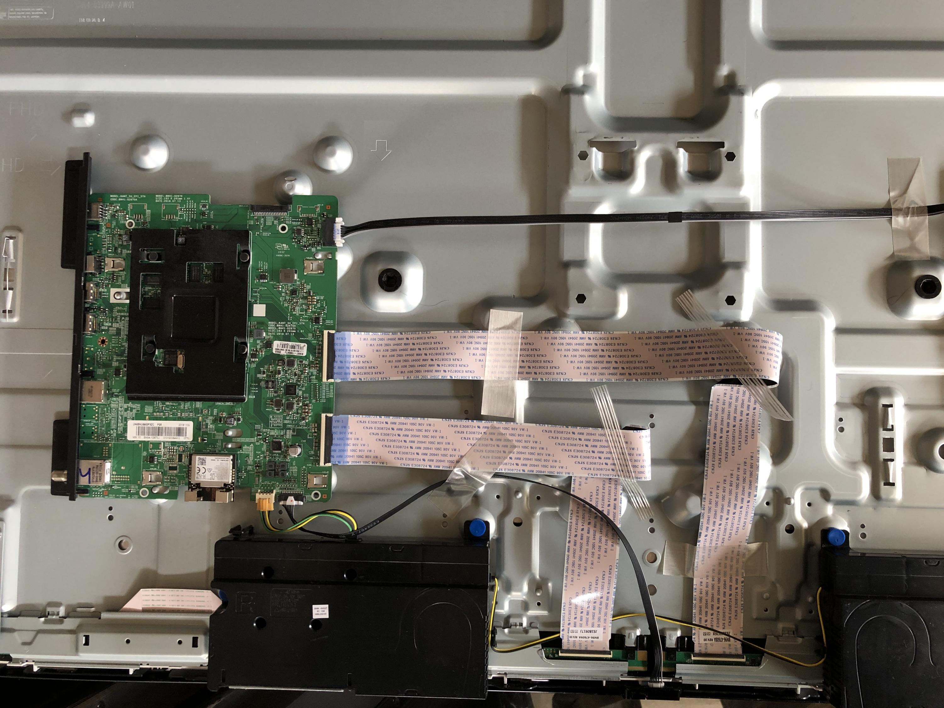

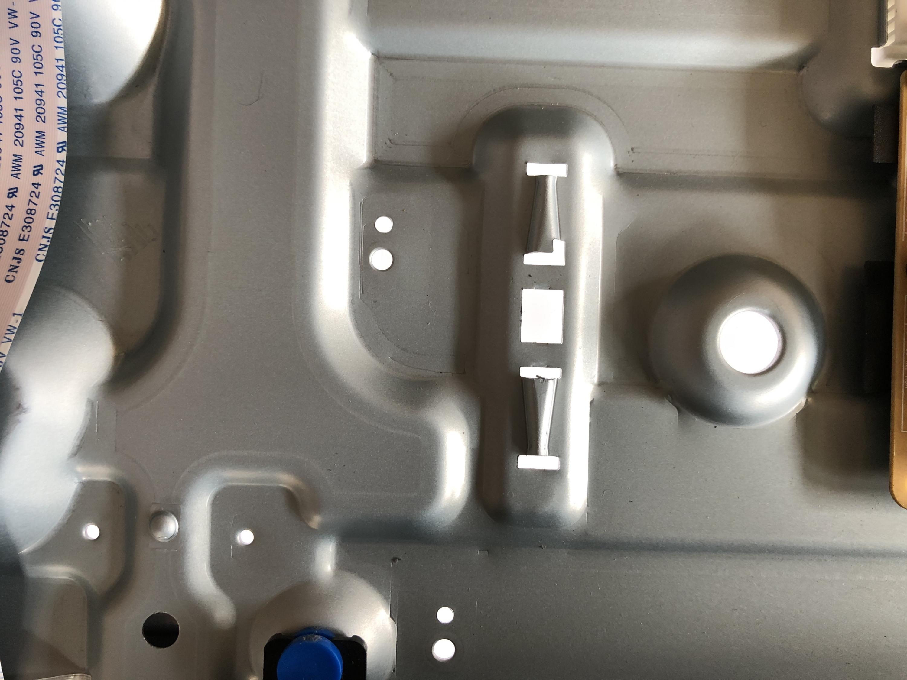

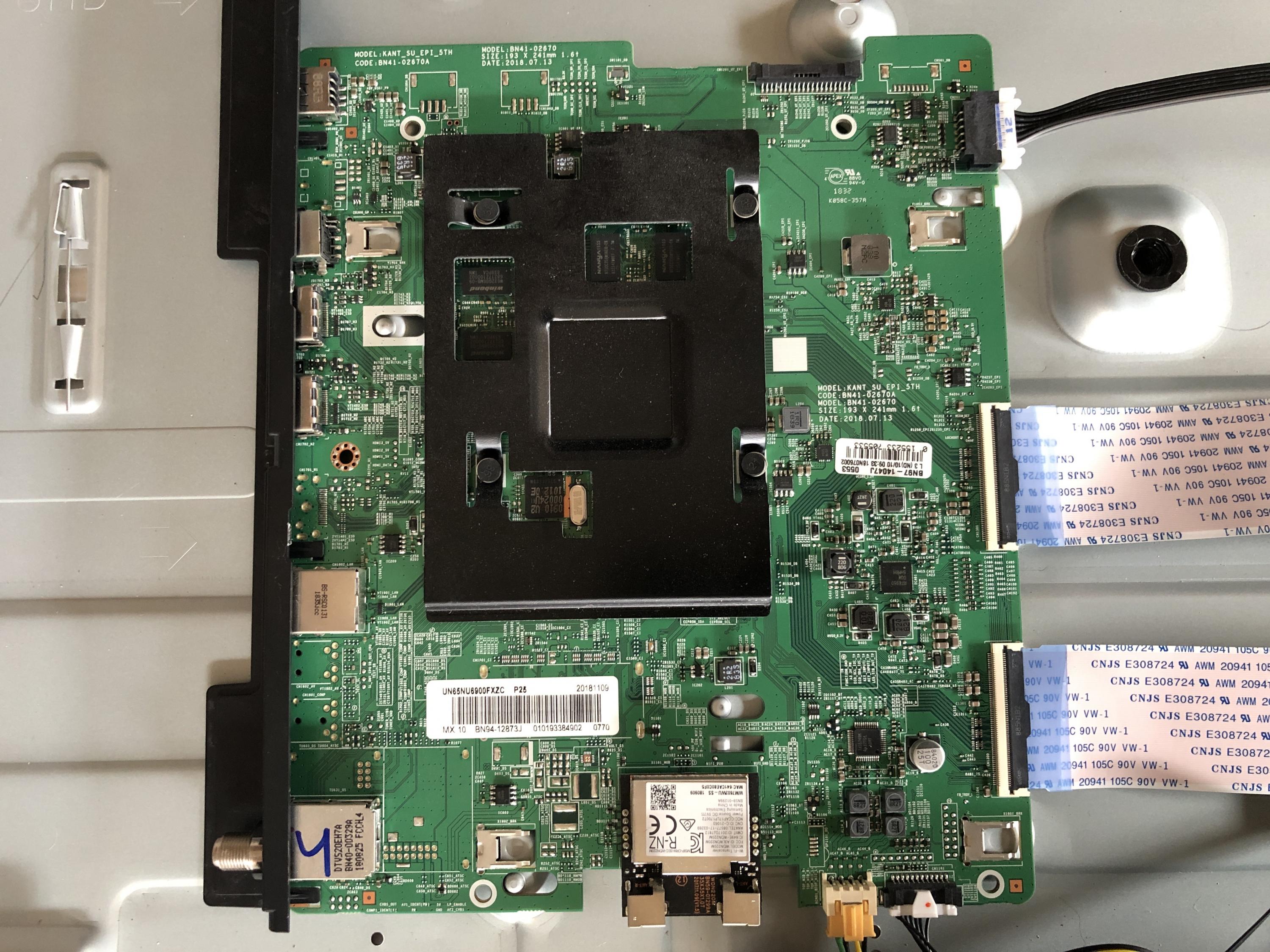

                              Good day guys
                              I got two of these Samsung UN65NU6900 TV's from a restaurant group. One, when switched on come on with only black screen, backlights on, sound on, responds to remote, no image with flashlight. If I take of either of the two tabs going to the panel, in both cases the right side comes on white. The other TV when switched on, showed perfect picture, but with vertical bar about 6 inches wide on left side. It eventually worsened to same as above.
                              Is this a panel problem, or can someone give some advise.
                              Thanks for reading this.
                              Herewith photos of boards inside this TV.

                                      I may be reading it wrong... not sure I understand "If I take off either of the two cables going to the panel, in both cases the right side comes on white".
                                      Can you please explain, for just one set, exact what happen with each cable disconnect. It is important to get the details right so that you can focus on where the problem might lie and save the panel. A "clean white" screen on the side that is disconnected is some what "normal". The other side (connected) should show something assuming there is something to show (ie. menu or input). Pictures of the result may be worth a 1000 words... :-)
                                      • henryvrensburg
                                        • Oct 2018
                                        • 104
                                        Re: Samsung un65nu6900 bonds get extremely hot
                                        If I remove the left tab going from the Mainboard to the Panel, the right half of the screen comes up white, and if I remove the right side tab, the right side of the screen comes on white too. That is what's weird about these TV's.
                                        Also, I did replace the mainboard on one TV, but with same result.
                                        Will add a photo shortly.
