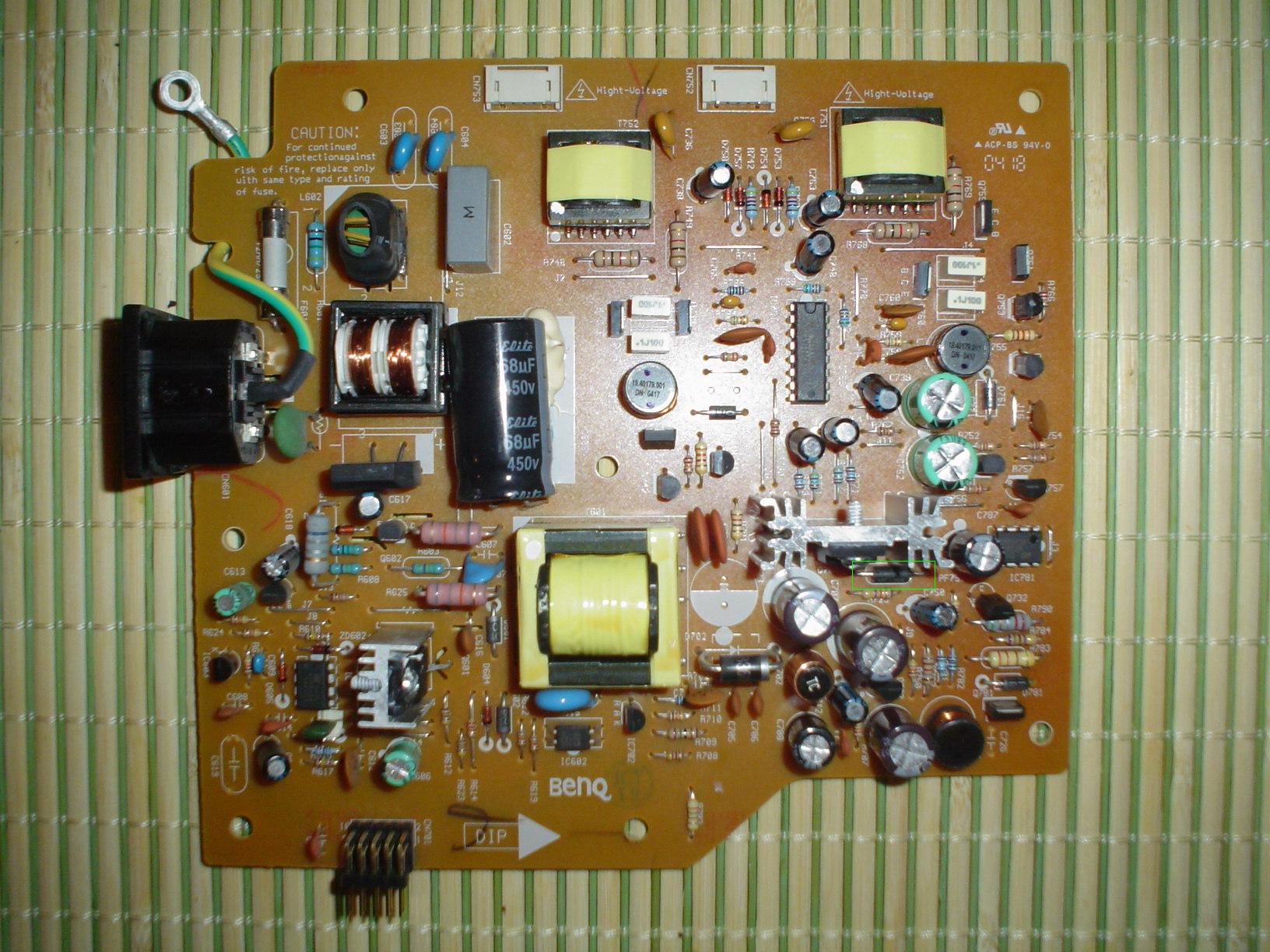

    Well i quess i should say hello to all, i'm new to this site and in need of a serious repair (to me anyways) If you have any Q's on irrigation i might be able to help....lol

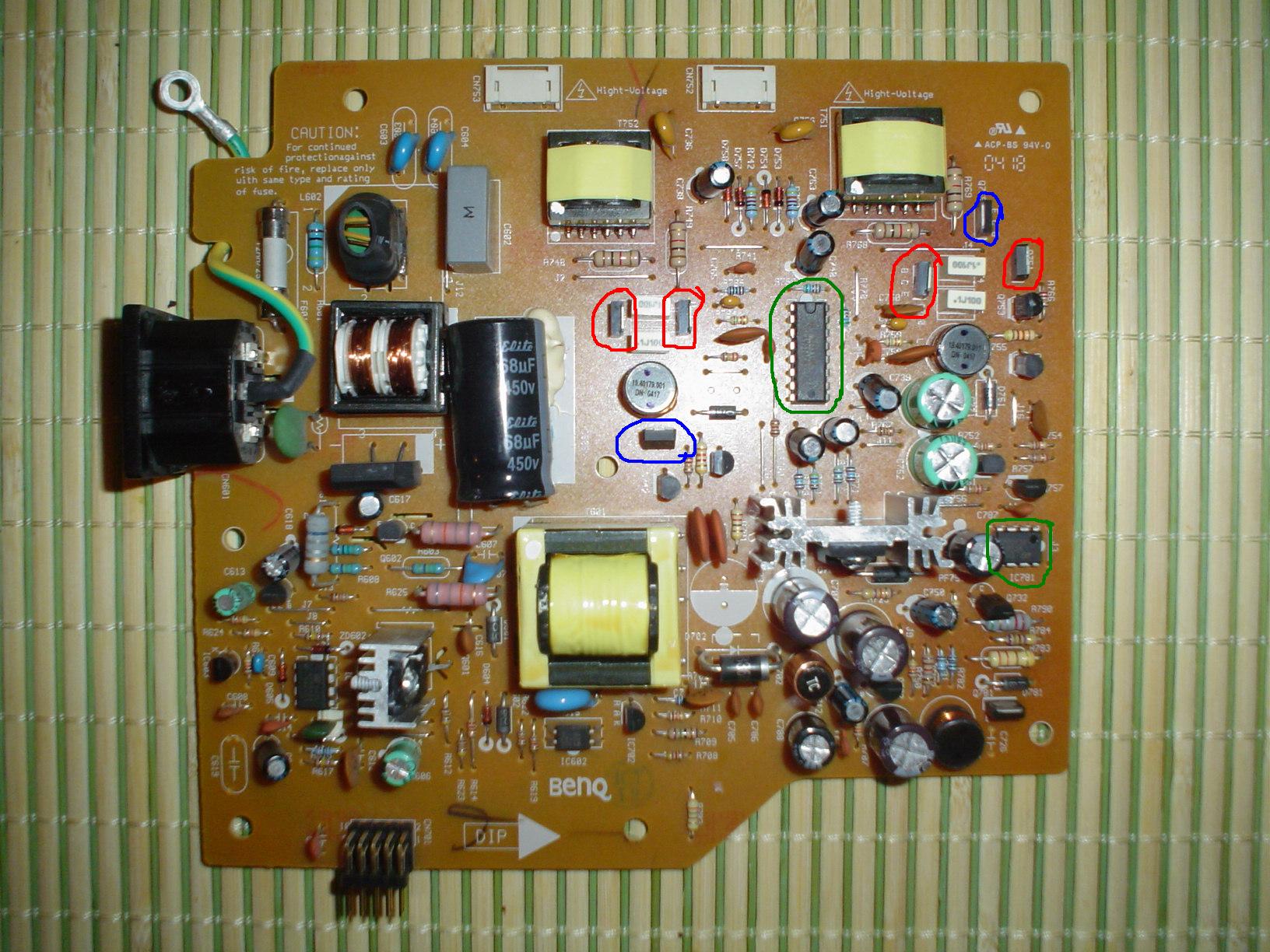

                    It's a pretty good picture, but a couple of tips to improve the next one. Turn off the flash and use a tripod to steady the camera. If you have steady hands and excellent lighting you may not need the tripod. The flash tends to 'white out' portions of the picture.
                    First of all, what have you done with this board? (Replace caps, resolder transformers,cast a spell, curse?)
                    The inverter circuit on this board looks similar to the one used on the E172FBb, but the layout is different. I have attached an edited version of the picture. 4 transistors have been circled in red. They should all have the same part number, C5707. 2 transistors have been circled in blue. They should have the same part number, FU9024N. Check these transistors for shorts. I have also circled two ICs in green. What are the part number of these ICs.

                      the small ic reads 063ac/kfh414 and the big one reads 42ayt8m/tl1452acn

                        I did change the transitor the big one on the left side by the large cap(cause of the burnt legs)and nothing same thing..

                            spotted small error because I made same mistake myself when renewing transistors
                            the blue and the red circle at top right need to be swapped,you have mos for tran and vice versa
                            also might help the fuse no doubt dead, its just in front of big heatsink needs marking

                              I checked the fuse and it beeps continuity and the blu and red you want me to swap em out?

                                  No, wait untill Plainbill gets back to you, he will explain
                                  (One blue circle should red and visa versa)

                                      Thanks for pointing that out. This was my best guess, that's why I was suggesting he check the part numbers. I was trying to identify the fuse, but wasn't sure where it was.

                                        The fuse is to the right of the switching transformer right below the heatsink the main switching FET is on.
                                        It has green text on it just like mine did probably made by Bussman boxed it in green.
