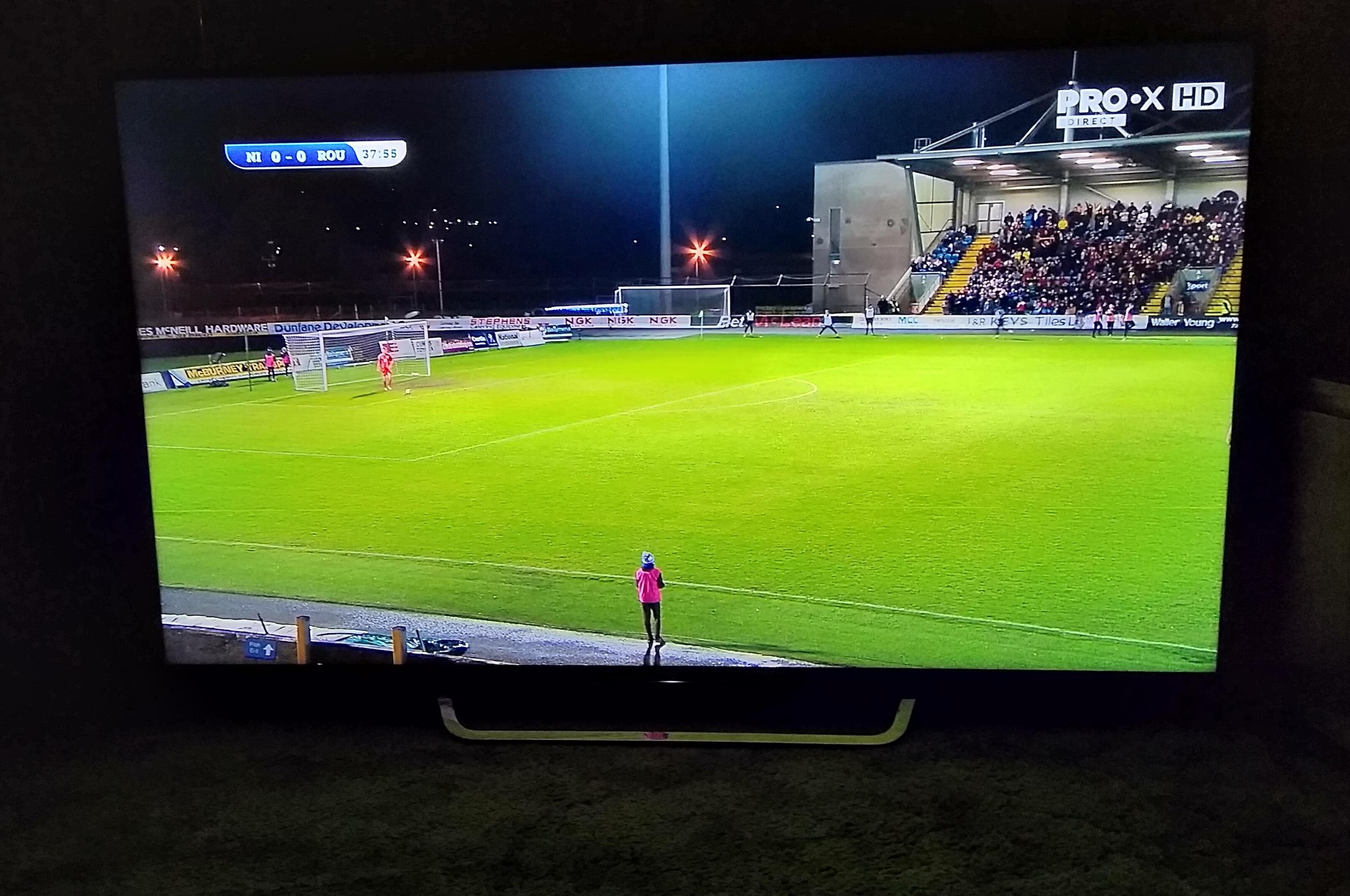

      As I've said the problem seemed to be and indeed was one of the COFs on the left side that was in short. It didn't let the Tcon function properly.
      I peeled off all the left side COFs eventually and it solved the no good picture from the start (all those vertical lines).

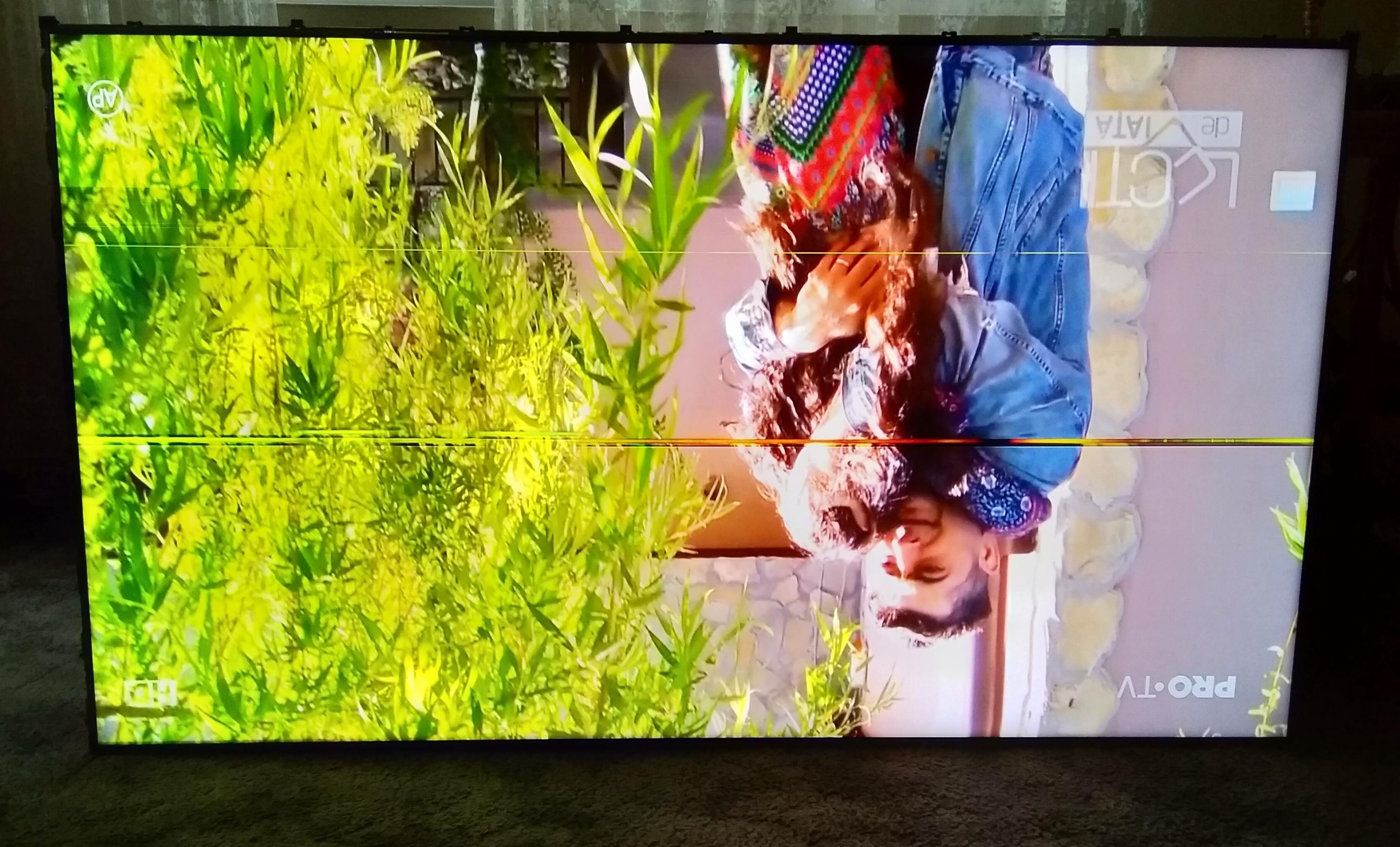

            As I said, I finally decided to remove the problem COF (and all the side COFs afterward)

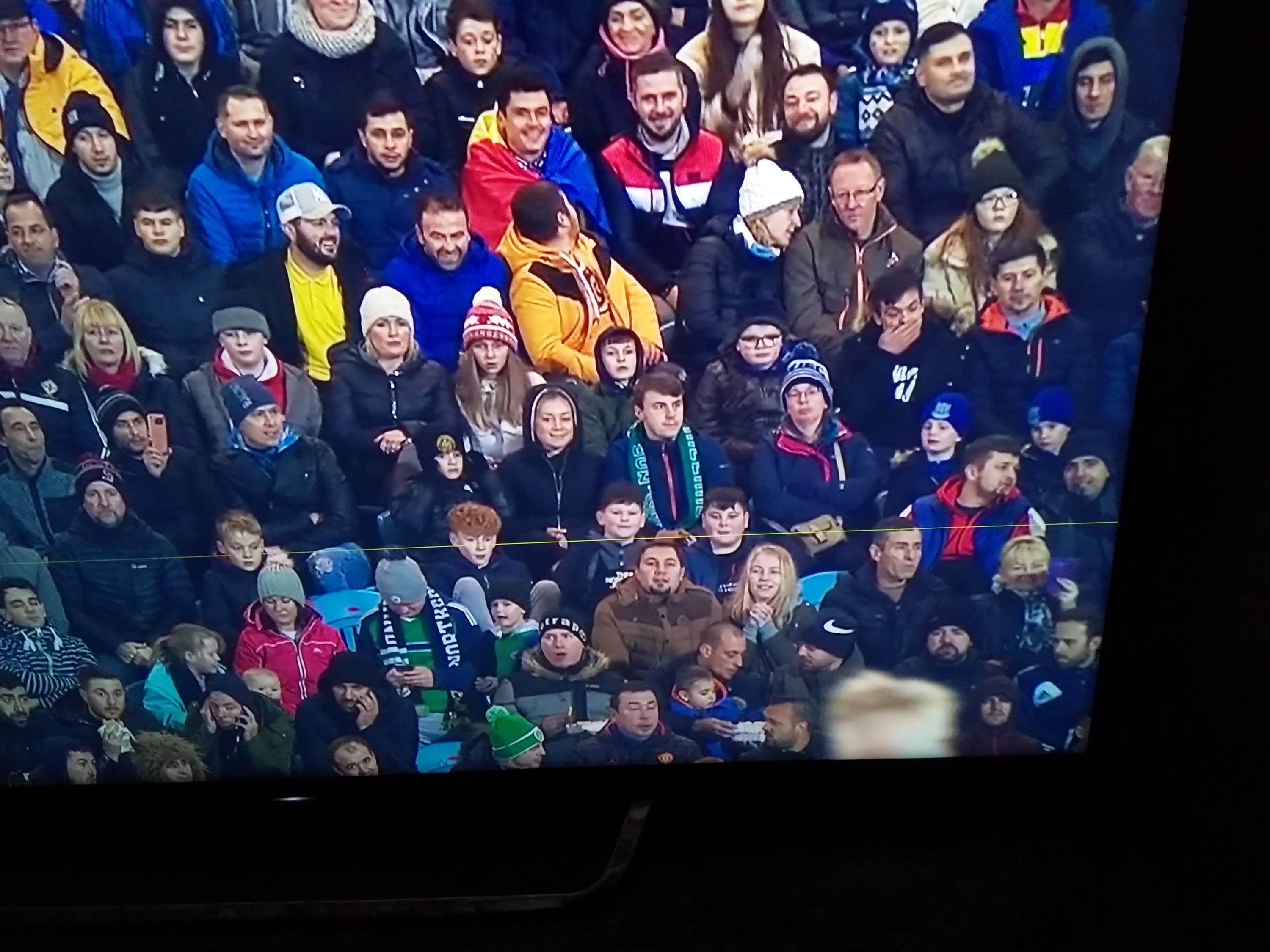

            The display has a problem still:
            A horizontal line (a pretty thin line from normal viewing distance (I guess 4,5 real liquid crystal lines in reality; 4k Tv))
            It is from edge to edge (in the sense it doesn't fade away at all).
            It changes colors interestingly:
            it gets it colors somehow from the adjacent lines
            it has different colors from edge to edge (not just one solid color from 1st column to last)
            also it seems slower (changes colors slower)
            it goes to black only when the picture is all black
            Is there anything I could do to make it go away?

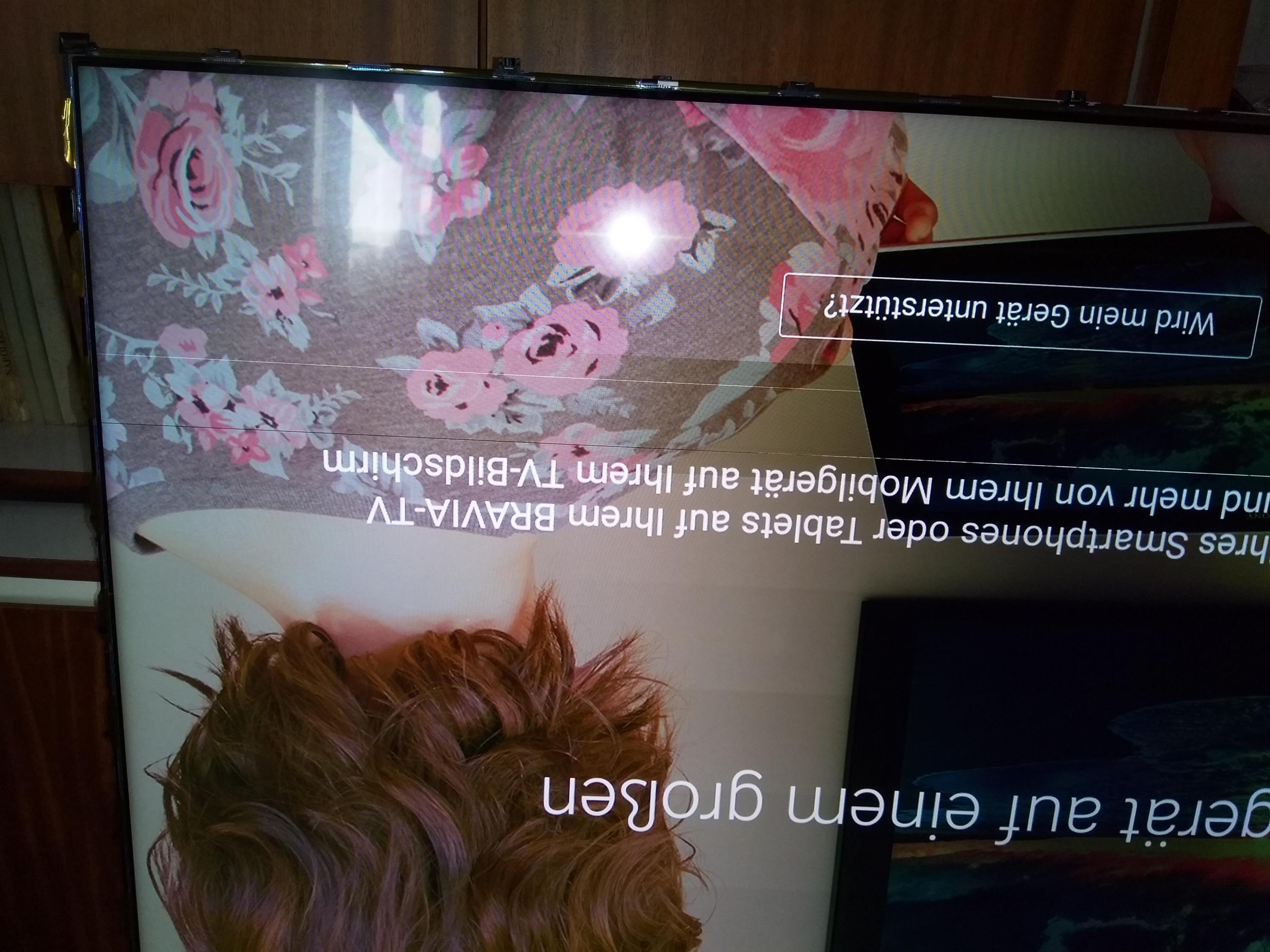

            From what I've described I guess I could conclude it is not a short in the glass, transistor lines from the LCD.
            I pressed the COF that is responable for those lines (there are 10 on the side) but there was no change at all.
            And I know if a COF has connection problems to the glass because (as you could see in the 3rd attached image) I, unfortunately, had (because of handling I guess) some problems at one of the COFs, which I had resolved easily with a little bit of scotch tape
            So, I don't think it is related to the side COF, because this line was from the beginning (you could see the pictures in my original post) even when I disconnected the left and the right side of TCON ribbons.
            This is what gives me hope.
            Maybe someone with experience has seen this kind of lines and would give me some insight into this problem
            Thanks.

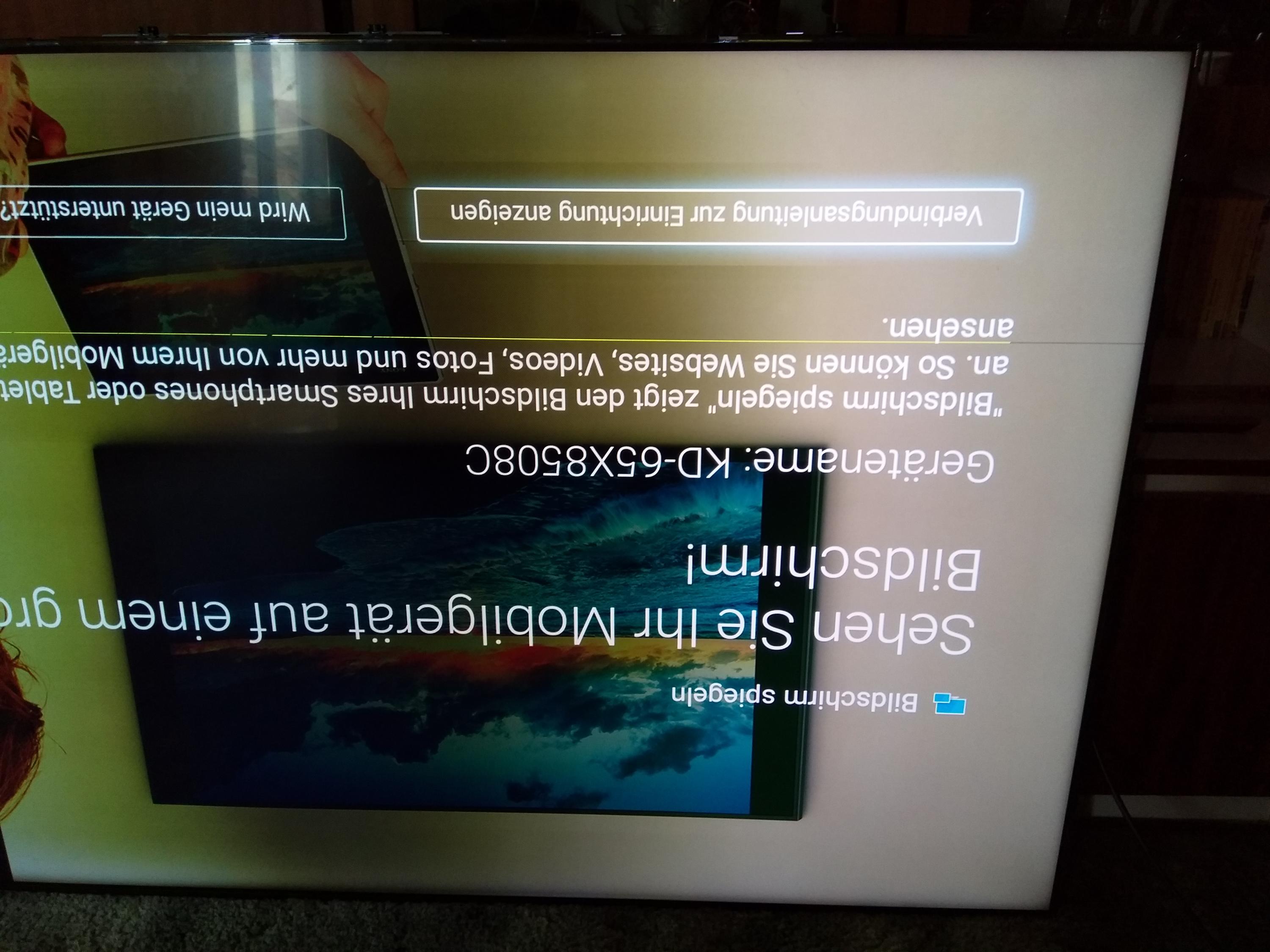

                1st attachment - left side COFs active - line is there
                2nd attachment - right side COFs active - line is present
                (these are older picture I had taken more than a month ago)
                That's why I said I still have hope.
                How could this be side COF related, then? (when with active right side COFs line is there, with left side active it was there too)
