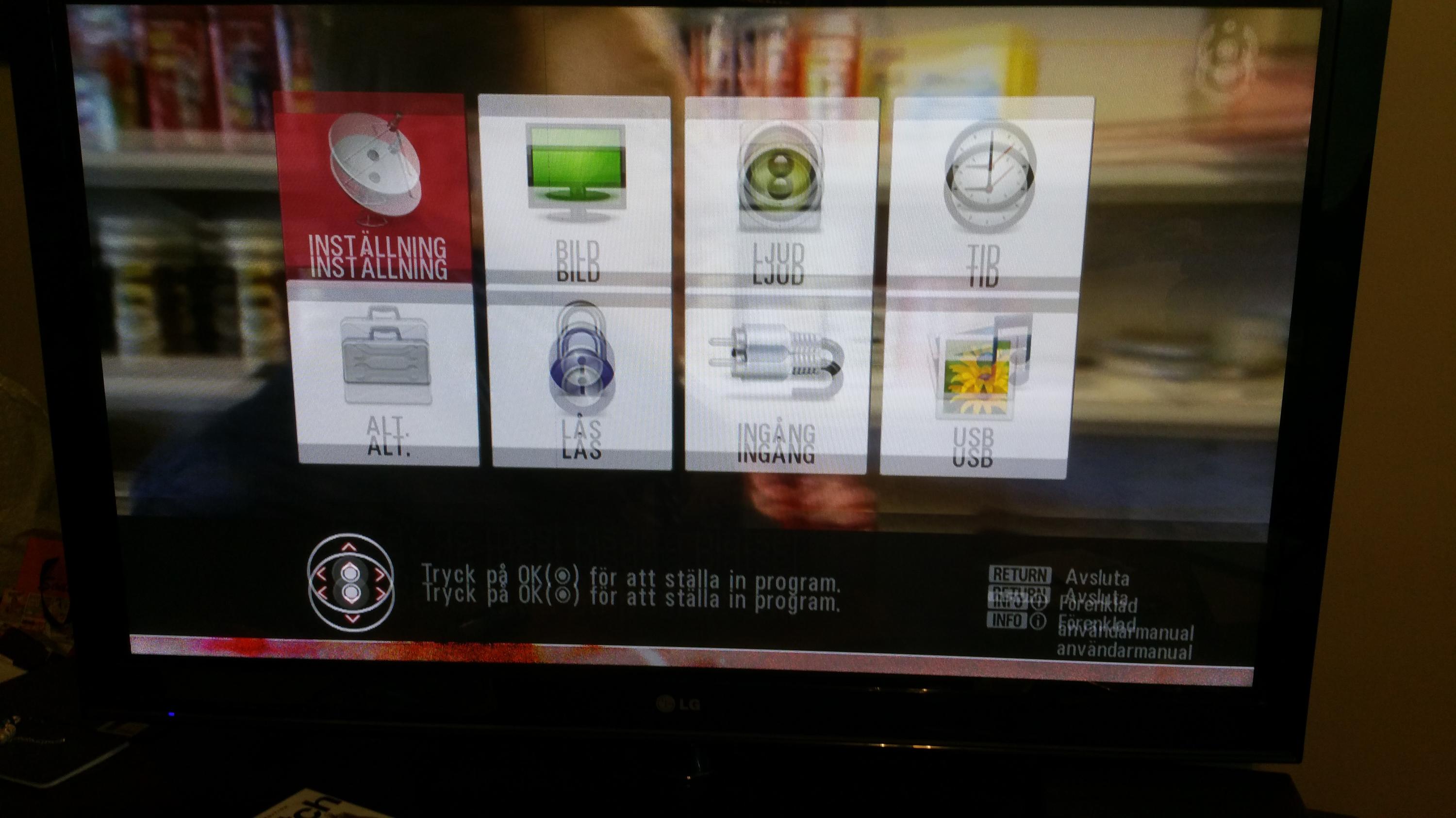

    As the title says. The picture has a double image vertically
    I was wondering where to start the fault check.

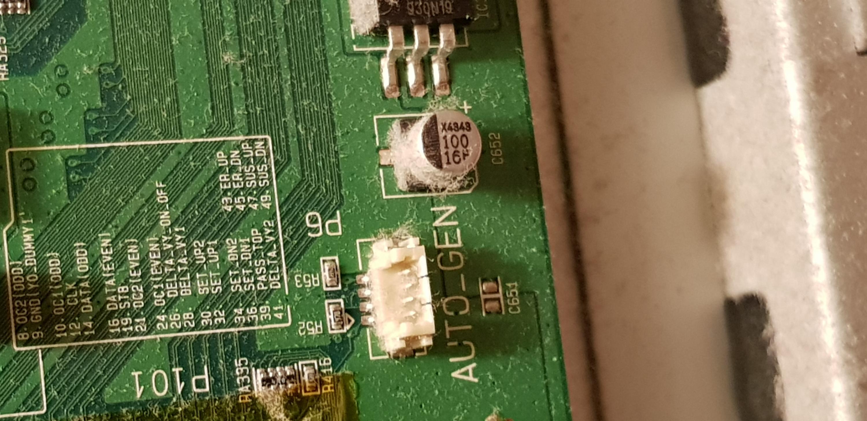

    I would start by checking just the panel using auto_gen test patterns.
    Unplug tv, dissconnect the cable between the main and control borad, locate and short the two points on the control board labeled AUTO_GEN and plug it the tv a see if the fault is still there while viewing the test patterns

        If the control board has a P6 plug (lower left on board) short pins 1~2 for Auto Gen. The fault could be a poor connection with the lvds cable also, (wide flat cable between control board and main) try re-seating this cable a few times if the autogen tests are ok.

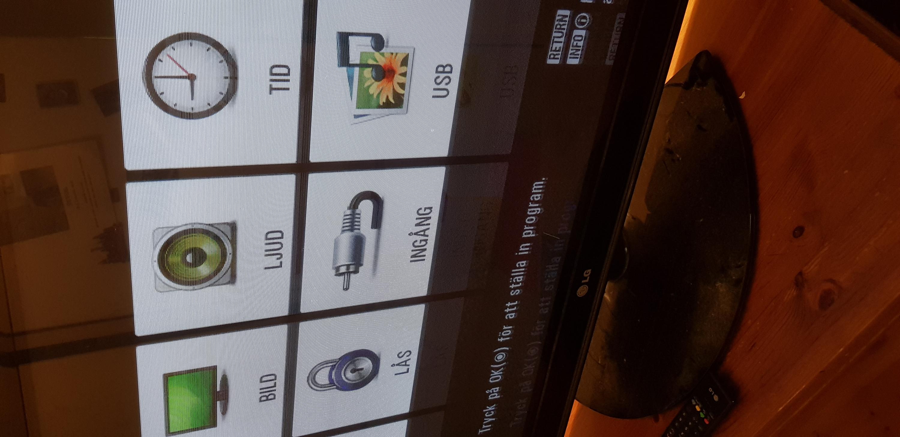

          Some additional information. The tv has not been used for a lo g time so when I turned it on the picture was perfect for a few minutes but then the double image returned and when on for a lo her time the screen continues getting worse with the double image flickering.and even a few thin horizontal coloured lines and on the top right corner some small shadows of red, but once in a while the screen becomes perfect for a few seconds.
          That's the auto gen plug. Just to be clear, is 1 and 2 to the left?

            Pin #1 is marked with a white triangle. If the tv has'nt been used for a while I would re-seat all the connectors and maybe even clean and re-seat the flat cables between the panel and buffer boards.

              I tested the auto gen patterns. The pictures has less distortions but in some tests the double image is flickering but much less

                  I clean all flat cables on the left side with alcohol and repeated them. At first I got 2 black horizontal lines, thin, and repeated them again and the lines disappeared. I cleaned and repeated the flat cables from the logic board and now it's almost perfect. Just a liiiitle small flickering left

                    Update. After letting the tv stay on the flickering got back more and there is a sound...hard to explain..but humming sound coming from the board to the left. When I touch one on the flat cables from the logic board the sound disappeared and the screen looks a bit better. Maybe reset the cables again and clean them
