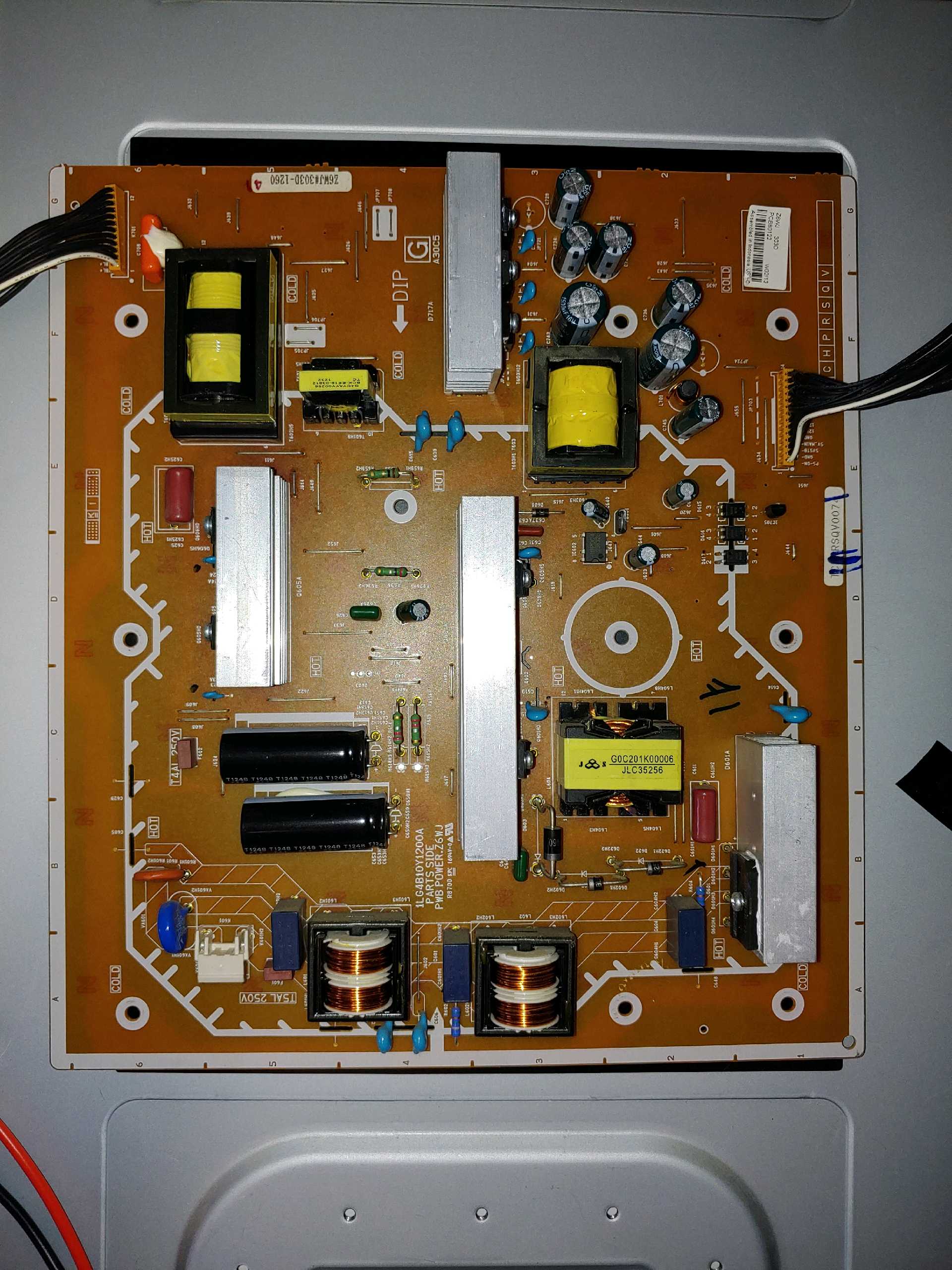

    I have a Sanyo DP50483. TV won't power on, however i do get 5V standby. When i plug in the set it automatically gives PS_ON 3.1V and the LINE_OFF voltage drops. BL_ON and BL_DM never show signs of life. The voltages i get on the connections to the main board (Listed below) are all stable except PS_ON. The big miss i see in this system is that the 15V for the backlight never gets above 12.6V. Also the PS_ON is getting 3.1V, I don't know if that's enough to get the system to switch on the 15V backlight circuit (Or maybe i need the PS_ON to go low?). I tried connected a resistor from 5V standby to PS_on and got the same readings except closer to 5V on the PS_ON.
    I've seen a lot of Main board issues with these models online, but i don't know my way around them when they aren't labeled clearly for test points. I I did try a new EEPROM ($15 figured why not?), but i see absolutely no difference in the voltages throughout the whole system (Including caps on the main board)

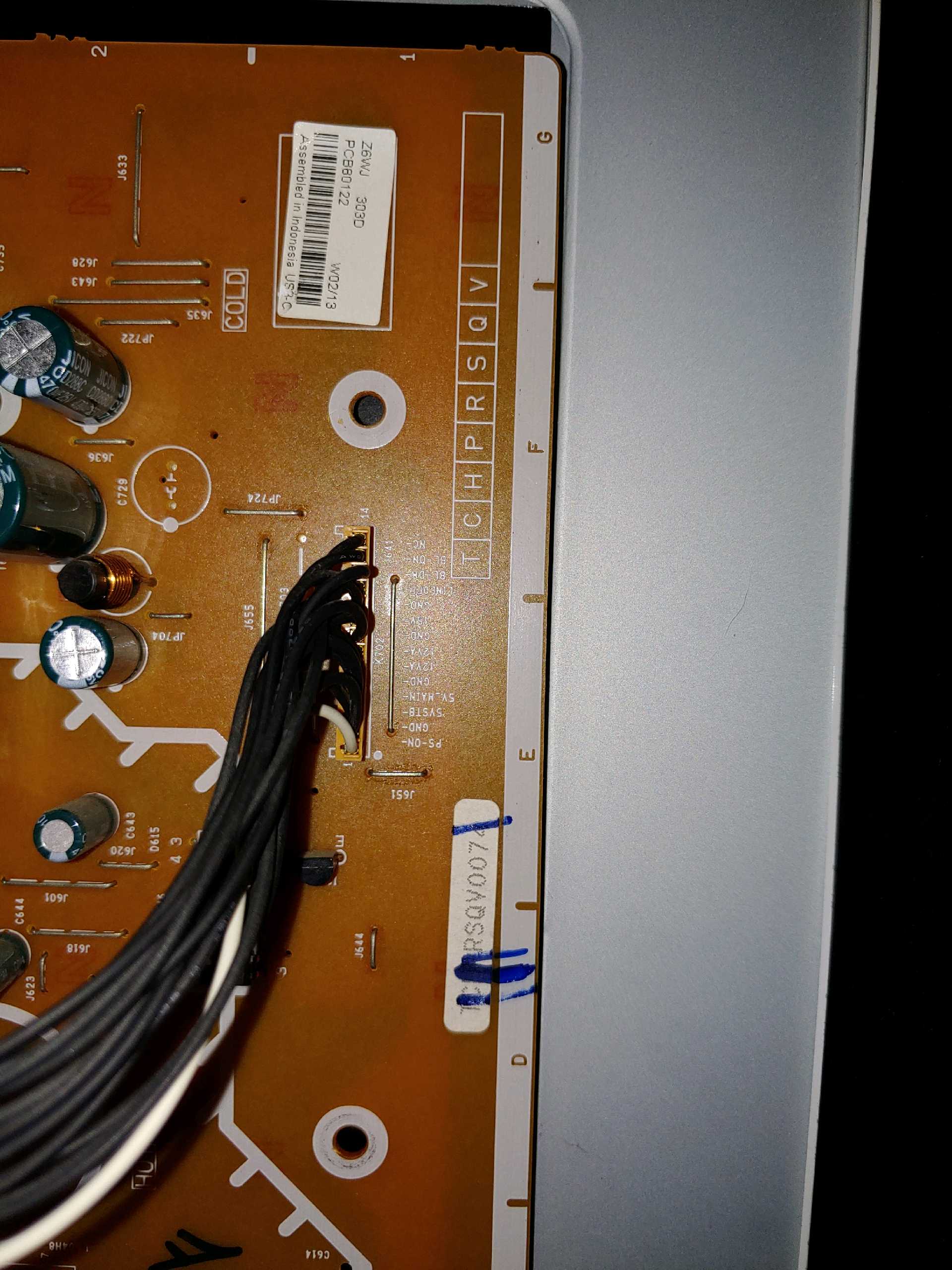

    PS Connections are as follows (1st number M.B. Not Connected, Second number M.B. Connected)
    PS_ON (0V,,, 2.9V-3.1V)
    GND
    5V STBY (5.1V,,, 5.1V)
    5V MAIN (5.1V,,, 5.1V)
    GND
    12VA (0V,,, 12.6V)
    12VA (0V,,, 12.6V)
    GND
    15V (0V,,, 12.6V)
    GND
    LINE_OFF (5V,,, 3.2V)
    BL_DM (0V,,, 0.1V)
    DL_ON (0V,,, 0)
    NC (0V,,, 12.6V)

    Re: Sanyo DP50843 Won't power on.
    Disconnect the BLon and Dim pin from the main board at the PSU. Take two 1k resistors and jump STBY voltage to BLon and DIM. See what happens if you turn the TV on.

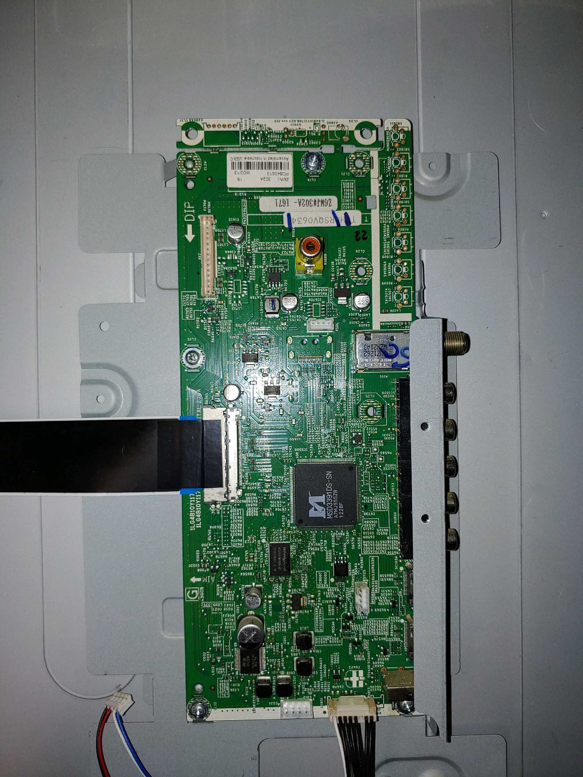

        so your main board isn't sending BLon nor the dim signals. These are getting generated on the main IC.
            No. It won't do that. If you have low 15V, I'd check the main filter capacitors on the PSU. I guess you have 2 problems to tackle.

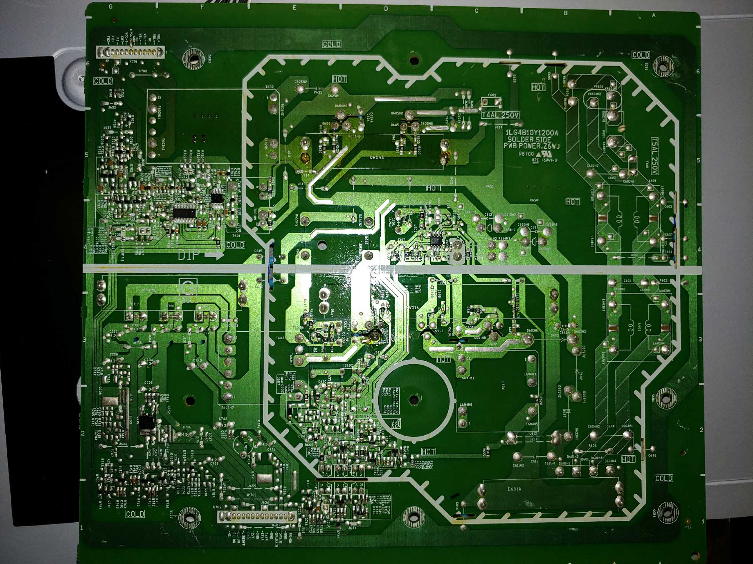

              https://assets.shopjimmy.com/media/c...6wj-bottom.jpg
              12.6V on pin 9 (15V) reading is correct because the 15V power supply section is not stuffed with parts for this PCB assembly version, it has jumpers installed for connecting the 12V power supply section to pin 9 (15V) and pin 14 (NC), that is why you are getting 12V on pin 9 (15V) and pin 14 (NC). You can see at the bottom side of the board and see how pin 9 (15V) 7 pin 14 (NC) are wired.
              The blank PCB can be stuffed to make many PCB assemblies as needed for many TV models.
              So right now the main board is keeping the BL-ON and Dim control lines LO.
                  Well after much fiddling around. I gave in and just bought a new main board. TV works perfectly now. Thanks to all who gave input.
