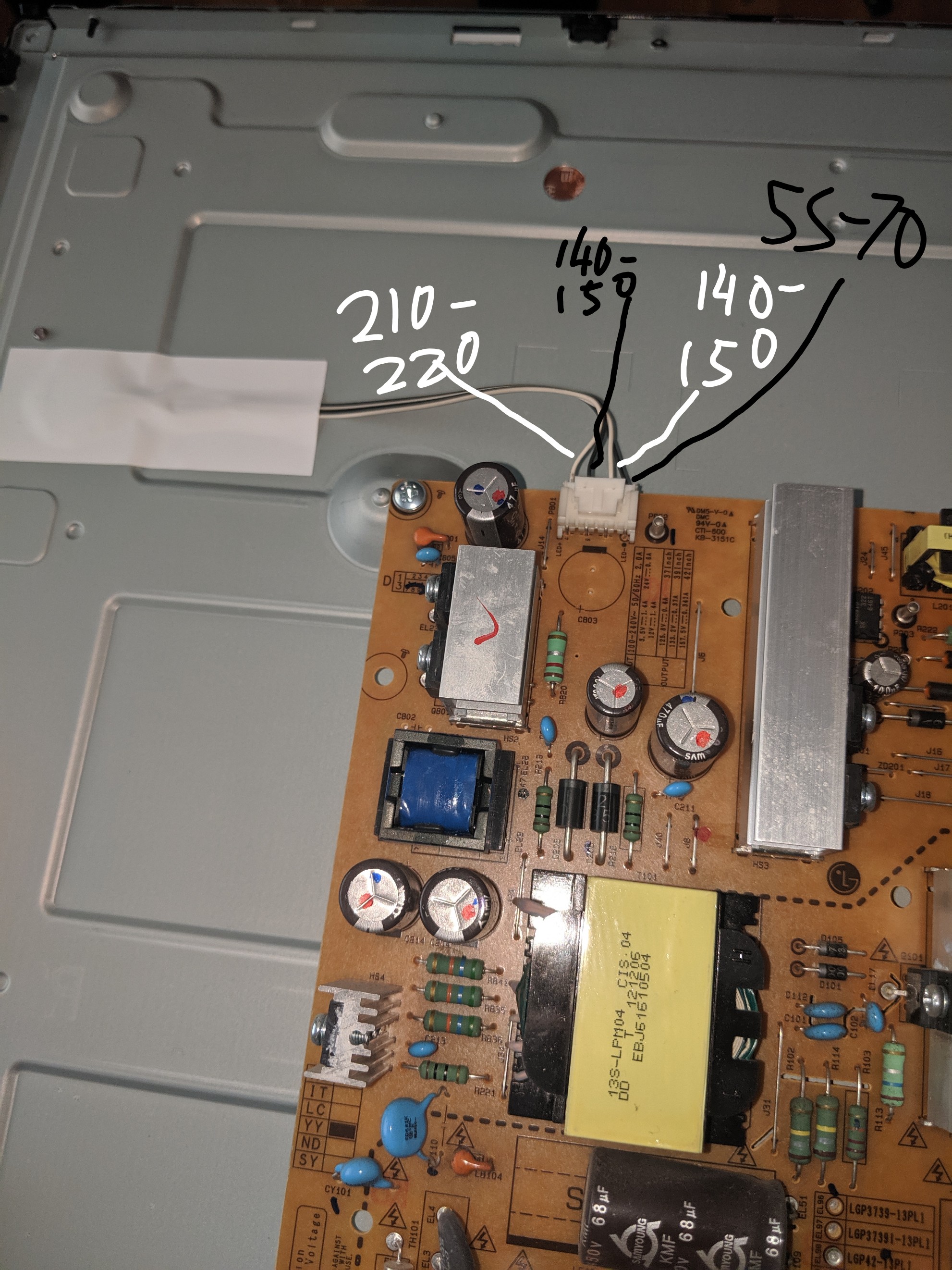

      May I ask while I'm learning if these voltages are correct as the mini diagram shows different thank you
      From left of the picture 210-220v, 140-50, 140-150, 55-70 (42 inch TV)

          The reading is from the bottom (ground) 0 12, 12, 0, 23, 0, 3, 3, 3
          On the led part from left to right of pic 50-60v 140-150v, 140-150v, 210-220v
          All seem healthy voltages why is the led different on the far left and right?

            you do wrong measurement on LED back light socket, you have 2 group black - and white +. so you should read with DM - + direct on black and white of each group each group--- just black - and white + and compare the value as written on printed label 157.V as your set 43
              Thank you i can finally rest while i was testing i put ground of multi meter to chassis the positive to the white middle wire alas i see the backlight stays on while like this..
              So i got someone to hold the tv while i did this and saw a small ink part in corner of T.V strange but know what was wrong now anyway
              For the future is this what you mean as i got under 1v when i tried

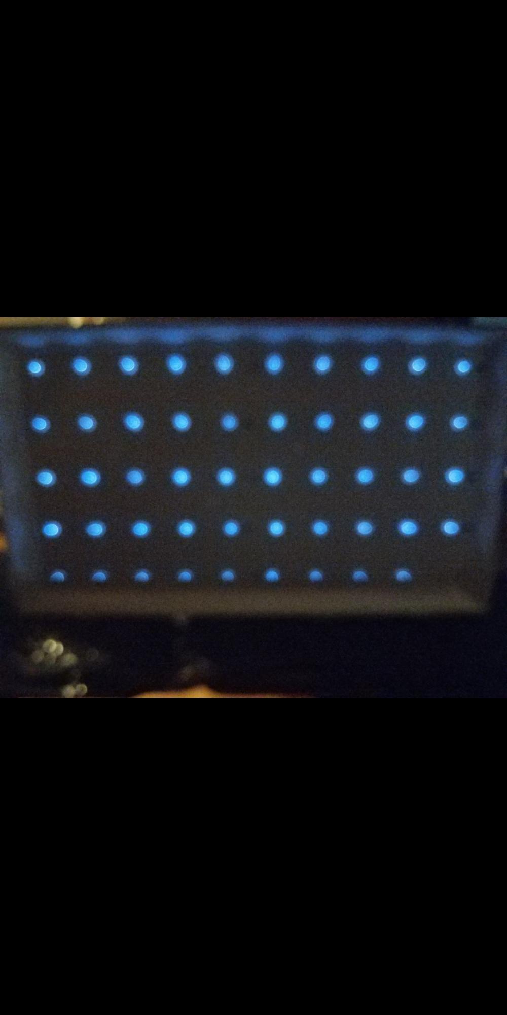

                  Hi thanks it wasn't as daunting as it seems the taking of the panel.
                  my findings front of LCD is fine then I looked at back.like you said and saw crack.
                  Then when I looked at led back strips I had to film on phone as they flash on and off so fast and every 5 or so seconds.
                  I found one led wasn't lighting up at the very bottom right corner.
                  To my final test when I hookup my multimeter to ground and stick a probe to the white wire running from powerboard to LEDs all backlights light up solid except the top row which flashes intermittently and the bottom row which flashes intermittently except one led at the right end of the panel which doesn't come on at all.
                  Thanks to all who helped as I gained good experience from this

                    #49
                    Re: Please LG TV no picture but sound slight buzzing
                    sorry to hear that.. its awful. but did this crack on screen ? to me via photo look a scratch
                    .. if its scratch worth to repair LED of course
